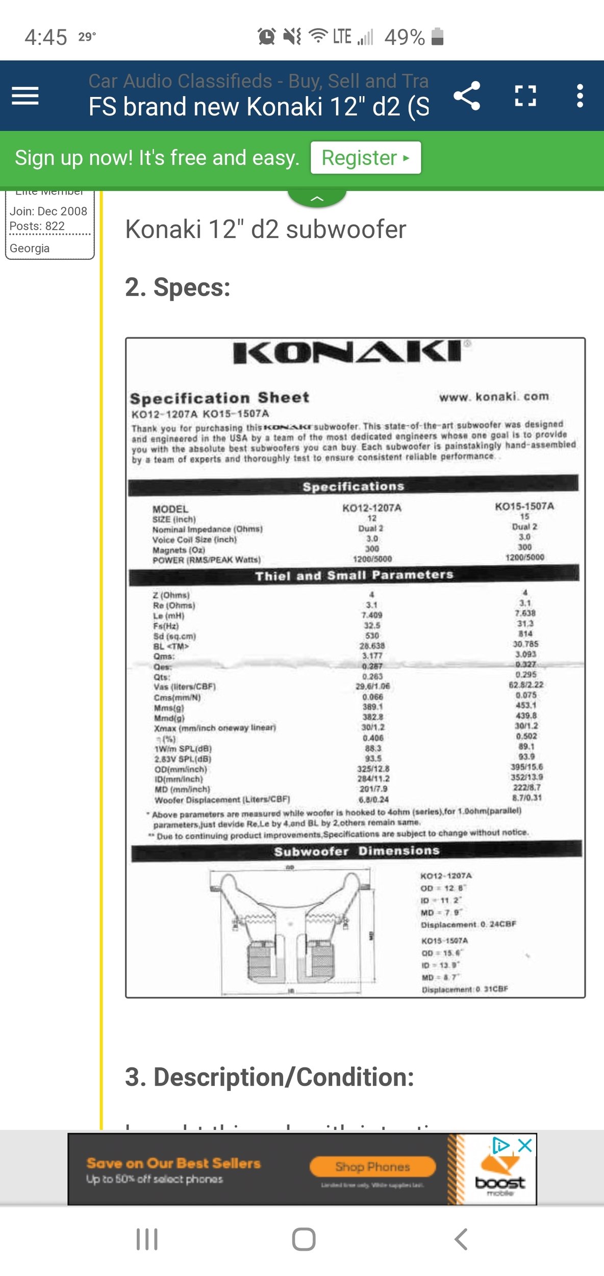

From what I know I got these for ts parameters on the model
This is the extent of depth I've tried to find on this thing. I remember hearing something about them but this is my first at messing with anything of theirs. Anymore iron or possible designs would be seriously appreciated. I tried to find an old post of big moe's with a sh*t ton of box layouts but never could find it. I was a member way back when snoopdan was still around but forgot all my account info and havent been active on forum for years.
