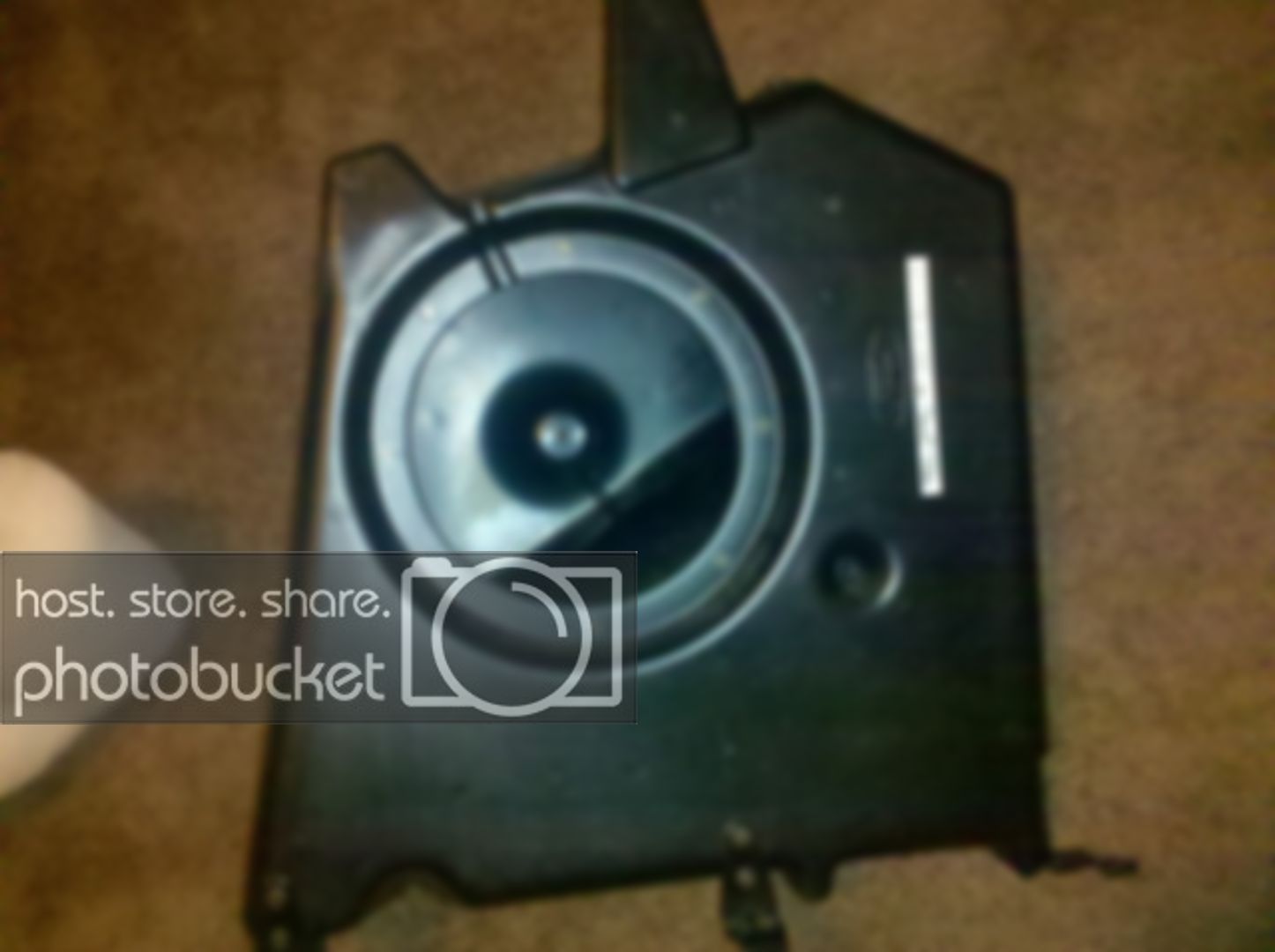

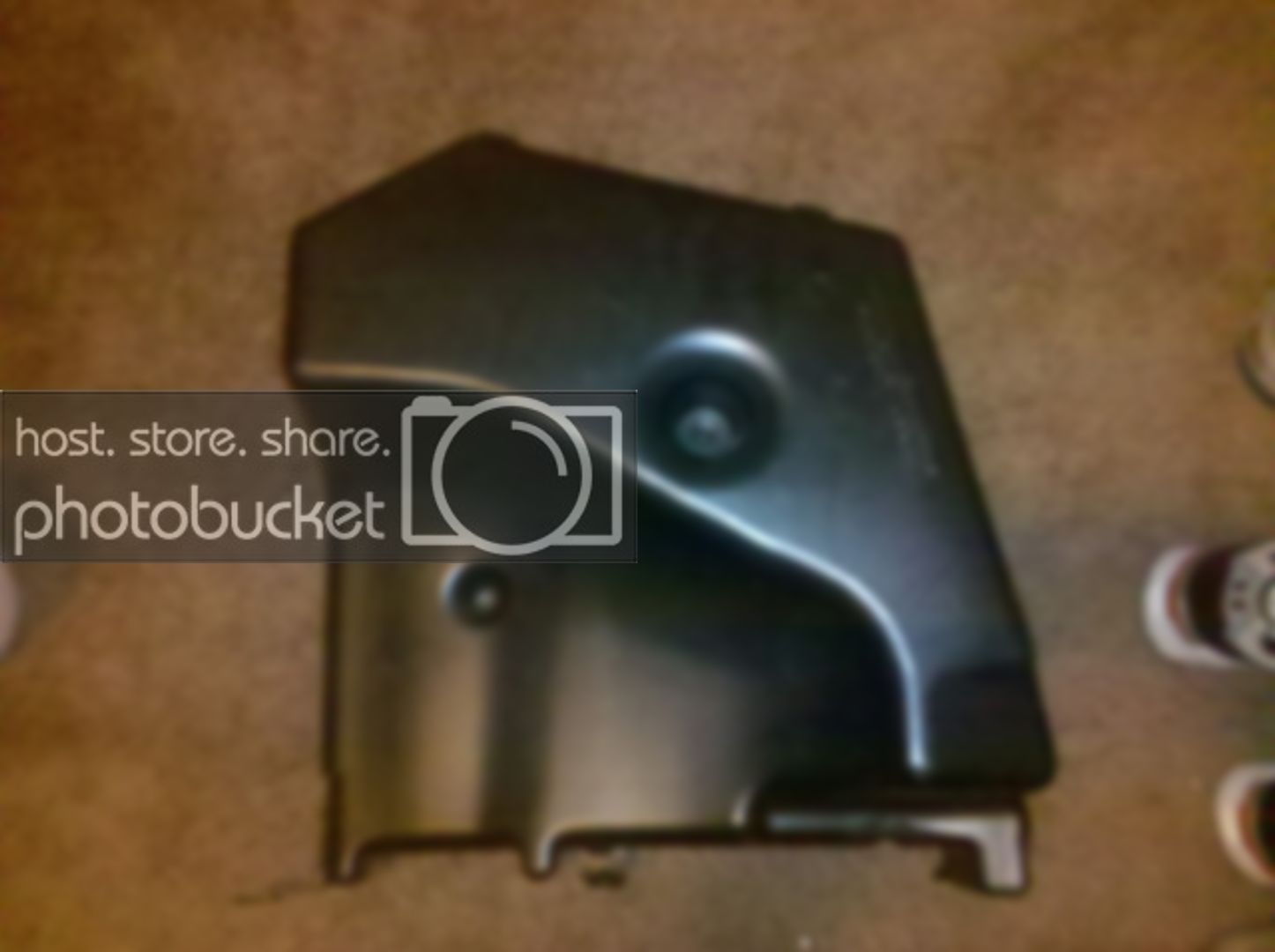

mast240, what about a form fitting box? I have a stock sub box that my car came with that I just want to replace the sub. I don't even know the cu is of the box because of the odd shape of it.
yea... for odd shaped box's, its more of an approximation.... if you wanted to find EXACT size, and the box is plastic, like yours, you could always use water to find out the exact size... 7.5 gal = 1 ft cubed... just make sure its 1. completely sealed, and 2. you dry it out COMPLETELY before re-installing it, 3. theres no internal circuitry that could get fried from the water (i.e. stock internal amp)
