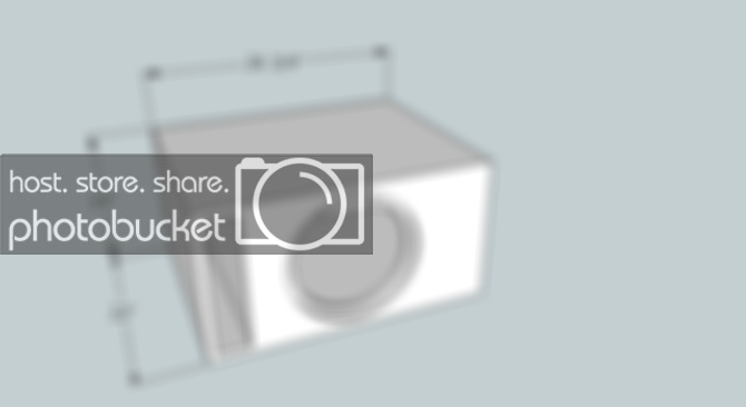

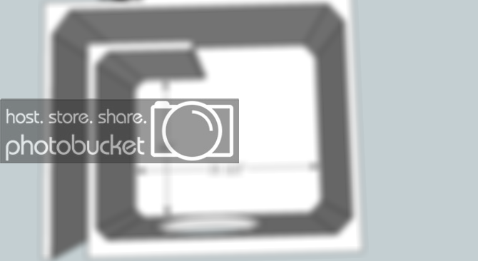

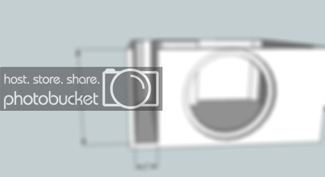

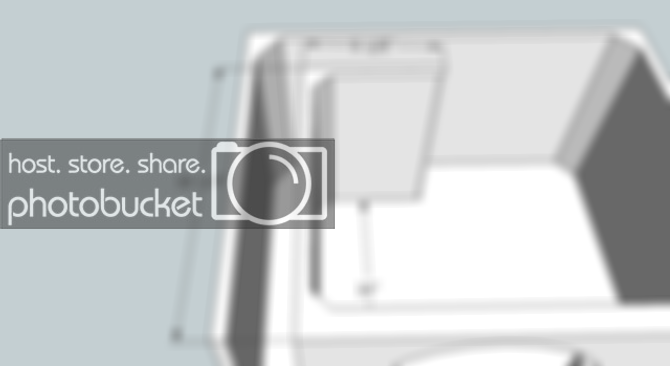

I did this like a month ago though so not sure if I remember the specs very well but here it is
let me know if I left anything out
Going off of those pics, I have 3.60741ft^3 before any displacement. So roughly 3.2ft^3 after sub and those little 45's in the corners. Port displacement is ~.8ft^3, so after all displacements you have ~2.4ft^3. 2.4ft^3 with a 12.5"x3" port that's 30" long = a shade under 35hz tuning.
