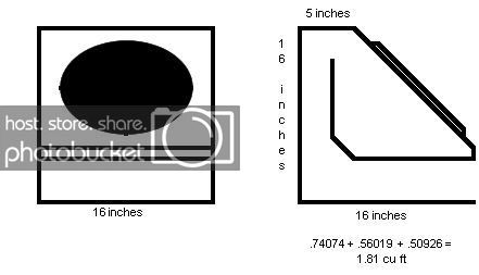

i did a quick draw up of a box - tell me if it would even work.....i have no clue
poke as much fun as you like...just give me some ideas about what i'm looking for here
