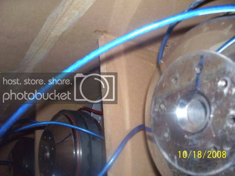

jake...i cant tell from any pics but do you have a divider in between the subs? and also do you plan on trying different angles besides 45s? and different size angles as well? also have you taped up the subs and counter sunk them? mall possible gains. all of them have gained me in the past //content.invisioncic.com/y282845/emoticons/smile.gif.1ebc41e1811405b213edfc4622c41e27.gif

I have a brace with a hole in it between the subs - I was going to try covering the hole later to see what happens.

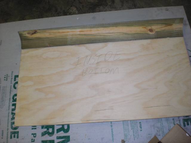

I will be making the 45s into arcs to test vs. 45s like so :

or are you saying you have like a window frame type brace in there?
Kinda like that - it has a circle hole in it with rounded over edges //content.invisioncic.com/y282845/emoticons/smile.gif.1ebc41e1811405b213edfc4622c41e27.gif
I can cover the hole and the divider would be alot like yours.
