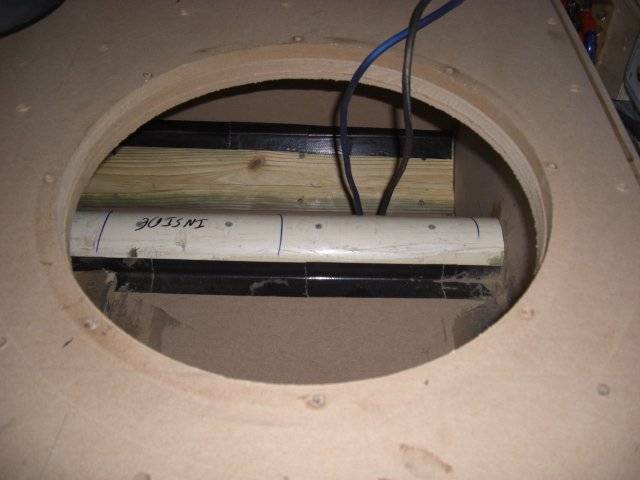

First piece in place - screwed in with tape along the top as that edge was rough:
This resulted in a GAIN :
I tested 49 Hz as well to make sure my frequency did not change - I metered 155.2 dB @ 49 Hz. I also gained 0.1 dB here compared to before but it is still not as loud as 48 Hz.

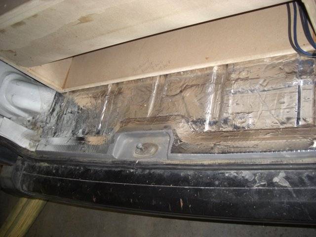

While I'm in the area I tried something random - metal taping all around the plastic trim piece at the bottom. I didn't have enough time remaining today to take the whole box out and do another 45 piece so I wanted to try something //content.invisioncic.com/y282845/emoticons/smile.gif.1ebc41e1811405b213edfc4622c41e27.gif

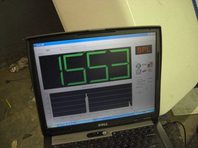

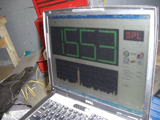

No change... but at least my 155.3 is consistant :
There was alot of odd noise on the meter this time, though... not sure why, maybe a fluke.
good to know some foil tape isnt going to help my car...
I've gained 0.1 in a vehicle doing 158s with a single piece of foil tape before //content.invisioncic.com/y282845/emoticons/smile.gif.1ebc41e1811405b213edfc4622c41e27.gif So it is always worth a shot!

I first looked at the pic of the TL readout WOW Your woofer hit's every note //content.invisioncic.com/y282845/emoticons/wink.gif.608e3ea05f1a9f98611af0861652f8fb.gif Then i read your last line:laugh:

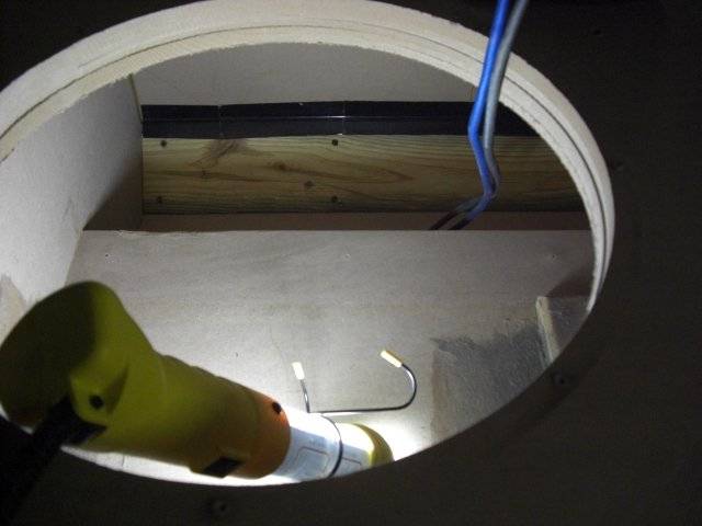

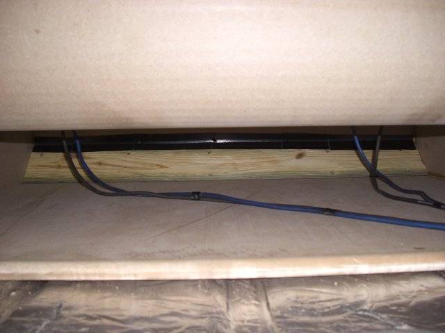

I wanted to see how much my internal port PVC piece was doing so I took it out this morning :
* With
* Without
Without - 154.9 dB (verified two runs 12 minutes apart)
With - 155.2 dB
So that piece is worth around 0.3 dB!
The score "with" is within tolerance since my speaker wires moved around in the port with the subs in and out... I need to get those out of the port - will probably do that today before further testing to eliminate that variable.
