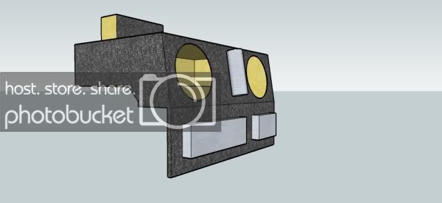

dude heres one i drew for a caprice its aprox 4 ft3 tuned to about 38hz ported up through the rear deck
ignore all that other crap @ bottom i was just showing the kid where his amps and cap could go
that's a pretty neat design. only thing is, i'd really like to keep my spare tire and not port it through the rear deck. i don't want to cut a hole in the rear deck. i could probably do with a box with close to the same dimensions as mine, just wider to add some more cubes. the max for the cvx's is 2.25 cubes per sub. here's a link to the manual
