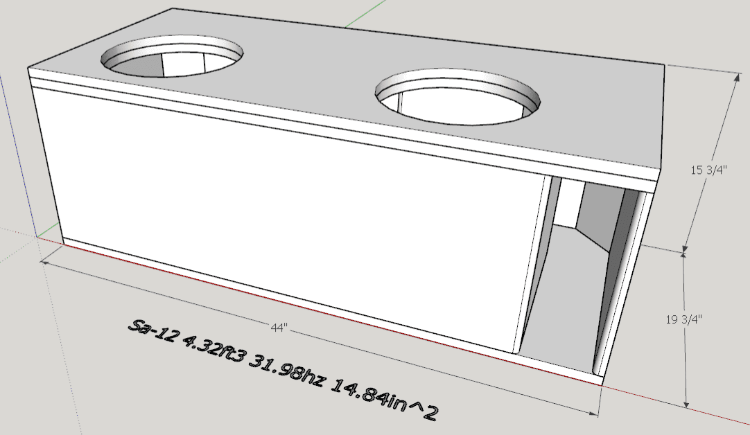

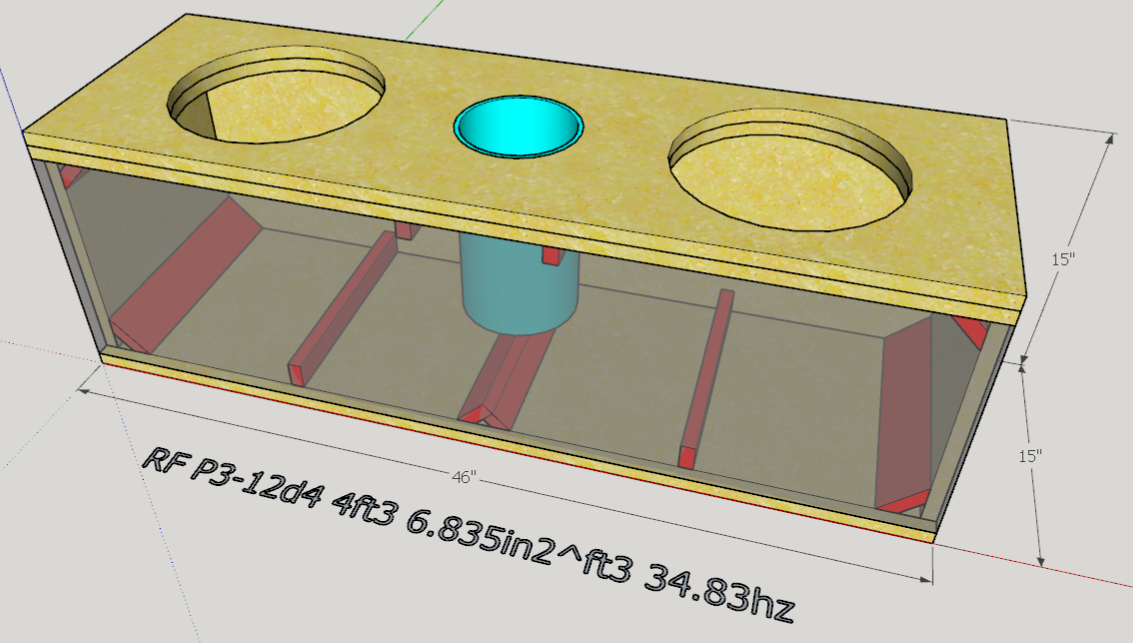

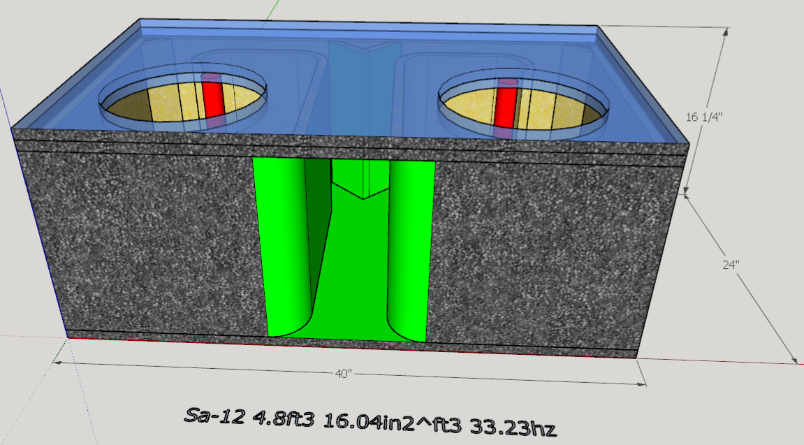

Box 1. It says 4ft@32 hz but I’m guessing that’s before sub displacement so tuning might come in a bit higher. Box 2 port looks huge and it says “spl port” so yeah it’s probly tuned really high.
Spending that much on subs and prefabbing them makes no sense.
Maybe for a temporary solution... idk
If it was me I'd build something configured for the specific vehicle tuned to your taste and designed not to limit output on your actual power.
$400+ of subs deserve a great enclosure.  Prefab would be my last/temporary option.
