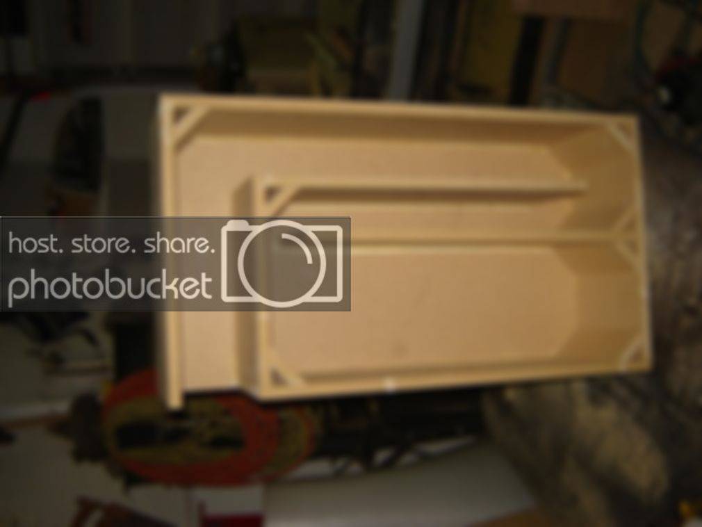

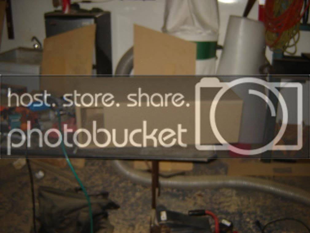

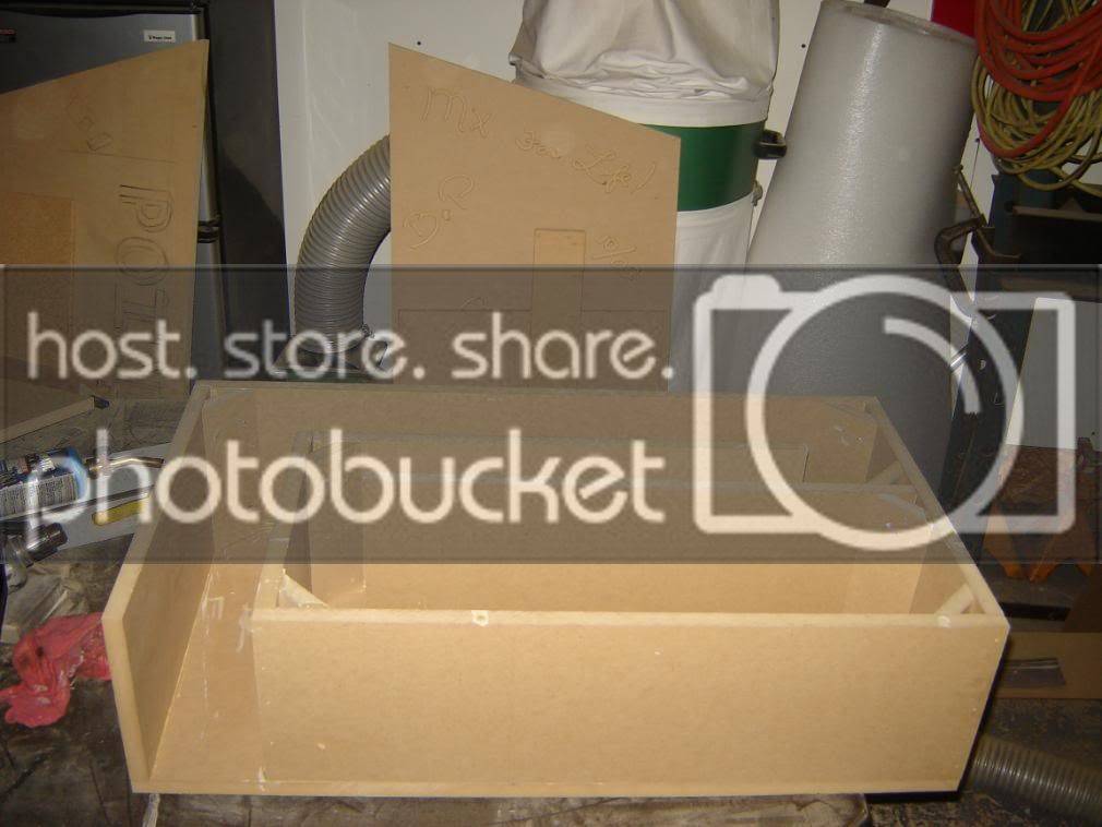

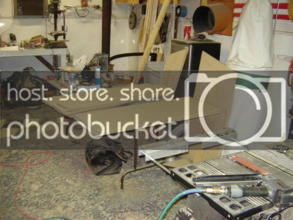

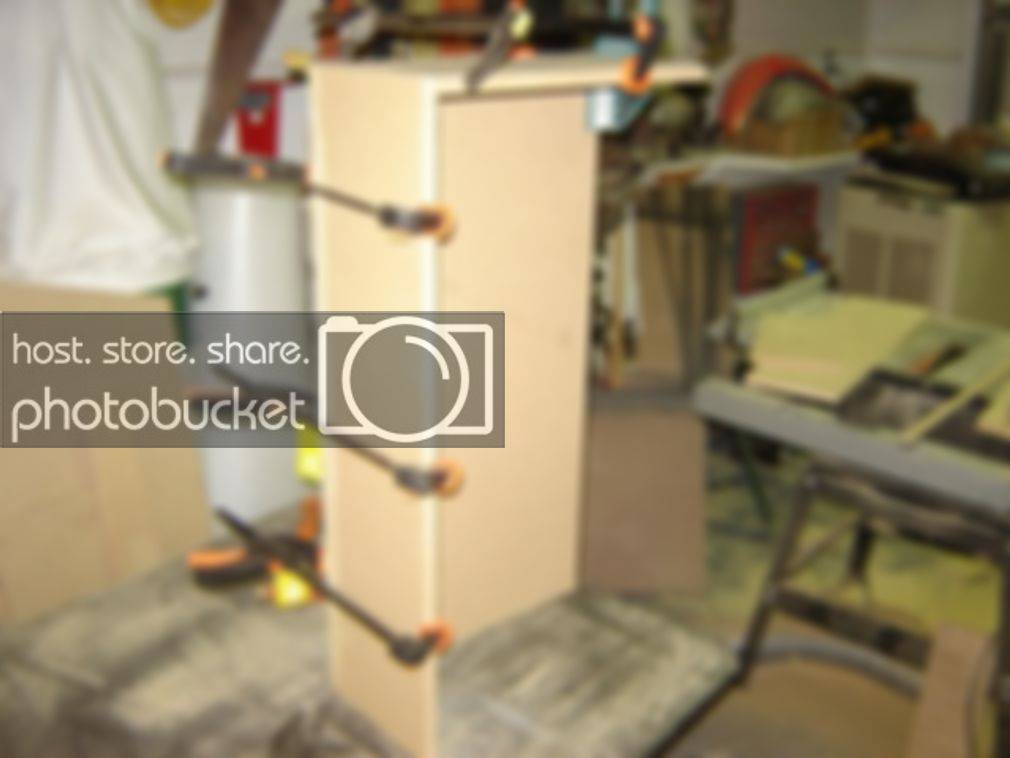

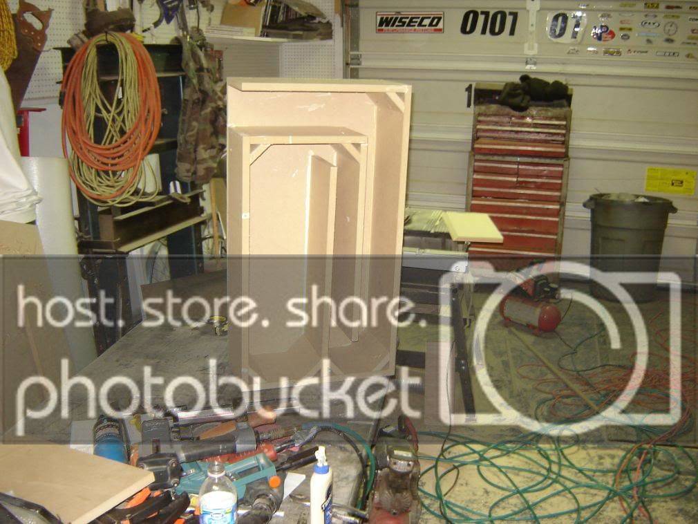

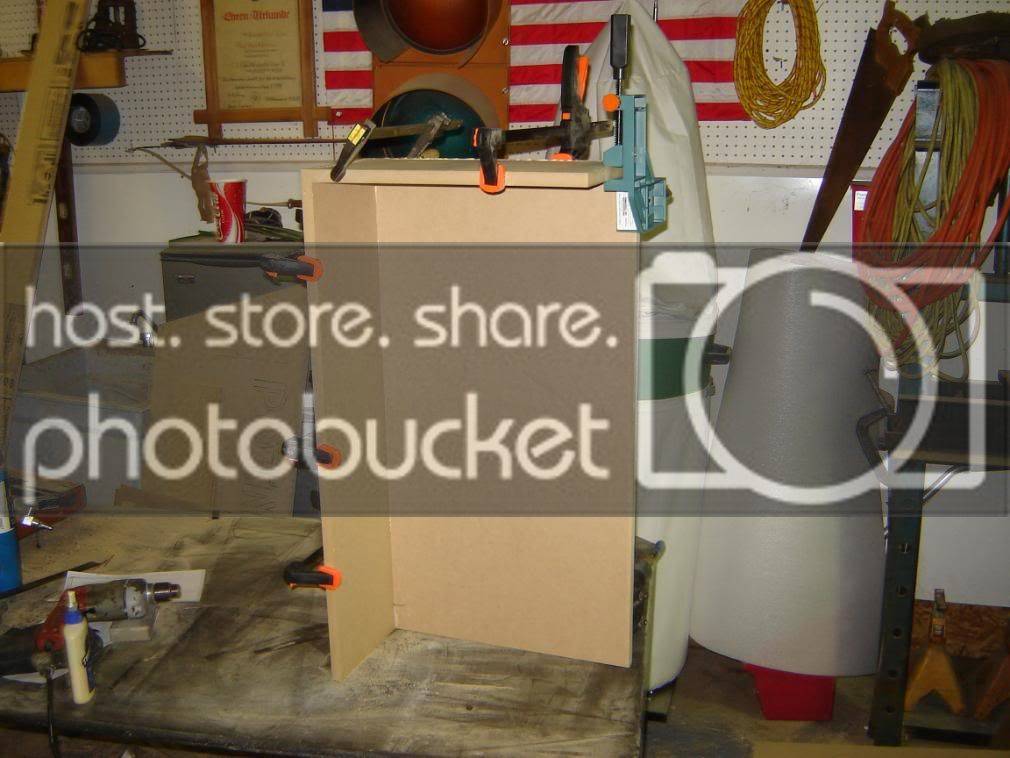

Got the box for the ED8 finished tonight, well nearly done. Still need to cut the hole and carpet it. On with the pics.

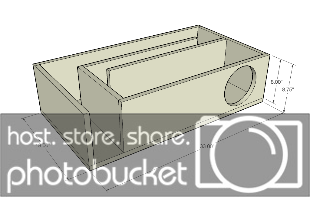

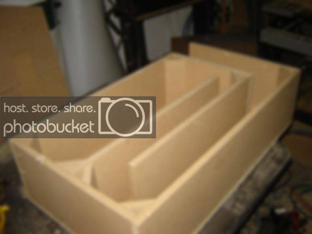

i know its a T-line just dont know the expression in english for the tunnel/port what ever u call it...every tline design i saw b4 didnt have 'irregularities' in teh tunnel area
Its a tapered t-line, meaning at the beginning it is smaller and tapers to a larger width as it gets longer. It is similar to a horn(i say similar for comparison purposes but in reality they are quite different)
