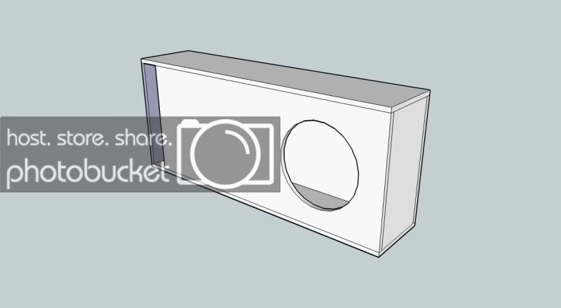

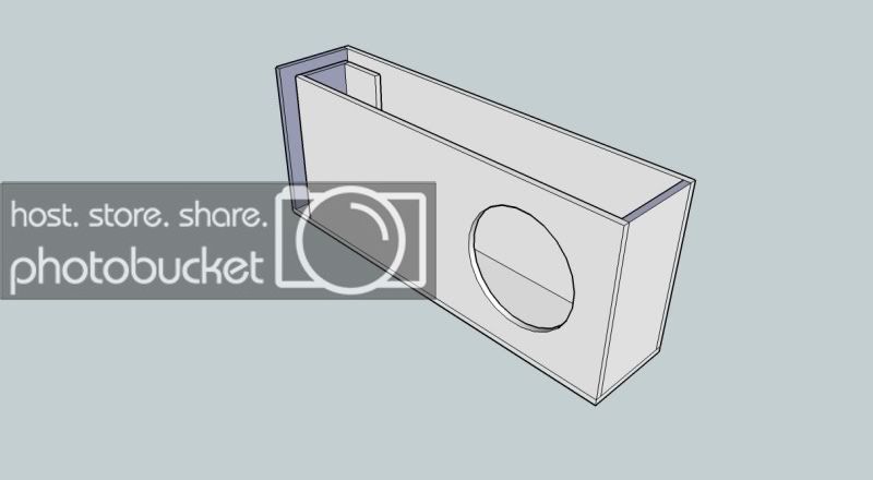

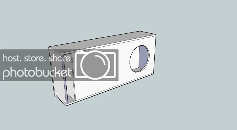

Ok, I found a Massive audio dmx 15" that i wanna buy and try out in my truck. The box is 4cu ft after port and sub disp. Port is 61.5sq in tuned to 37.5hz. Would like to hear some opinions on if this would have more output than my 2 12in alphas. The dmx will be ran on my RD 1750@ 1ohm.
pics:

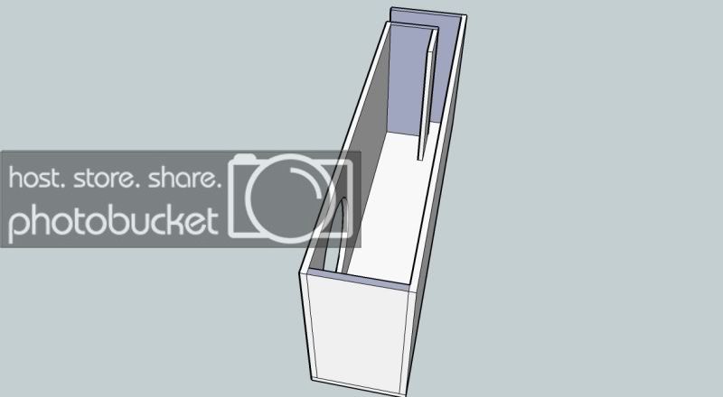

ok, im not for sure that i can make it a whole lot bigger. Ill try and see what i can come up with and post a few more pics. Also I could always add more power later and deffinatly be louder right? lol
Oh ya i would deff add more power! And you will be way louder! You should just upgrade to a 3k amp! Imo! But ok lmk when you get pics up
lol yea idk i kinda wanna get louder with the power i have but i have the alt power to do 3k i just gotta add a couple more batts. Ill have a new box up in a few mins.

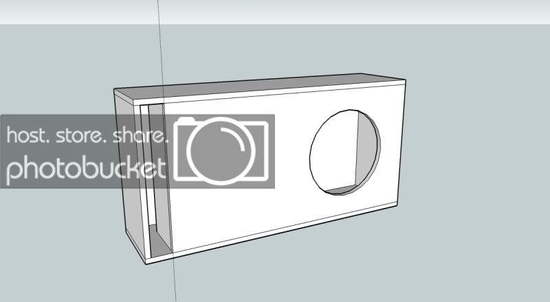

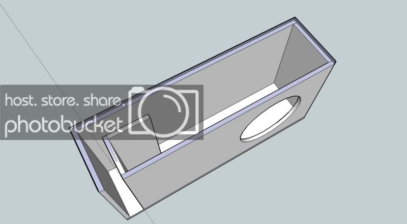

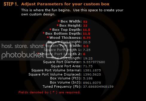

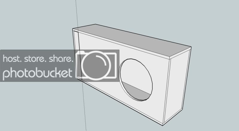

Ok, I came up with 4.8 cu ft actually after port and sub disp. slot tuned at 37.68hz 71.75sq in of port. 3.5x20.5 slot. Will have some pics up soon...
