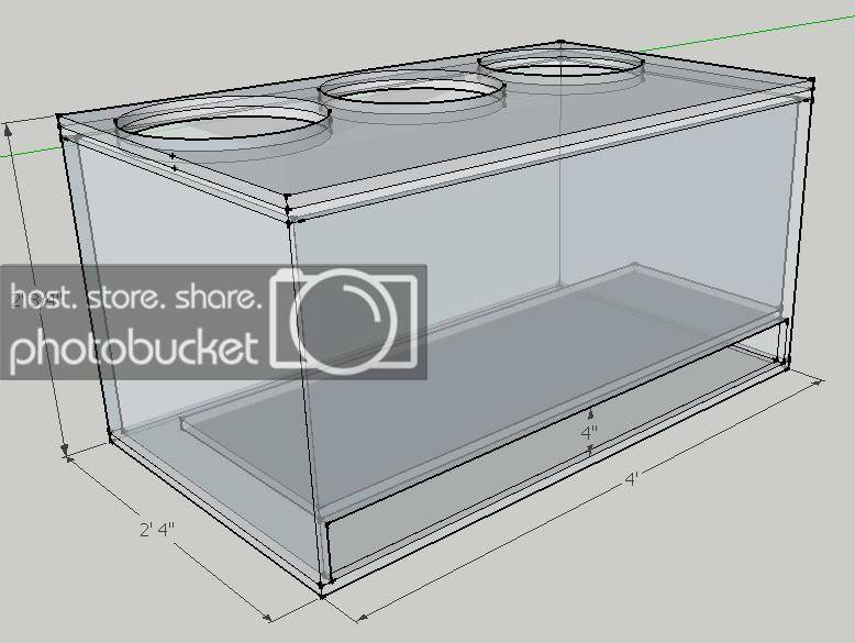

Trying to design a box for 3 15s I'm normally used to using rebox calc, but for this large scale of a box i just used 12volt for the port length etc. i had 15.54 cubic feet after sub displacement and put that into the port length calculator along with the dimensions I wanted port. It told me for 16.6" of port. This totals 1.7 cubic foot displacement so i would subtract that from my 15.54 for the net cubic feet? Here is the sketchup model. I just want to make sure I am going about it properly. The box will be braced yet don't worry.

you have to put in the port calculator how much box is going to be after ALL displacement...so its not still going to be tuned at 34hz after 15.54-1.7cu.ft....thats like 13.8ish cubes so you want to put that into the port calc not 15.54.

how can i see what all the displacement is if i don't know how long the port is going to be for port displacement...I thought the calculator worked by putting in my 15.4 cubes and it made port length appropriate to that volume. so after the 16" port i would have my 13.8 cubes net? I can't put in 13.8 because thats assuming 16" port port already..? It would make a port length according to 13.8 cubes when in reality there is already a 16" long port.
