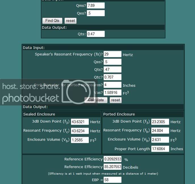

this will be my first system ive figured almost everything out that i need now i need a box but im clueless on all the dimensions i need form reading it seems like a ported box is the way to go for the type r i listen to mostly rap hip hop and some rock if that helps can any one show me the way to what size box i need
A 3.3911 cubic foot box tuned to 28-32Hz (at least that's what I would prefer), and the RE Box calculator is inaccurate. I just got done making calculations for designing a box for a 12" type R so that's how I know about the box size.
Yeah, no. Make that box a cubic foot smaller and you're money. Anything over 2.75 cubes for a 12" type r is almost always too large.
Yeah, you're absolutely right lol.
I tried using BCAE1 again and the box volume came out completely different than it did yesterday.

Yesterday, someone told me that they had a box that was 2.7 cubes tuned to 28Hz and they said they were unhappy with it and came to me asking for help to make it sound better and I guess I must have hit a wrong button when using the calculator.
