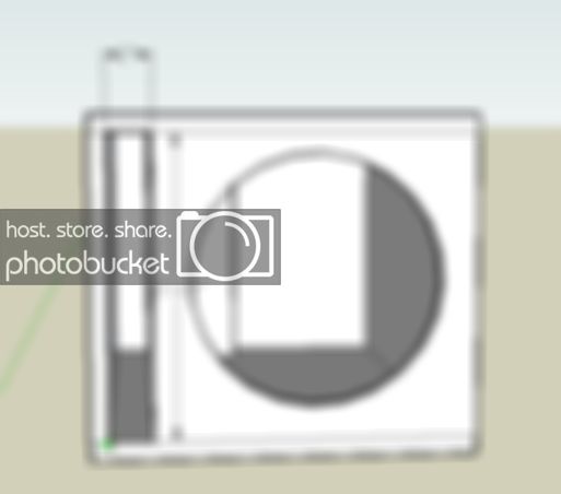

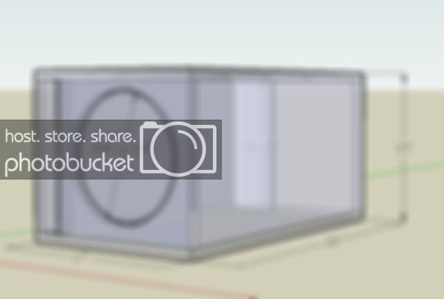

DonH 5,000+ posts ..... 6,288 44 So Cal Mar 17, 2009 #17 ight bro here you go box is 2.56ft^3 @ 26hz after port and sub displacement. with 27sq in of port which is just fine first pic port pic bottom 17x29 Top 17x29 Left Side 29x13.5 Right Side 28.25x13.5 Back Plate 5.5c13.5 Front Baffle 14.25x13.5 Port 1 25.5x13.5 Port 2 4.2x13.5 which is 4 1/5 //content.invisioncic.com/y282845/emoticons/biggrin.gif.d71a5d36fcbab170f2364c9f2e3946cb.gif cutout diameter is 11 1/8 should get LOOOOOOOW
