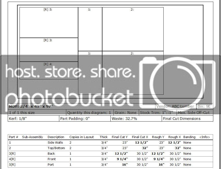

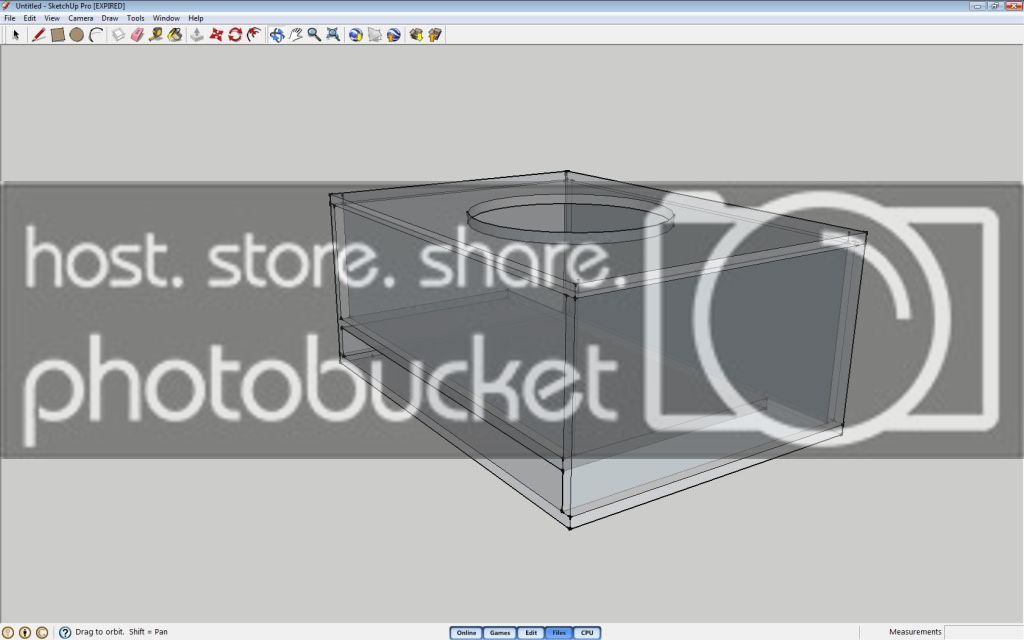

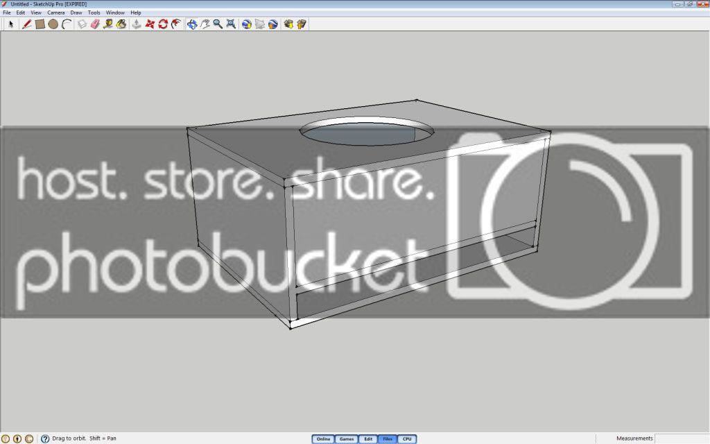

3.4 cubes at 38hz
Box is for a Audioque HDC3 15" on a Kicker SZ1500
Going in a hatch Integra, that is the reason for the CRX style box.
These should save ya a bunch of time d-REW or if anyone else wanted to make a similar box.
Hopefully d-REW will post finished pics as he is doing all the build work, I simply designed it. Pretty basic, yet solid box. Best of luck.

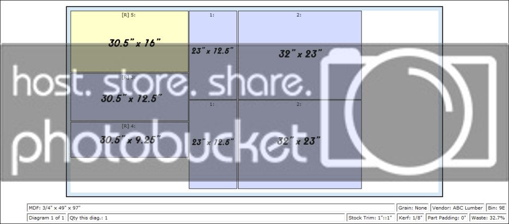

Looks good. Just curious, what program is that for the cut sheet? Is it integrated in Google Sketchup? (Haven't gotten around to playing with it yet)
Nope its a seperate program you just plug in the dimensions and it will lay them out for ya and everything its real nice, theres tons of programs that will do it but I like "Cutlist plus"
Box is on the small side for the power he has, so if he has room I'd go for 4cubes or bigger...
I know Mike I would have done almost another cube but I literally went to the absolute maximum measurements I was given.
What-up Drew, I would personally tell ur buddy to let it go at least a half an inch bigger each dimension and use 2 street duty 12s or DC audio Lev 3 12s I think he would like the output better in a hatch on that power, and in that airspace.
