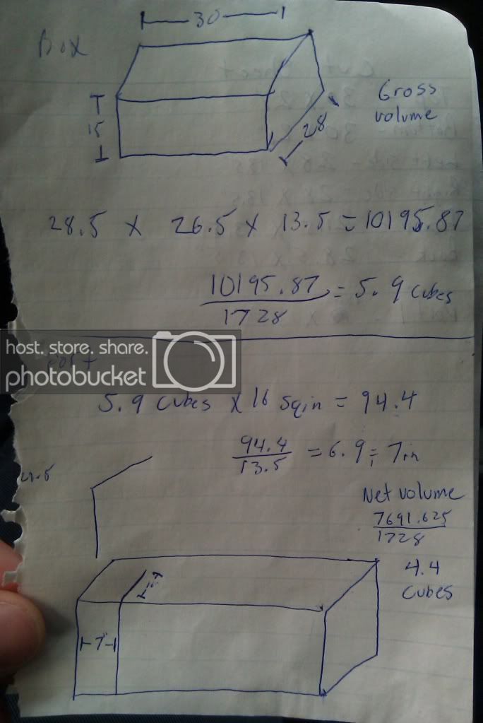

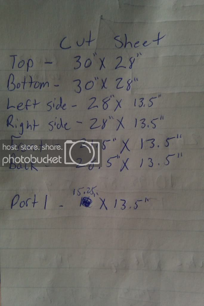

Hey guys i came up with a design i just want to know if i did this right let me know its 4.4 cubes not counting port area and its 40 hz can somebody double check this and confirm what i did was right thanks
