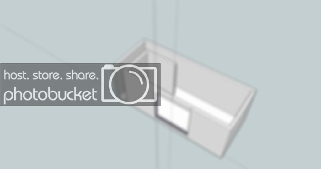

Im going from a wagon with tons of room to a trunk with limited space. I could use some designs and ideas for the new car.
I have a L712 d4 @ 2ohms and runing it on a kicker 700.5. so only 400w rms are going to the sub untill I get the funds to go with a multi amp setup.
Im thinking of possibly going sealed if I cant get the tuning/cf but would rather go ported. Budget is tight so cant got real areos but can do pvc and port into cabin of the car through the empty 6x9 holes.
I have a 93 le baron and hope to go sub and port towards rear. To fit in between the trunk hardware this is about the max I can go to fit.
37w
15h
19d
Would like 3ish cf @ 32-36hz.
Any help or ideas ouside of getting a new car lol would be apricated.//content.invisioncic.com/y282845/emoticons/crap.gif.7f4dd41e3e9b23fbd170a1ee6f65cecc.gif
Ok decided to try ported within those dimensions. Any one want to help me out and shoot me a design for a 3cf 33hz slot port within those specs?
Free would be preferred because my box budget is already over with paint this time //content.invisioncic.com/y282845/emoticons/wow.gif.23d729408e9177caa2a0ed6a2ba6588e.gif
http://reaudio.com/speaker_box/LPort_Box_Calc.html
Type:
37
15
15
15
.75
3
10

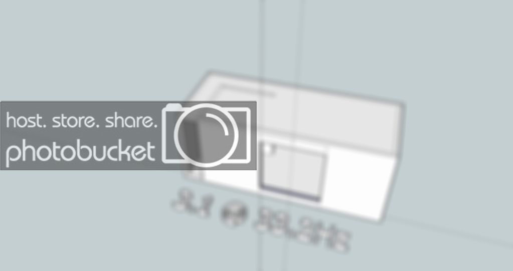

You get 3.1 @ 33.2Hz
The cut sheet is on the website and I am practicing making boxes so I drew that box in sketchup.
sweet thanks for the responce //content.invisioncic.com/y282845/emoticons/biggrin.gif.d71a5d36fcbab170f2364c9f2e3946cb.gif
