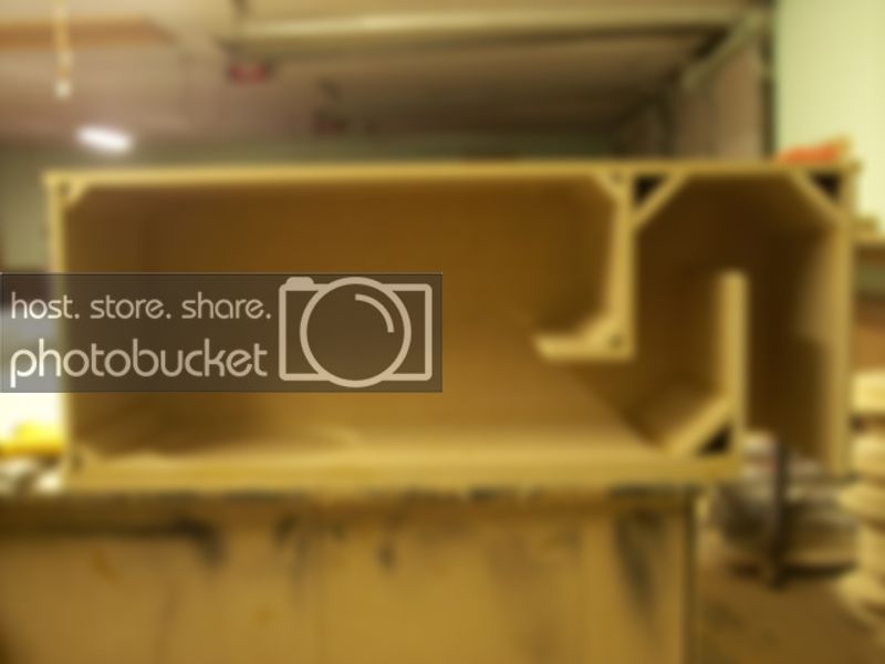

What is the purpose of the pieces in the corner? Is it simply to increase structural integrity or does it lower port noise or somethin? Basically, should I do it to my box when I build it?
Sorry to change the subject slightly, but how important are these? Is the port noise that noticeable without them?
