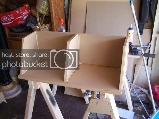

Fun little build. Dual sealed box for two powerbass 10's each chamber is .65ft^3 after all displacement. it will be wrapped in Dark charcoal gray carpet.
Not many pics as it is not to many pieces lol

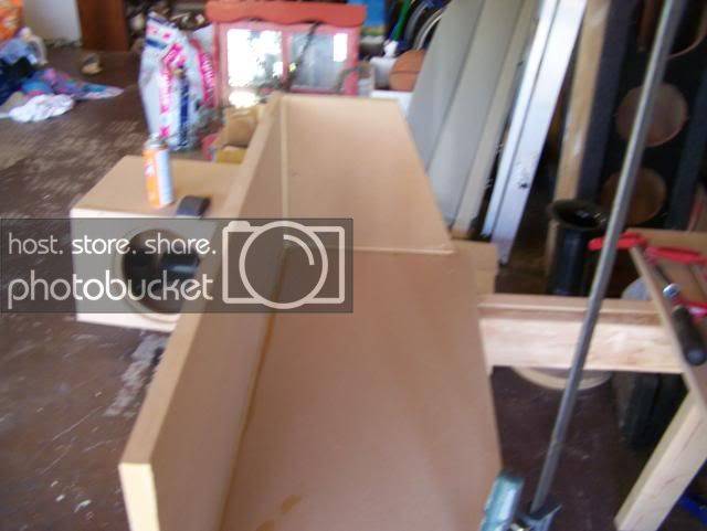

As this box has a slanted rear building from the front back is a must!

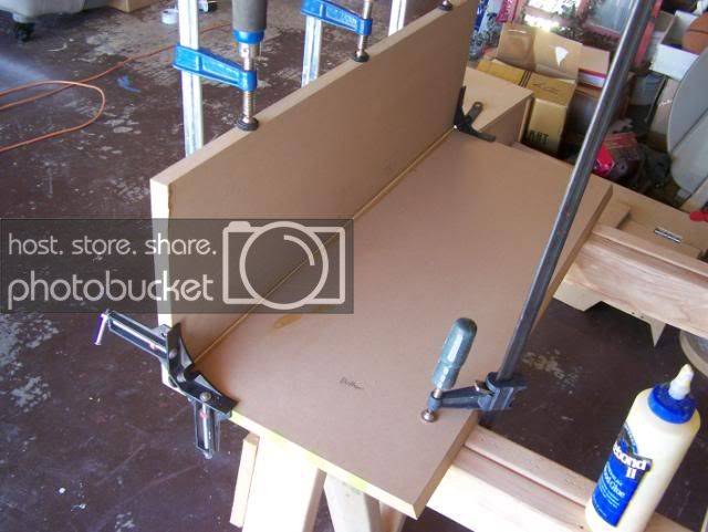

The Front Being clamped

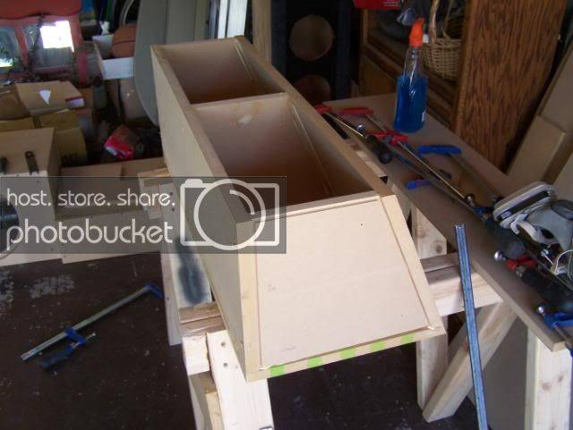

the back is on. as you can see the sides are not exactly flush on this end. i build from one end flush and leave the other end to hang for later when it is trimmed with a flush trim bit. i would advise this to anyone building.

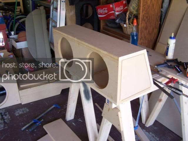

all done except for carpet
if anyone has any questions on how to make the side pieces perfect and exact feel free to PM me and i can walk you through it
