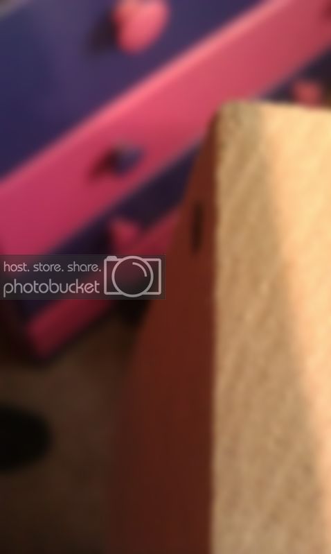

oh no... I must have pre drilled to high and got a small spit..let me check my pics and see how bad they are(if they are even there)..

BTW here is a pic of the box I'm doing right now for you..hmmm counter sunk? How does that happen...oh wait pre drilling with a counter sink bit.
