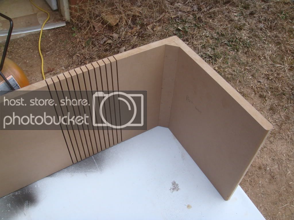

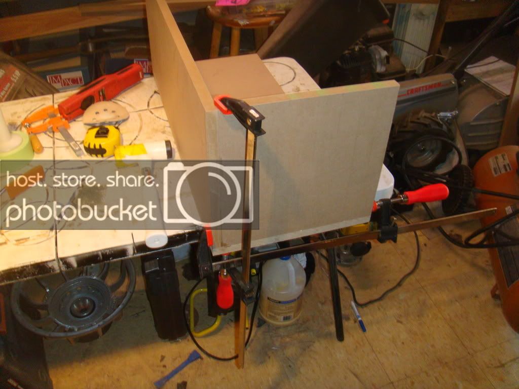

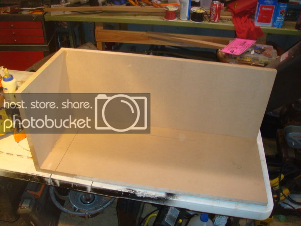

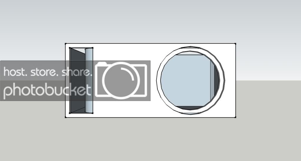

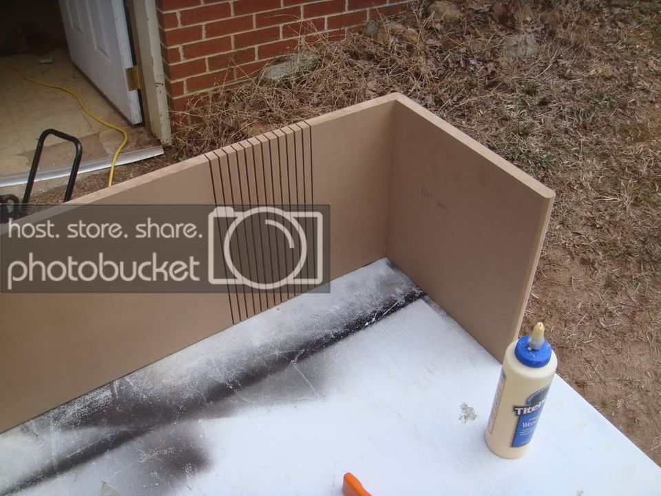

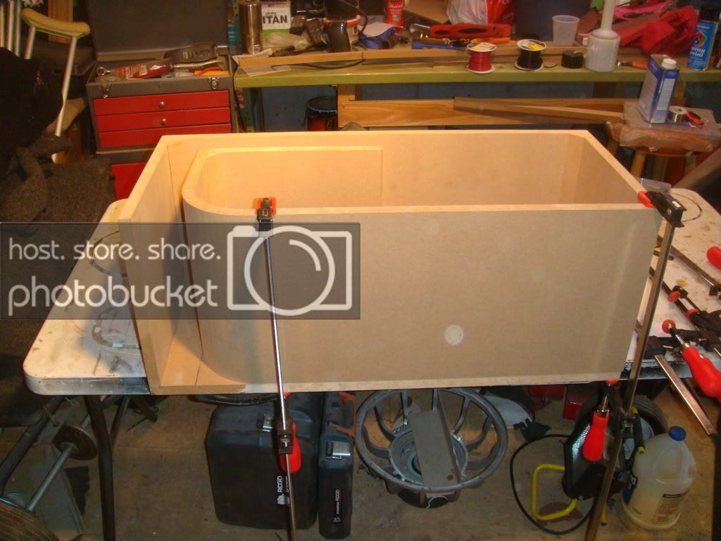

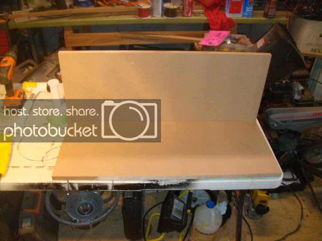

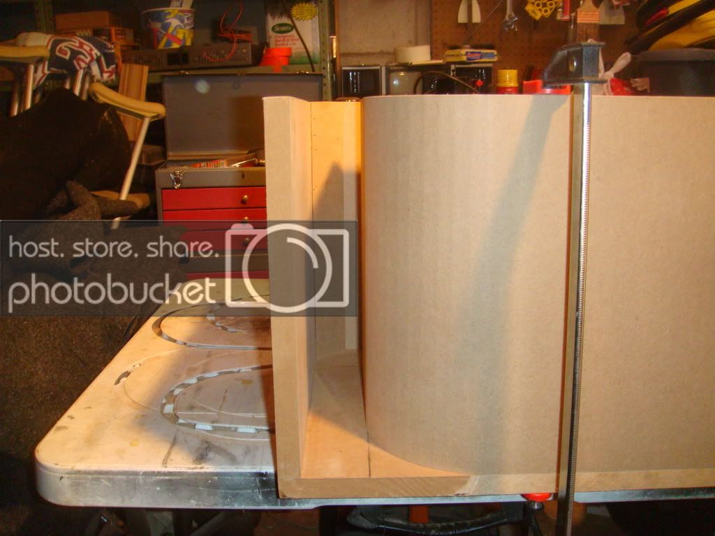

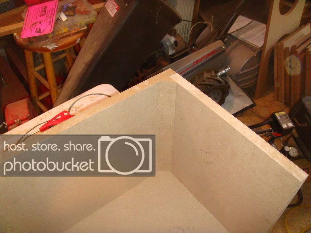

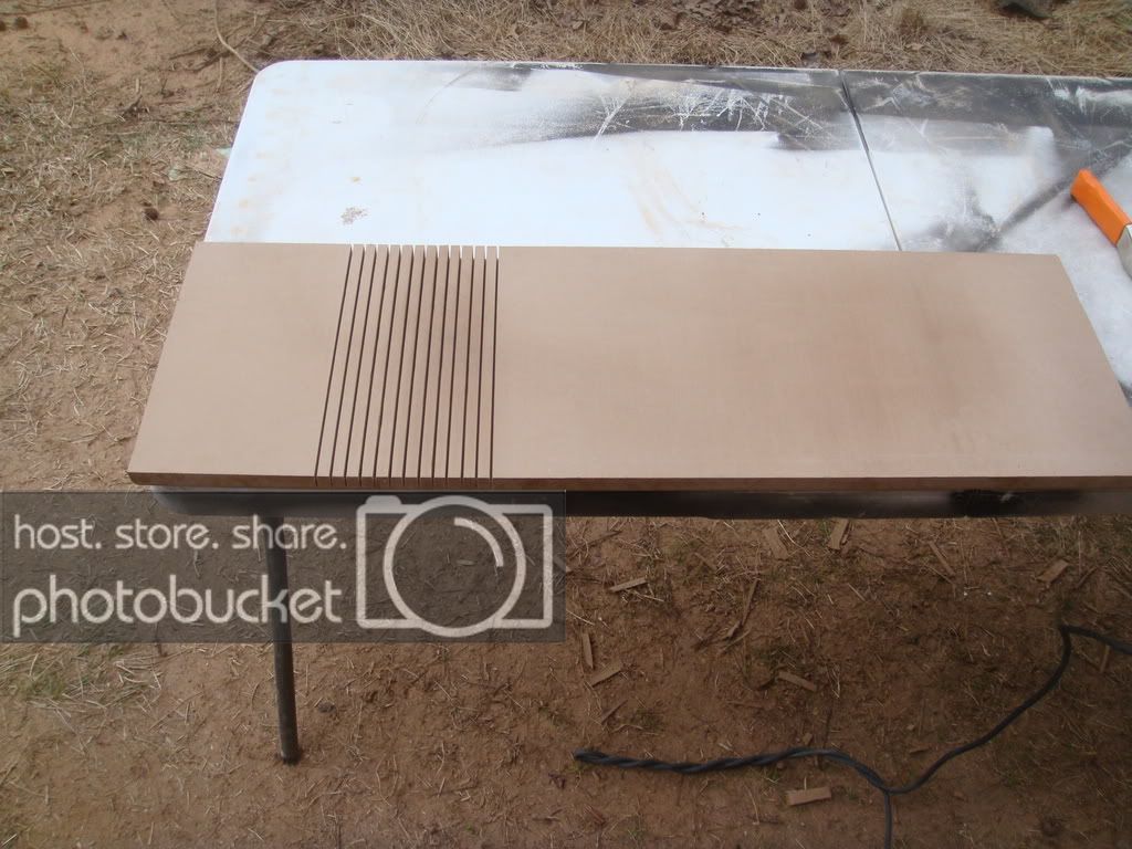

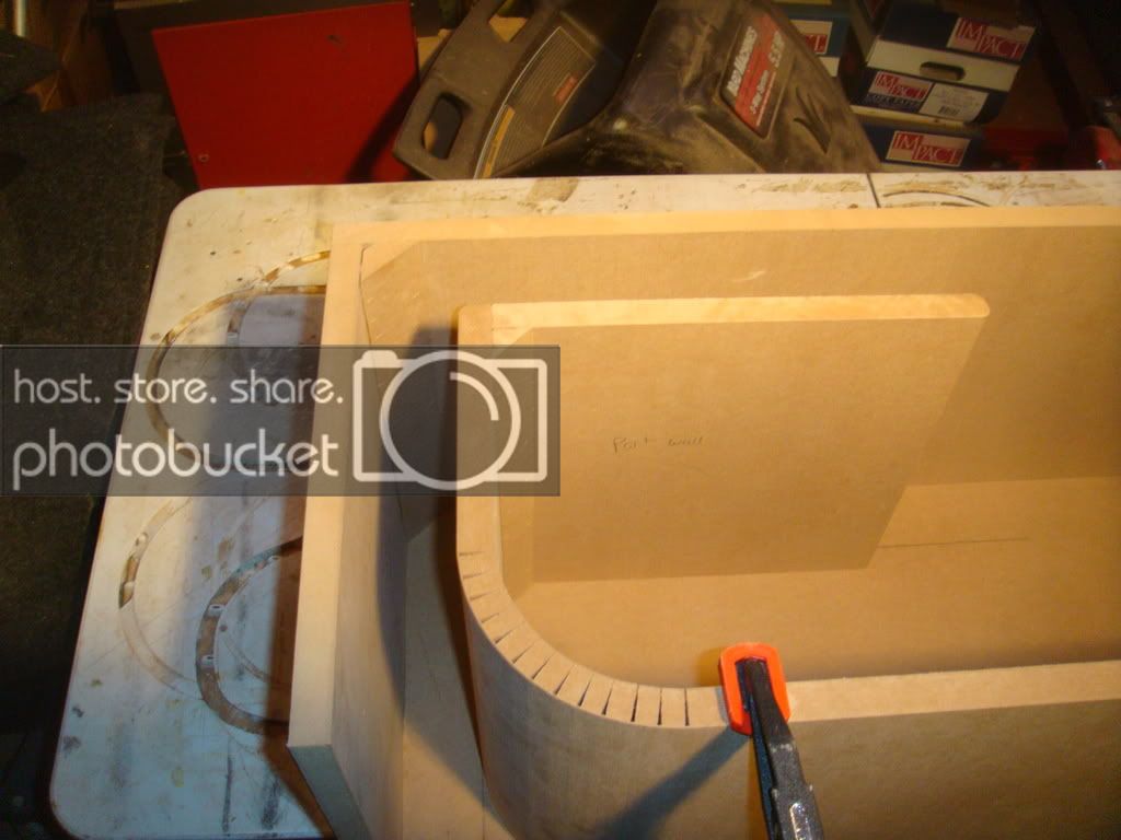

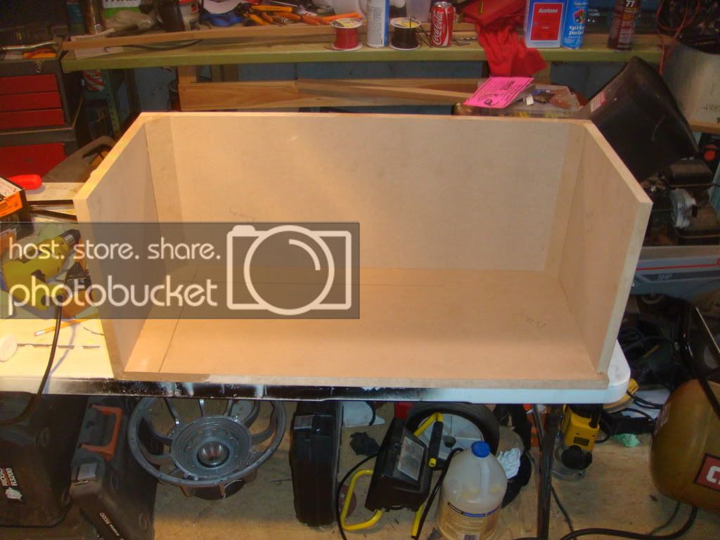

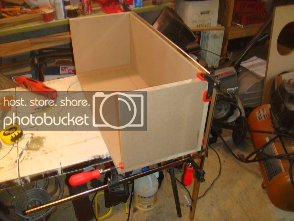

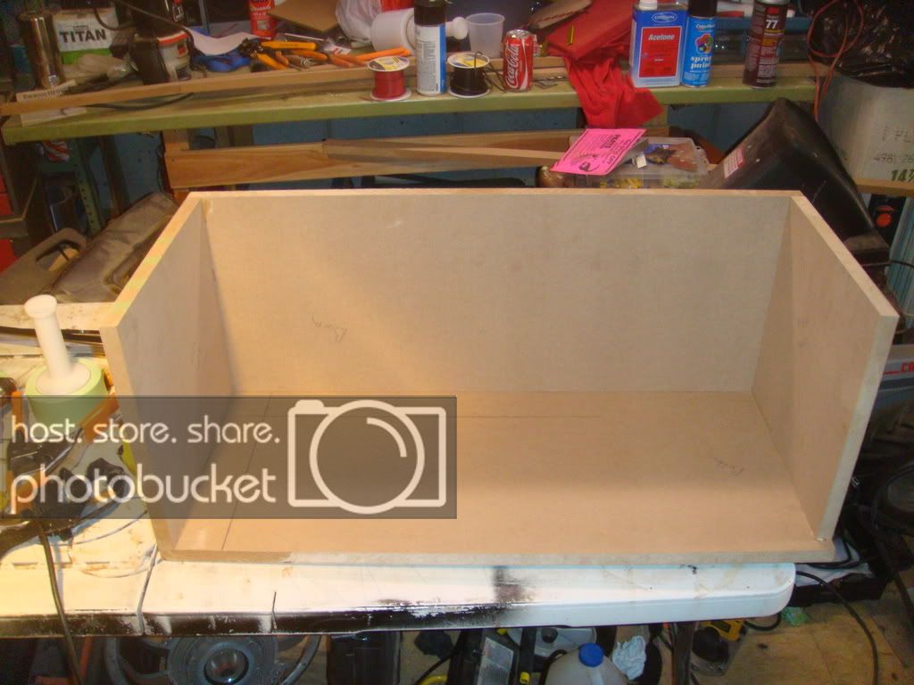

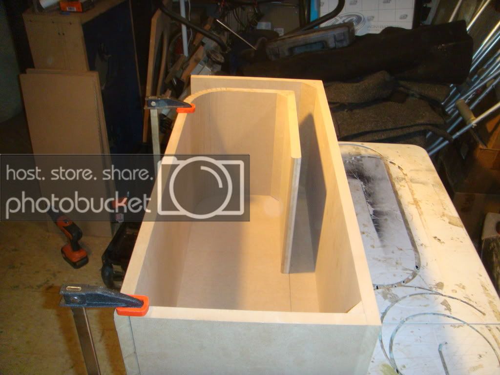

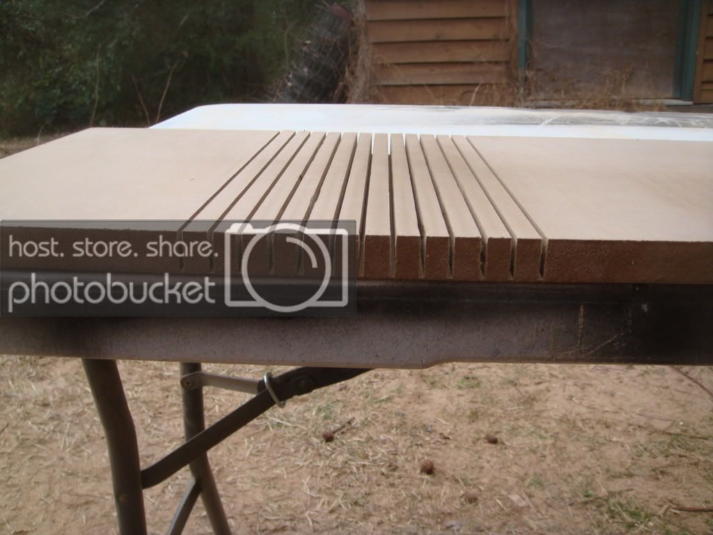

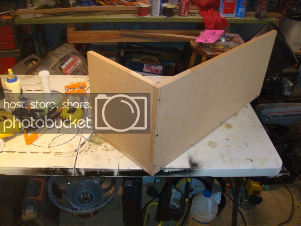

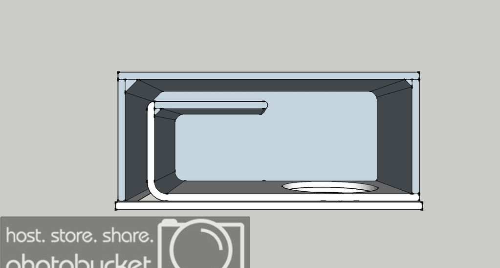

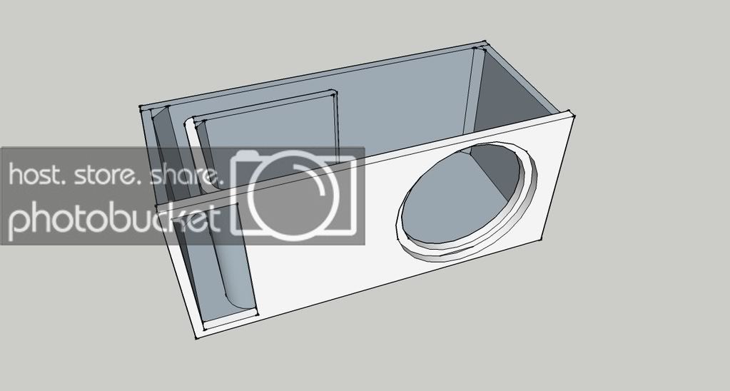

Ok everyone this box is for SQPL's single AQ HDC3-12. Box is 1.8 cubic feet after all displacements. Box will have 27 square inches of port tuned to 38Hz. The port will also be kefered. The front face of the box will be wraped in black vinyl with a rasied AQ logo on it.
Here is the design..........
nice. how do you calculate the length of the port with the kerfed design.
Everyone is diffrent on how they calculate port lenght with a kefered port. Some measure from the start of the flair and back. I measure from the center of the flair and back.
Very very nice, Mike! I am getting excited now that I can see the progress. //content.invisioncic.com/y282845/emoticons/biggrin.gif.d71a5d36fcbab170f2364c9f2e3946cb.gif
