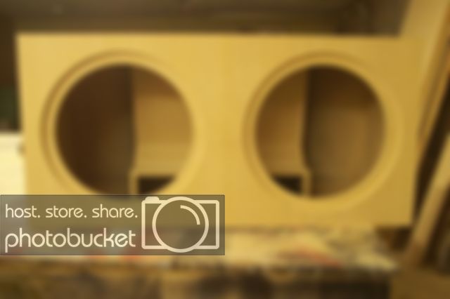

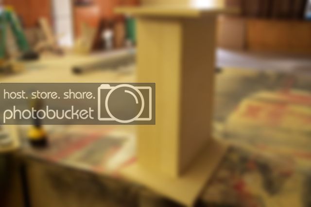

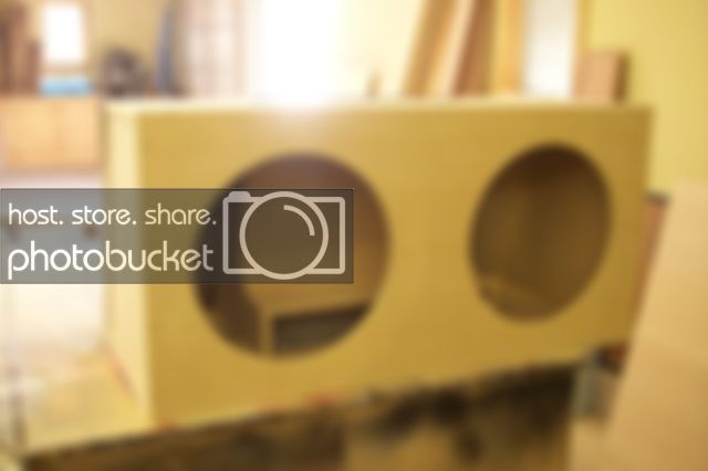

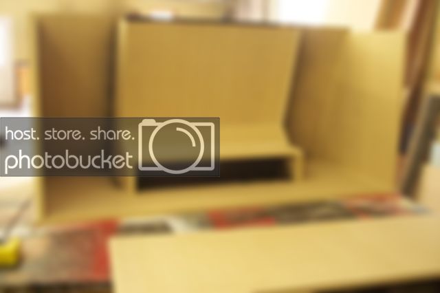

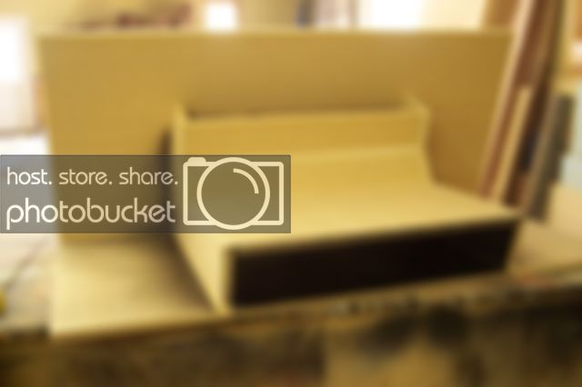

I dont recall the specs off the top of my head. Maybe he will swing in with them. Not a regular ole' ported box. I like getting these kind of builds sometimes. Nice to change it up a little every now and again.

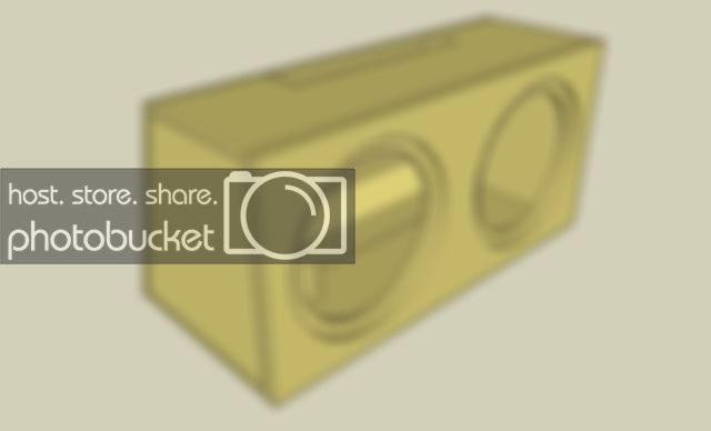

things have been a little crazy as of late, so the actual specs are quite fresh in my mind... but they are "in general" as follows
roughly 8 cubs (i think, i should probably look that up LOL)
tuned at 30Hz
box is for 2 eD 19ov.2's
if we can get IONSQL to swing by, he did the final design on the box, and for sure can give the details on volume and tuning... I just came up with the basic idea, but my initial design was a little small on the port area and we were worried about vent velocity, so Chris, if you can through in your 2 cents... go ahead
looks good to me. im assuming this is the "fun" one you were speaking of? tuned in //content.invisioncic.com/y282845/emoticons/cool.gif.3bcaf8f141236c00f8044d07150e34f7.gif
This is the one //content.invisioncic.com/y282845/emoticons/wink.gif.608e3ea05f1a9f98611af0861652f8fb.gif

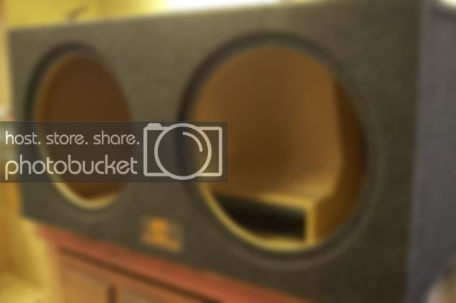

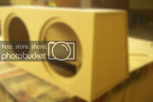

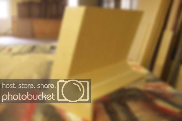

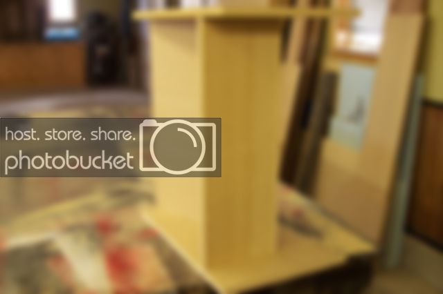

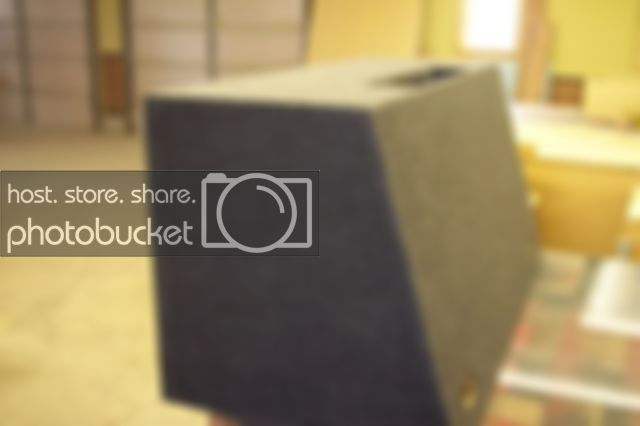

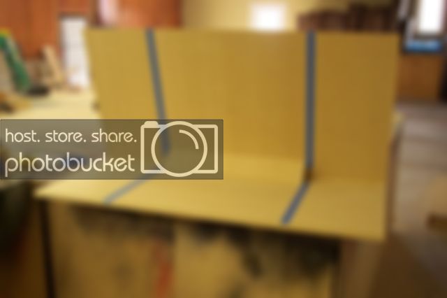

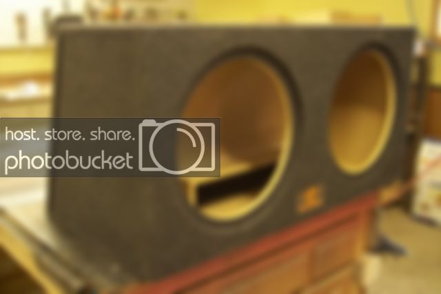

Here is the build completed and ready for carpet.
//content.invisioncic.com/y282845/emoticons/thumbsupwink.gif.129404938effda6ad9cca39e7f4b58a3.gif//content.invisioncic.com/y282845/emoticons/applause.gif.bb805d8088f72dbc2fe808c29e85fb4c.gif
Thanks guys.
Yea, its a little more difficult build. The hardest thing was cutting out the port on the top panel. Since it is angled, I had to make a shim for the router to be able to run my flush bit down it. Still couldnt get it perfect with that, so had to do a little hand sanding.
