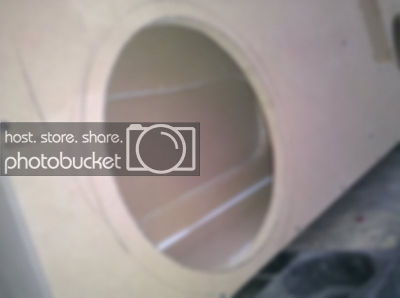

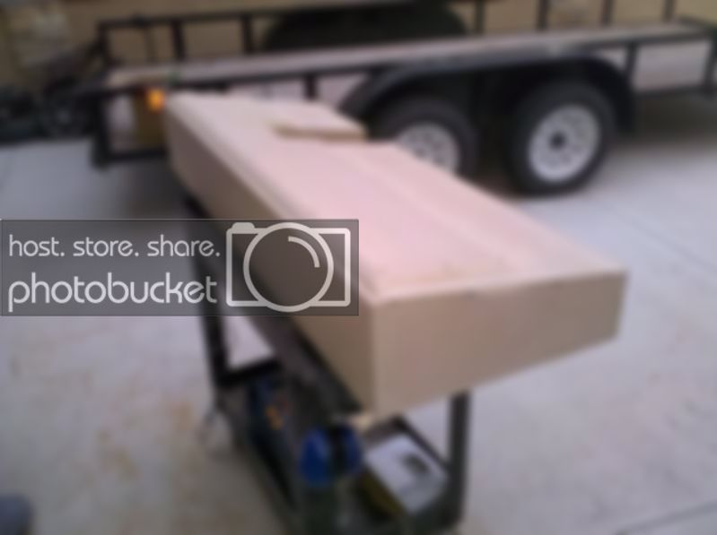

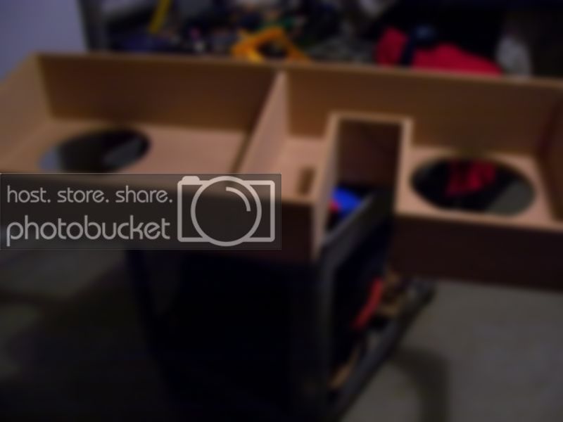

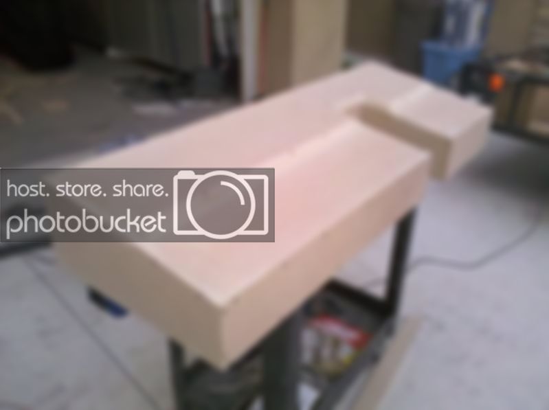

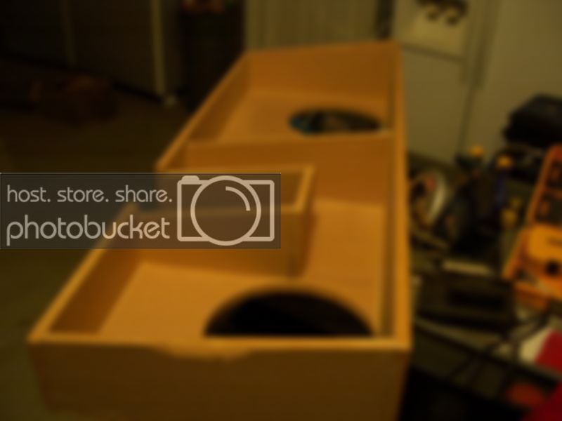

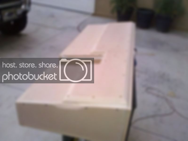

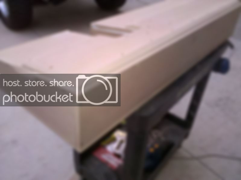

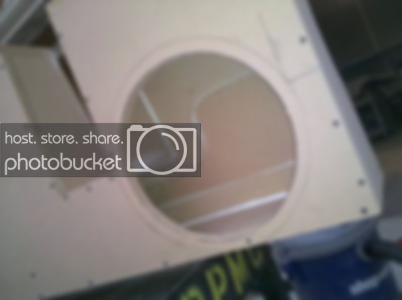

Thought i share my box i have been building for under my rear seat in my F150
here are some pictures of what i did today.
I have to work around a seat bracket for those of you curious to why i have that cut out in the box.

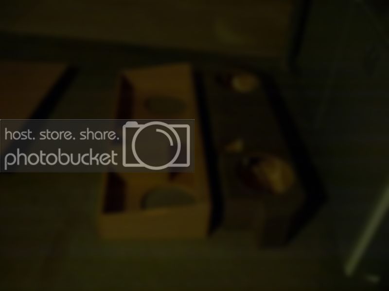

here is a side by side comparison to a box that ive been running that is up fire. New one is obviously down fire.
Next is to test then if all sounds well, then carpet! //content.invisioncic.com/y282845/emoticons/thumbsup.gif.3287b36ca96645a13a43aff531f37f02.gif
I sure hope so, i am swapping to Fi SSD from two W6v2, i want more SPL now! i was able to get much more air space going down fire!
thanks for the complements guys! //content.invisioncic.com/y282845/emoticons/biggrin.gif.d71a5d36fcbab170f2364c9f2e3946cb.gif

how do you get the subs to not hit the bottom of the floor? Add a spacer? but dont see anything like that
yes there will be a spacer/legs hold the box up. it has about 2.75" of clearance from the floor. may bot sound like much but there is another guy running the same subs in this setup!
