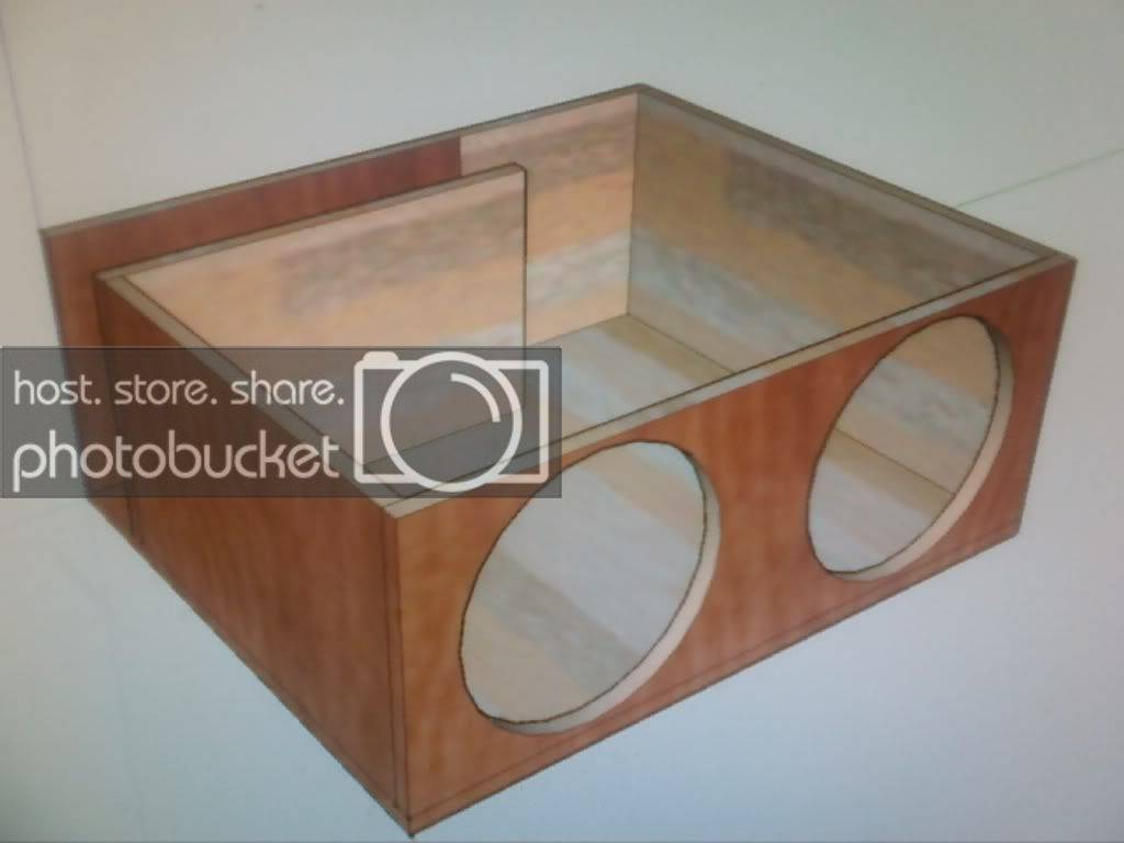

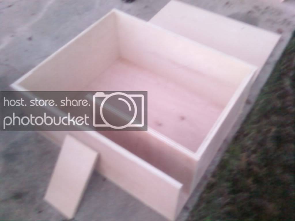

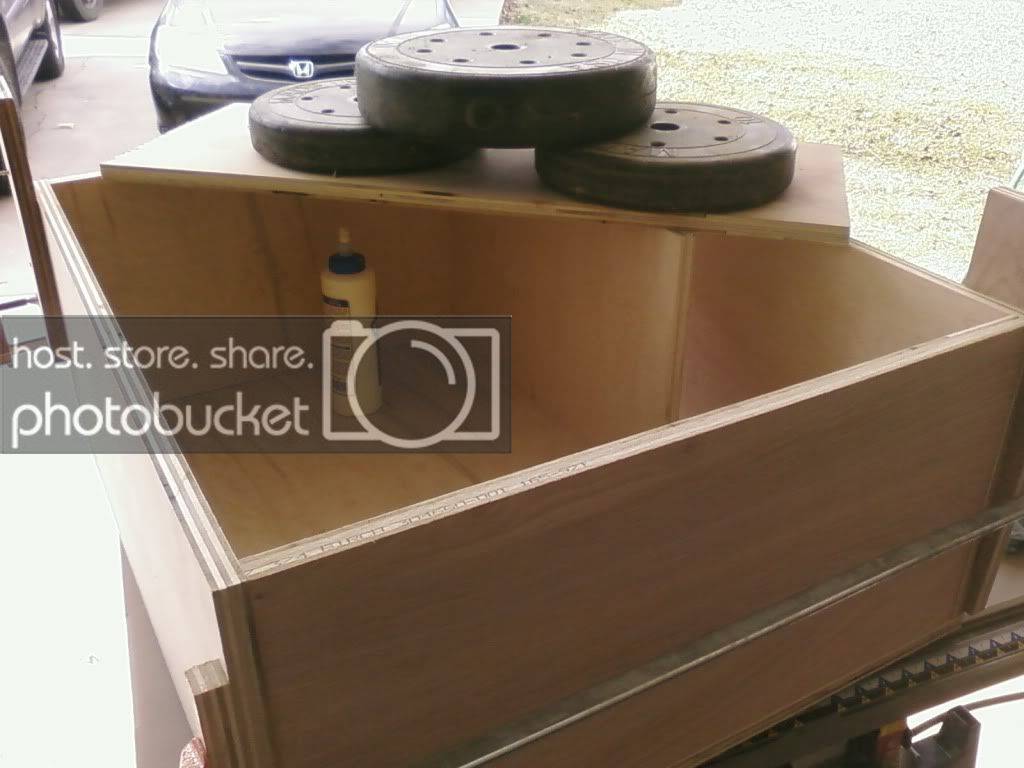

This is the box i'm building for tstephens11 on here. It's 3.8 cubes net, with 46 sq inches of port tuned to 35hz. Material is 3/4" birch ply and its going to be stained with a cherry color. Should be sexy when it's finished. Sorry in advance for the blurry pics, they were taken with a phone.
The sketchup

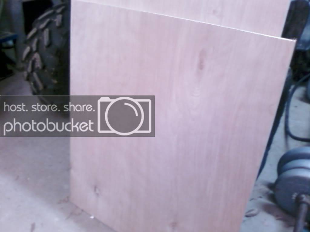

The wood. I love working with this stuff, and it looks great

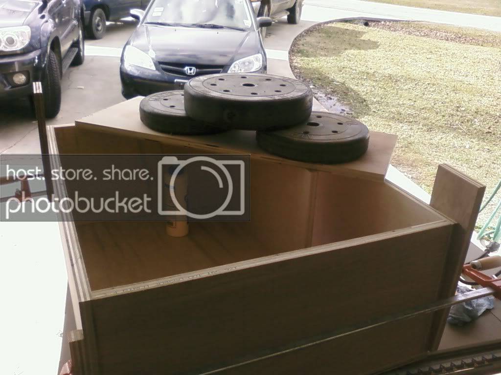

Putting it together

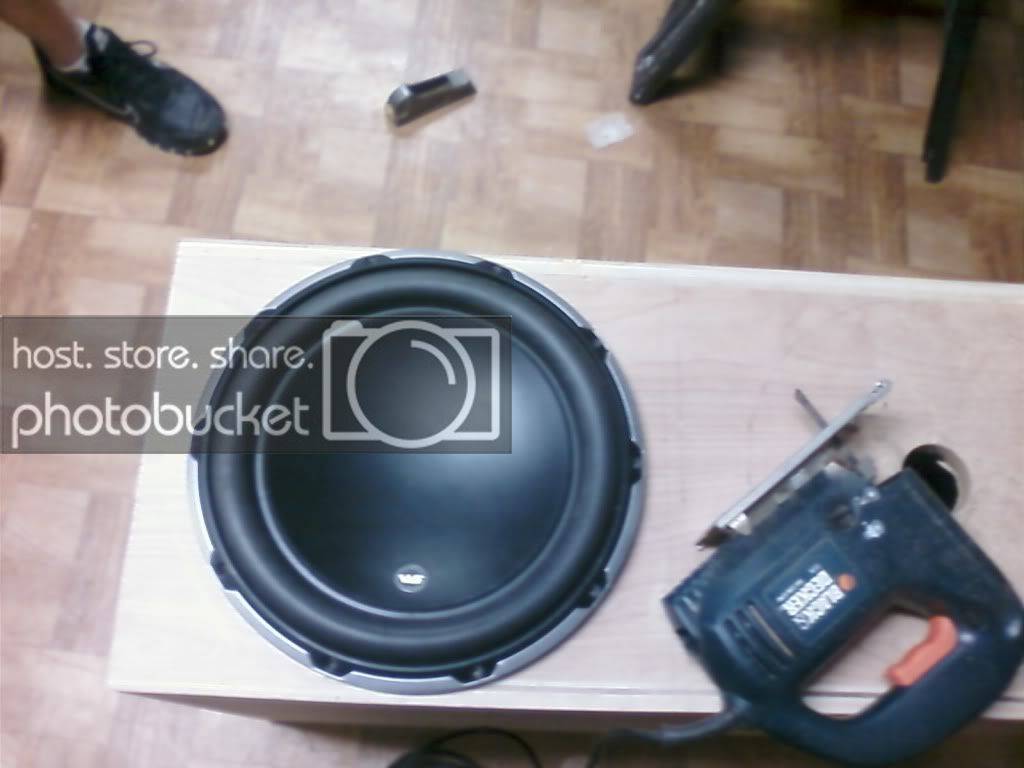

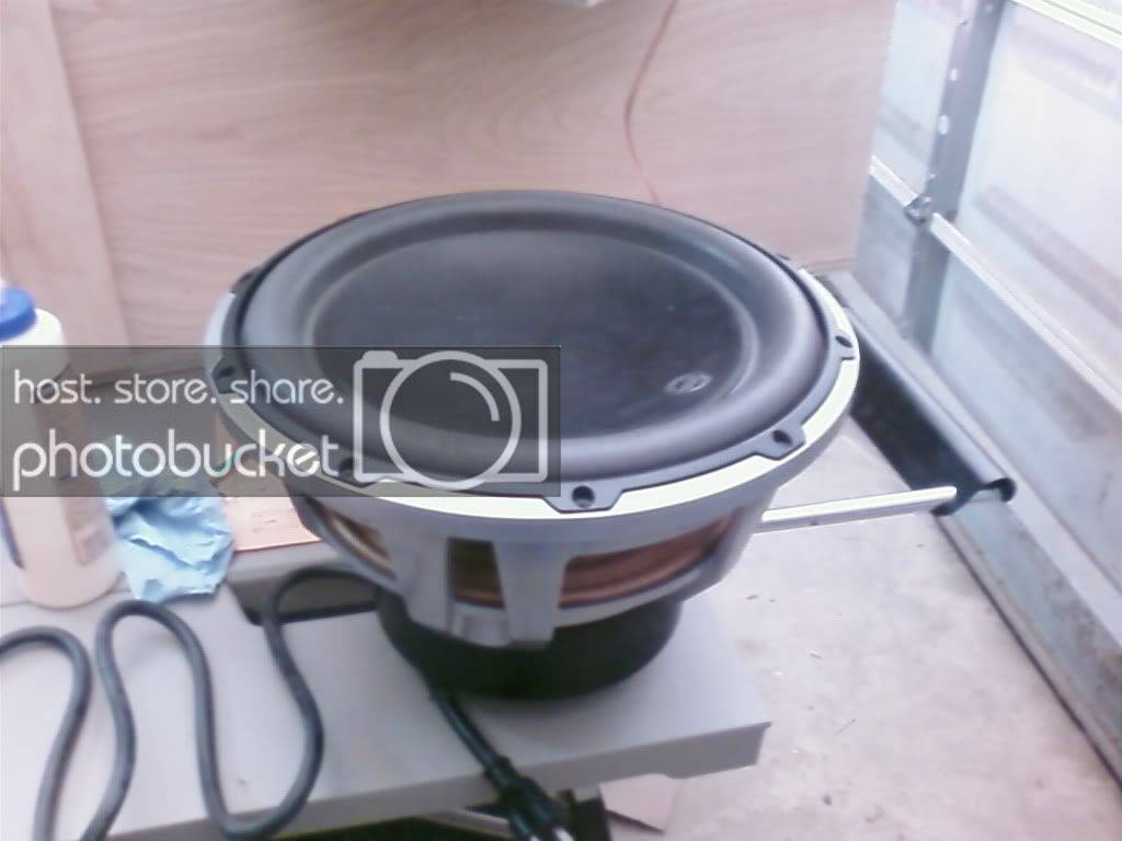

2 of these will be going in it

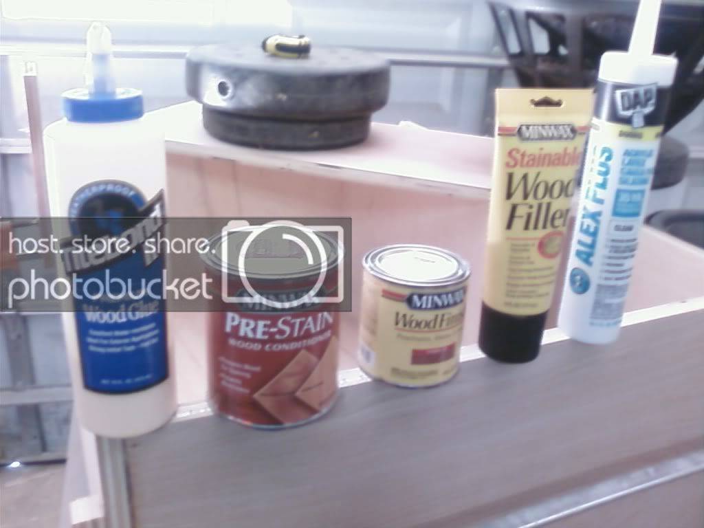

Some goodies

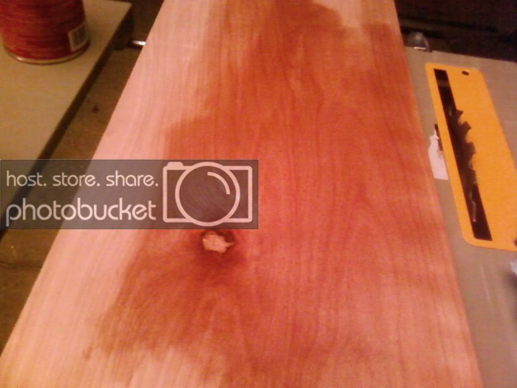

Trying out the stain on a piece of scrap

I should be finished with this thing tomorrow, just have to caulk the inside, throw some bracing and the top piece on, then comes the sanding and the staining. More pics tomorrow
$40 a sheet compared to $25 for mdf around here
60 bucks a sheet here for birch ply //content.invisioncic.com/y282845/emoticons/crap.gif.7f4dd41e3e9b23fbd170a1ee6f65cecc.gif
Living in a small town sucks...

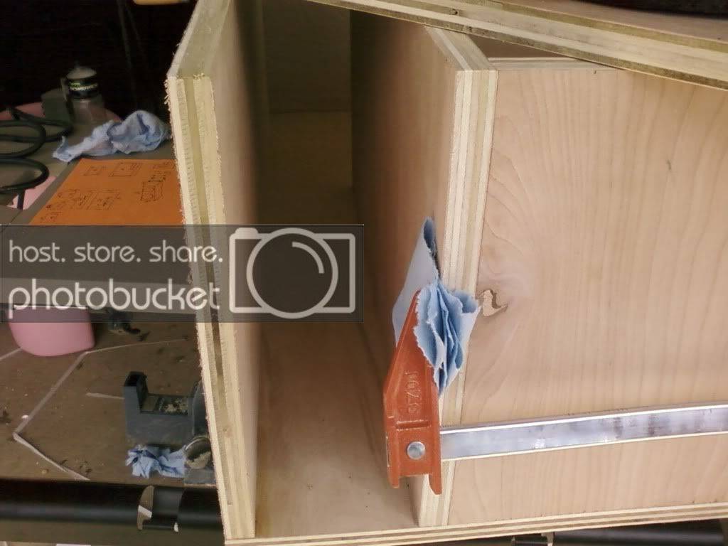

got some bracing in
Caulked and sprayed the corners to seal it up, and painted the port

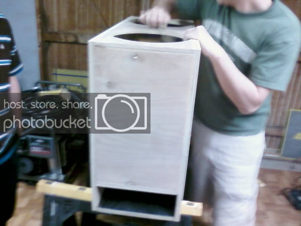

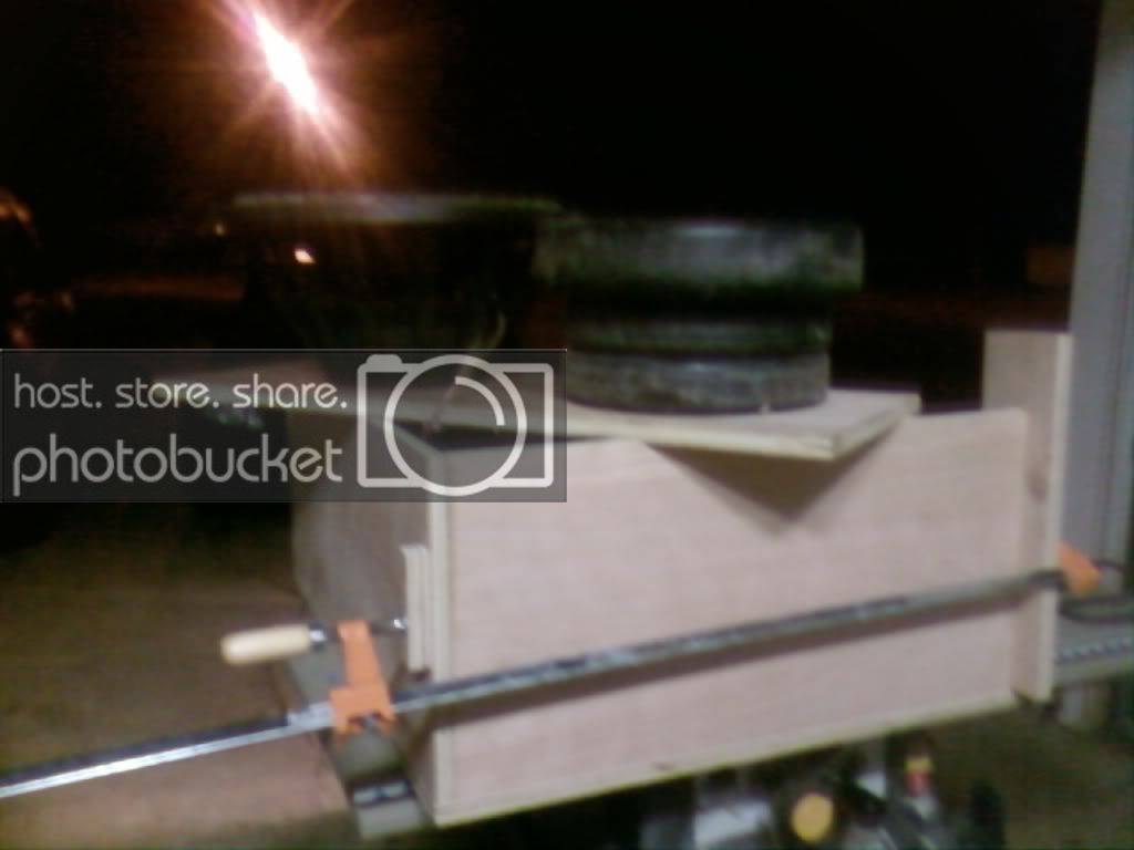

Putting the top on
Sanding it down. I had to go pick up a couch at this stage, so tstephens11 handled it on his own, and it came out nicely

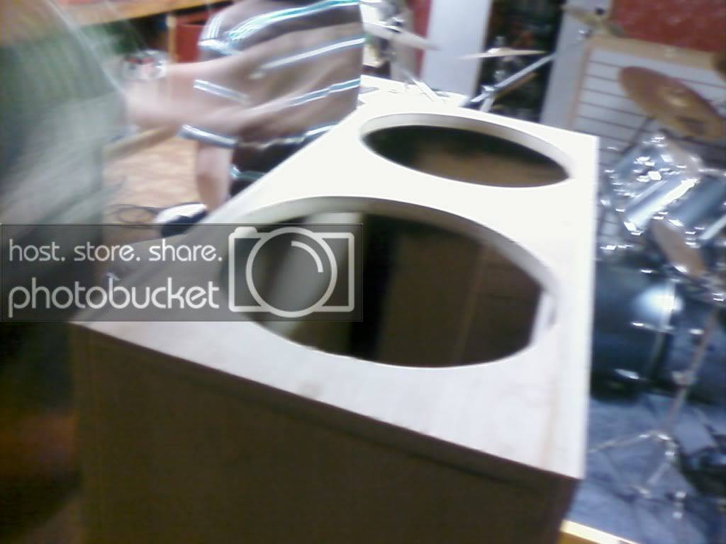

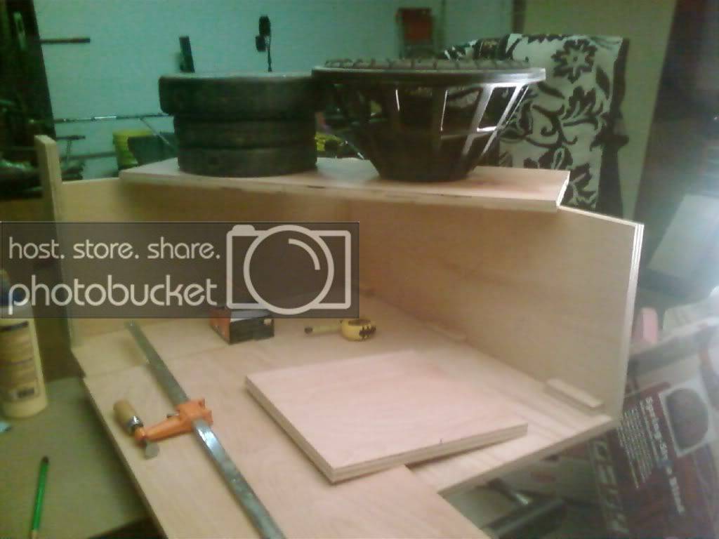

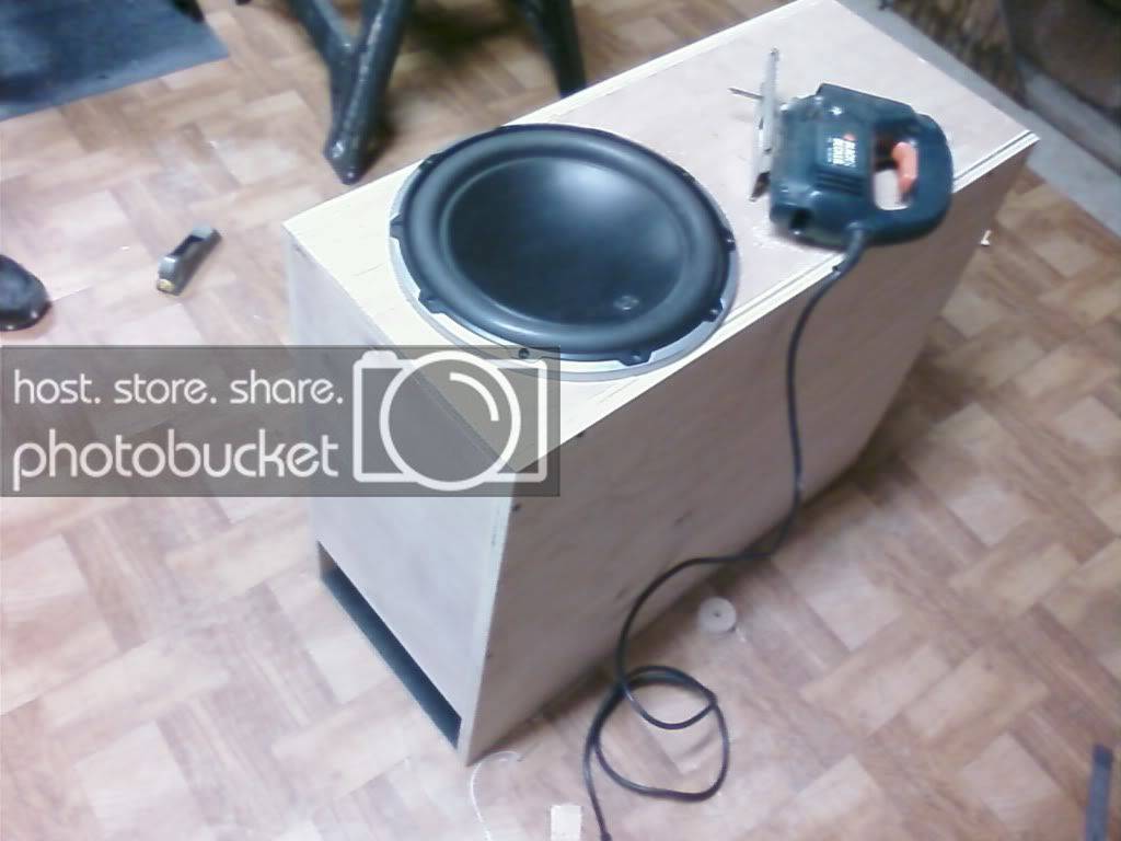

I got back in time to cut the holes for the subs
Everything is done except painting the top of the port and staining the box. The pics don't do it justice, it looks awesome in person. Should have pics of it finished tonight and maybe a vid
