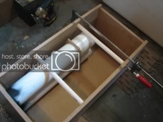

All the sides put up already, except the top. made a brace for the ends of the pvc aero's.

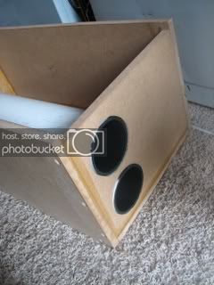

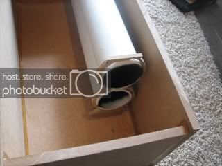

Another shot, they're 2' long, so I have rougly 30-32hz, using PSP's port calculator
Painted the aero's flat black (In the pics it's not finished yet, but they are now.)
Bracing, it was hard to brace front to back because of the ports, but I guess these will have to suffice where they are, because I ran out of the dowel rods anyways.

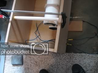

Got the wires in, and made some disconnects incase I need to remove the box and not have to dig for an allen wrench for the amp screws. (The ends on the inside of the PVC ports are all painted now, completely inside but not outside)

Just so you know, those are not aero ports. Those are round PVC ports and they don't have the benefit that aero ports have because the ends are not flared.
Ok. I knew they didnt have the benefit as being flared, but I though they were the same basically. Thanks for the info though.

i can't see routering 1/8" (if that) off of a pvc to make "a flare" is going to help... its gonna have little to no effect
I know, I asked though to see about port noise and some said it's hard to work with pvc and some said just go with PSP's ports, but i'm broke and figured i'd try it.
