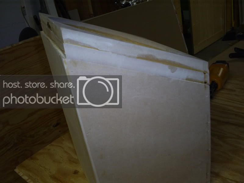

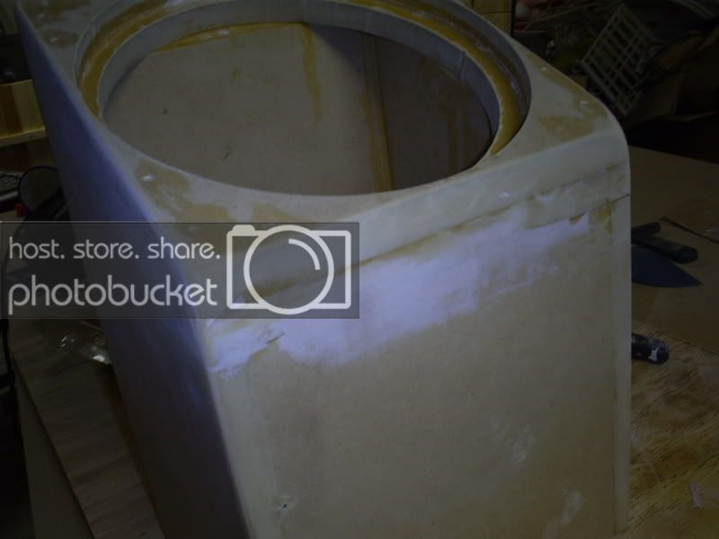

It fits between his two seats and the center console and the back with an angle to make good space. Heres a pic of how terrible it looked before... it was scraps that were about 1/8 to 1/4 short and long in some places...

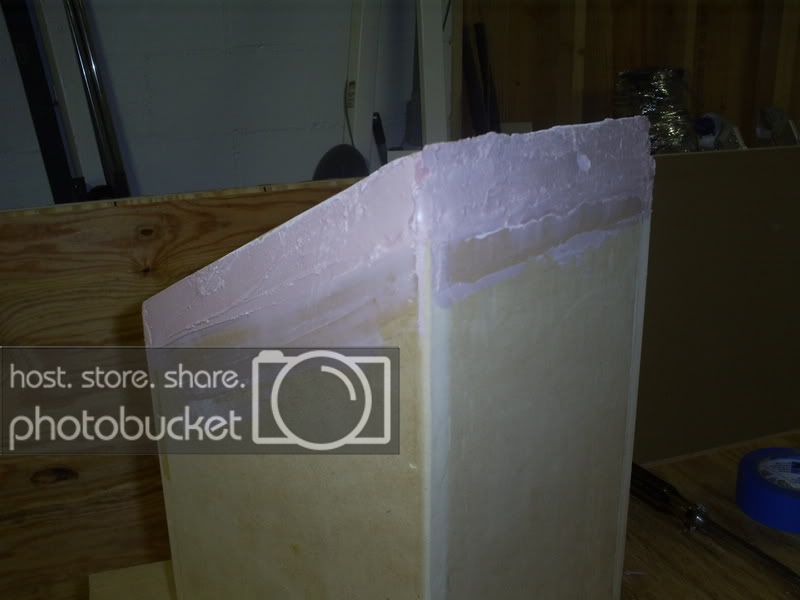

But thank God for bondo...

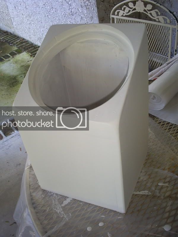

So after a few coats of this stuff and some sanding I got it to look like this.
Here I got it sanded and two coats of latex primer/sealer, brushed it on.

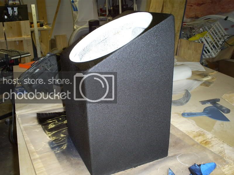

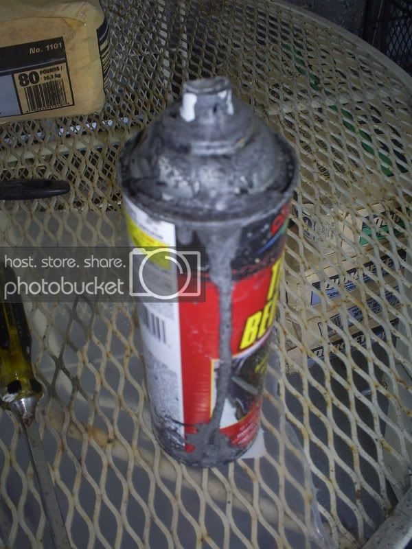

He wanted to use the cheap bedliner from walmart.... I advised him not to, but he wanted to save a few bucks. And look...
the valve broke instantly and began to spew the goop for a few hours till the sun dried it enough to clog... I took the cans to walmart today and got a refund. I got some of the 3M undercoat which is basically the same stuff, and iv used it before with good luck so I gave it a try. And now it looks like this.
It came out really nice IMO. Last thing to do is line the walls with poly fill and put a terminal cup in. Hes ordering the sub friday, so whenever he gets it to me and i put it in, i'll update. Once he gets all his parts in and I put it in, I'll post back for anyone looking at doing a single cab truck. Thanks for looking

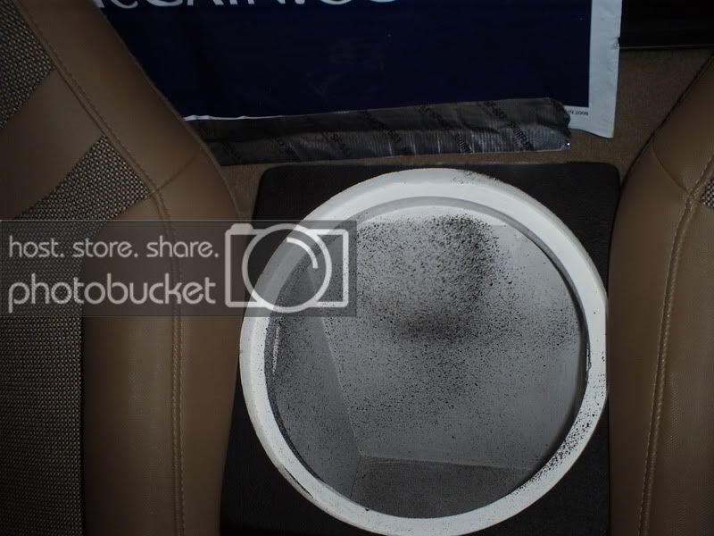

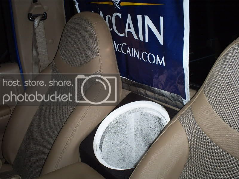

He stopped by tonight to do a test fit... It was meant to fit like a glove, and it was a win. I rounded all the edges and corners to relieve the stress off the seats. These pics are with the seats all the way back, and his seats angled how him and his girlfriend always have it.
It fits great, doesnt move one bit, and hes really happy! More to come in the next week...
