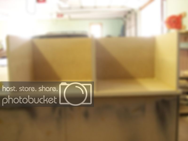

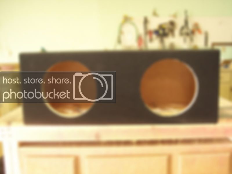

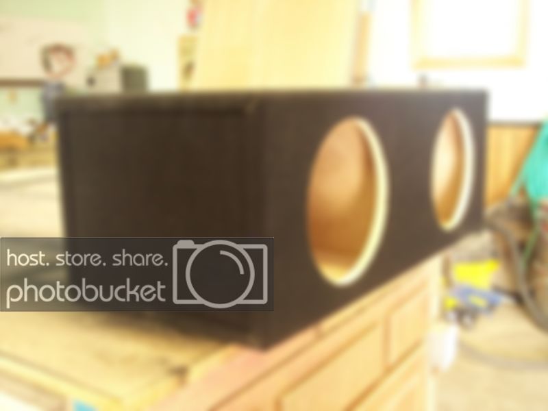

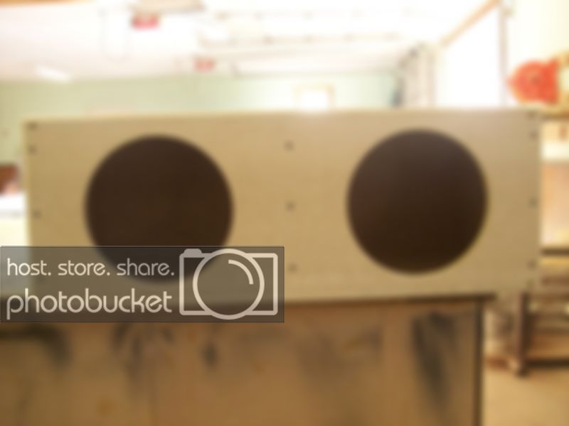

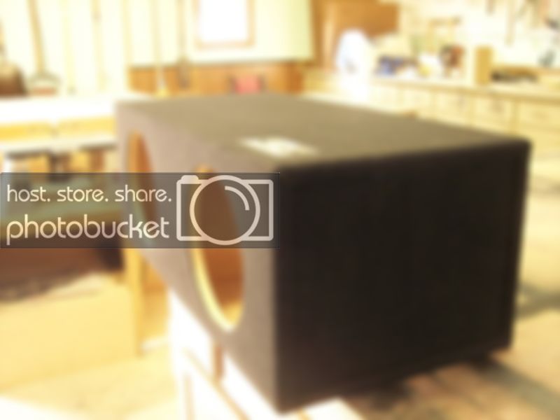

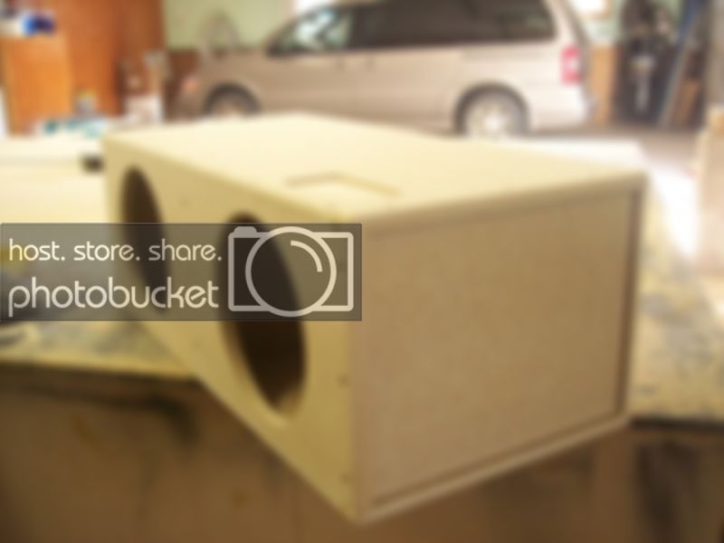

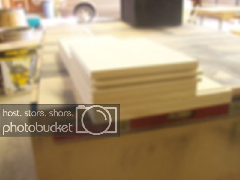

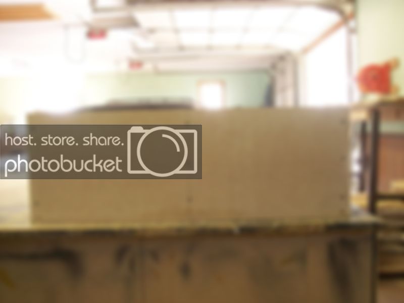

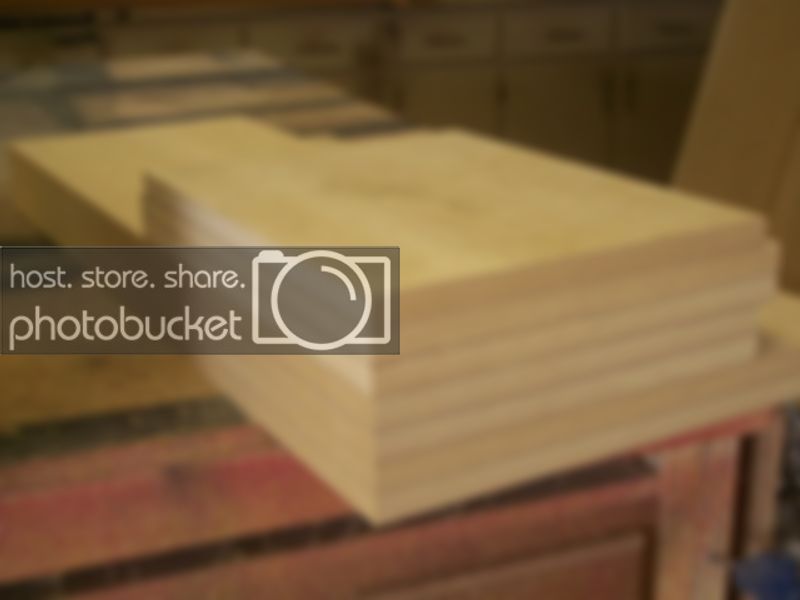

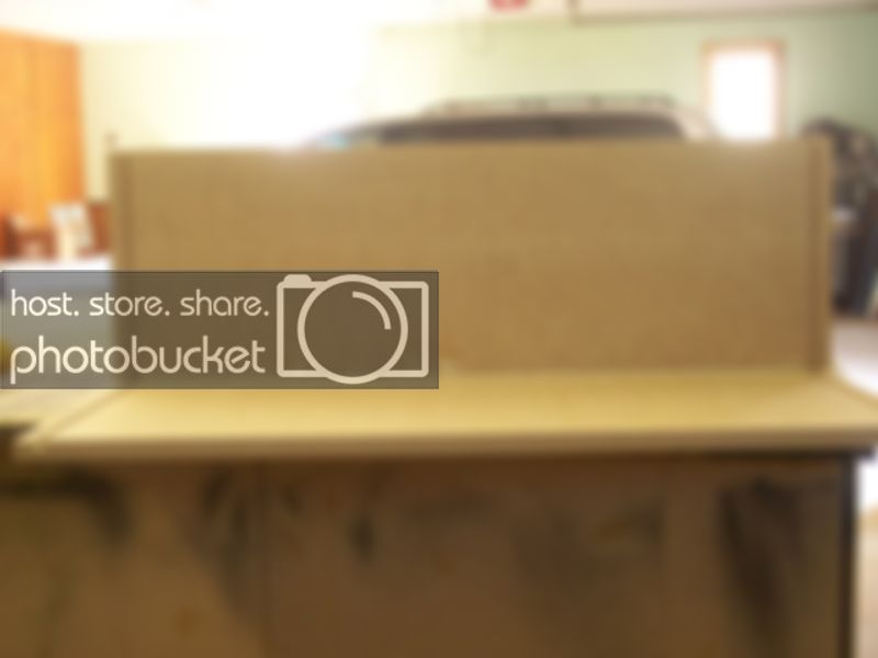

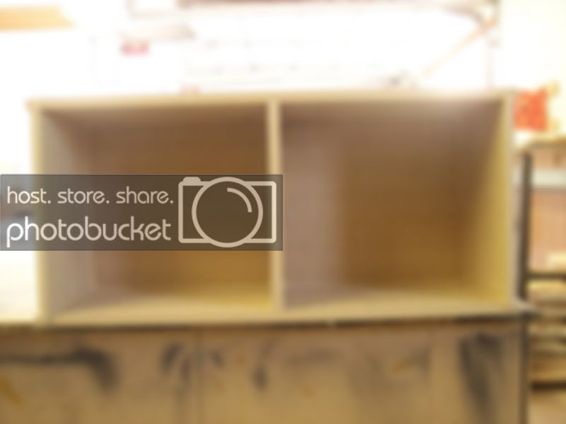

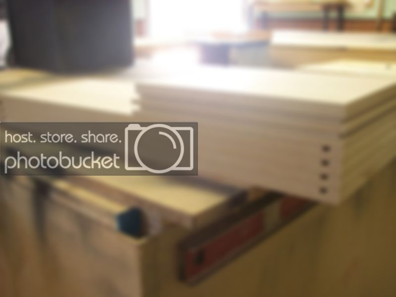

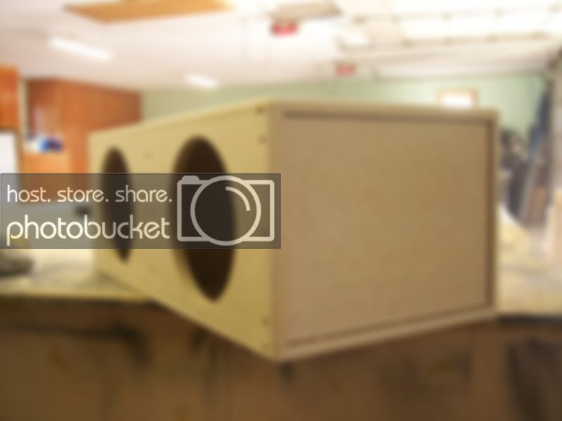

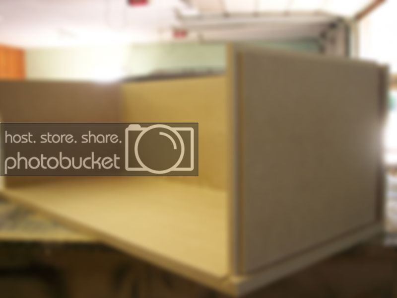

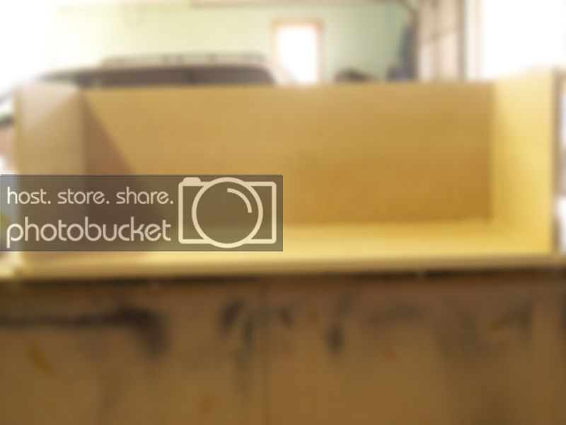

This box is 2.2 cubes NET for a pair of 10" Oz ME's I believe. He wanted separate chambers, rounded over edges, and black carpet. Thats the basic specs... onto the pics...
Nice lookin box. Is that your "brand" on it...
LOL, yep thats by "brand." Its actually a little plexi badge...

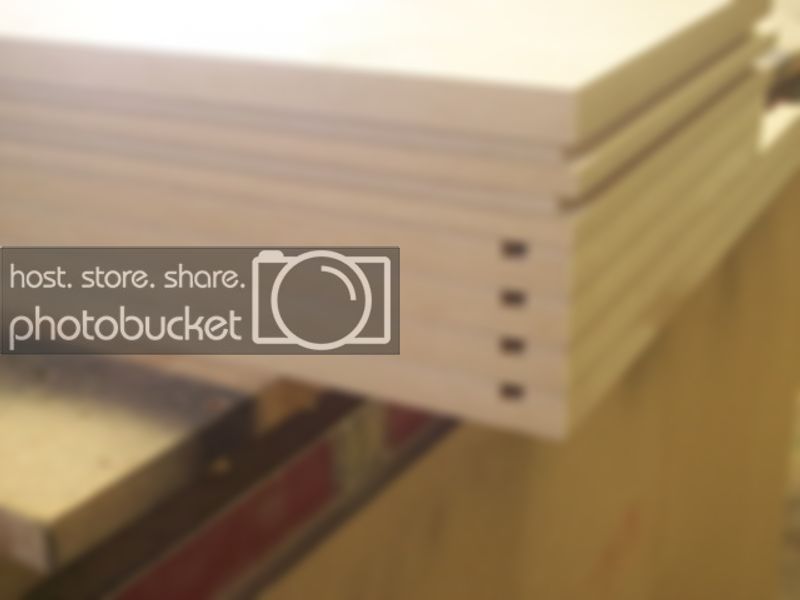

Just wondering, why do you prefer screws over brand nailers ?
seems like it would be so much faster. Cuz in the end its the glue that does the work right?
IMO, screws give a might tighter "hold" while the glue dries. Much like clamps do. But unlike clamps, I dont have to wait until its completely dry to move on. I just feel brads dont provide good enough pressure. Just a personal opinion. I know several people that will argue it to death. But in the end, its just personal preference.
