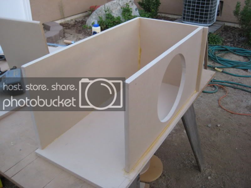

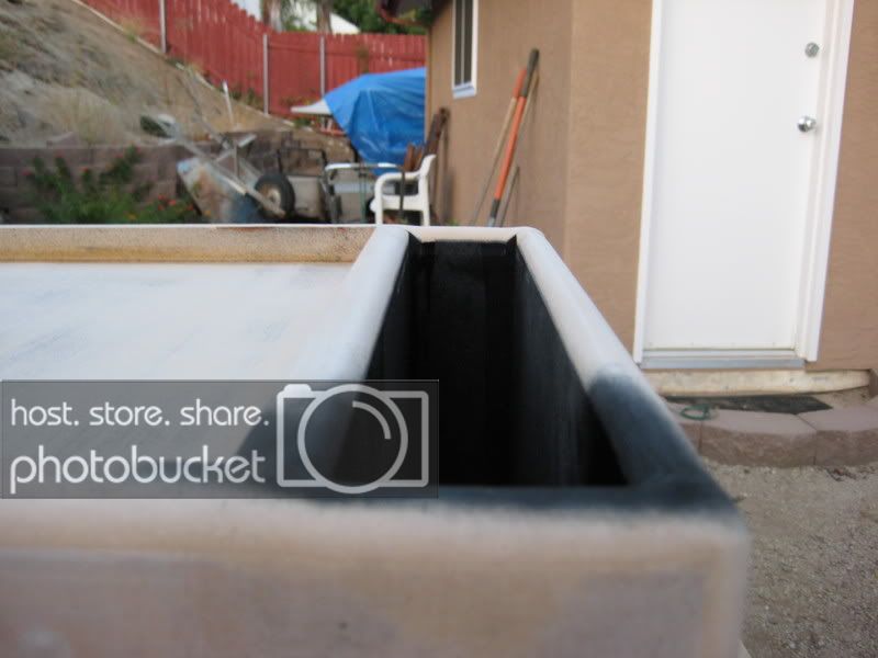

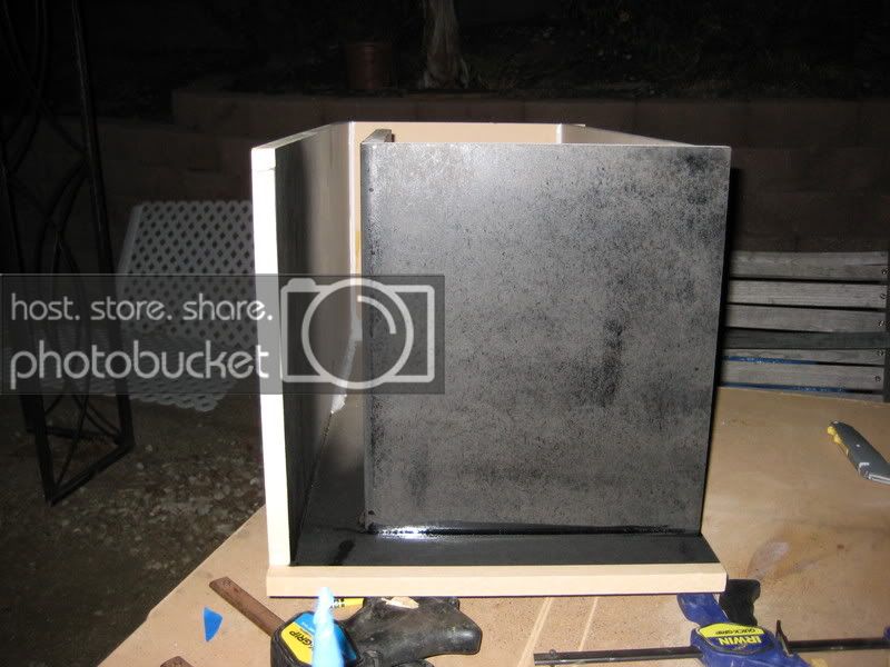

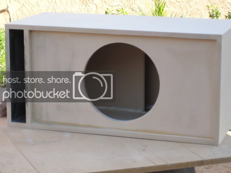

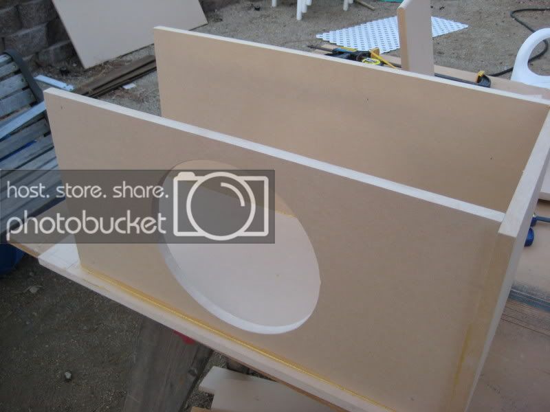

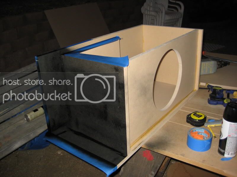

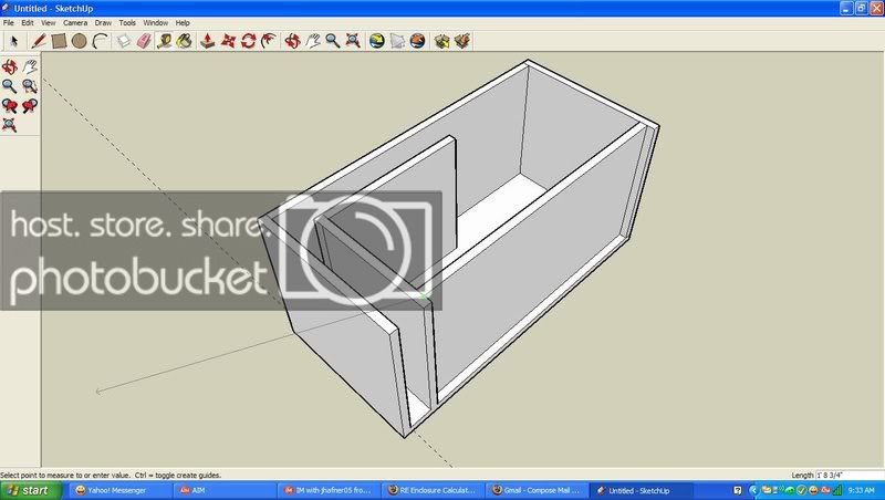

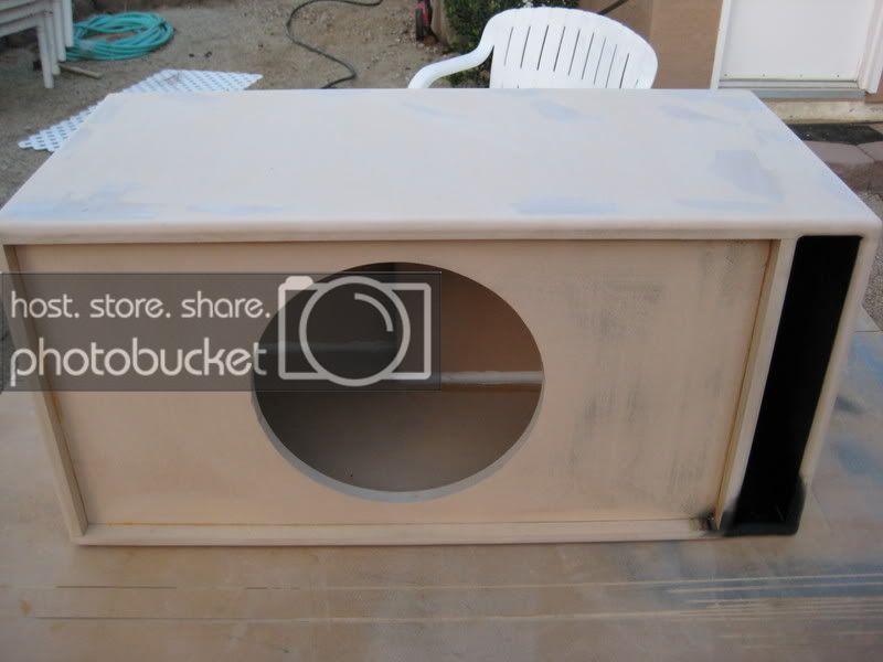

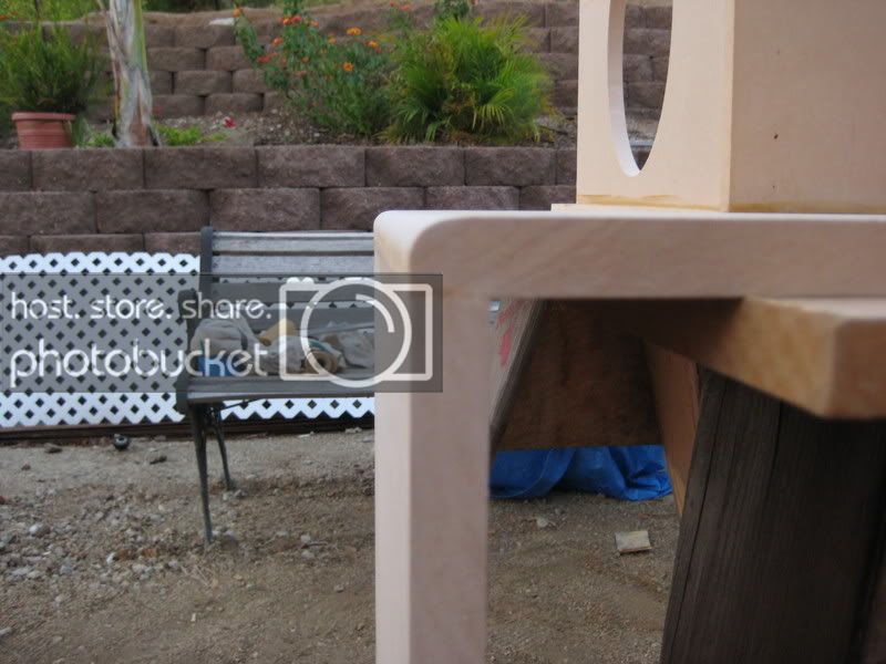

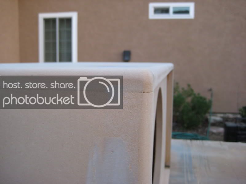

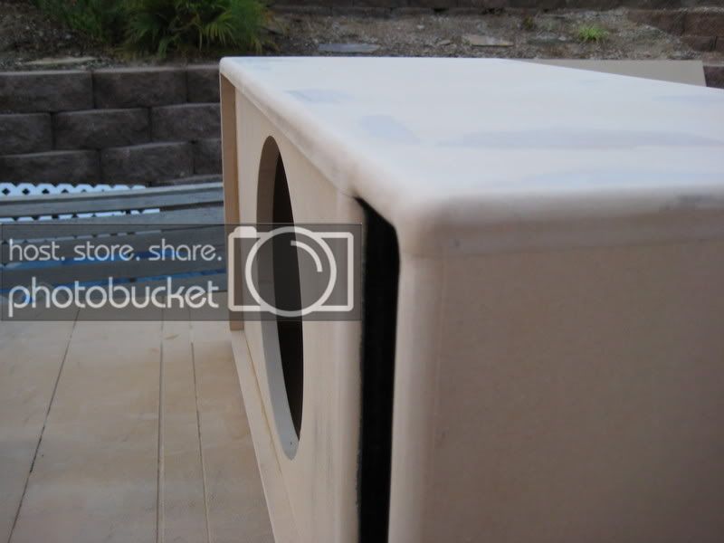

Building an shipping out a box to keviNxL for his 12" Fi Q. Box is 2.2cubes@32hz with 30sq.in. of port area. Another great design by 90accordman. Box will be black fleckstone with a white fleckstone baffle. I stared pics halfway through so thats where it'll start.
