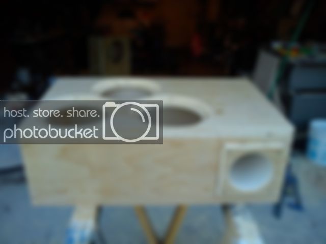

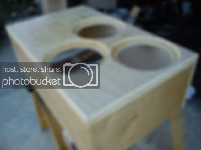

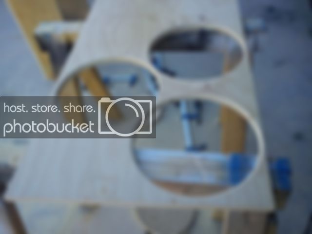

okay have pics //content.invisioncic.com/y282845/emoticons/smile.gif.1ebc41e1811405b213edfc4622c41e27.gif box is 4ft^3 @ 30hz for three skar vvx 10's //content.invisioncic.com/y282845/emoticons/smile.gif.1ebc41e1811405b213edfc4622c41e27.gif enjoi

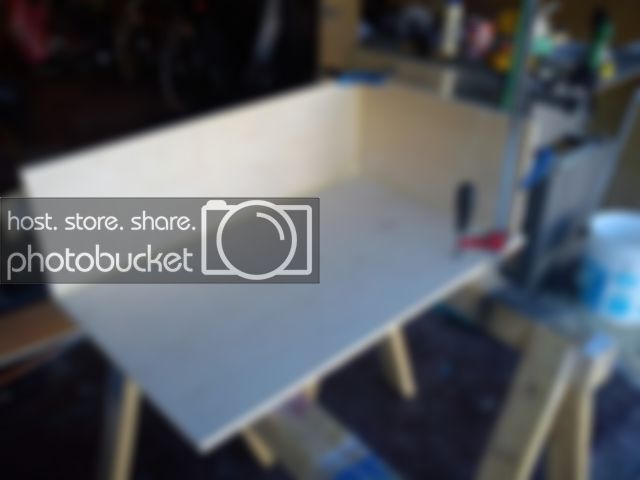

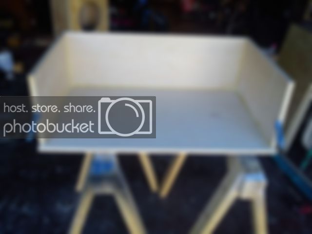

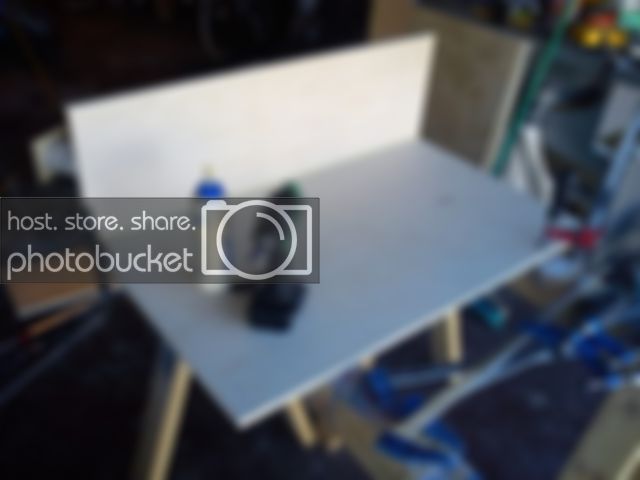

NOTE, there is a reason why it says TOP on the bottom piece, as that is the top. buildign it upside down and attaching the bottom last allows me to hide any and all screws on the top baffle as this box is bare.
more pics in a wee bit when i continue building

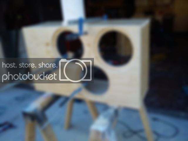

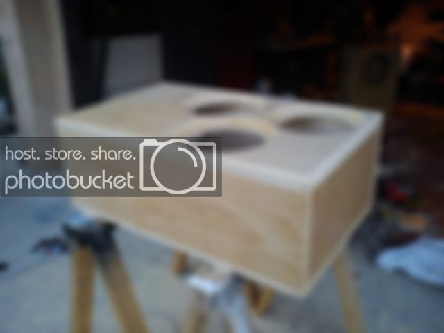

I think so man,.Cut outs on the sub openings look a little close to me.Room to bolt subs down look like they may run into each other.Overall nice so far man
thanks for the concern BUT that piece is the top baffle. i should have noted that. but hey! ITS DONE here are more pics:

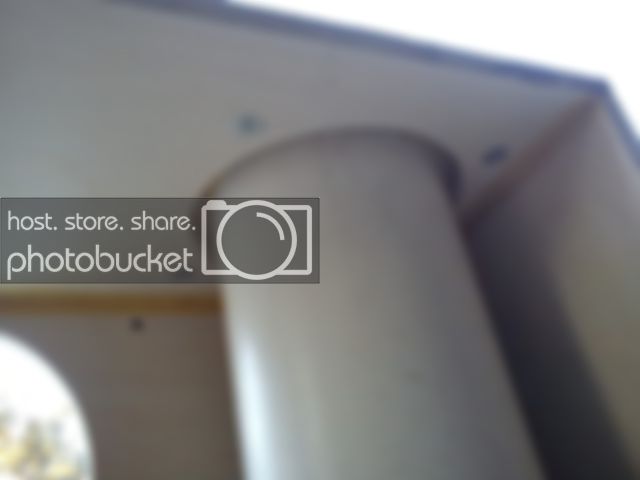

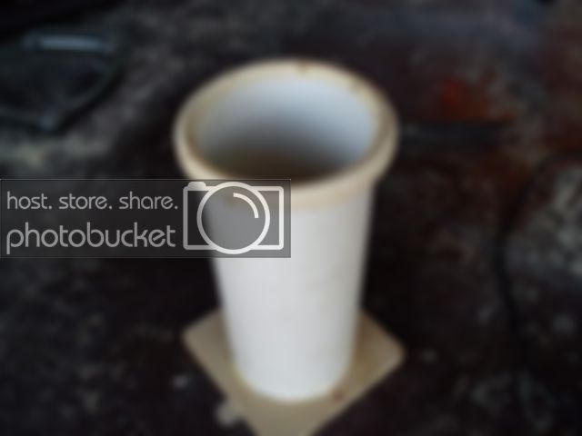

the port
attached with t-nuts, NOTE weather stripping was used on other edge. the port is detachable in which in the future IF he wanted a higher tuning i could make him another port, as in going with different subs/goals

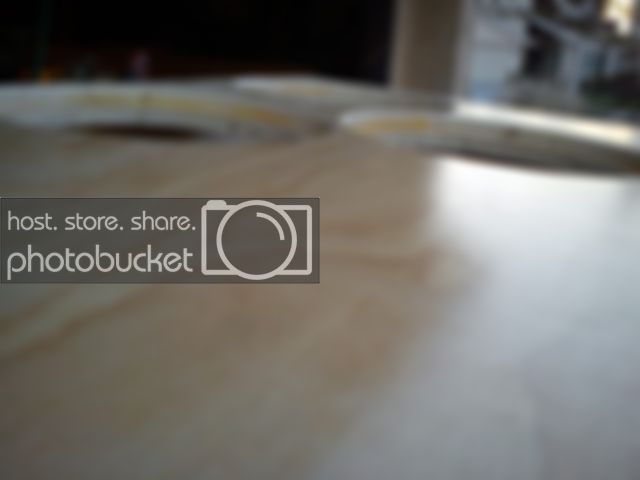

high gloss finish on the wood:
Oh jesus what did you use to gloss that? It looks beautiful //content.invisioncic.com/y282845/emoticons/yumyum.gif.0556df42231b304b9c995aefd13928a8.gif
first, sand with 120, then 400 then 600 then 1000. then lay the gloss lacquer. i mix it up really runny so it doesn't build up and is absorbed in
