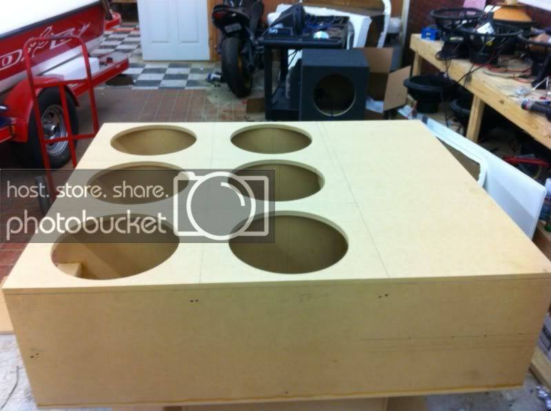

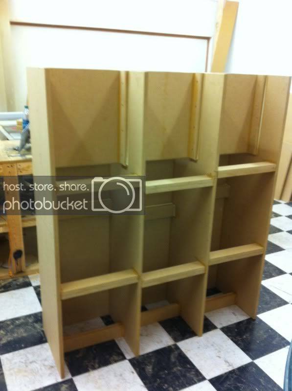

Starting on the box w/ a little bracing.
first baffle on

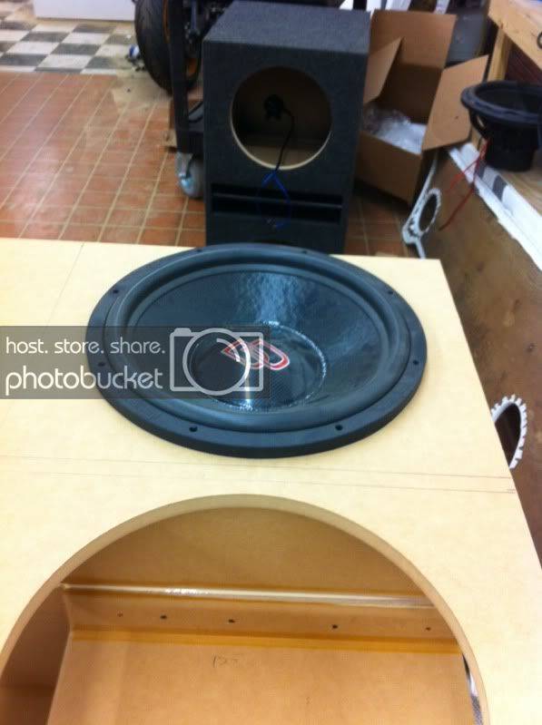

a little test fit

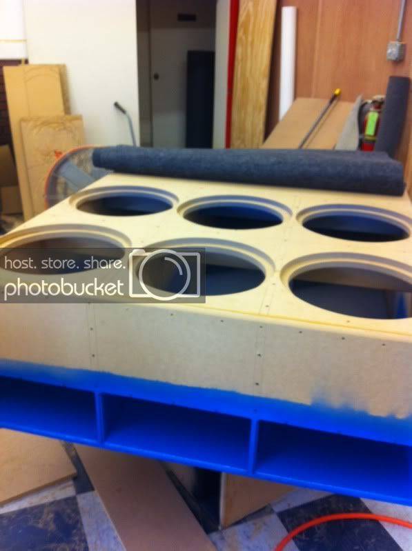

Taz picked out the port color...wanted something a little different

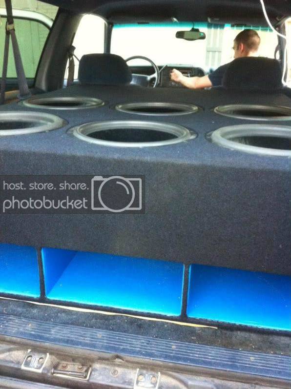

Up and running on 1 DD M2a @ 1.33ohm for now. Taz is going to a pair strapped when he gets his batts.
Even on 1 amp, it seems louder than my 151+ @ 38hz Avalanche. This thing is pretty sick w/ less than 400wrms per sub!
