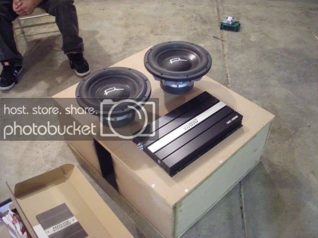

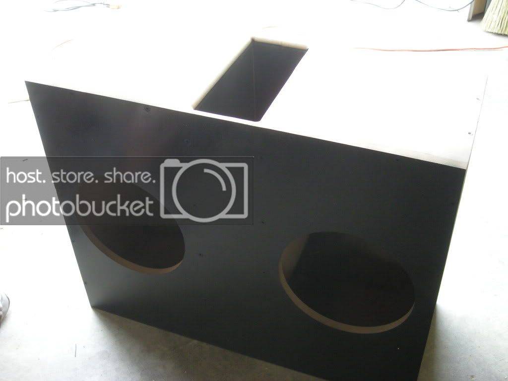

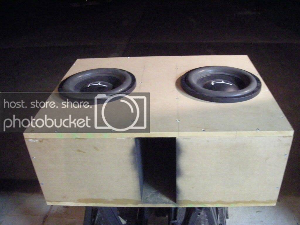

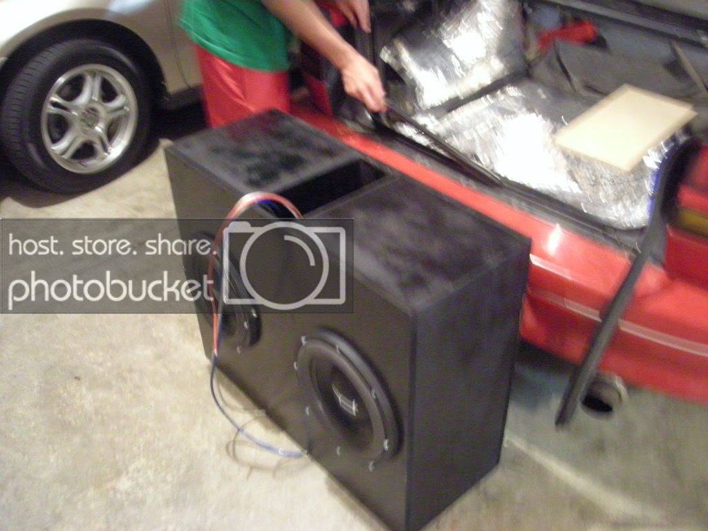

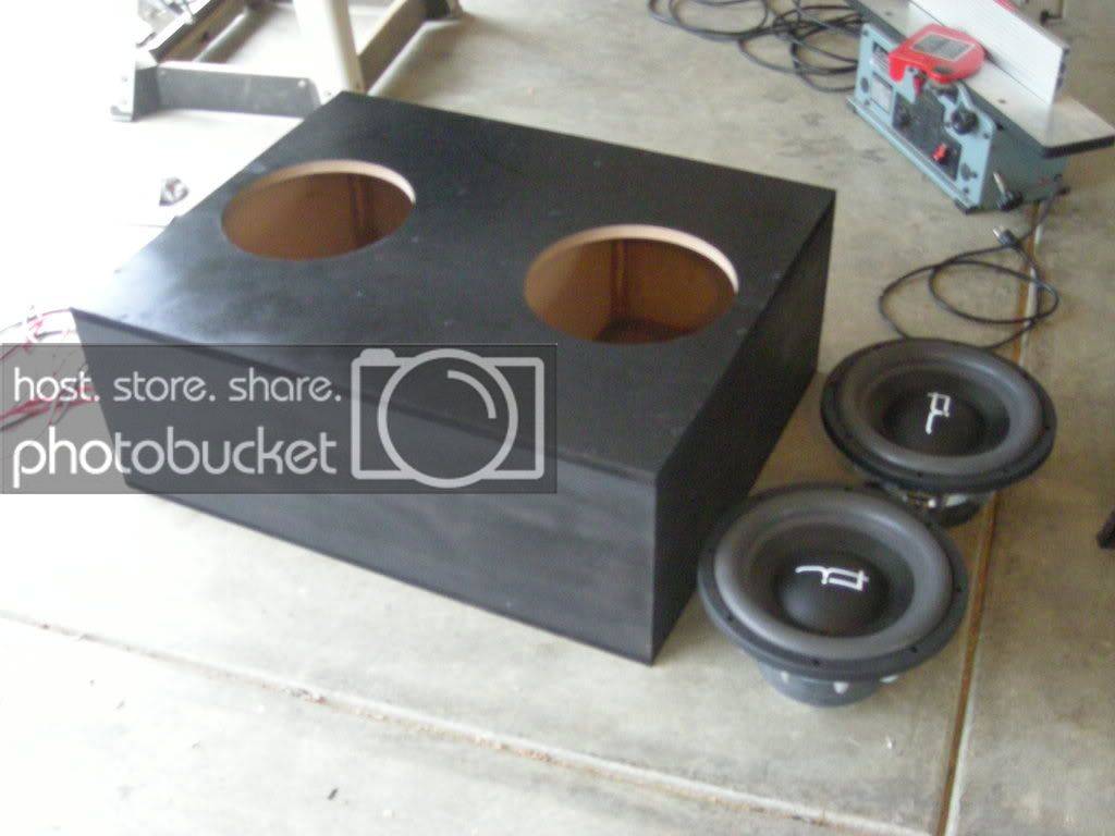

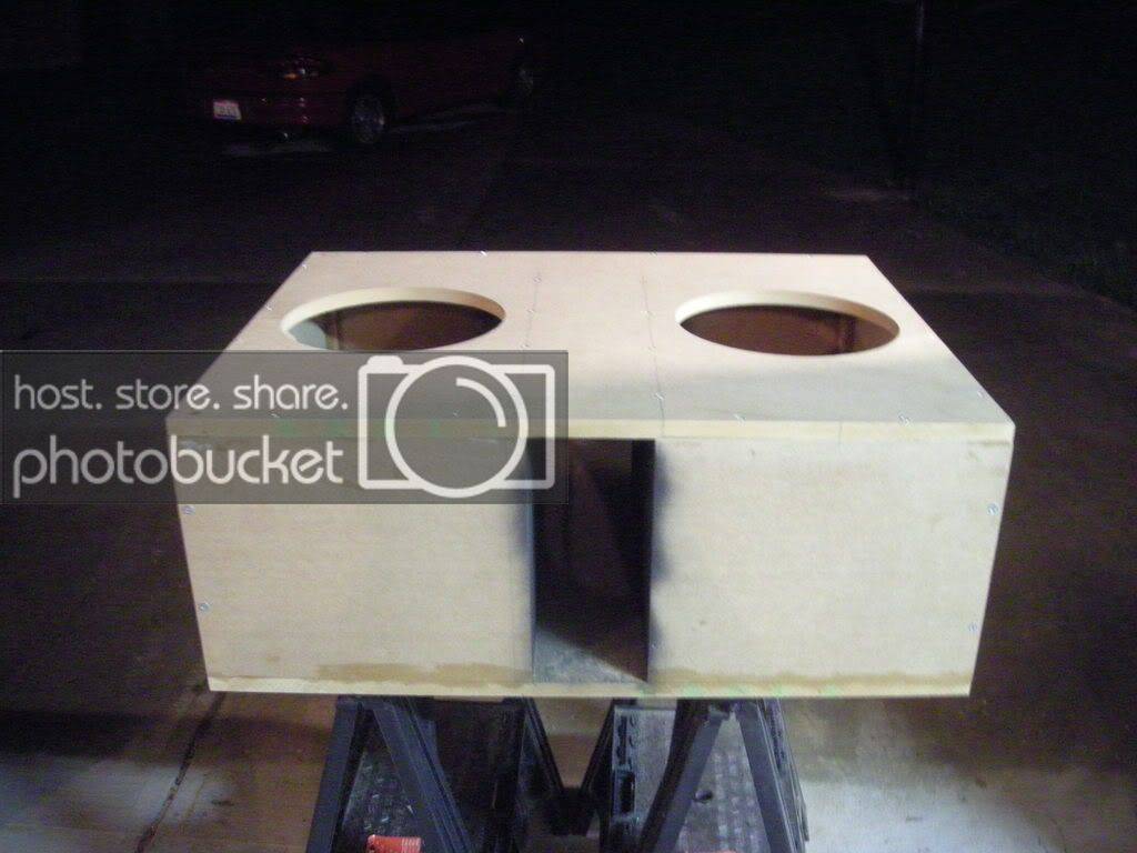

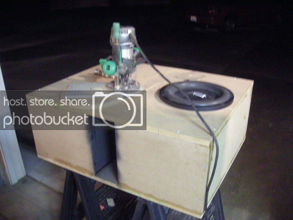

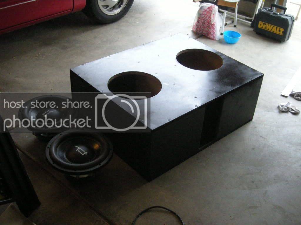

Finished this a couple days ago...isnt too complex but came out great and sounds very solid. Its for a apir of 12" Fi SSD's on a Sundown 1500. It is 2.3 cubes per sub and tuned to 32Hz.

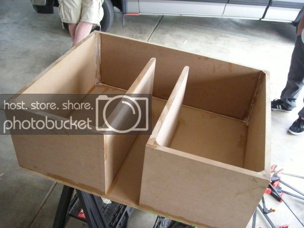

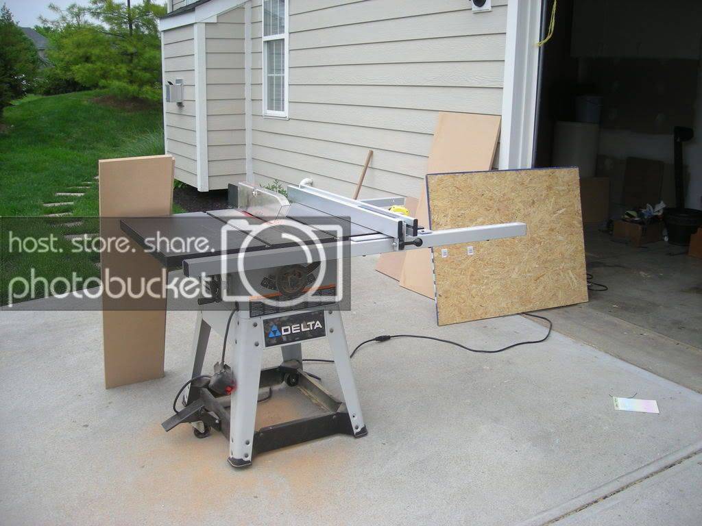

Getting things started

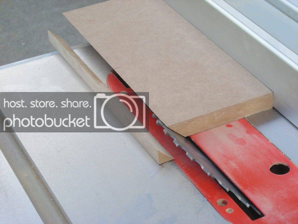

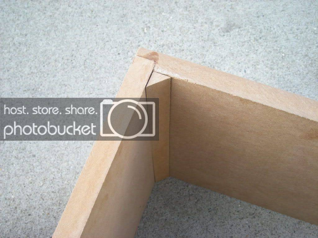

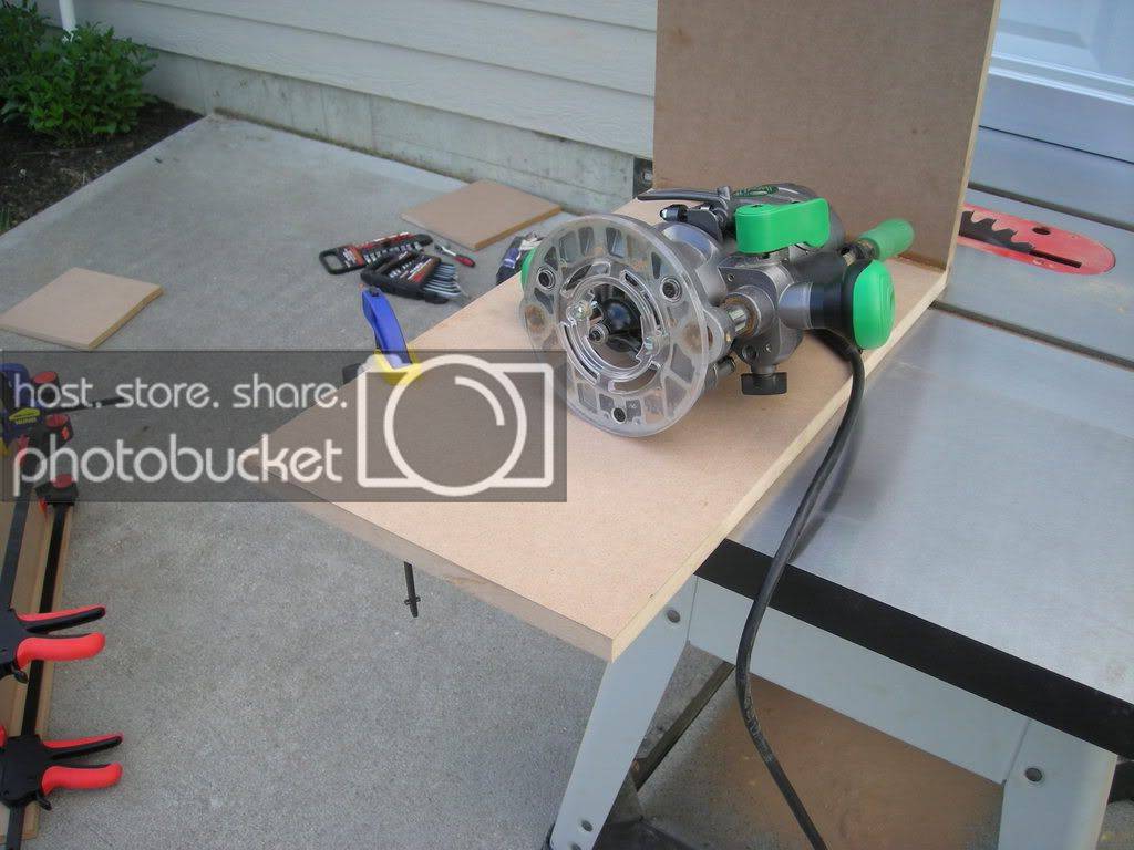

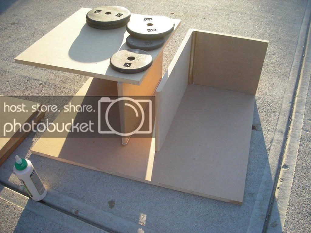

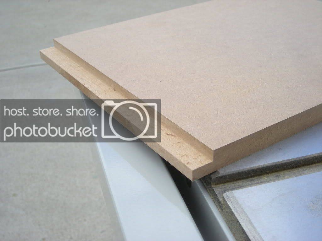

Rabbited corners on the face of port to fit everything together, very strong corners here..

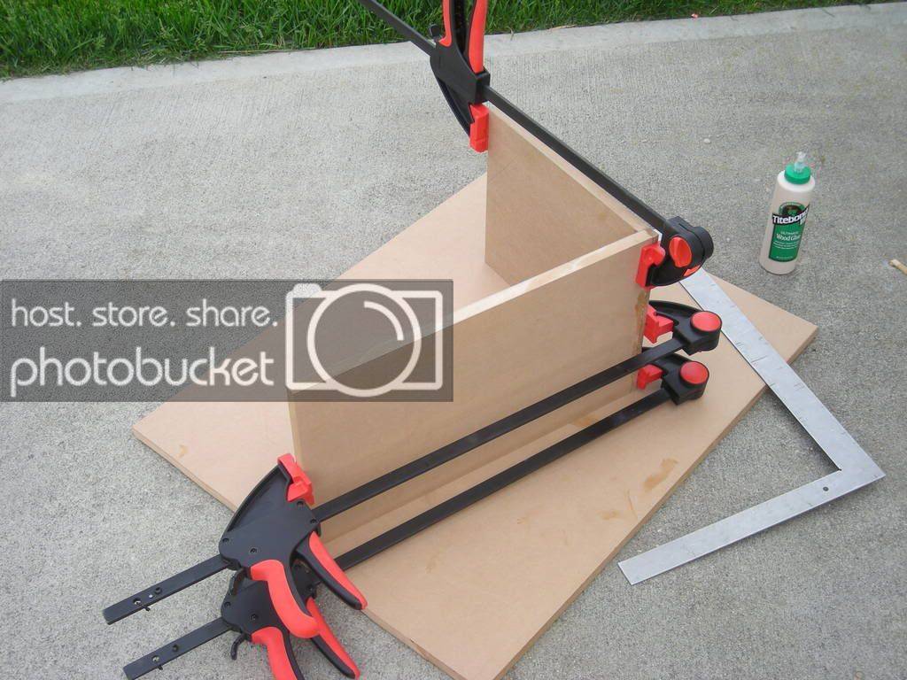

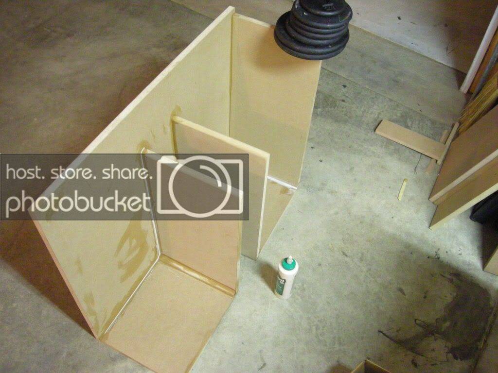

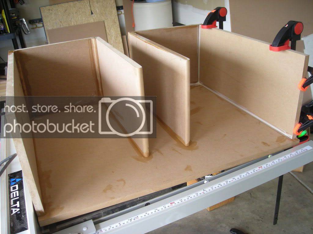

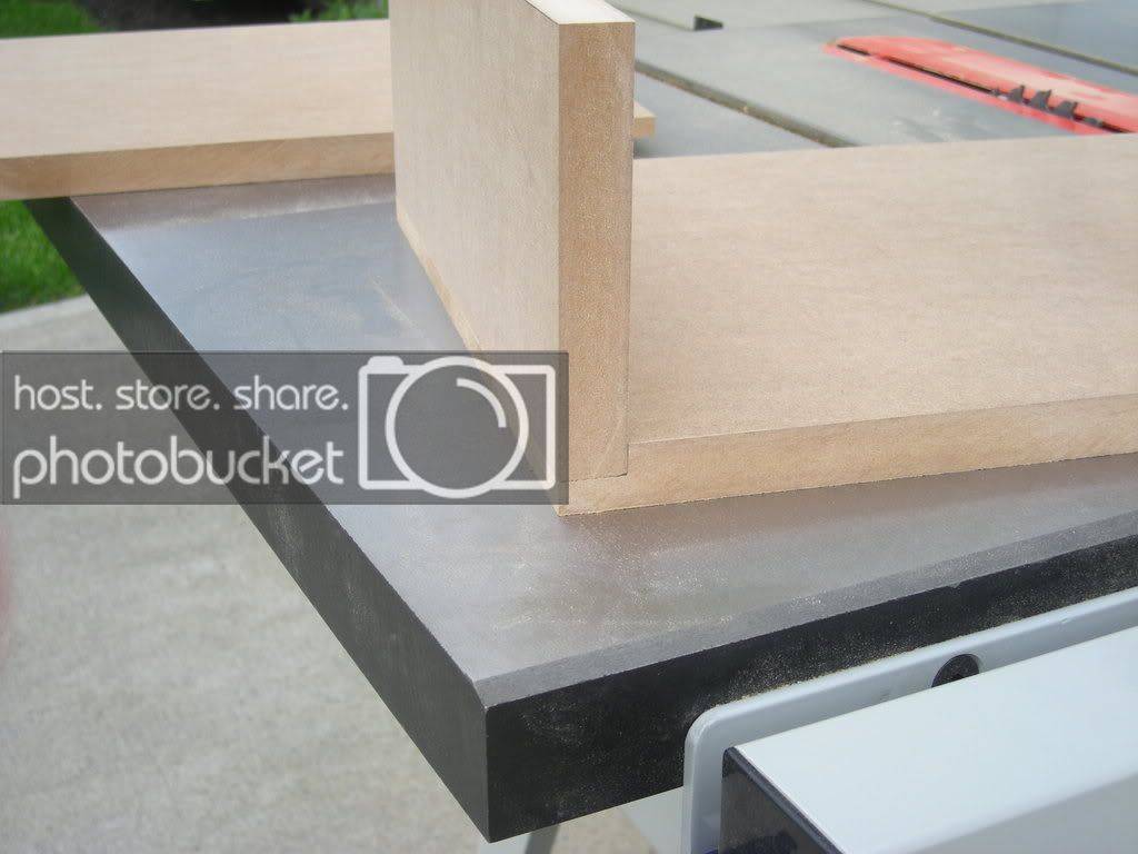

Squaring things up...

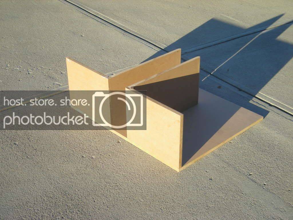

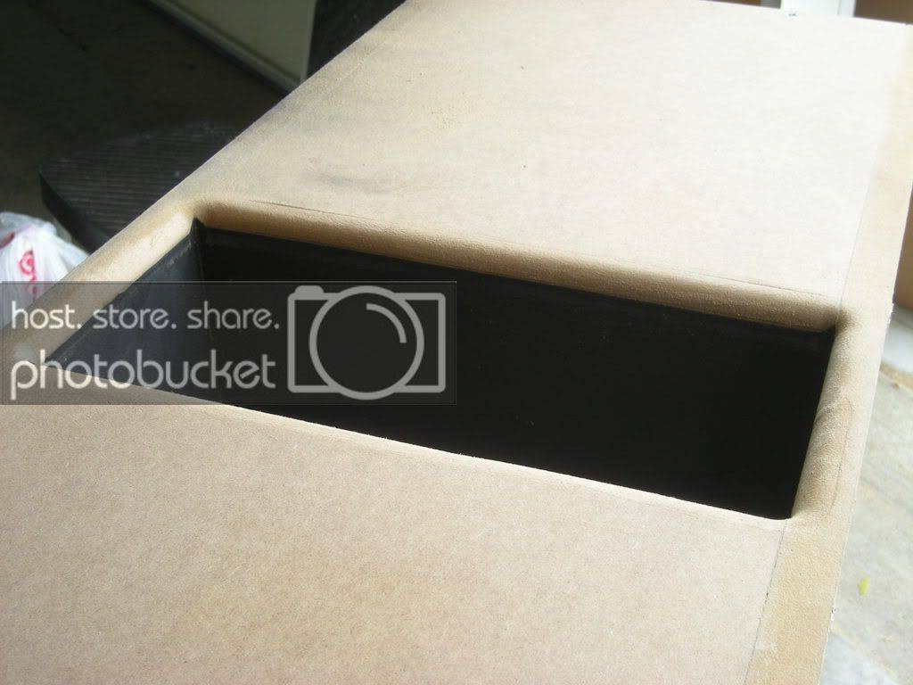

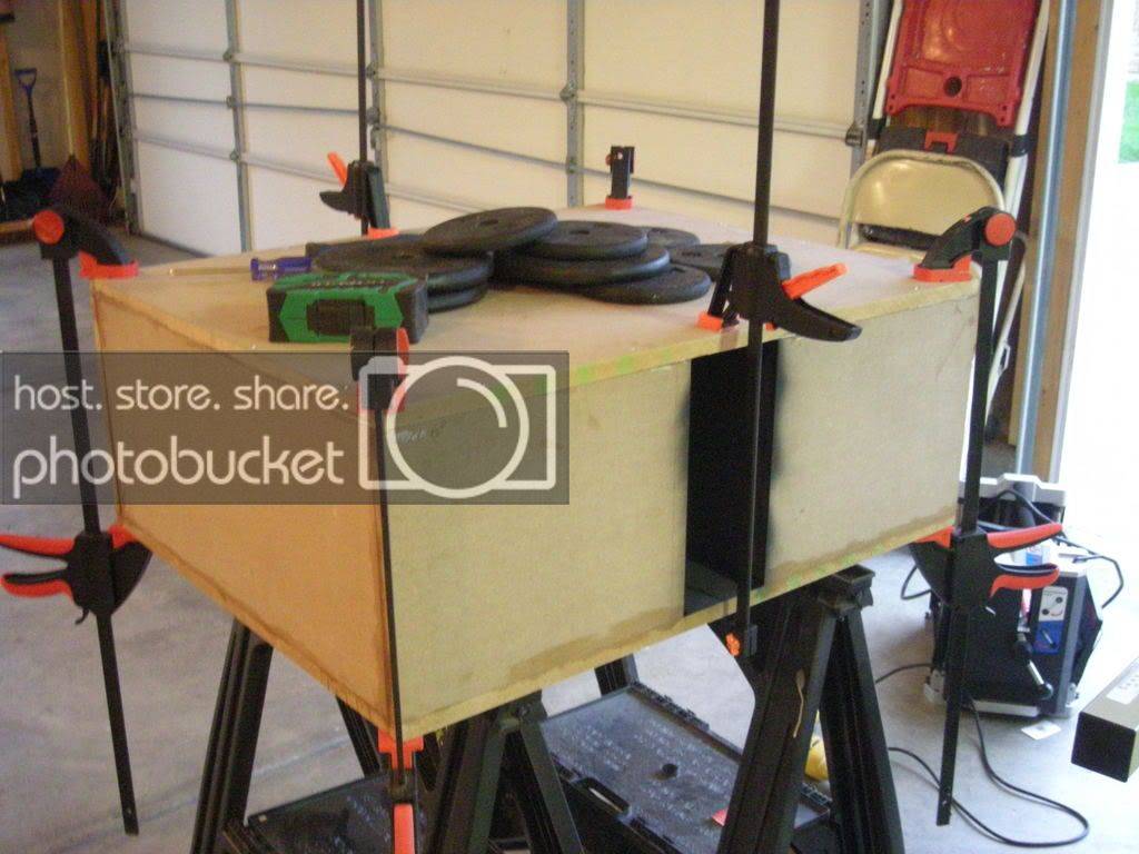

Rounding over port wall endings..

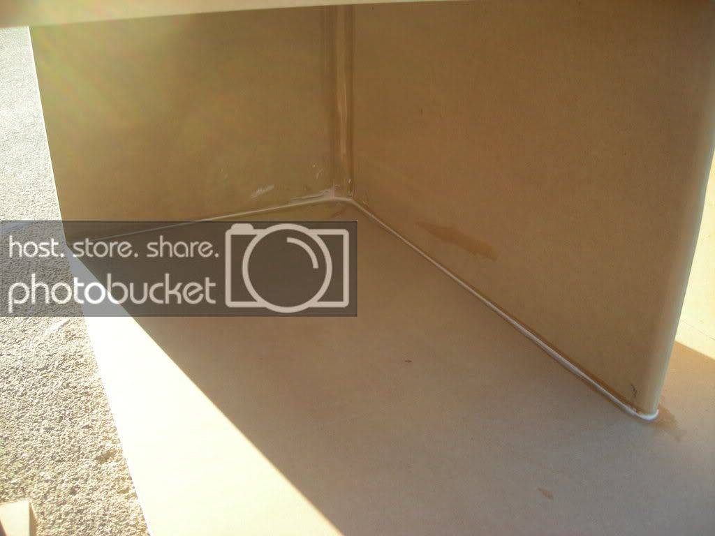

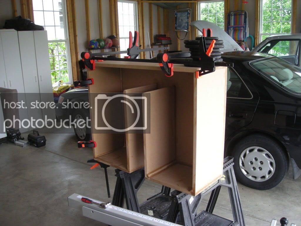

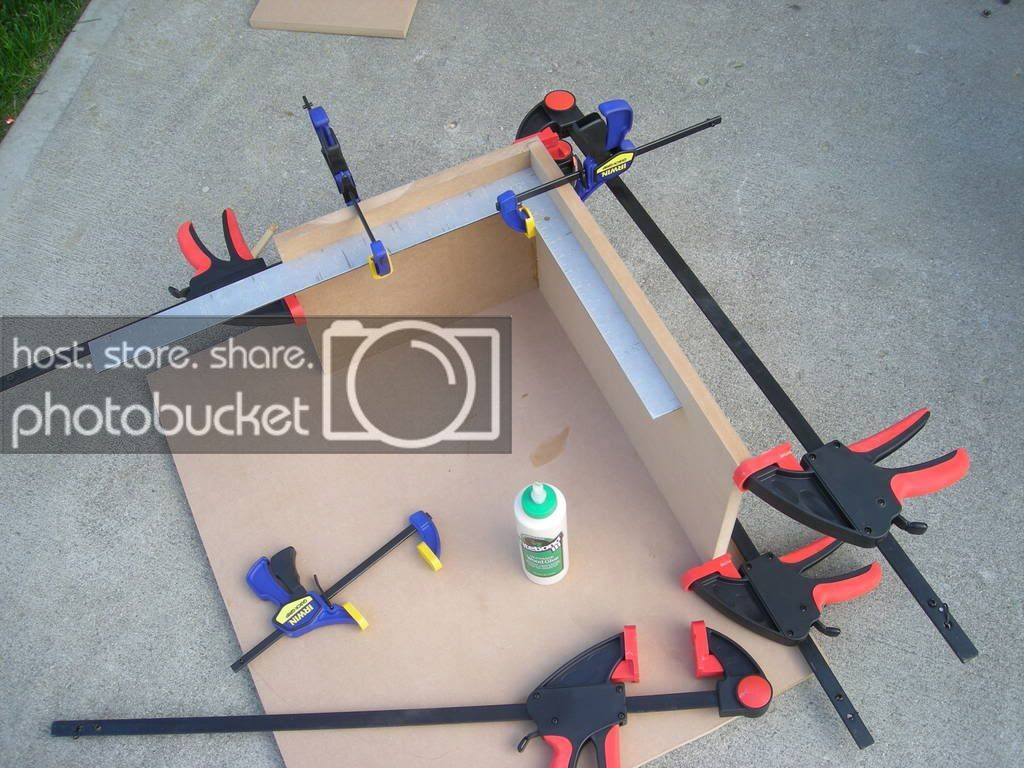

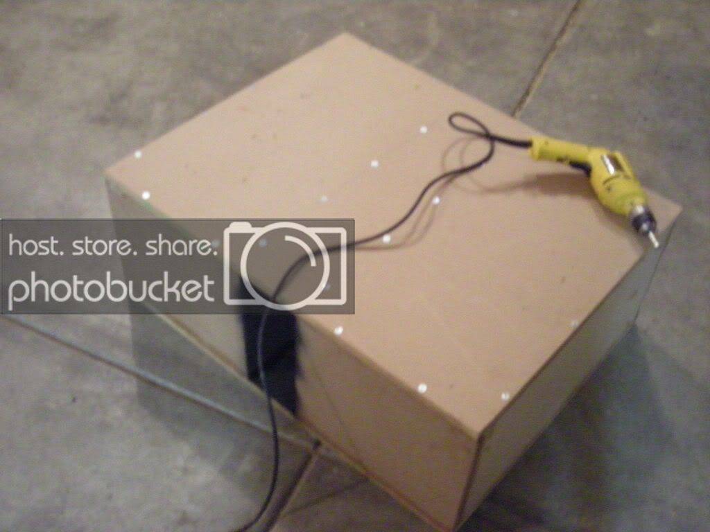

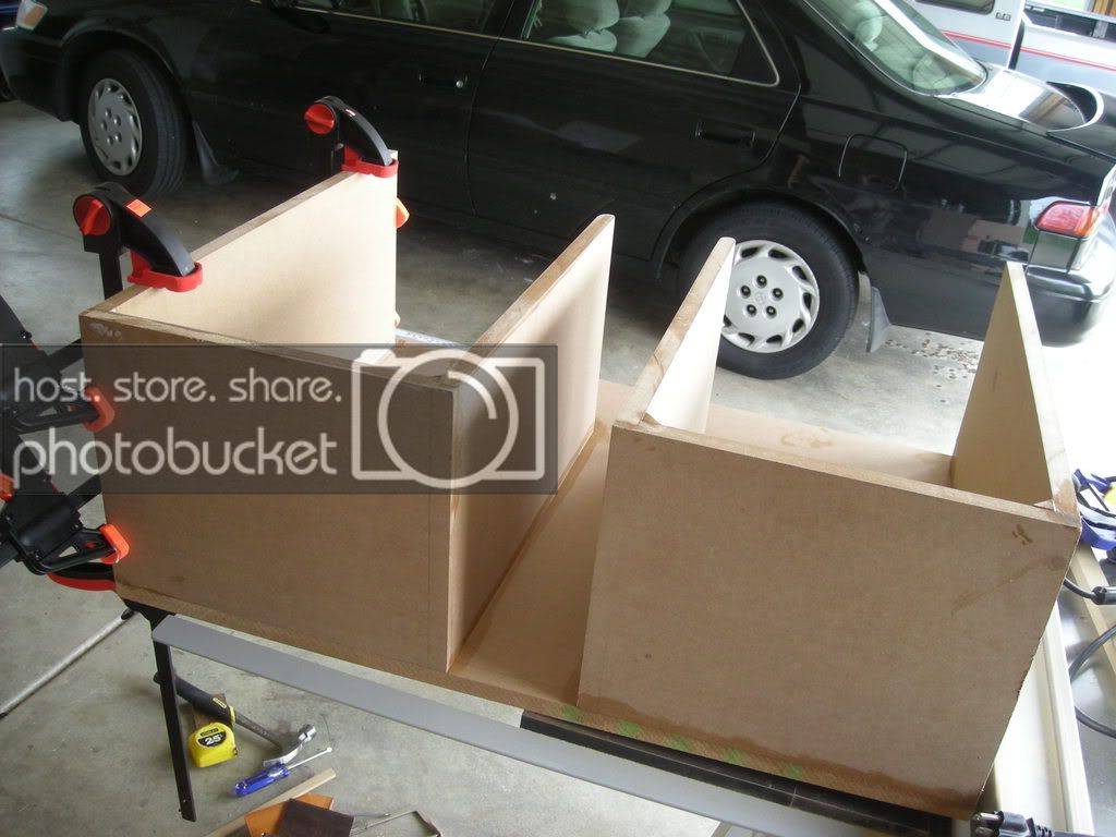

cutting 45 degree inserts for the corners..
