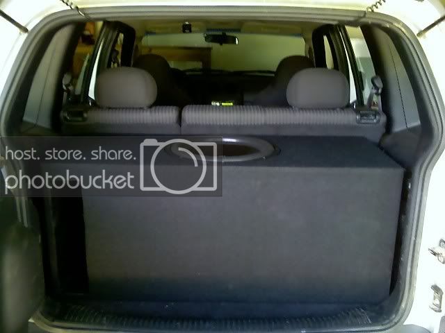

this is mine.
thats about as big as you can get with back seats
well the box is subs up and port pointed toward the right of the car in the back, but if its going to sound like s**t then im probably going to have to put the seats down.
well i guess ill just loose the back seats, im going to try subs up and port back unless you think it will sound better with both back????
well you could probably get about 6.25 cubes after port and sub displacement if you built it with an angles back to form with the seats. then you get to keep the back seat. if you put the back seat down you might as well just do a wall or i would say its just a waste of space.
