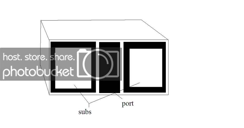

heres an idea that will work for you:
45w x 22h x 22.25deep. 6.5 inch port opening without the second piece so its like this "||".
that gives you about 8.5cubes at 35-36hz with 133.25 inches of port area.
put the port in the middle of the box and have the subs up or facing the seats. make sure the box is close to the front seats and then you will be able to see out the back. you will still have cargo room for amps batts and other stuff. plus to top it all off it will get fvcking loud.
ya that sound good 45 wide is just skinny enough to fit..lol, if up put the subs up should i put the port towards the rear or the front seats... and i dont know alot about those ports so how deep should it be to tune it at 35-36hz
cut sheet for the centered port would be like this:
bottom and top=45 x 22.5
left and right plate=21 x 20.5
back=20.5 x 45
front plates=19.25 x 20.5 x2
port walls=14.5 x 20.5 x2
im making a paint pic of it just a sec
just a mock up of it so you know about what the outcome will be.
the only thing i don't get about that calc. is it says square port length 1 is 15 then the second one is zero , but then it says total port length is 25.5 whats that mean
ya ill try that design out, but with the subs pointing up.
and then when i use winISD pro is says port length should be 25.5
i don't understand why they are different??
