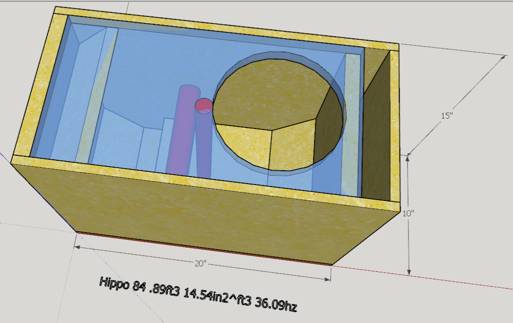

I came up with 2 separate enclosures sub/port up at .89ft3 net, 14.54in2^ft3 tuned to 36hz slotted in your given space OP... but as Kush said the 3" round might be easier. This used .5" and .75" materials.
But as Kush said a round would be easier to build... I don't think tuning much lower ported would be what I'd advise.
