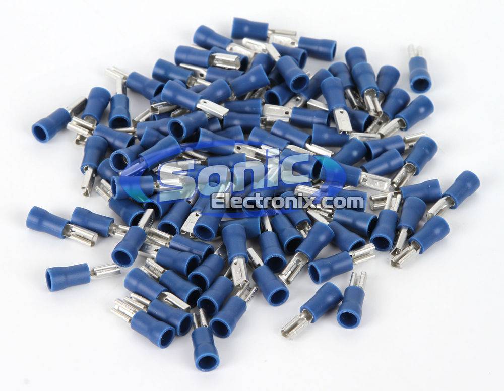

OK Quick update to those who actually care about this thing. I managed to install the Boston today and got everything wired up except for the sub. Just want to verify the internal wiring, but the amp gain is already set to 300W by DMM so all I'll have to do it pop the sub box back in there and wire it up. Connections are pretty simple on this amp, provided you have a set of allen wrenches. Turns out the clearance on my bit set wasn't deep enough to bite onto the power or the speaker connections, so you will have to use hex wrenches. For those who buy new, it's included. But if you're like me and got the refurb, plan to provide one of your own (guess that's where the 5-dollar difference comes from. Additionally, you will need a female quick disconnect to attach the remote turnon lead. Looks like this (photo courtesy of SE):
Btw, that package of quick disconnects I displayed was 5 bucks for 100-count. Great for shops *hint hint and shameless plug*
