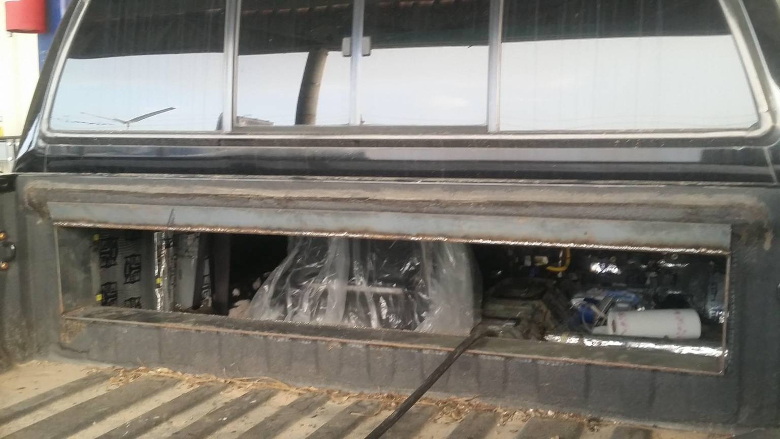

The steel accordion boot has started.
I'm going to order 3 ohio gen 300a alts on Monday and hopefully my mids, highs and multichannels in the next week. Then all that will be left is the batteries, wiring, LEDs, and building material.
More welding got done on the accordion boot on the inside of the cab. Still more work to do, but it's coming along nicely! I kicked the rear wall and it didn't move a bit. It's solid to say the least //content.invisioncic.com/y282845/emoticons/biggrin.gif.d71a5d36fcbab170f2364c9f2e3946cb.gif

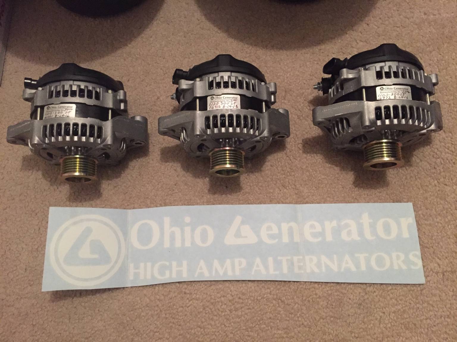

Got my three 300A Ohio Gen alts in! Should be plenty of power for the three 4ks at half ohm.
About 200A at 800 rpm idle and almost 320A at 2k rpm. Output was tested at 13.8v. Alt is set to 15v cold.
With the 8 Deka g31s I'll be getting, I shouldn't have too much voltage drop!

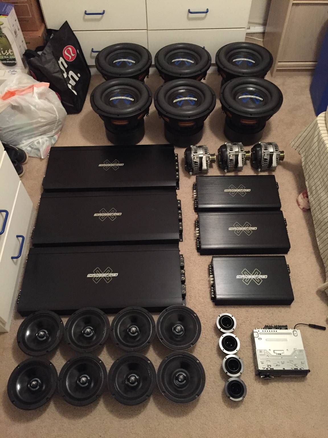

Just ordered the last of my Crossfire gear.
8 - 6.5" loudspeakers
4 - super tweeters
2 - C5 800.4
1 - C5 400.4
Hopefully that's enough to keep up with the 6 12s

Better pic of everything going in the truck.
I think what's dissapointing the most....is the poorly cut Ohio Generator decal. But that's me I guess. I watch for detail things like so.
Otherwise, great gear so far. If I haven't said it already, look forward to seeing this done.
There is nothin poorly cut about that decal... Just laid one on my buddies windshield and looks great. What are u talking about ?
