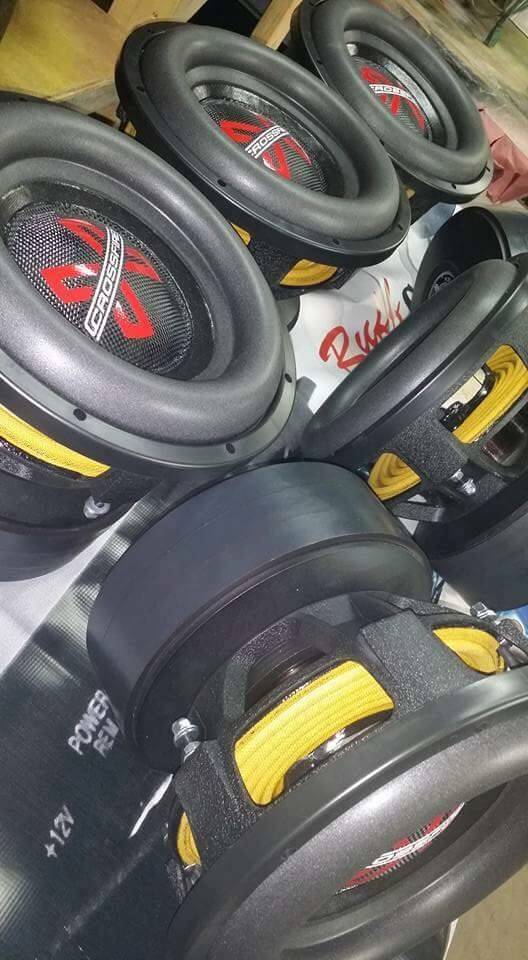

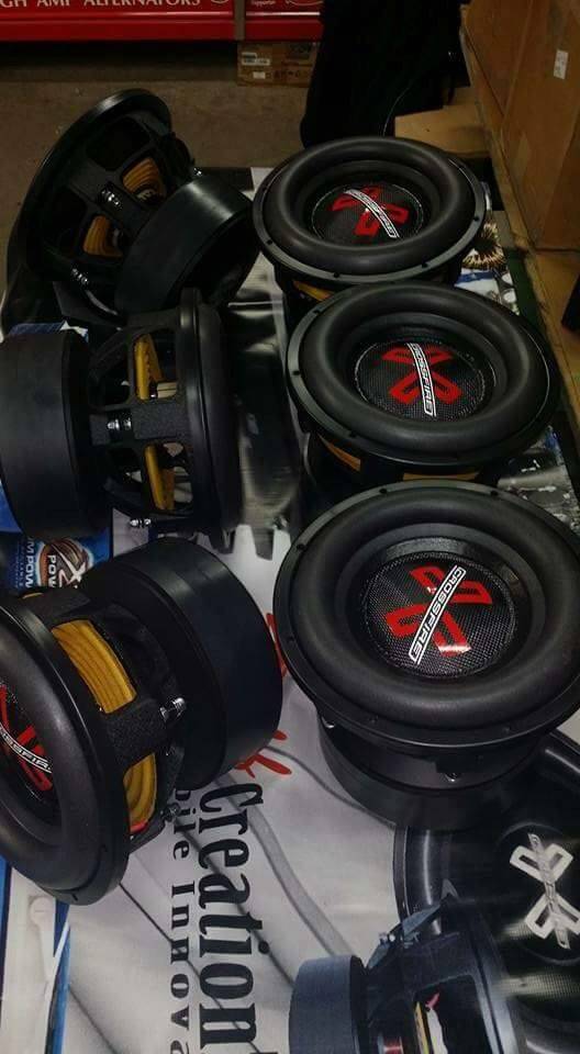

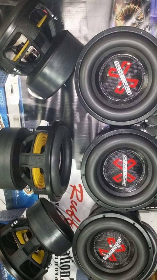

Had a buddy send me some pics of the subs I'll be getting. Mine will have a blue logo instead of red though. Mmmmmmmm
