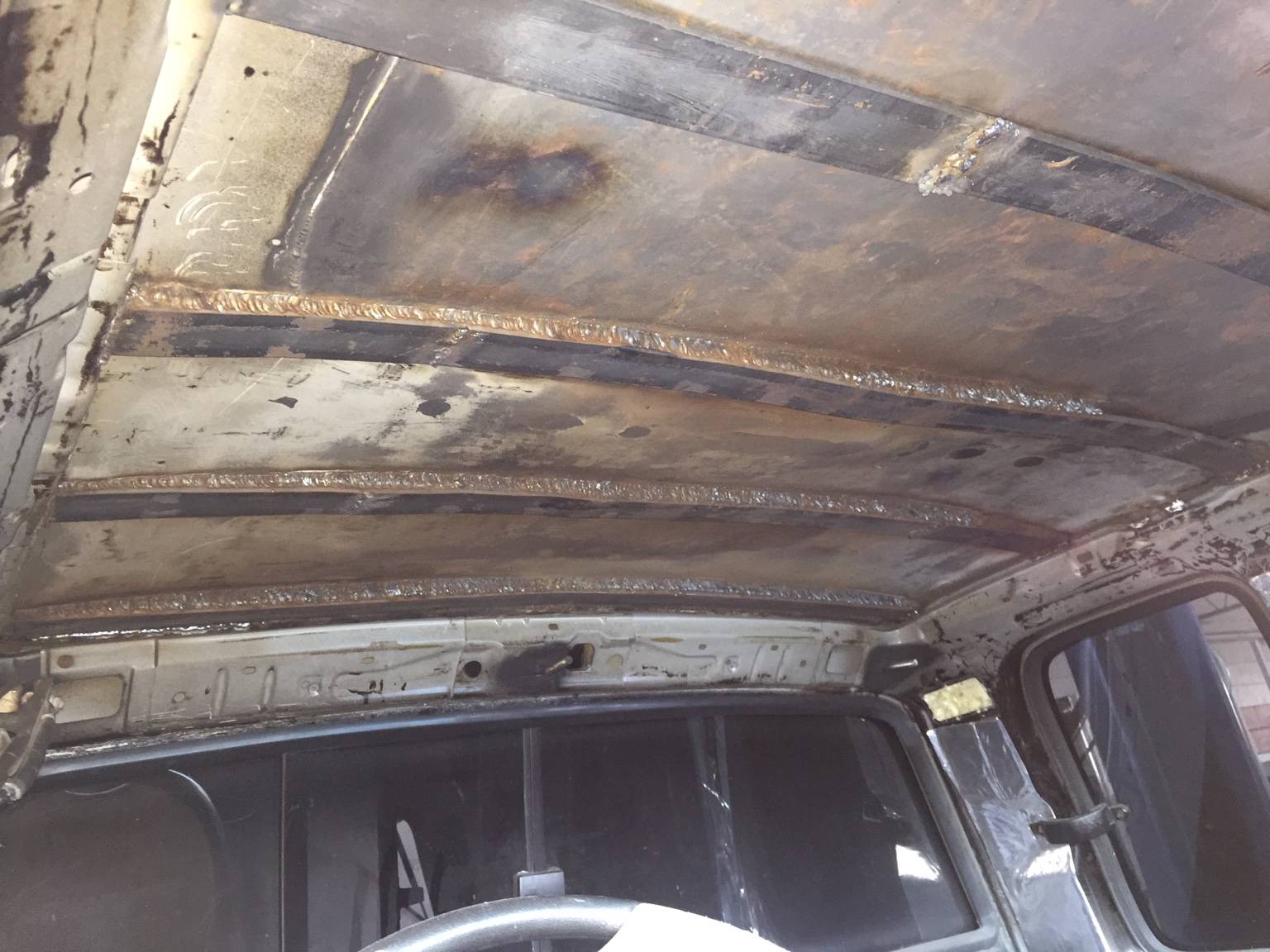

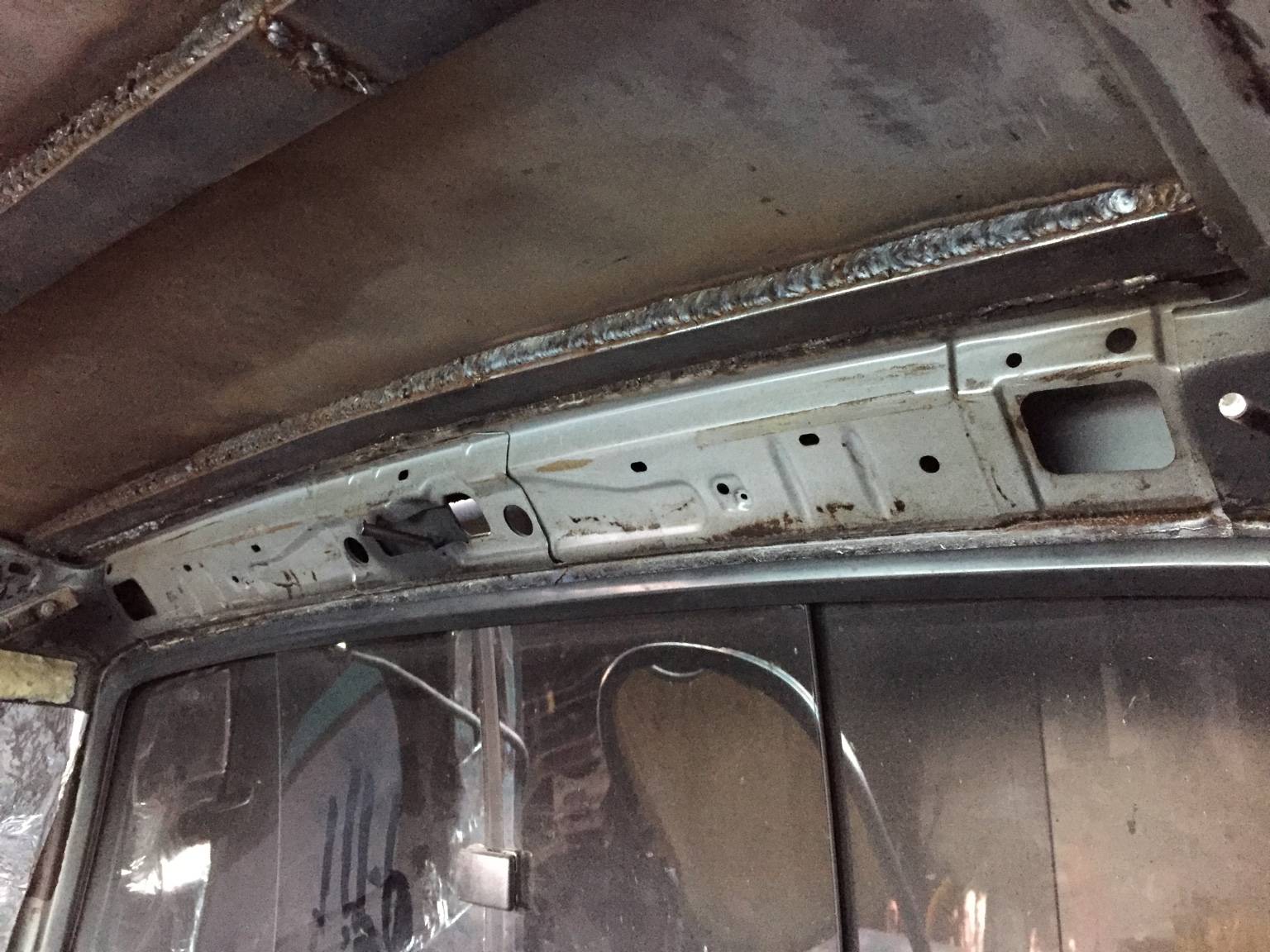

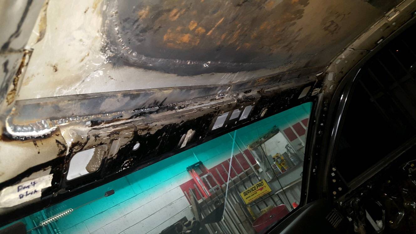

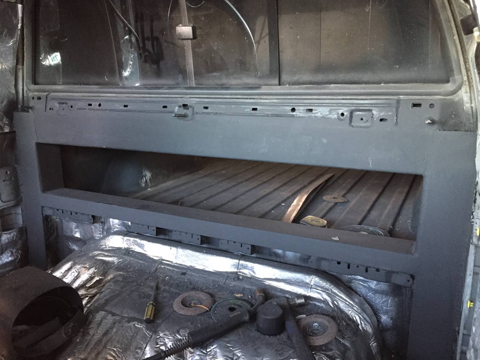

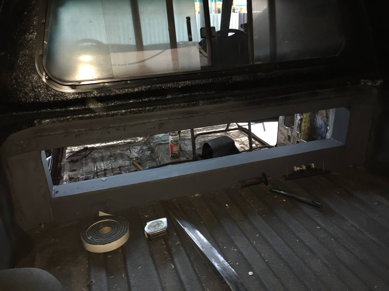

The steel reinforcement is making progress and should be completely done in the next couple of weeks. It's finally starting to come together and is turning out pretty good. We have the steel for the triple alt bracket too so that will start shortly.
My box guy is moving to a new home so that will be put on hold until about March. The good thing is, all the major stuff is done so the rest shouldn't take too much longer.

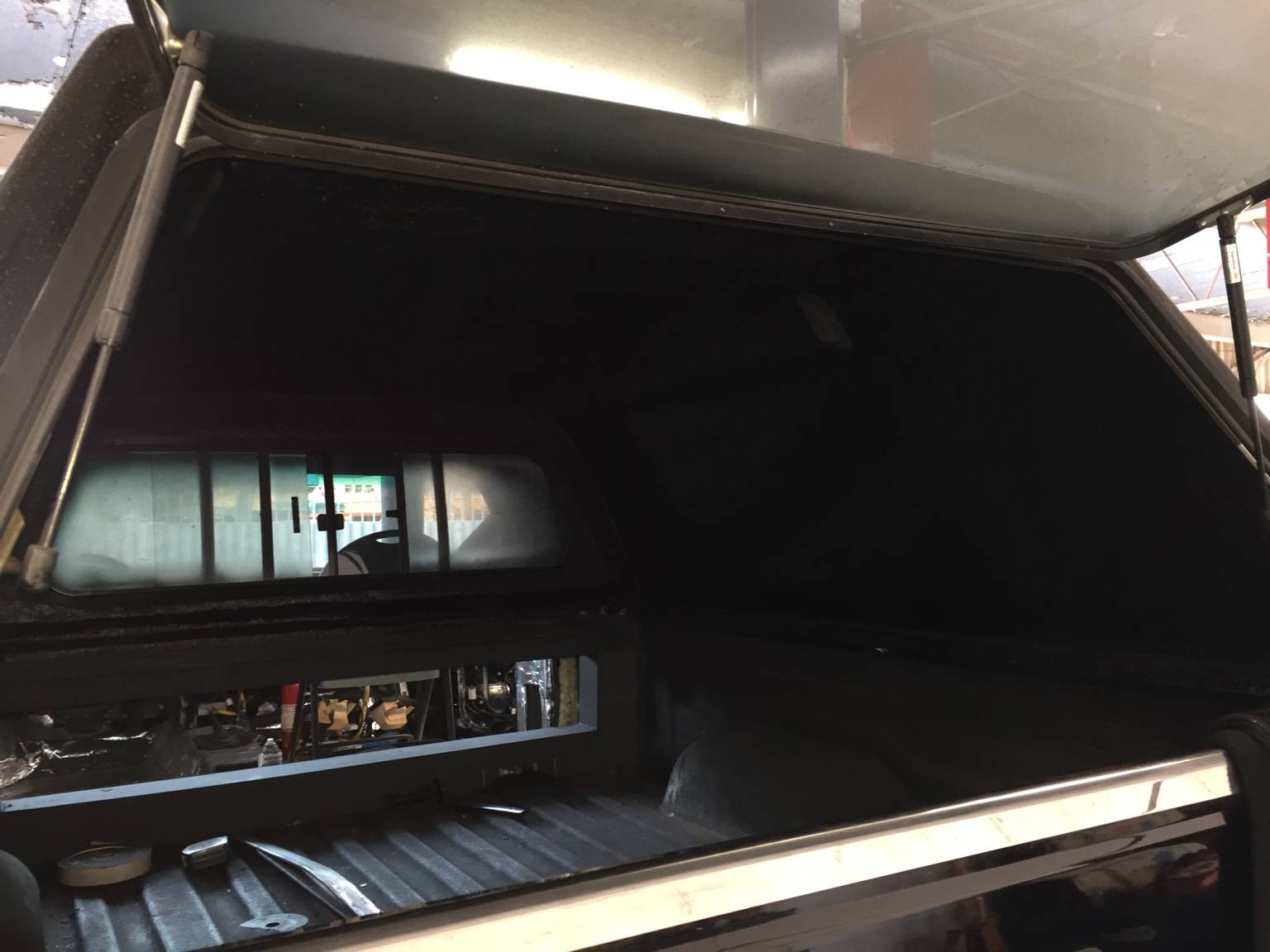

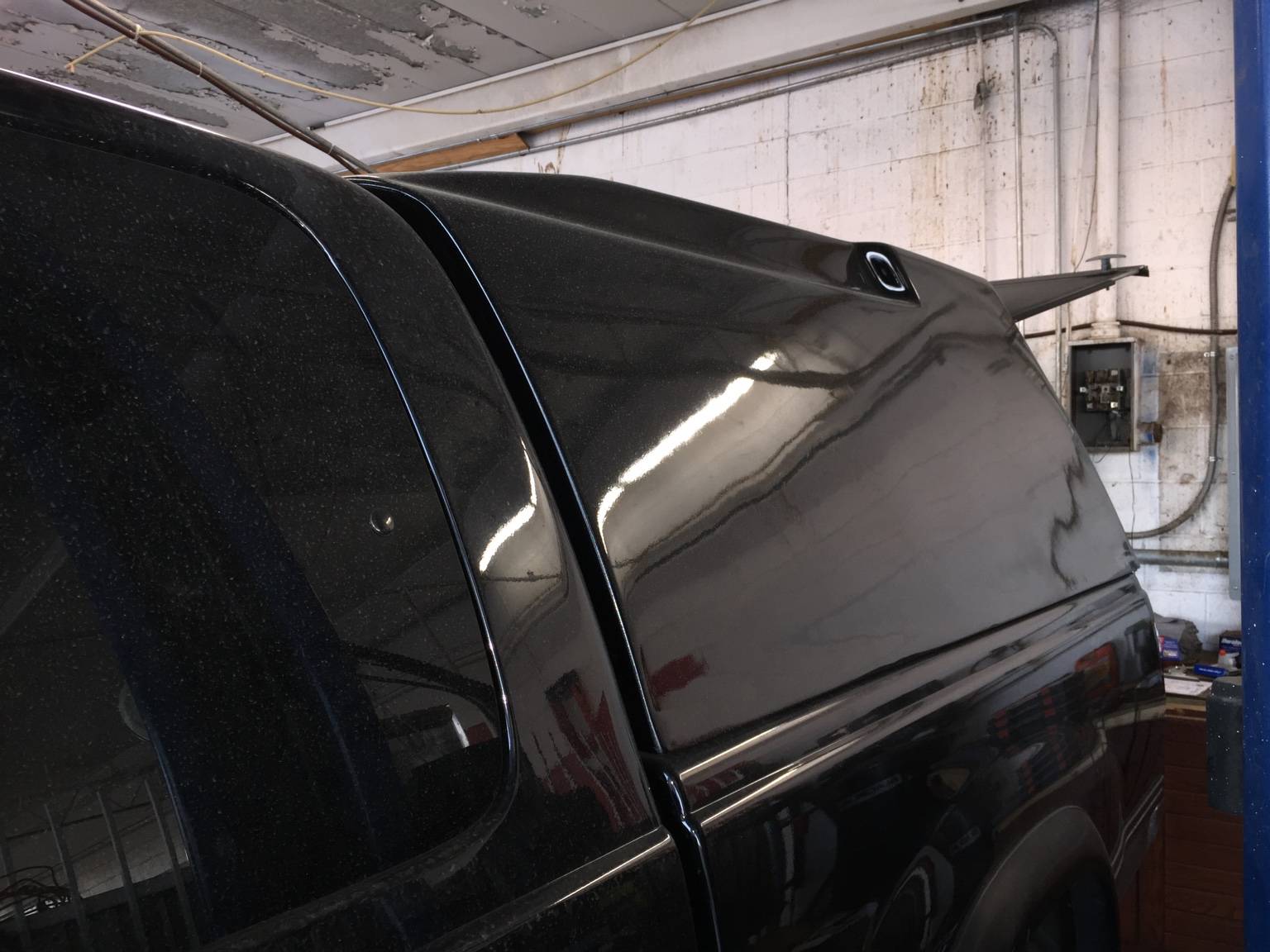

Outside and inside of the camper got painted black too
As soon as it starts warming up just a little more, I'm going to start fiberglassing the doors!

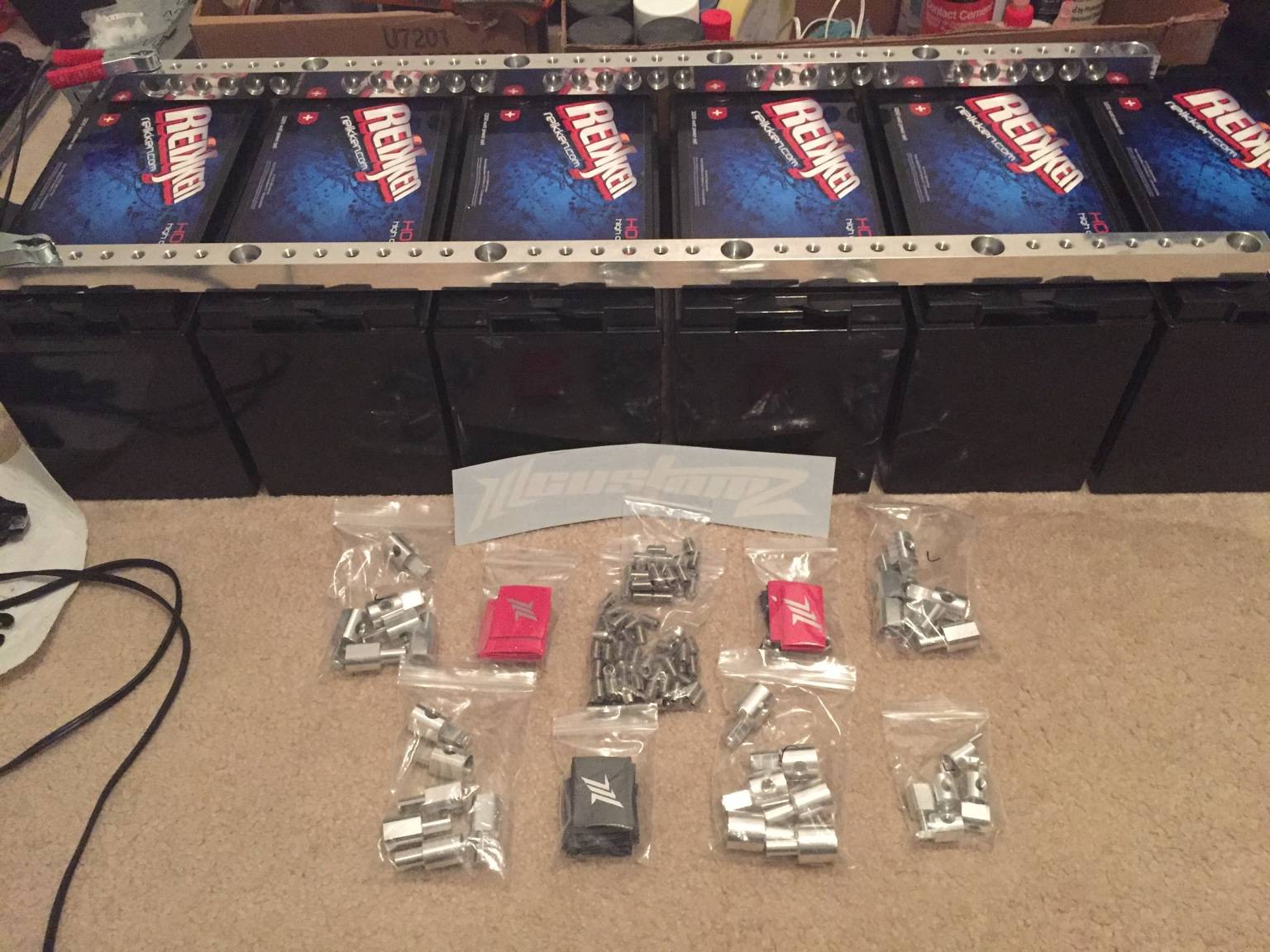

Got a nice package from ILL Customz this weekend.
Buss Bars
6 4/0 to 1/0 reducers (for alts+ to batts and batts to frame)
6 4 awg to 8 awg (for multichannel amps)
18 1/0 to 1/0 inputs (for sub amps)
And a whole lot of heat shrink //content.invisioncic.com/y282845/emoticons/smile.gif.1ebc41e1811405b213edfc4622c41e27.gif

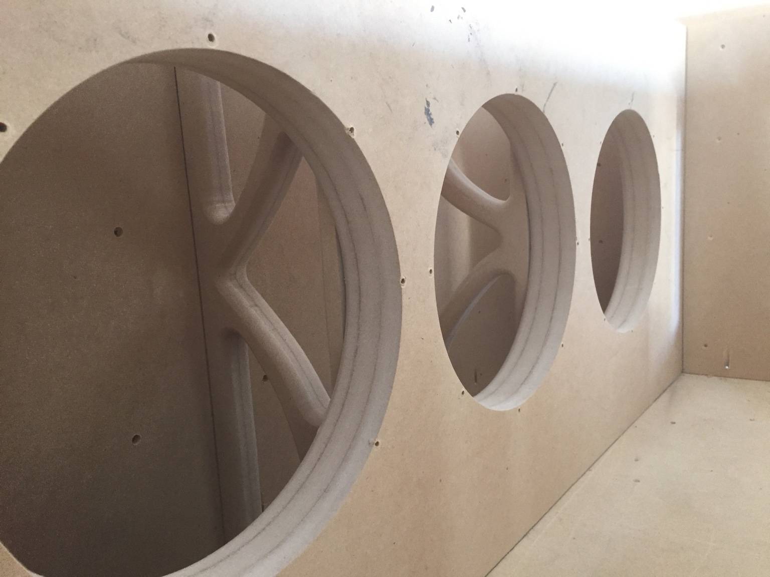

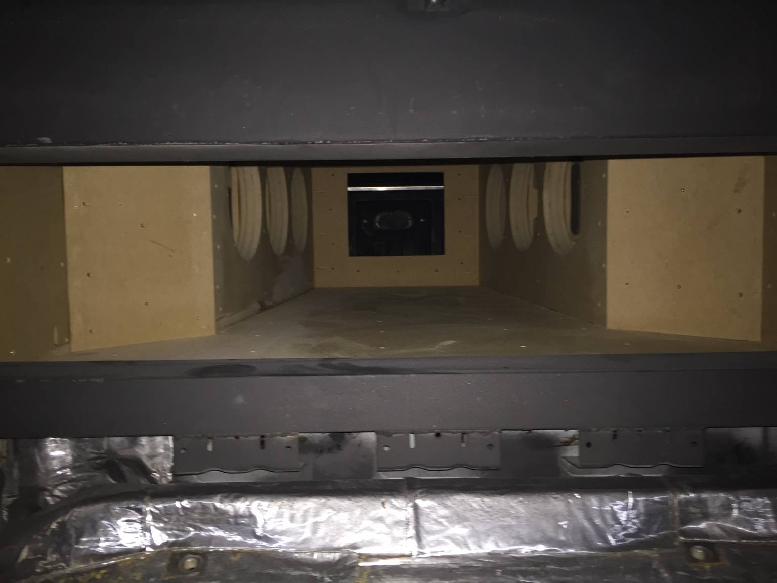

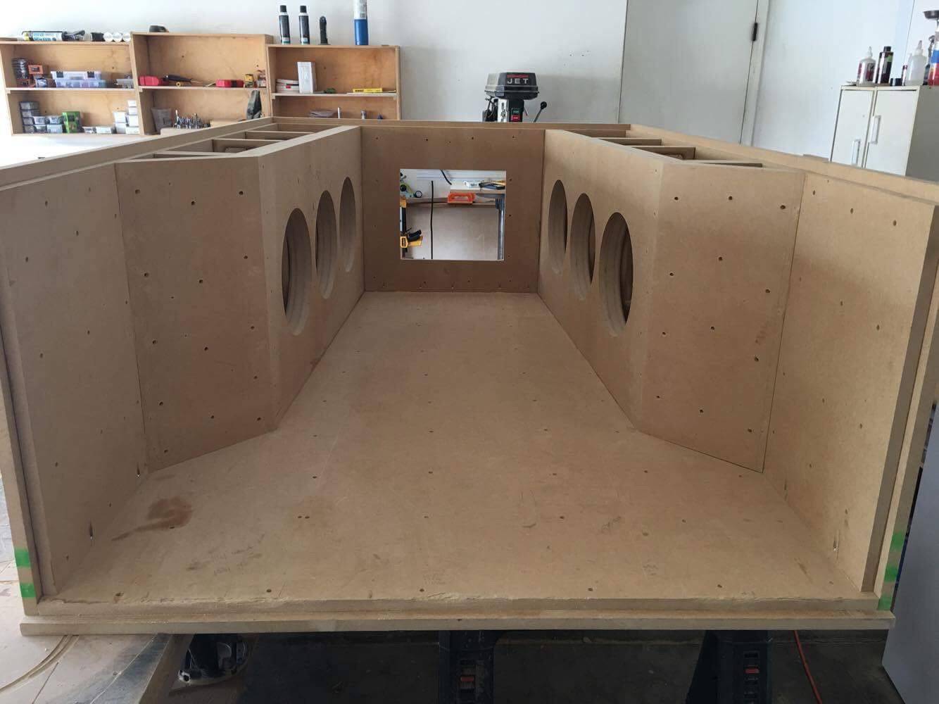

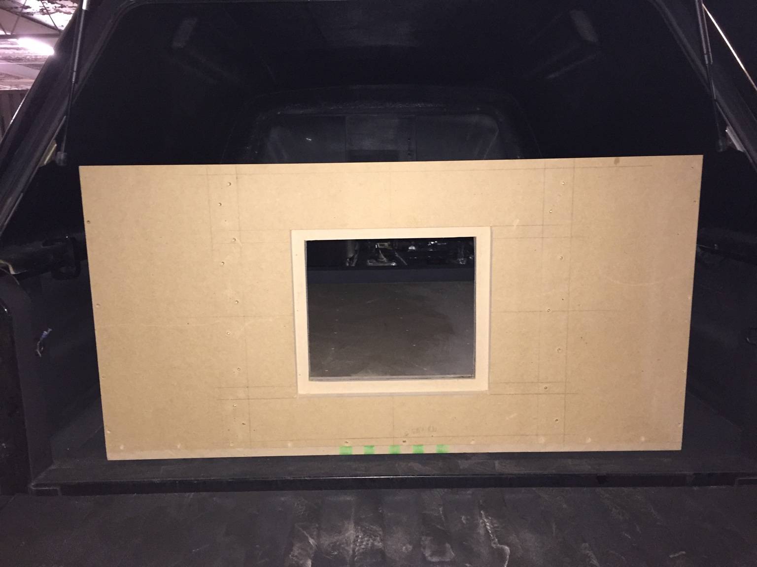

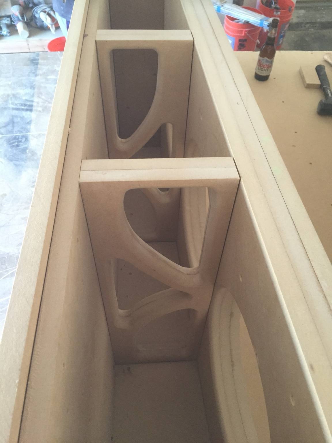

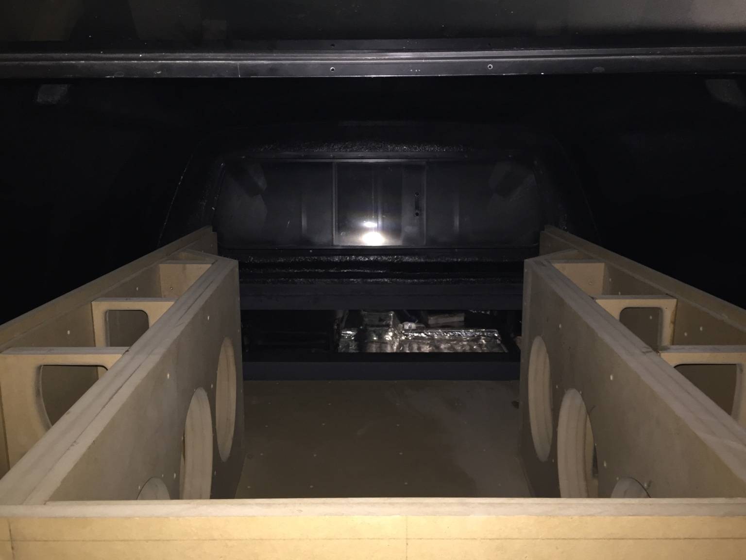

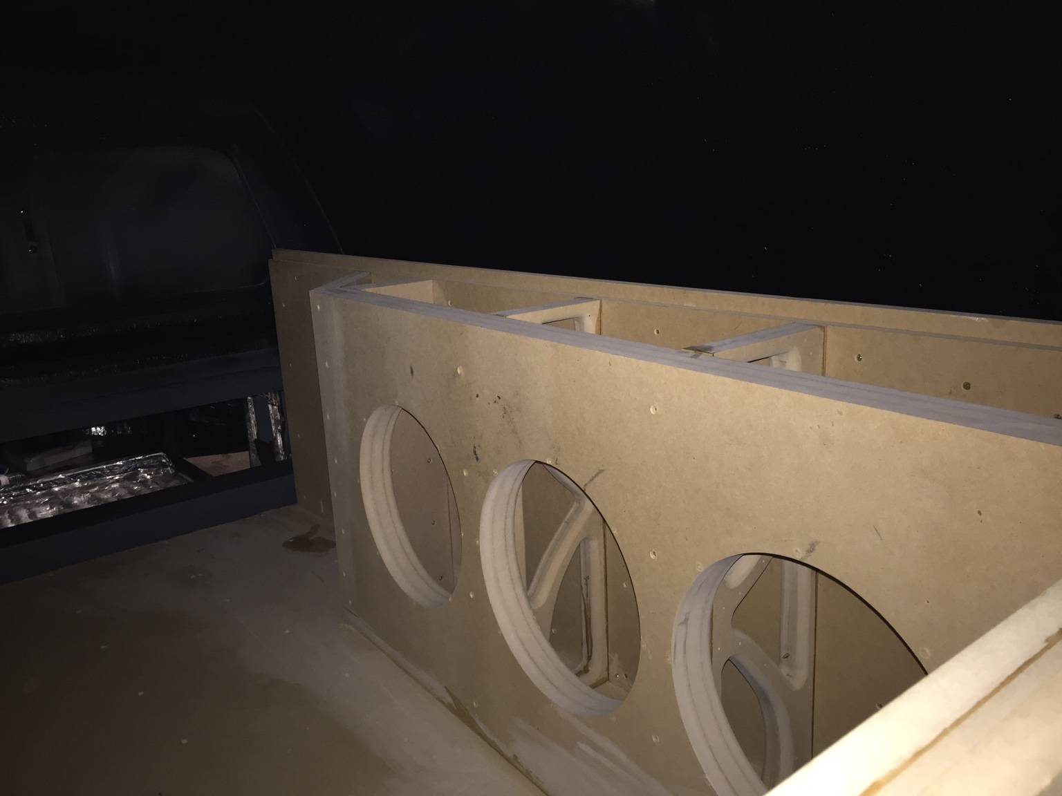

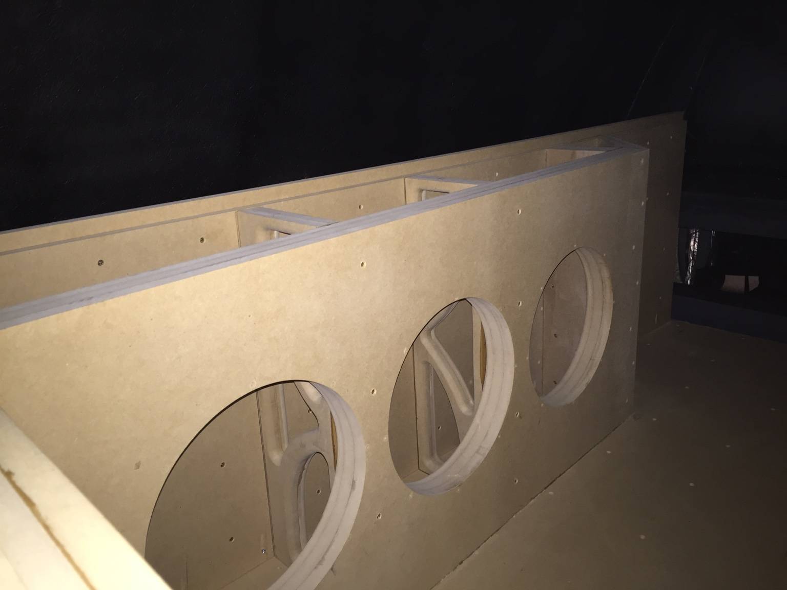

The box is loaded up in the truck until the builder gets moved. The truck only squatted about 1" so not too bad... so far haha. He is still able to work on the port side bracing and top, so after that we have the port, body filler, paint and the plexiglass window.

A few more pics of some gear that came in yesterday. The battery rack stand is built but I forgot to get pics. Roof is really close to being done. Might be done this weekend. Just need to add one more bar along the front to double up the width. Decided on no stripper pole.

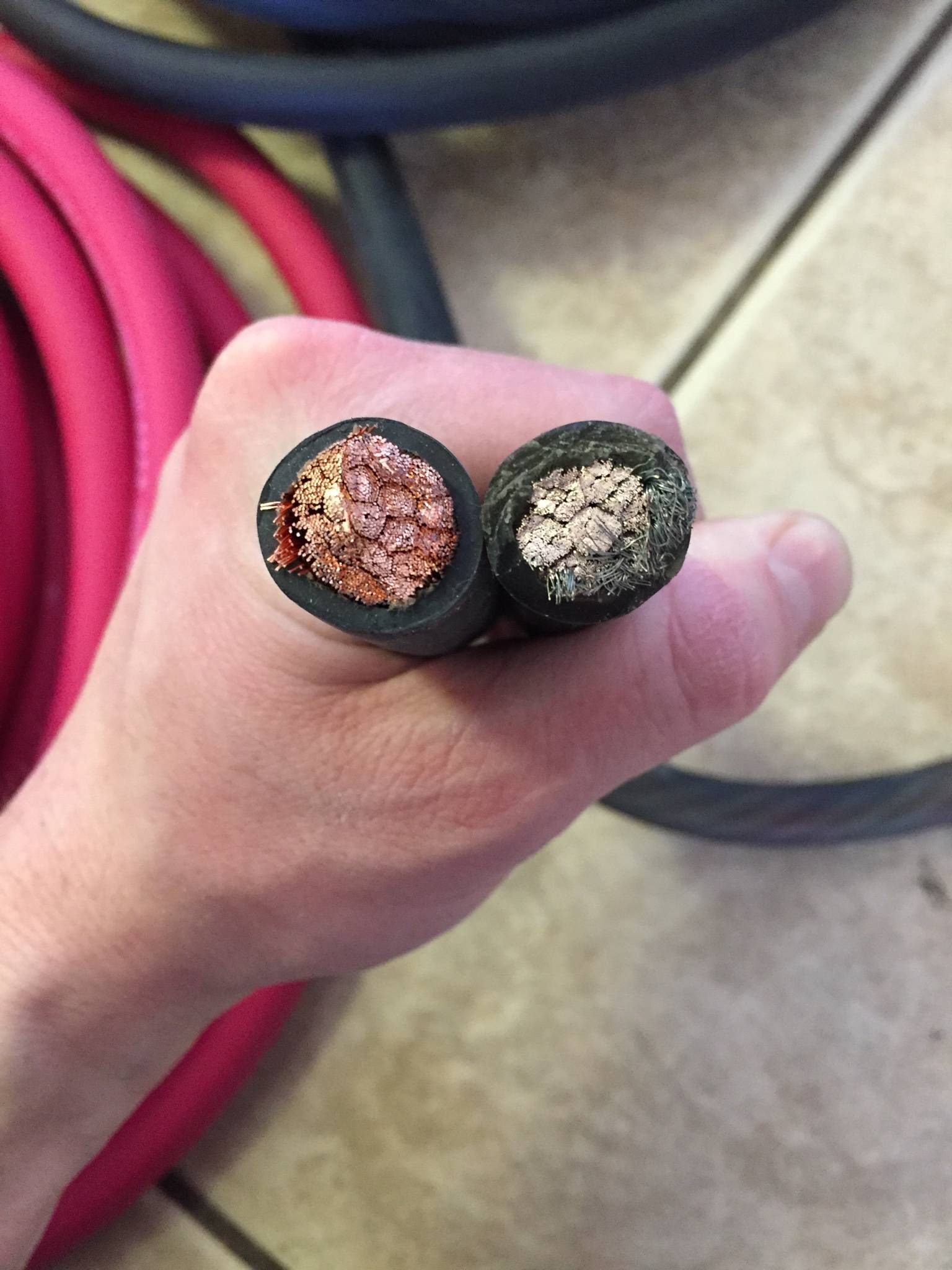

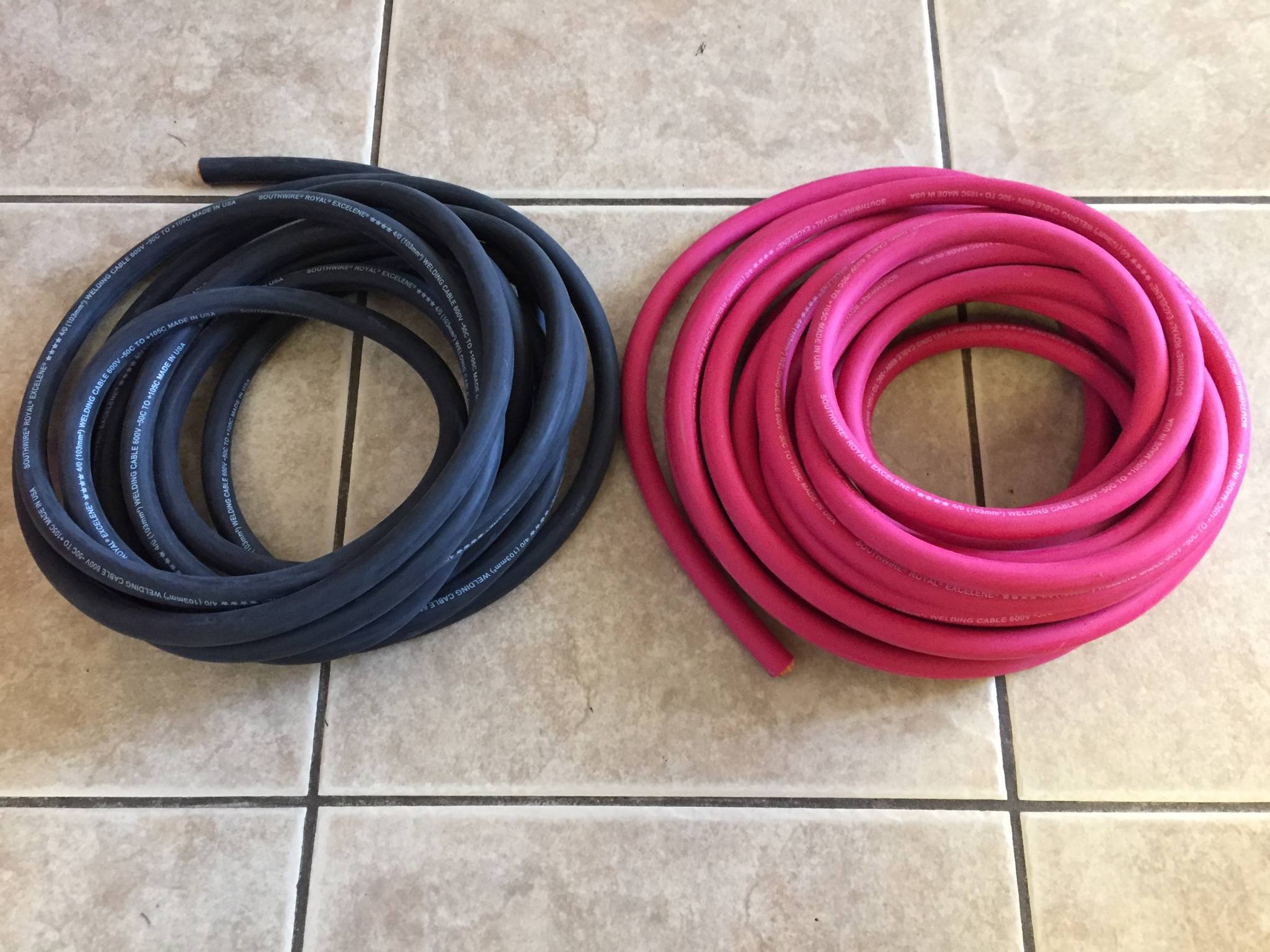

4/0 for runs from alt to battery bank and frame grounds

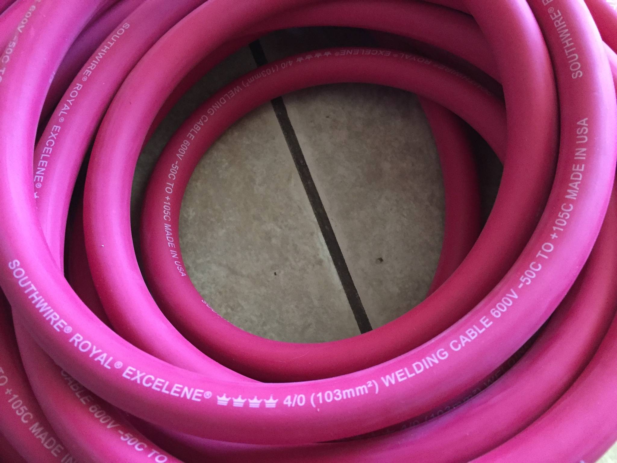

4/0 Royal Excelene on left, Kicker 1/0 on right

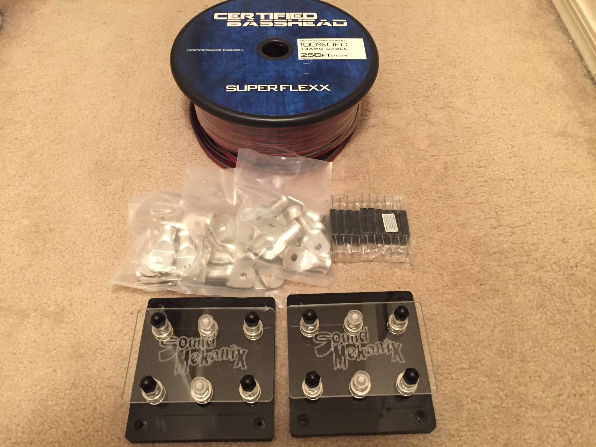

250 ft 14 awg certified basshead OFC speaker wire for mids and highs
4/0 lugs and 300A fuses
Sound Mekanix 3 spot fuse blocks. These feel like really good quality and are a little cheaper than the SMD ones.
