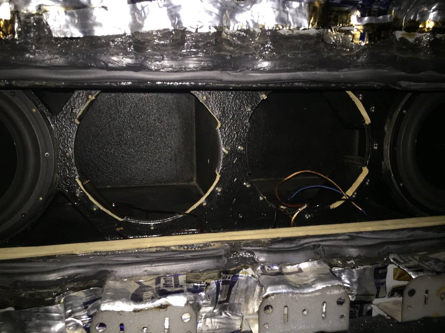

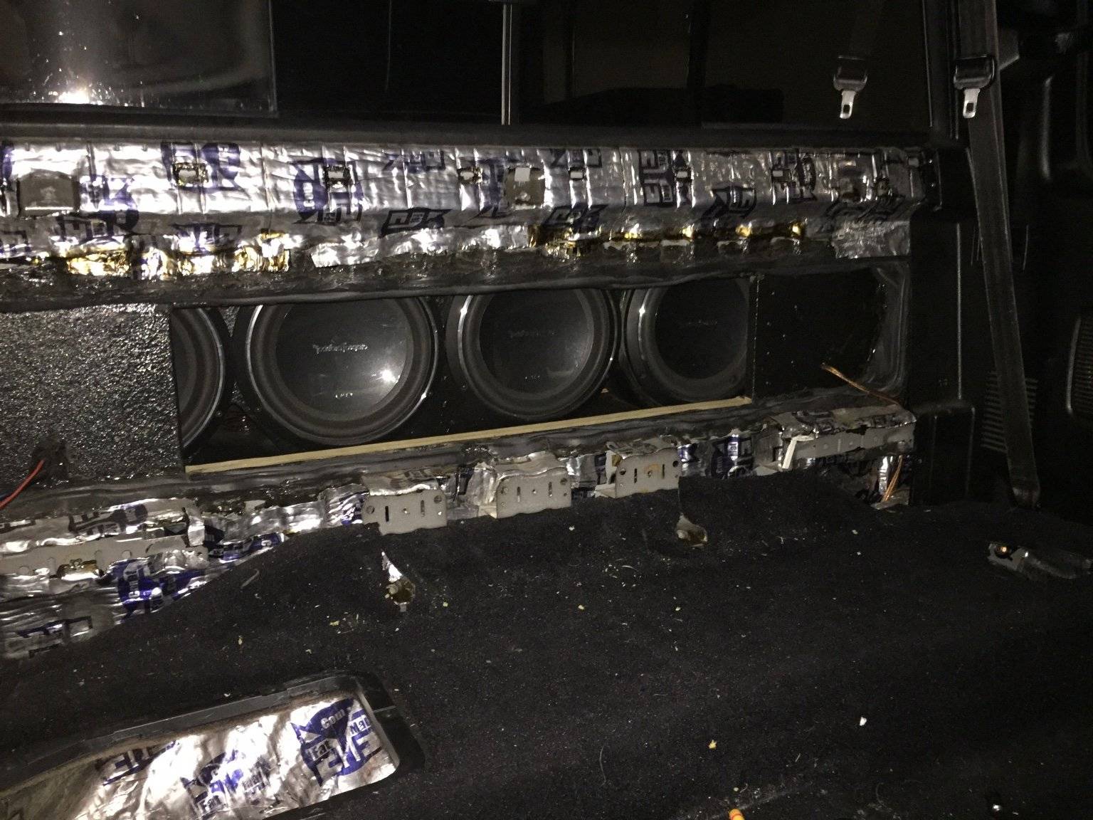

Got the back seats, port, and 2 subs pulled out tonight. My small screw gun died and I can't get the other 2 subs out without it. I'll pull those out Thursday and then hopefully have the box out by the weekend

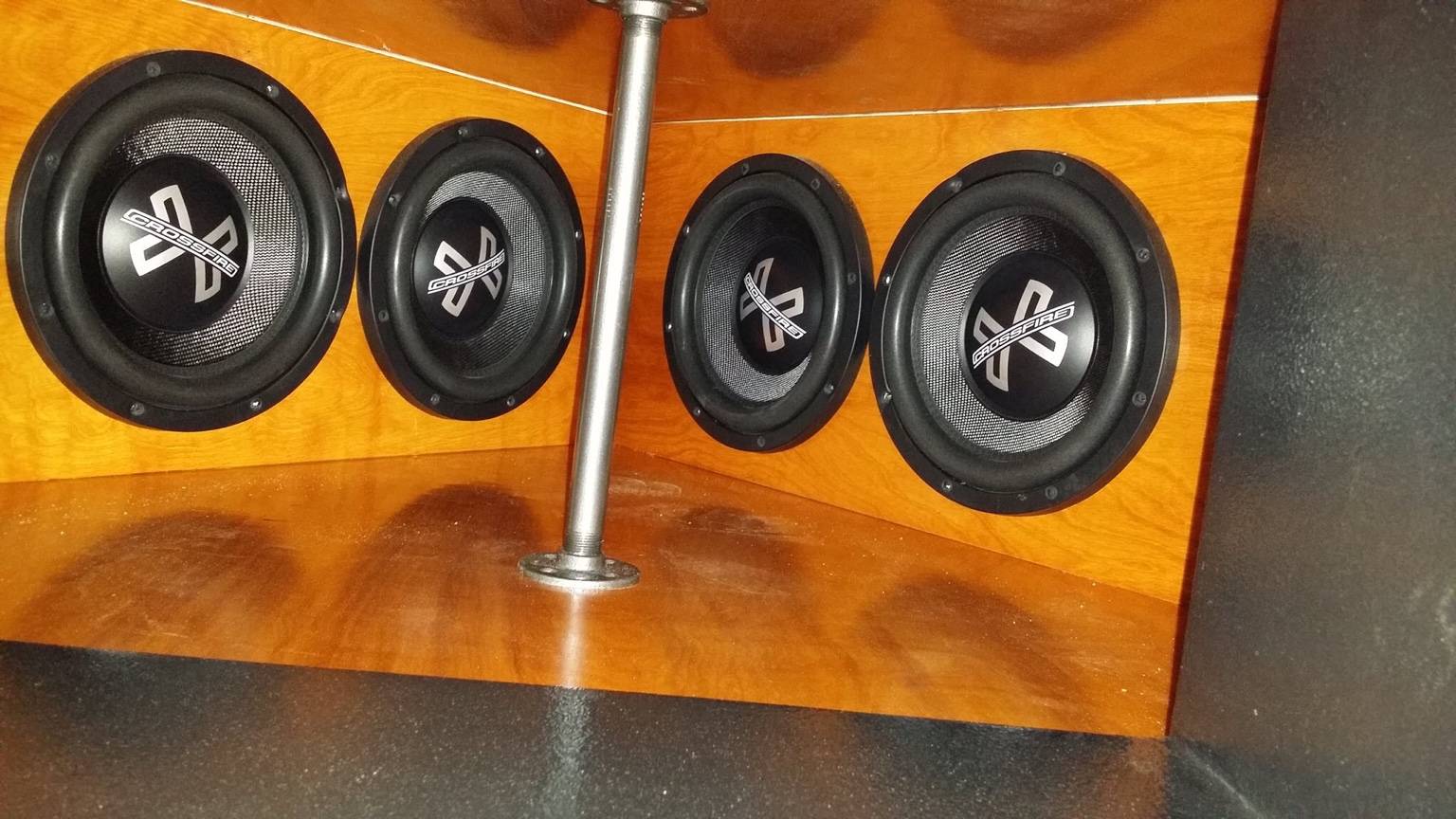

Here is one of my teammates blow through. Super clean and pretty **** loud for only the C7s
I think I'll do something similar to this but 3 subs on each side
