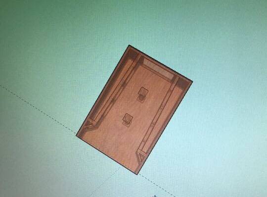

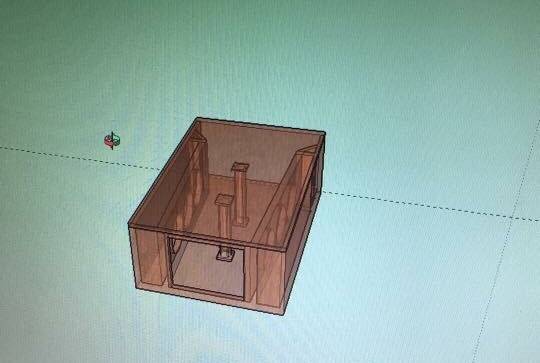

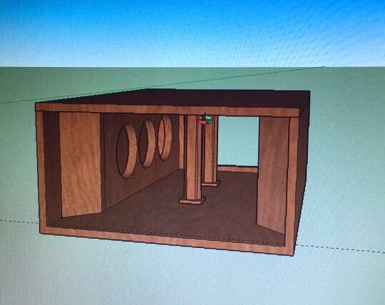

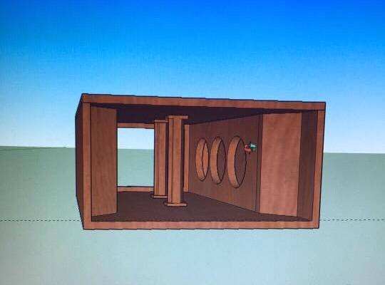

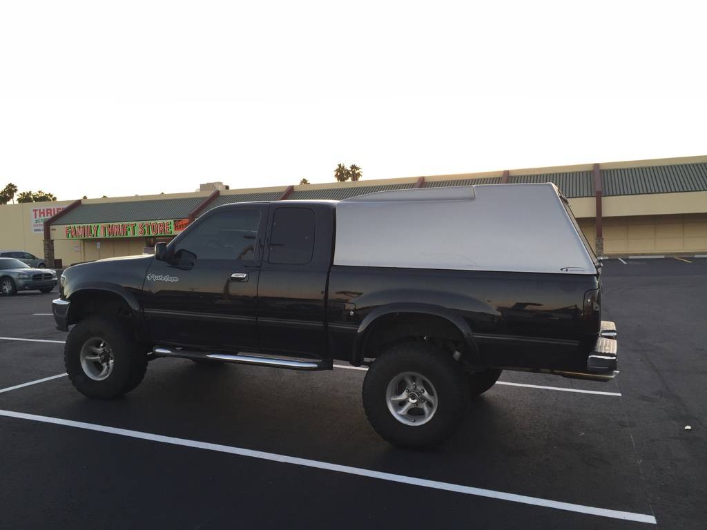

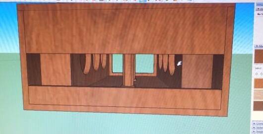

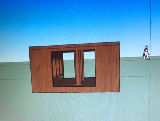

A couple updates though. The box design is done. About a 3:1 4th. In order to save cost and time, we are just going to build between the wheel wells, but that means the box is going to be 25" tall and my bed is only 17" tall. So I got a camper shell for the truck. It will be painted black. I needed a camper shell for the round 2 build I do in a couple years anyways after 6 12's isn't loud enough anymore. Will probably do a full walk through up to the b pillar, but that won't be for a couple years.
I'll upload some pics of the camper shell and box design in a minute //content.invisioncic.com/y282845/emoticons/biggrin.gif.d71a5d36fcbab170f2364c9f2e3946cb.gif

Here are some pics //content.invisioncic.com/y282845/emoticons/biggrin.gif.d71a5d36fcbab170f2364c9f2e3946cb.gif
This is the back of the box (tailgate end of the bed). The cutout will be for a plexiglass window //content.invisioncic.com/y282845/emoticons/smile.gif.1ebc41e1811405b213edfc4622c41e27.gif
This is the port side (what will be seen from inside the cab)

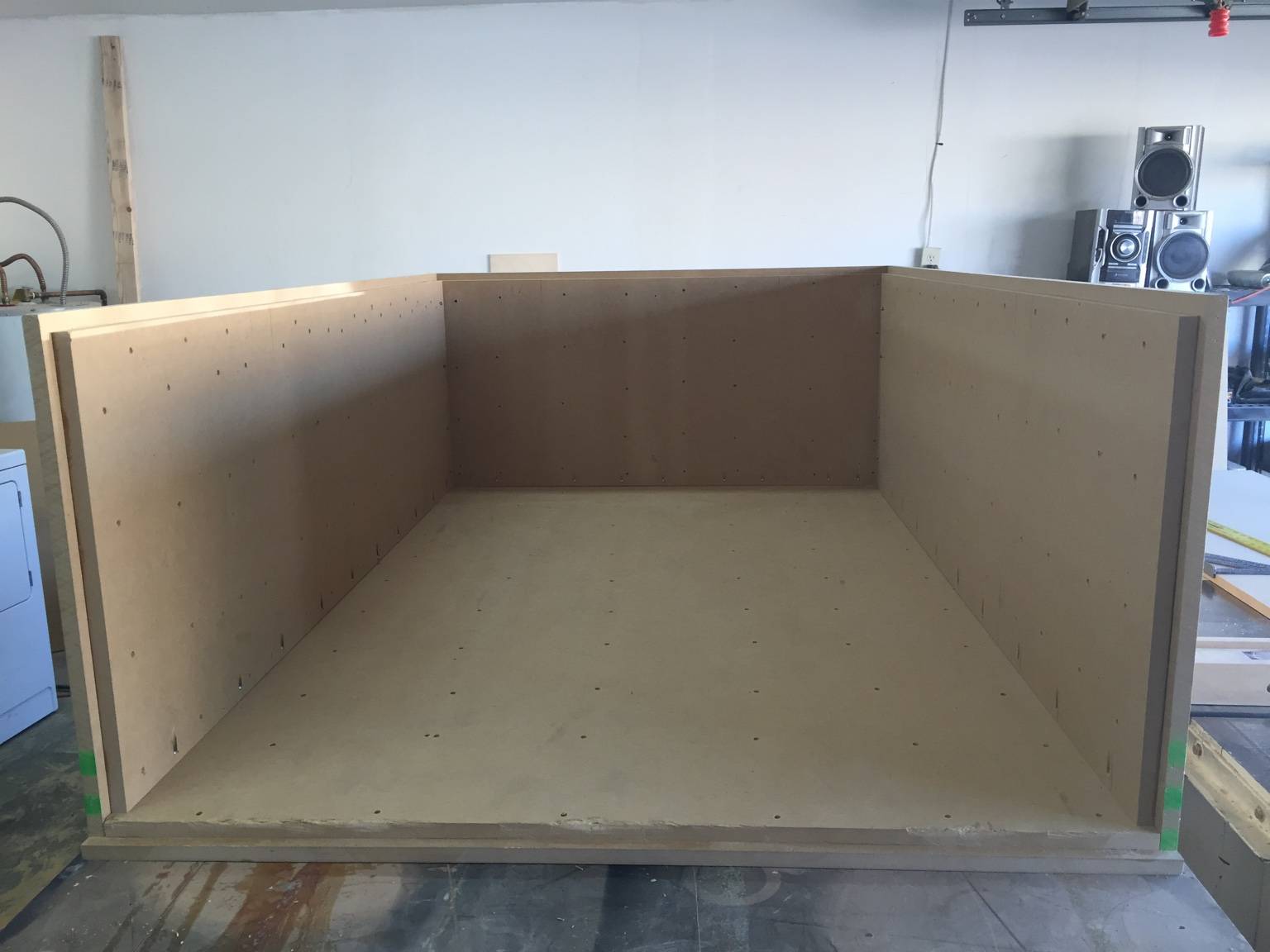

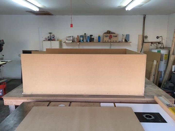

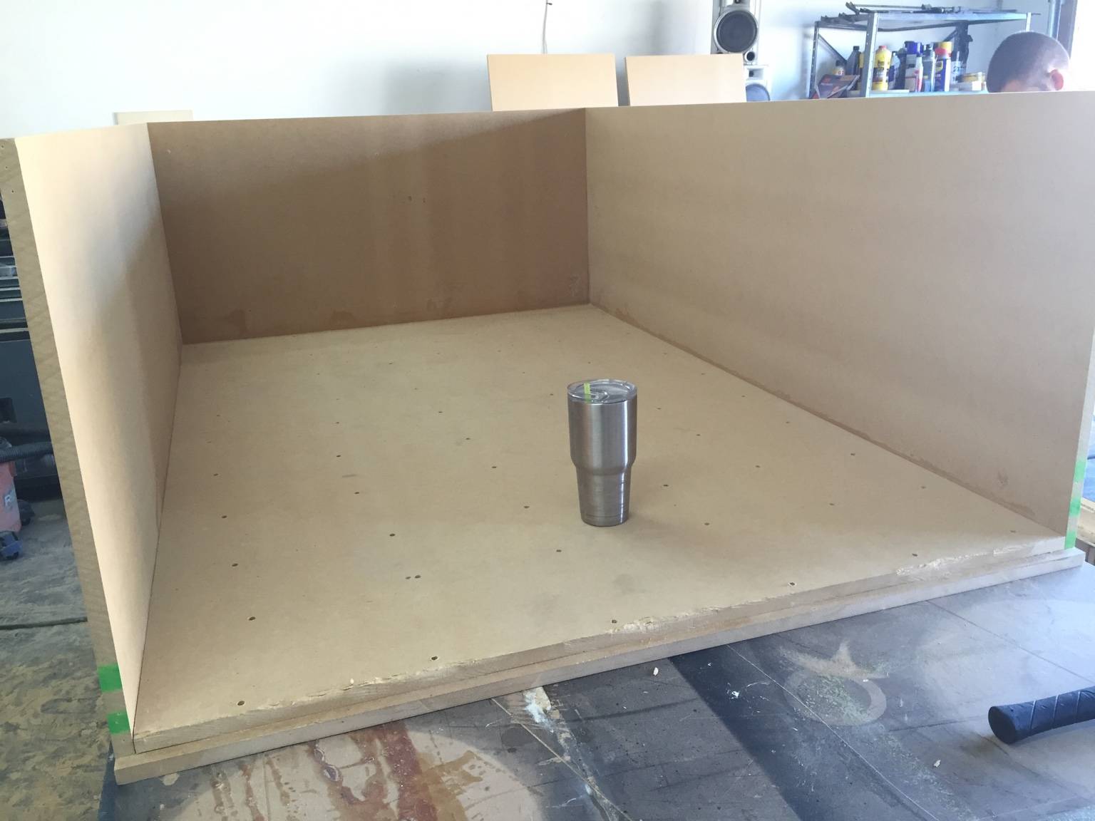

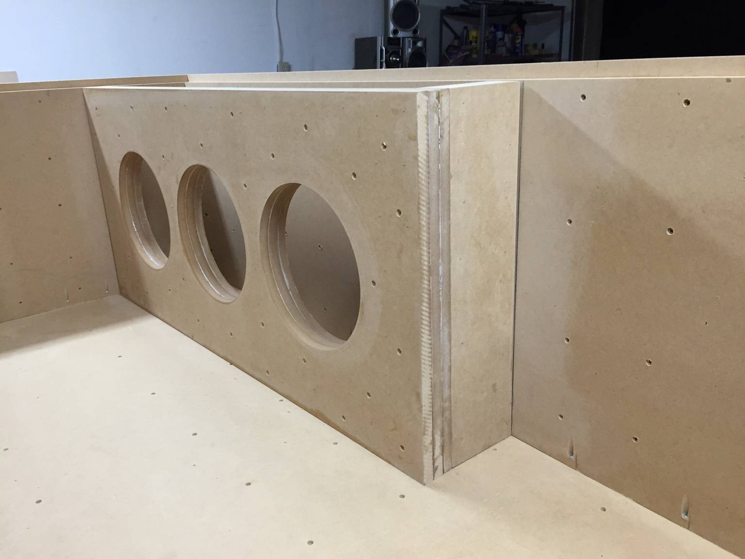

The box construction has begun as well and it's freaking huge! 6 feet long, 4 feet wide, and 2 feet tall. Basically a 2 person coffin haha. Brent is going to make this thing so awesome, I'm really excited. We came up with a lot of good plans tonight.

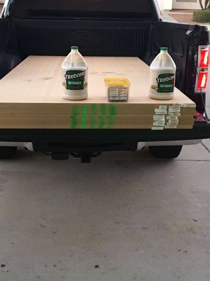

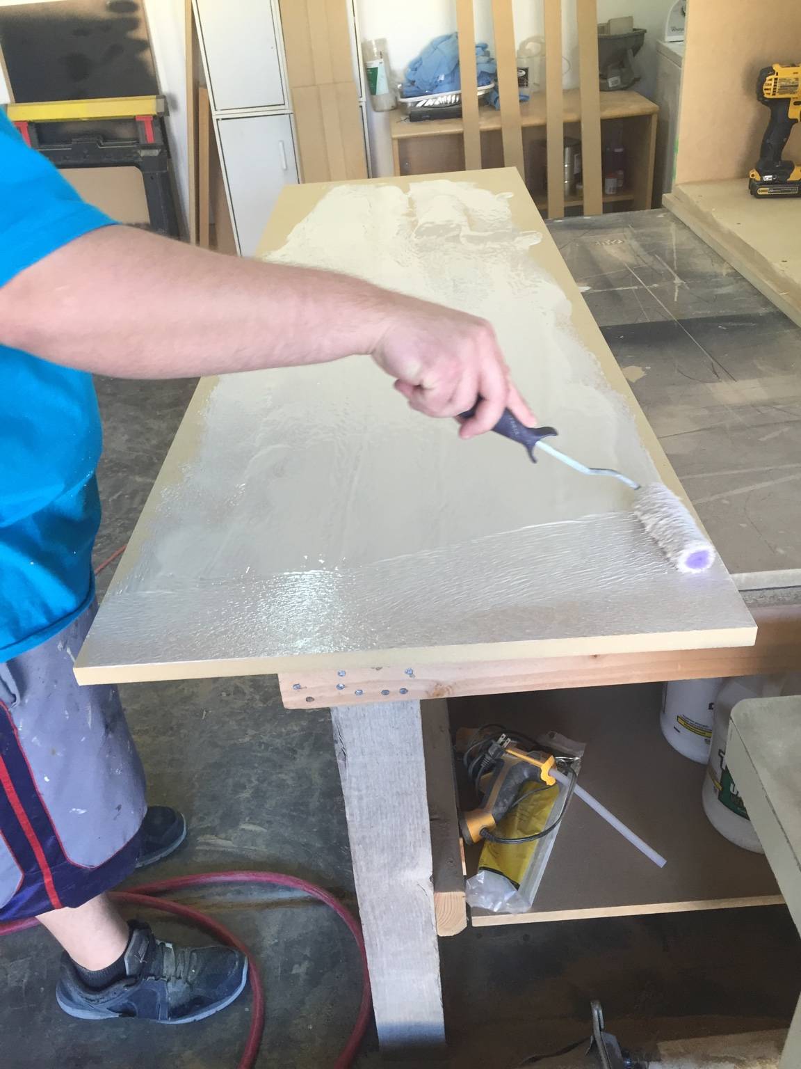

8 sheets of 3/4" mdf
Single layer

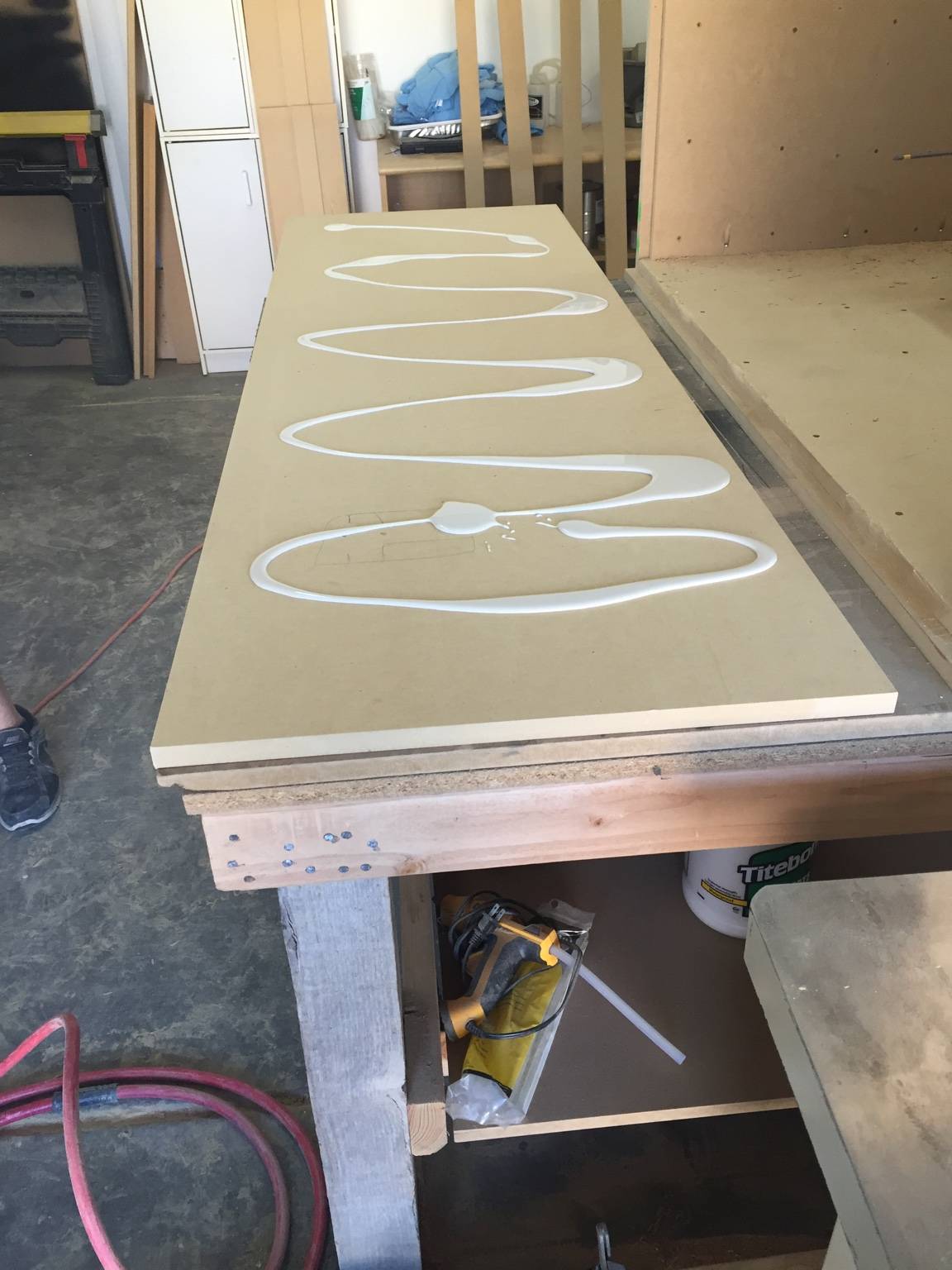

Lots of glue
Double layer

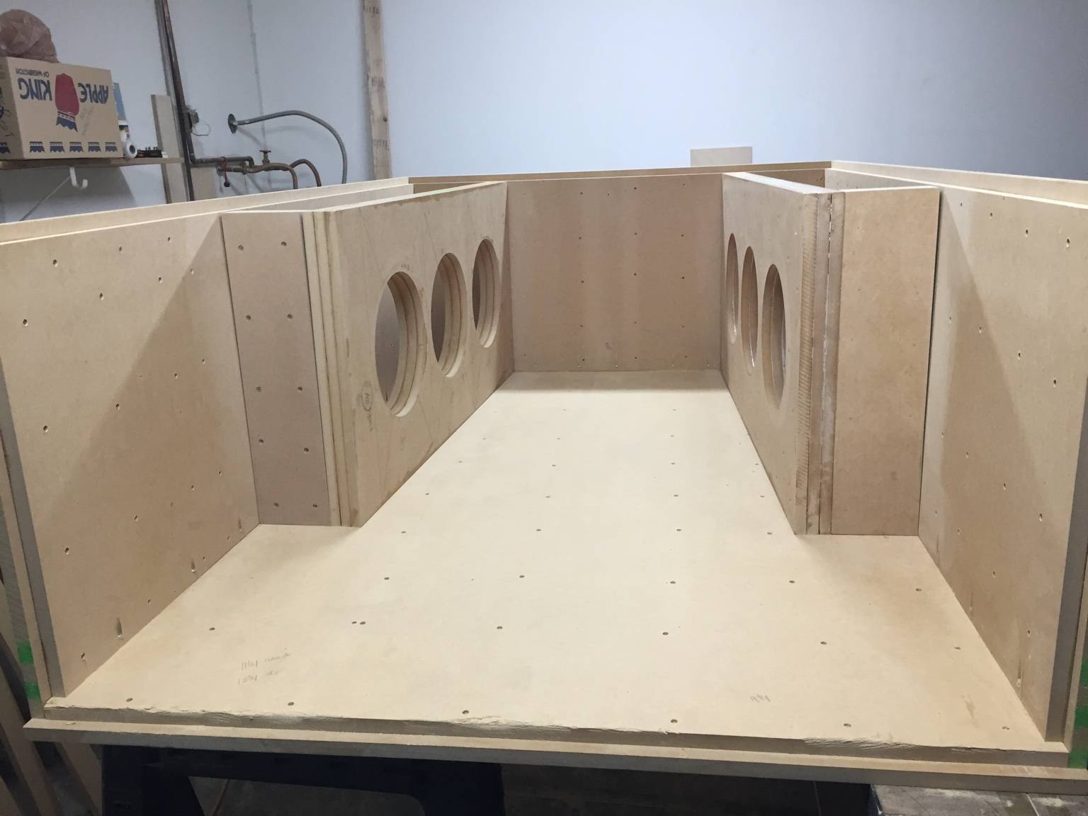

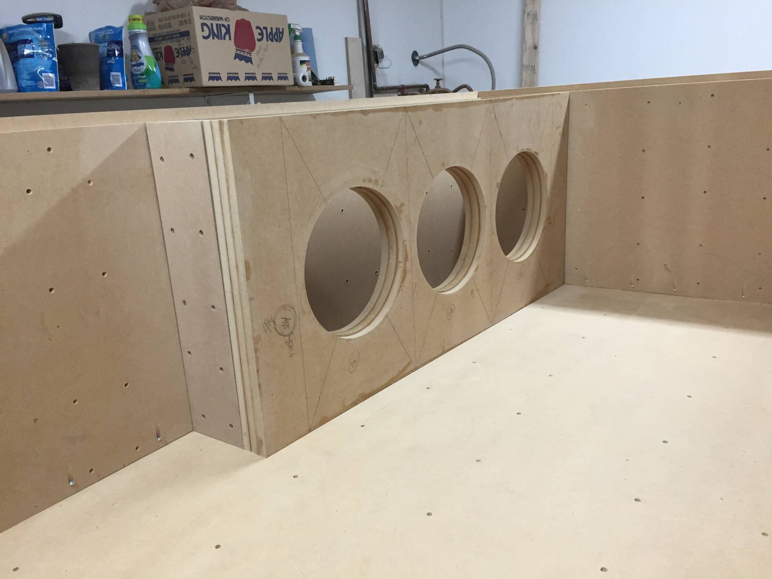

Baffles cut. Test fitting. It starts 8" at the back and tappers down to 5" at the front.
How heavy is that thing? Looking good dude
Sent from my SAMSUNG-SM-G935A using Tapatalk
Thanks man. The box will weigh somewhere around 600-700 lbs unloaded. With the subs in there it will be around 1,000 lbs

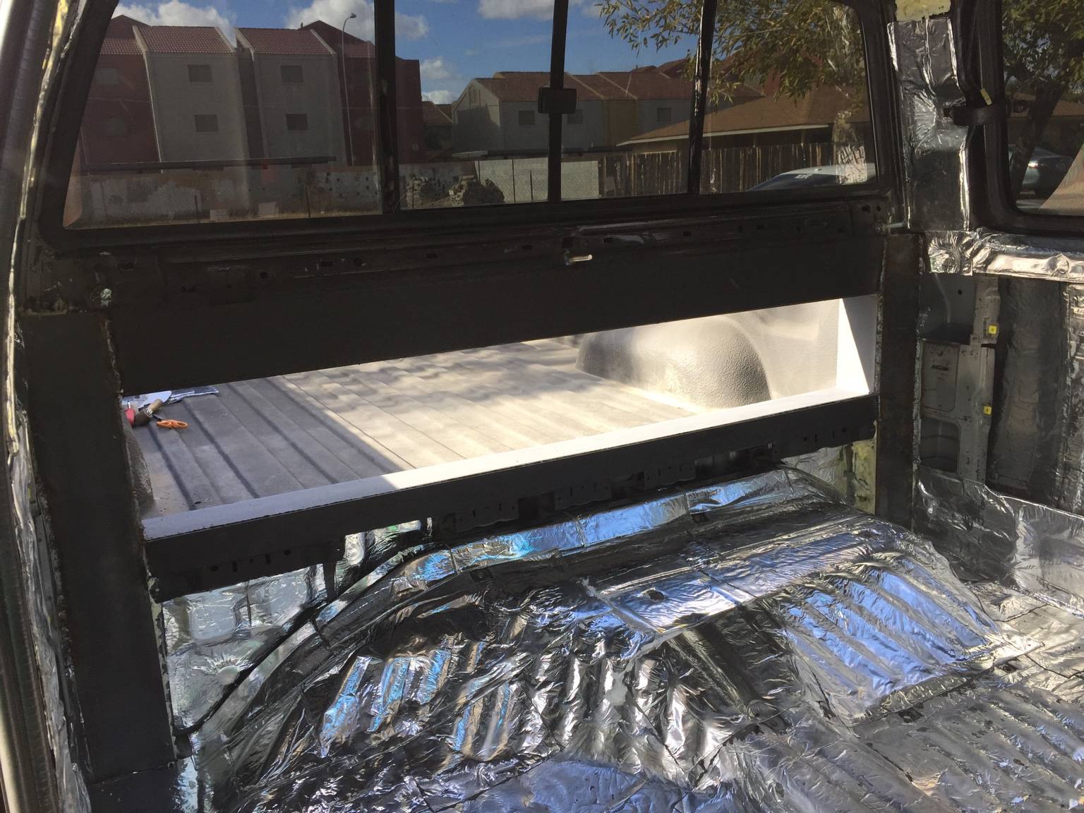

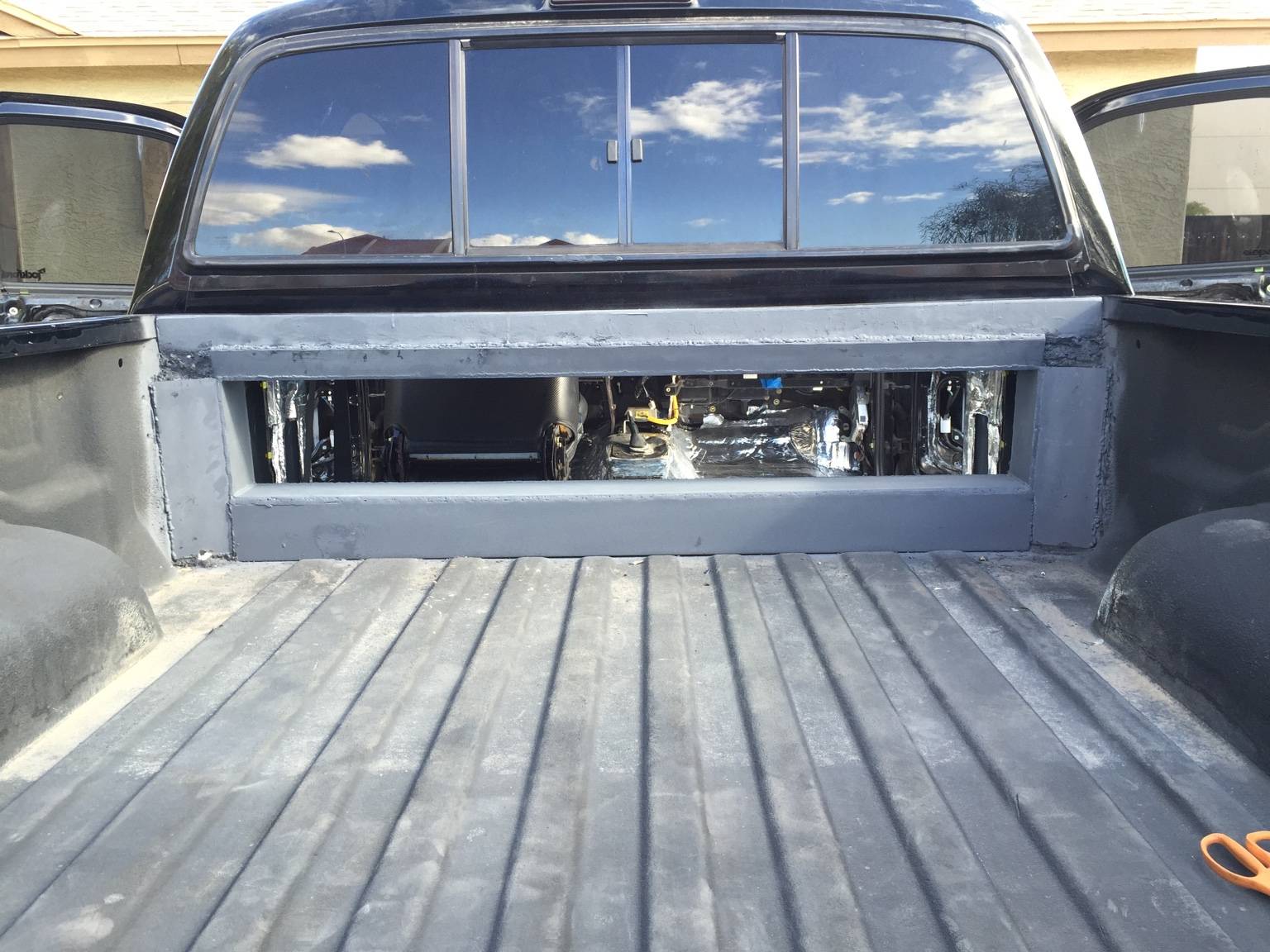

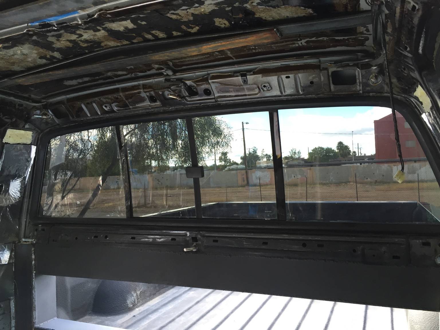

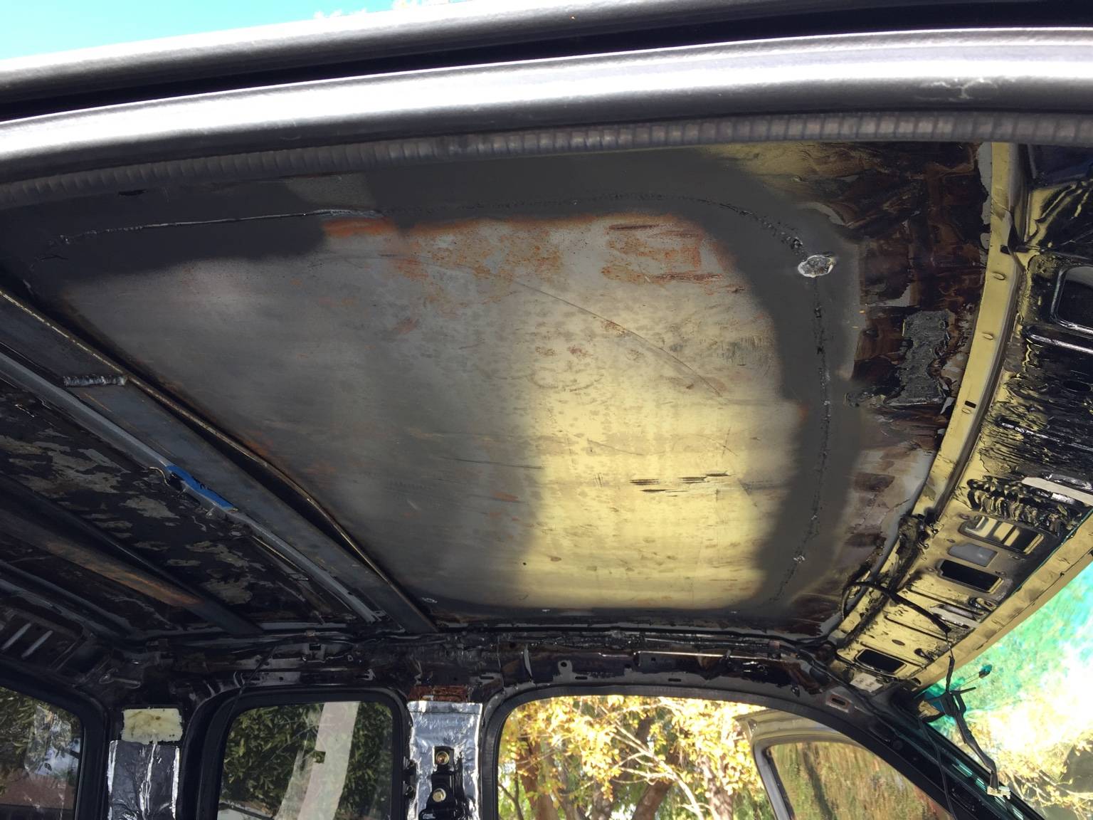

The steel reinforcement is going slower than expected. The blow through is like 90% done (needs a little more grinding), the sunroof delete is about 60% done (needs grinding, working out a few dimples, prime, and paint), and the roof reinforcement is about 50% done. The roof braces are all made but they still need to all be put in and welded then ground down. The guy doing all this could not get the braces to fit exactly along the curvature of the roof so he is having to use some shims to fill in gaps. It's making the roof take much longer than expected so I'm not very happy about that since he told me he could get the steel to be the exact shape of my roof. I don't think I'll be using this guy again. He said everything would take 2-3 months max and we are at 5 months and it still has probably another 1-2 months worth of work if he keeps going at the rate he has been. He is slow that's for sure. But it should turn out okay when finished.
Here are some pics of the steel blow through and sunroof

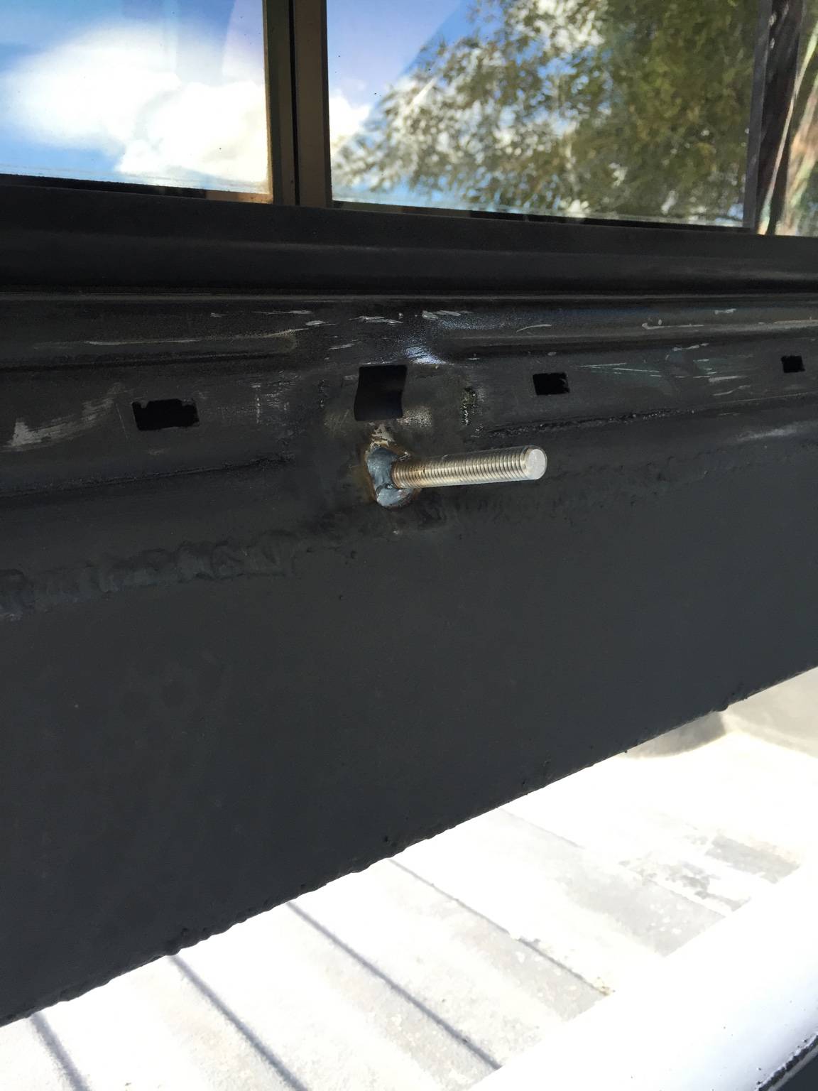

If you look closely you can see 6 pieces of threaded rod welded around the rear window. I'm going to mount a sheet of wood over the back window so I can mount the two 800.4s and the one 400.4.

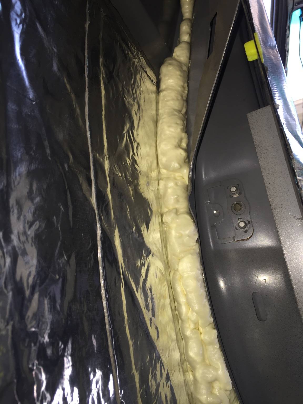

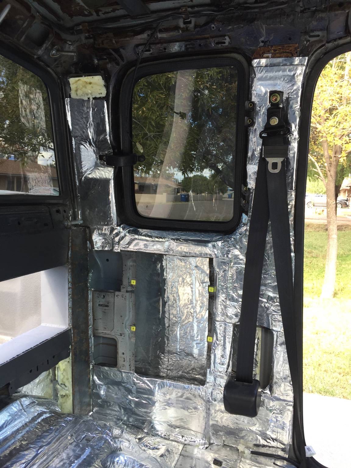

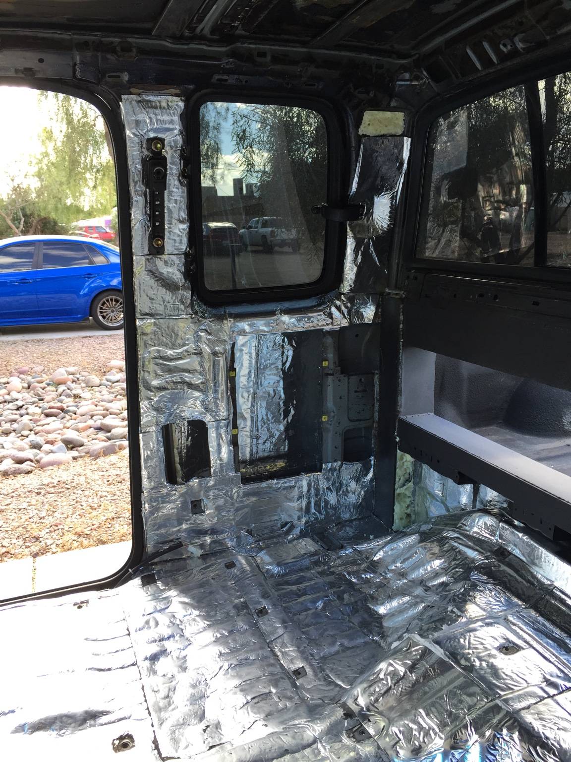

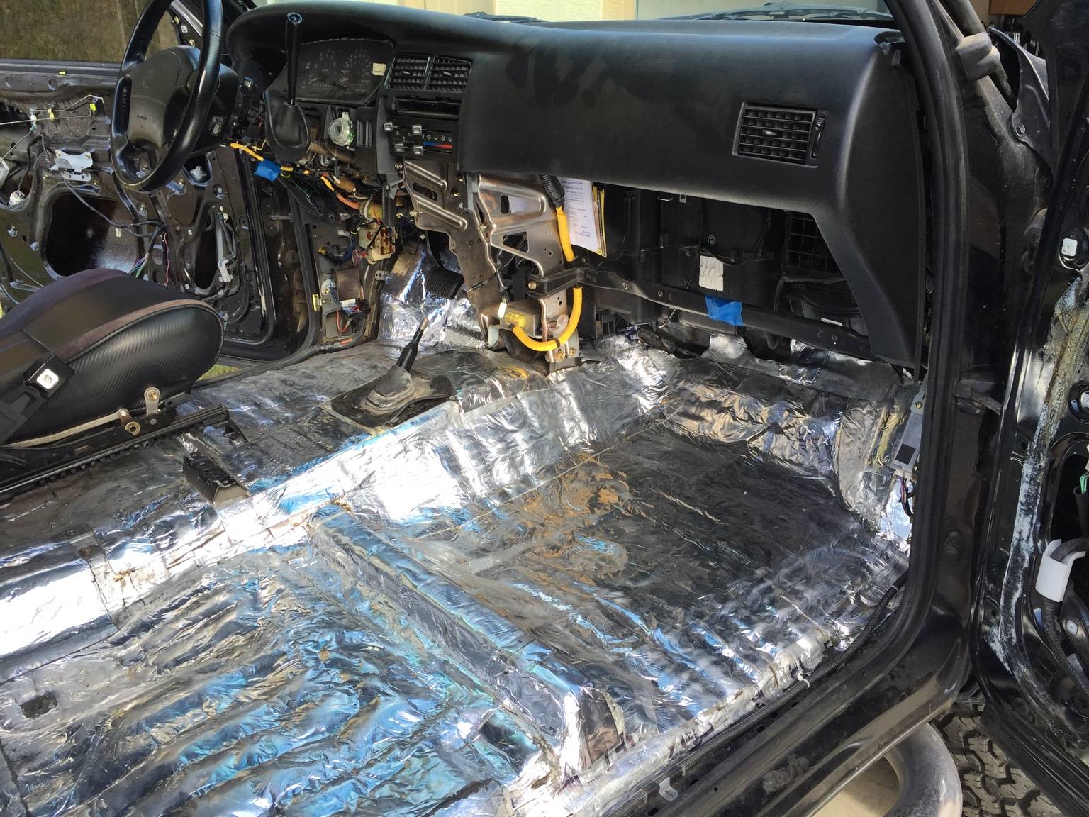

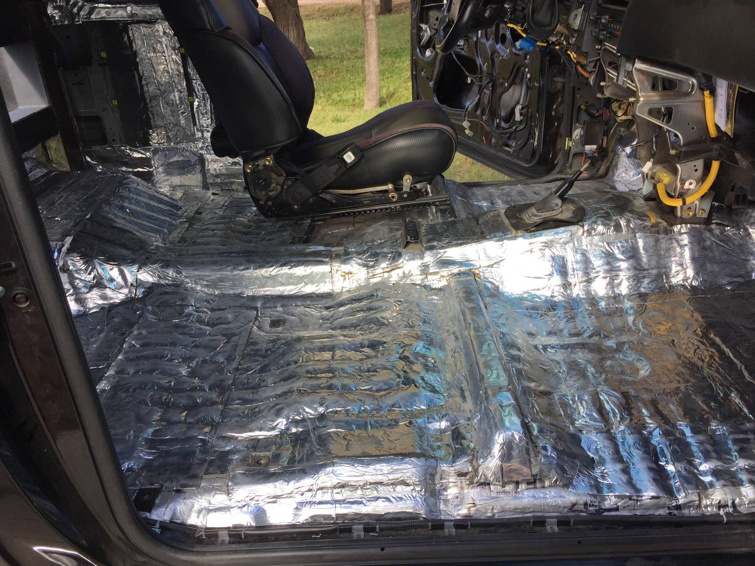

All the deadener is laid for the most part. There are 2 layers on the floor, 3 layers on the outside of the rear walls, and 4 layers on the inside of the rear walls. About 150 sq feet so far. I have 50 sq feet left so I'm going to use that on the inside of my dashboard and on some parts of the door to decouple some steel that will bolt onto the doors. I bought 5 gallons of Second Skin Spectrum so the inside of the doors and roof will be coated with that.

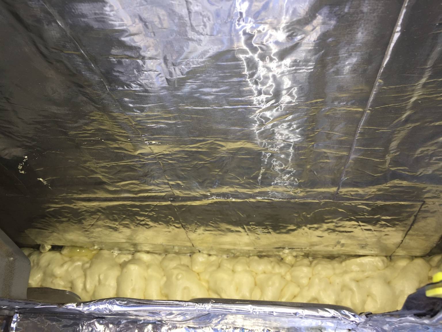

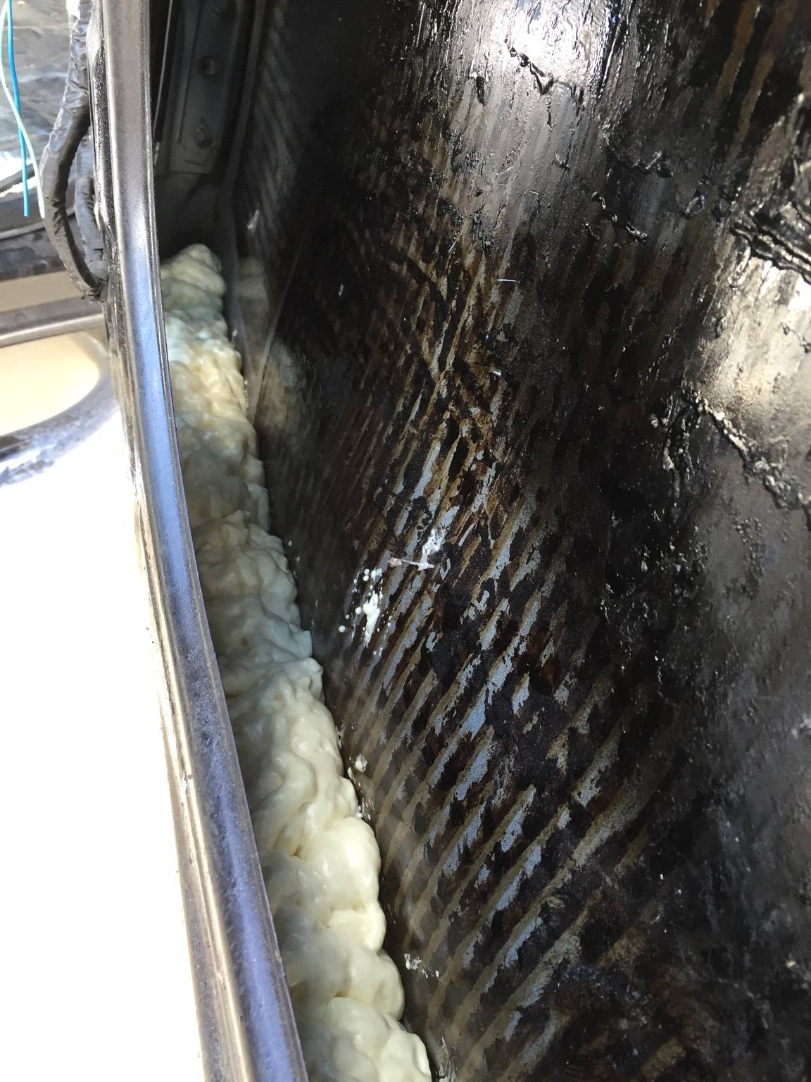

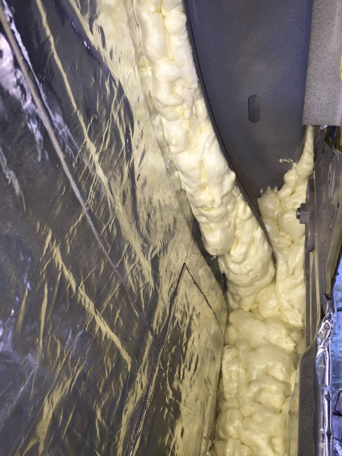

And I had some fun with spray foam to stiffen up the bottom of the rear walls and the bottoms of the front doors.
Shits gonna be solid as a rock once done.
