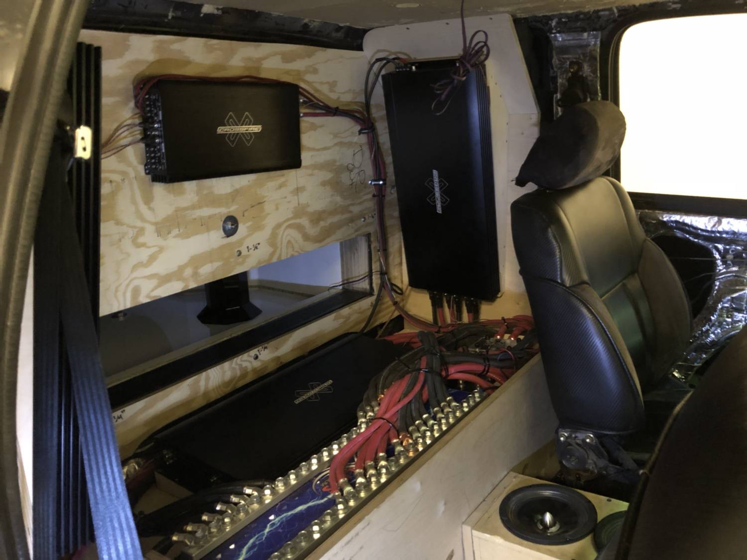

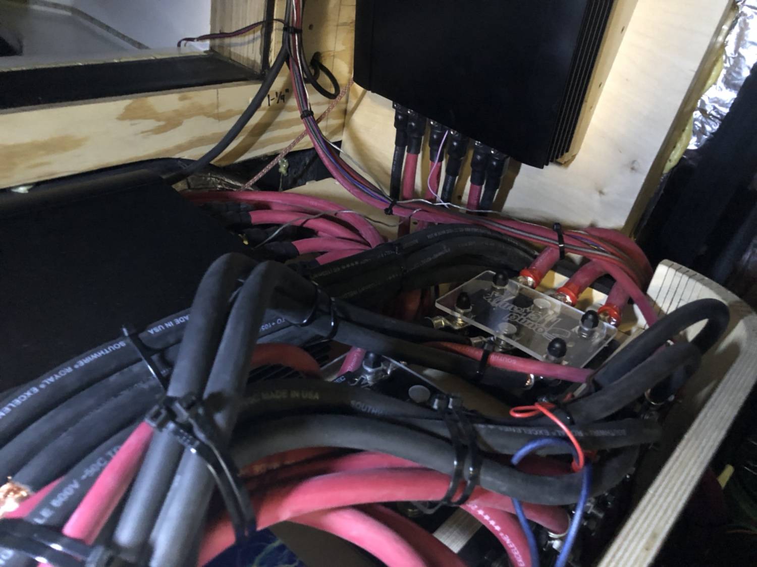

Here are a few pics of the cab. Wiring is a mess and will get cleaned up. And don’t worry the center console is getting thrown out. I had a jigsaw and 20 minutes so this was the result haha.

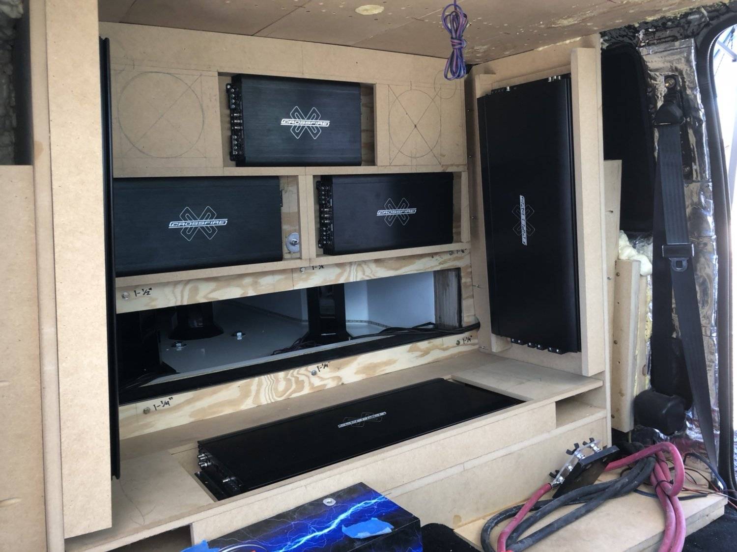

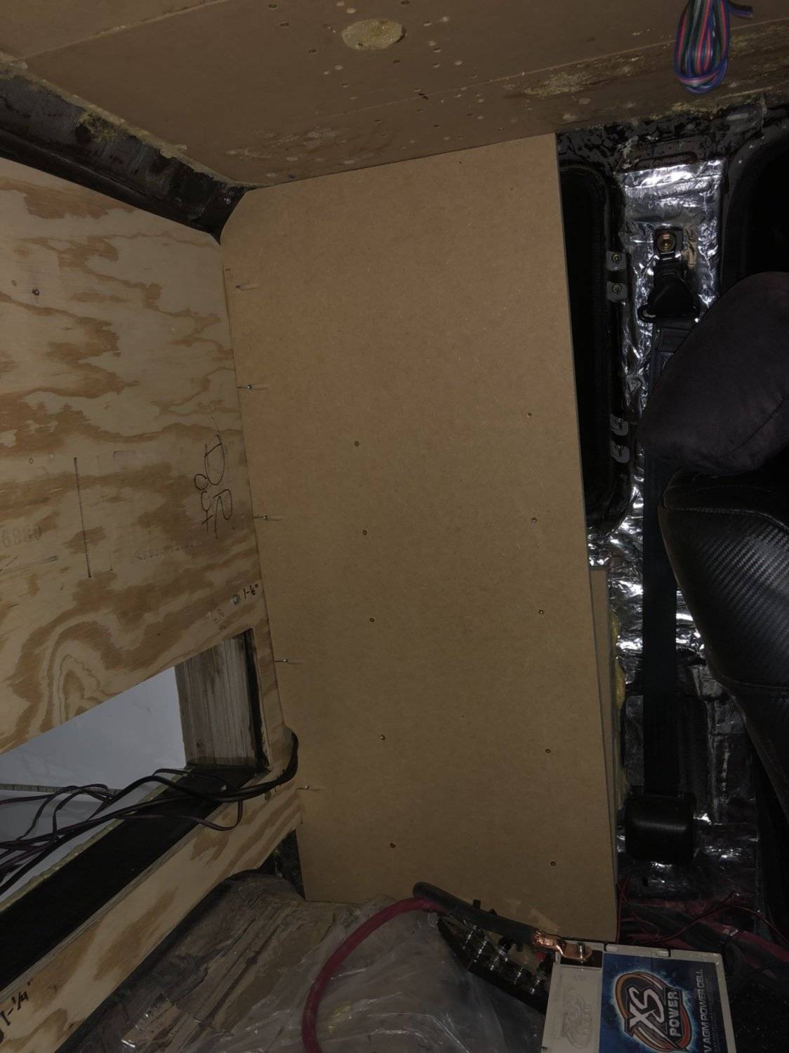

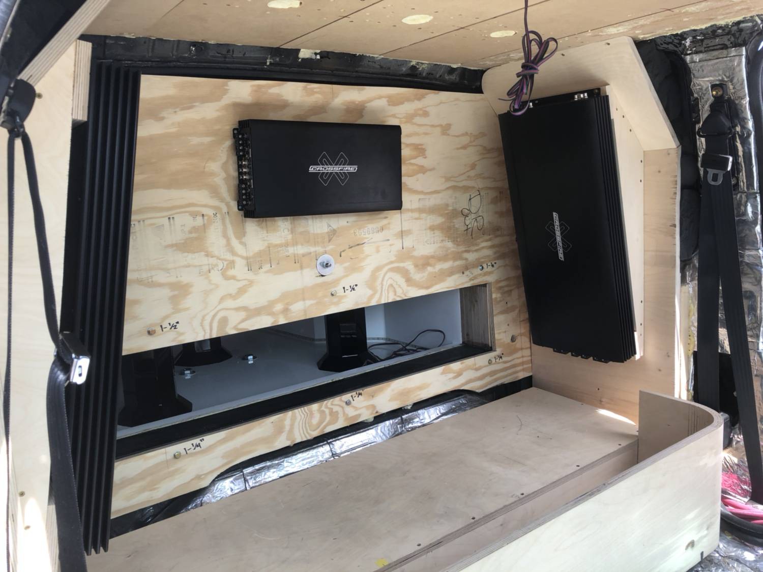

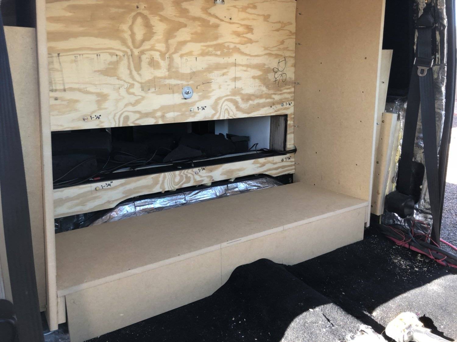

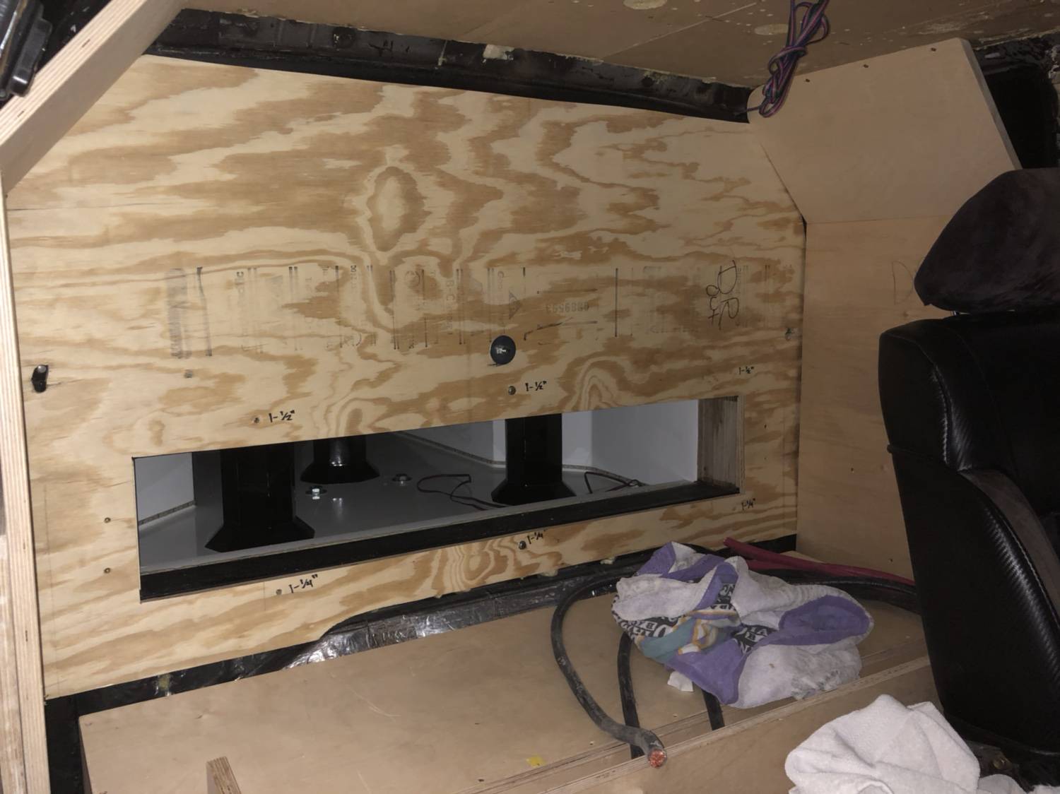

We ripped everything back out and started over in the cab. The first go around was a great trial. We learned a lot about what needed to be stiffer and what needed to be redone to make beauty panels a little easier on us. It’s getting there!

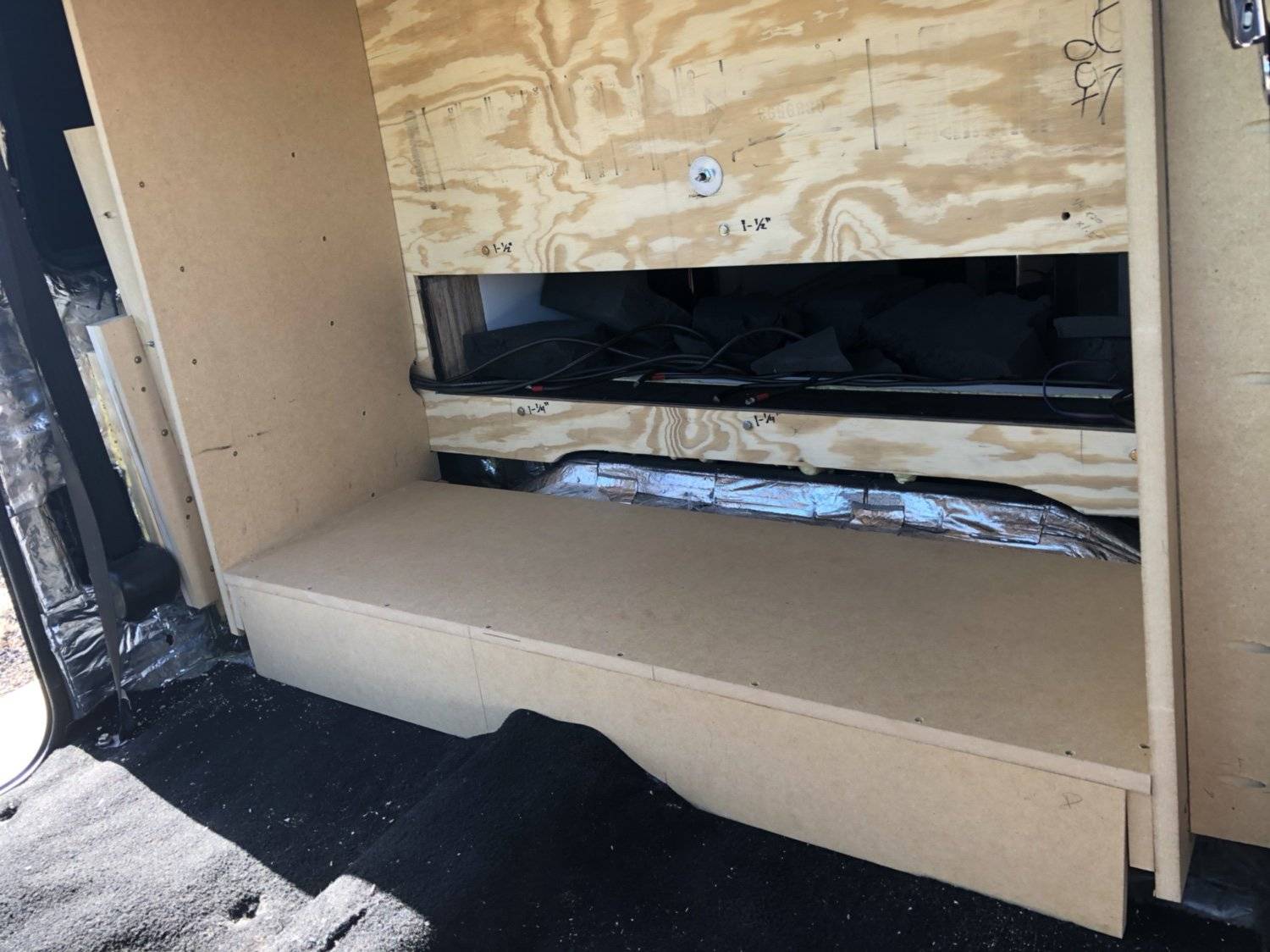

The base structure of the two side walls, rear wall, and floor is mostly done. A lot of areas are double layered and a few more braces are left to add. Everything is extremely stiff now! Shouldn’t have any flex issues anymore //content.invisioncic.com/y282845/emoticons/smile.gif.1ebc41e1811405b213edfc4622c41e27.gif

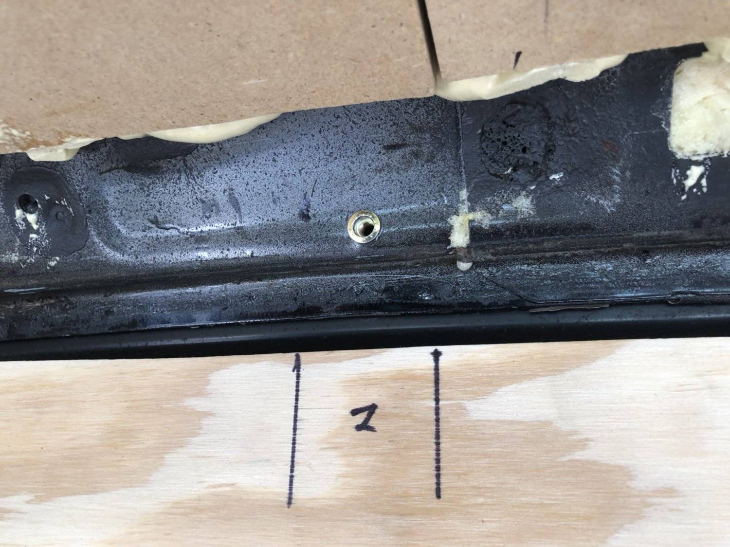

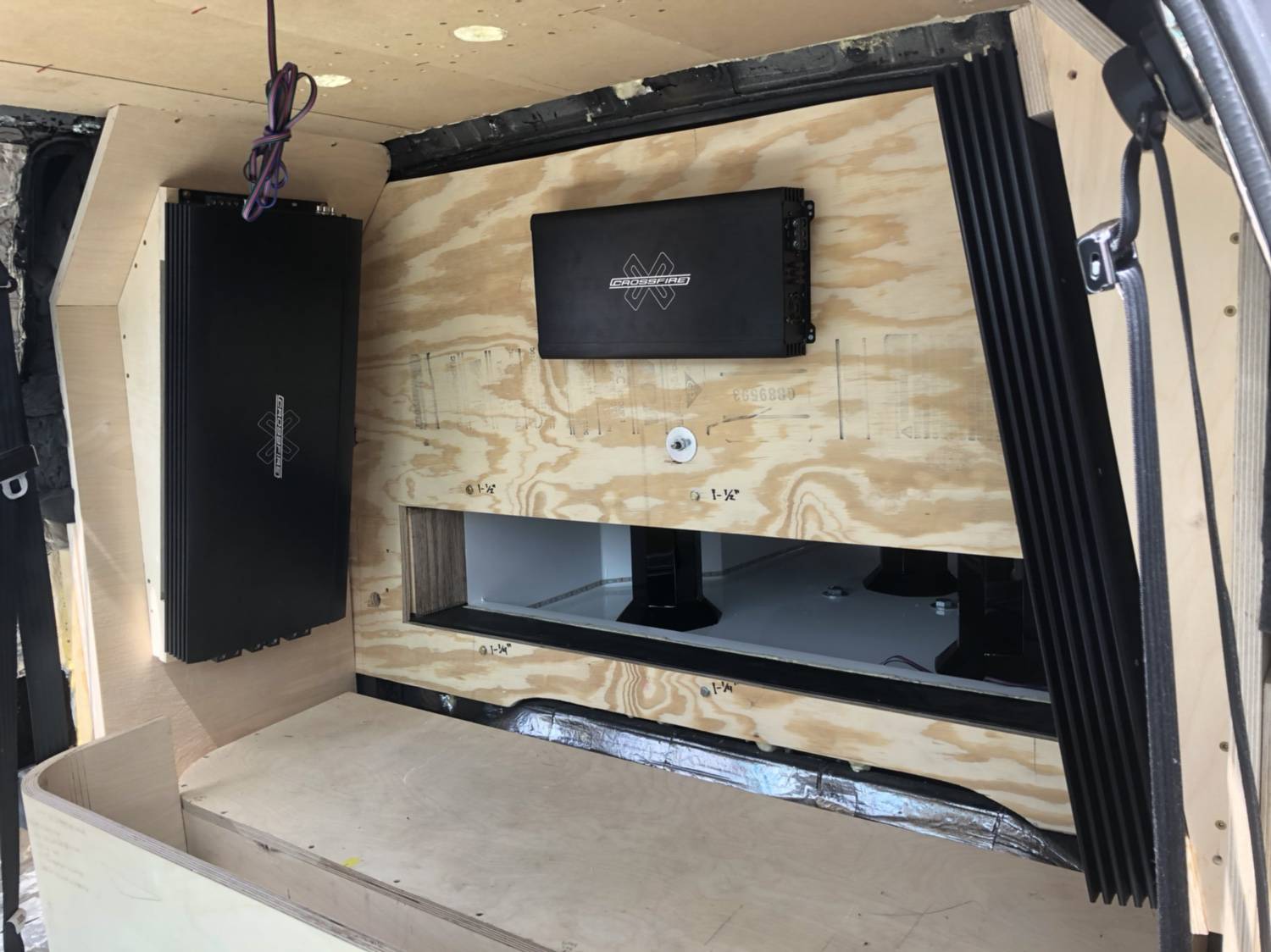

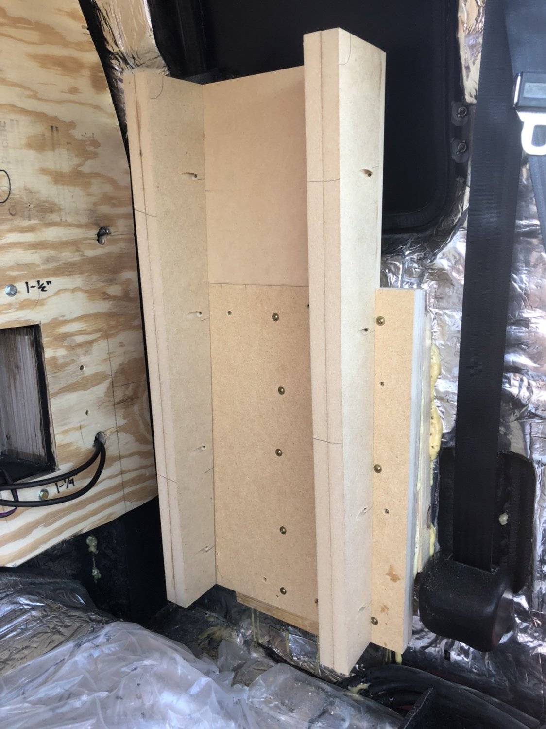

New side wall sub-base. 1.5” thick everywhere. Glued and screwed. We wanted to go with less of an angle for the side walls so gravity isn’t pulling the top of the amps down as hard as the first go around. We just need to attach the top of the wall to the roof.

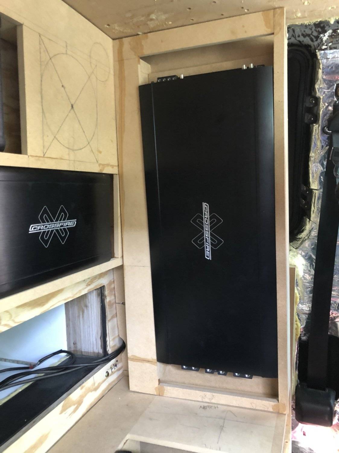

New side wall that the 4K will mount to. Then we will build a secondary structure surrounding the amp then the beauty panels will attach to the secondary structure.

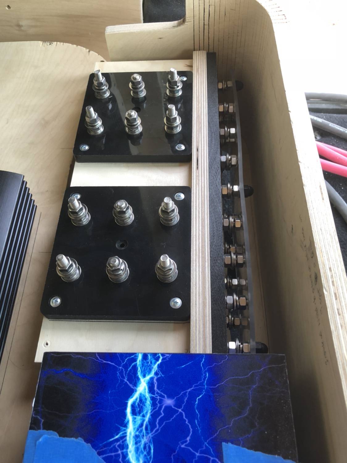

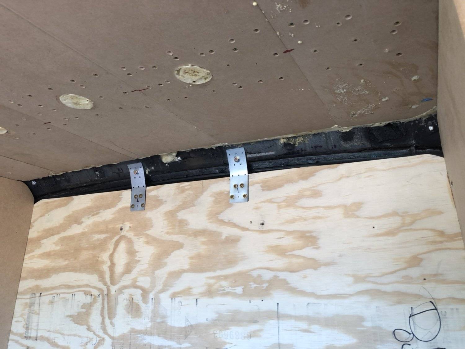

Messed around with some steel rivnuts. These things are awesome and will be used in a lot of other areas. We bolted in a couple framing brackets to stiffen up the center of the rear wall. We will also be connecting the rear wall to the roof which should stop all of the flex.

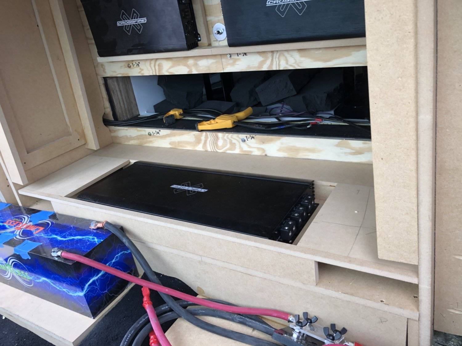

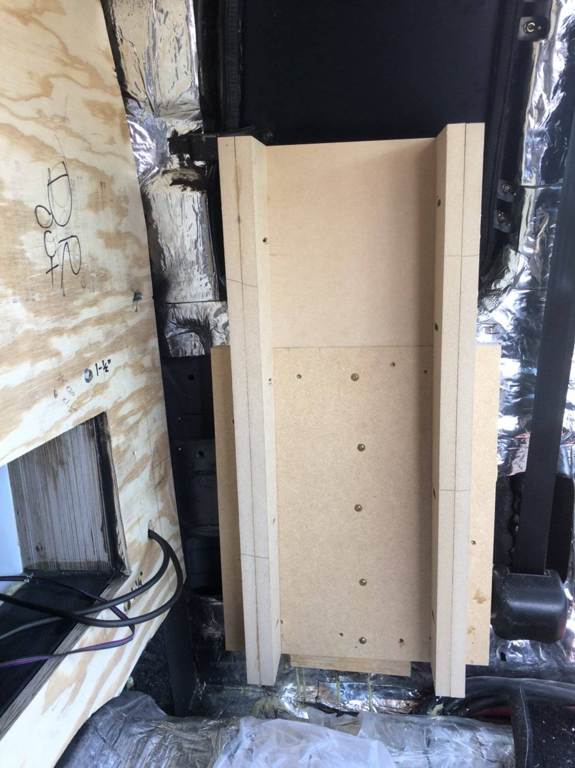

Some pics of the floor that the 3rd 4K mounts too. We still need to build the area in front of the floor that will house the battery and some fuse blocks.
Here is how the beauty panels will lay out around the amp. The main beauty panel that covers the majority of the wall will be wrapped next black vinyl. Then the 2” lip around the amp will be a press fit panel in white flock (similar texture to suede) that will make the amps look flush mounted. Should really help make the black amps pop! I think it’s going to turn out really clean.

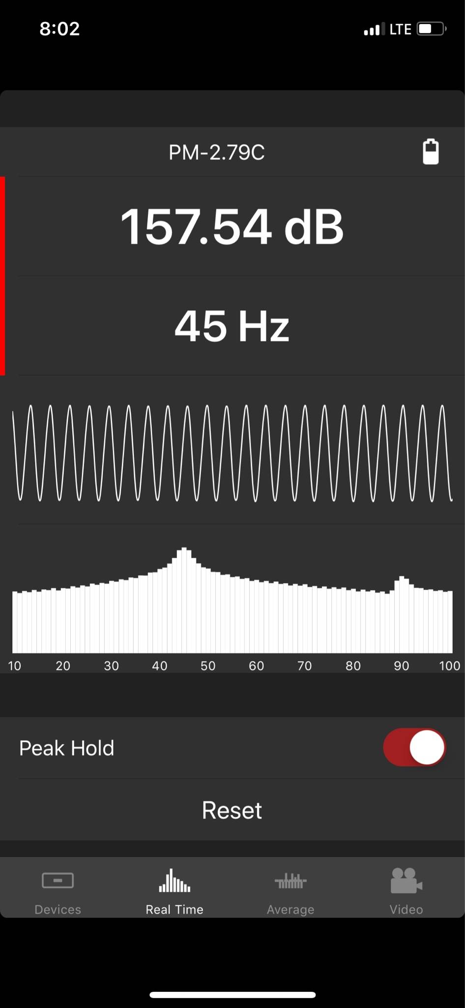

is there a second peak up at 90? or is that just background. can't tell if that's a sweep and your entire spl curve or not
I don’t think so lol. It must just be background because that was a burp I did. I barely messed with it while it was playing because I knew it was getting redone and I didn’t want to spend much time testing. I think I did one sweep before this then burped at this frequency at one show then it got torn apart. It will still be a little before we run a sweep to see the actual response curve. We want the interior mostly done before we test and mess with the port and get things finalized.

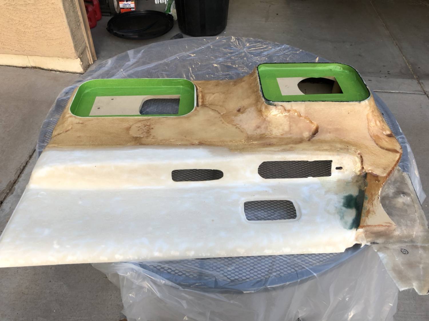

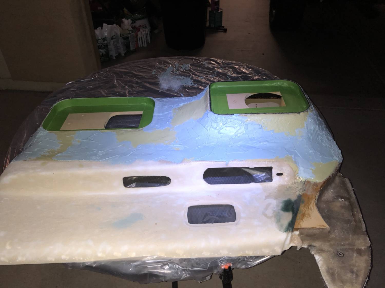

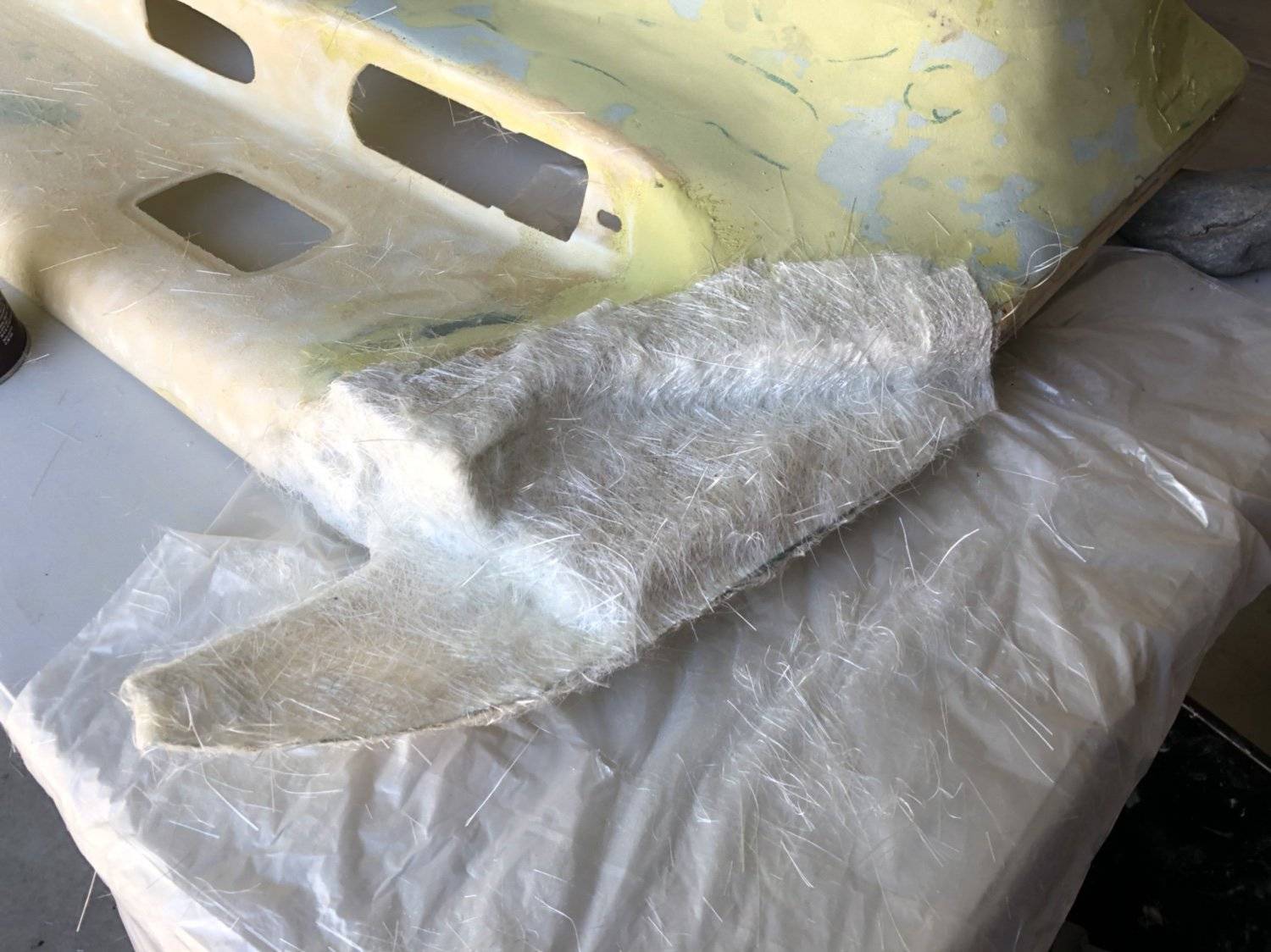

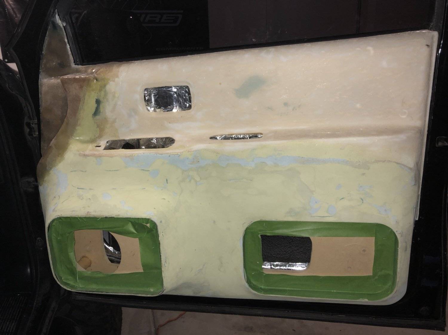

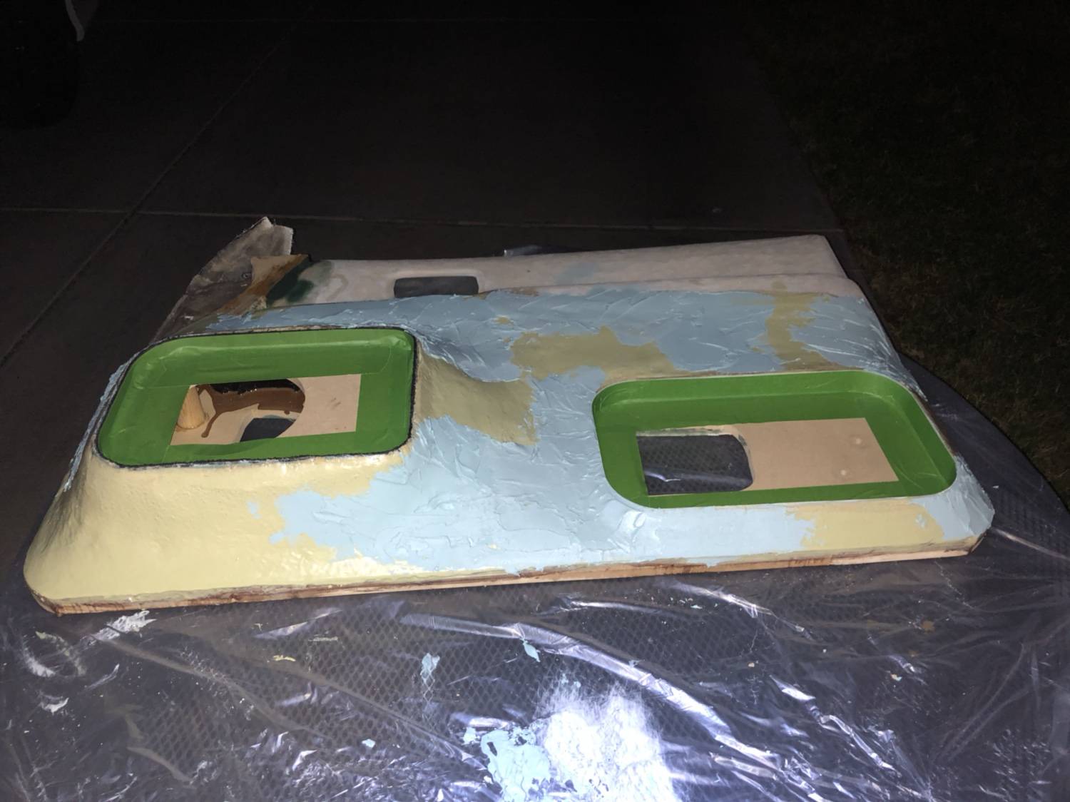

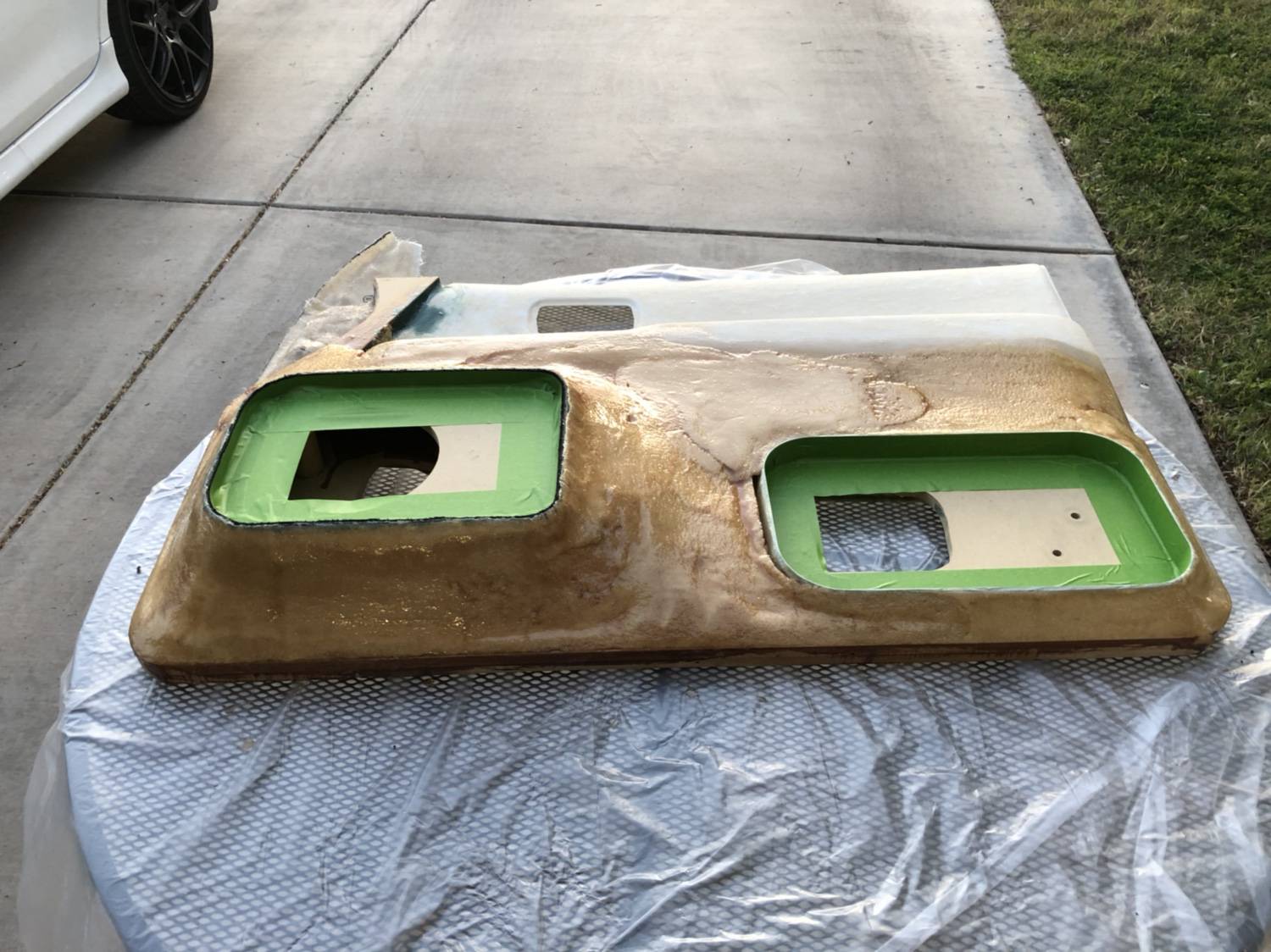

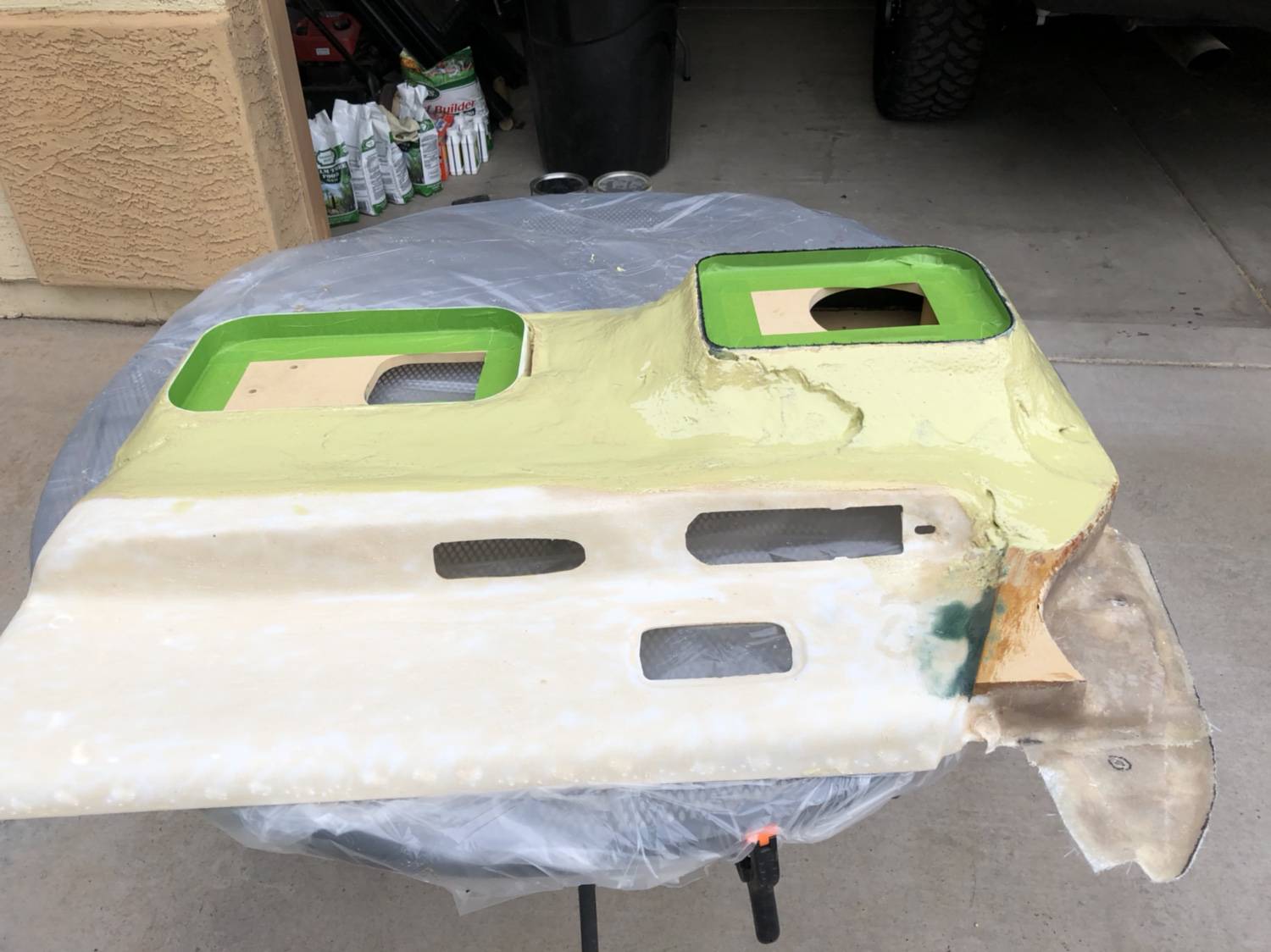

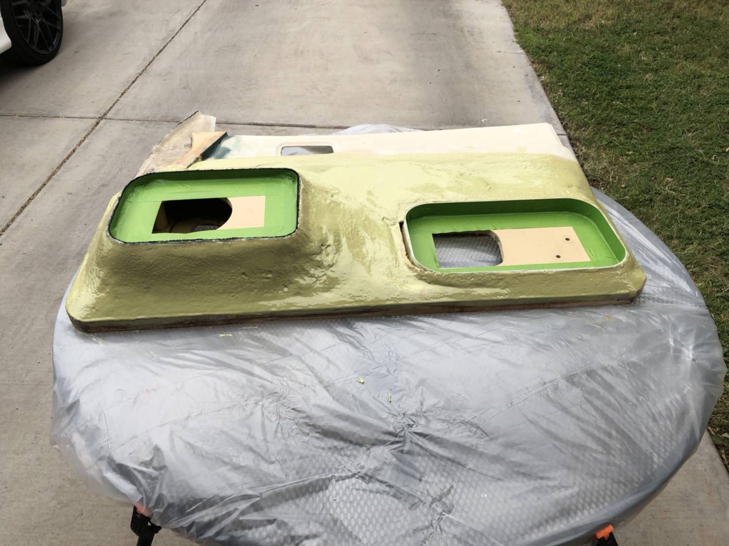

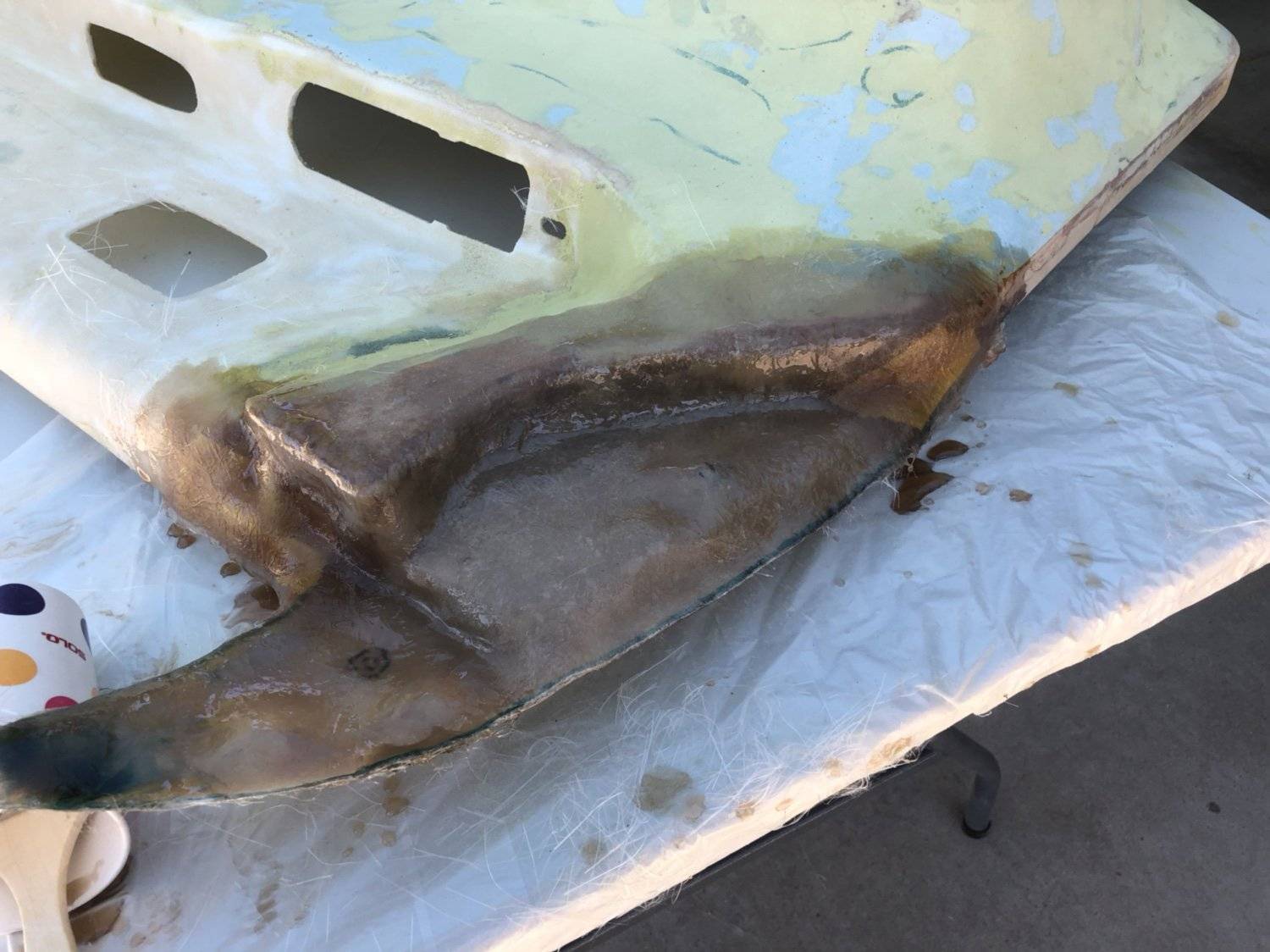

Well, looks like we will be starting over on the doors. Back in high school I fiberglassed my doors to fit 3 speakers. For this rebuild, I was able to salvage about 1/3 of a usable door panel. Essentially the part that houses the window controls, door handle, etc. Unfortunately, at the time we were ready to start these custom door panels, I could not find a pair of used panels anywhere. No junk yard, not online, no where. My specific model truck is not very popular to say the least lol. So with that, the majority of the door had to be made from scratch. It has been a bit of a nightmare but I’ve learned a ton from attempting this with my buddy. For some reason the other day I decided to look on eBay and I was able to find a pair! I just ordered them and they should be here in about a week. We will only have to make a pod that bolts to the door now for 1 or maybe 2 6.5s. Should go a million times quicker, will fit better, and look a little cleaner since it’s a factory panel. This will help ensure that the truck gets done by October
Some final pictures. I’ll keep this door for now just in case but after the new ones are done it will get tossed out.
Added 2 more layers of mat to the upper left corner

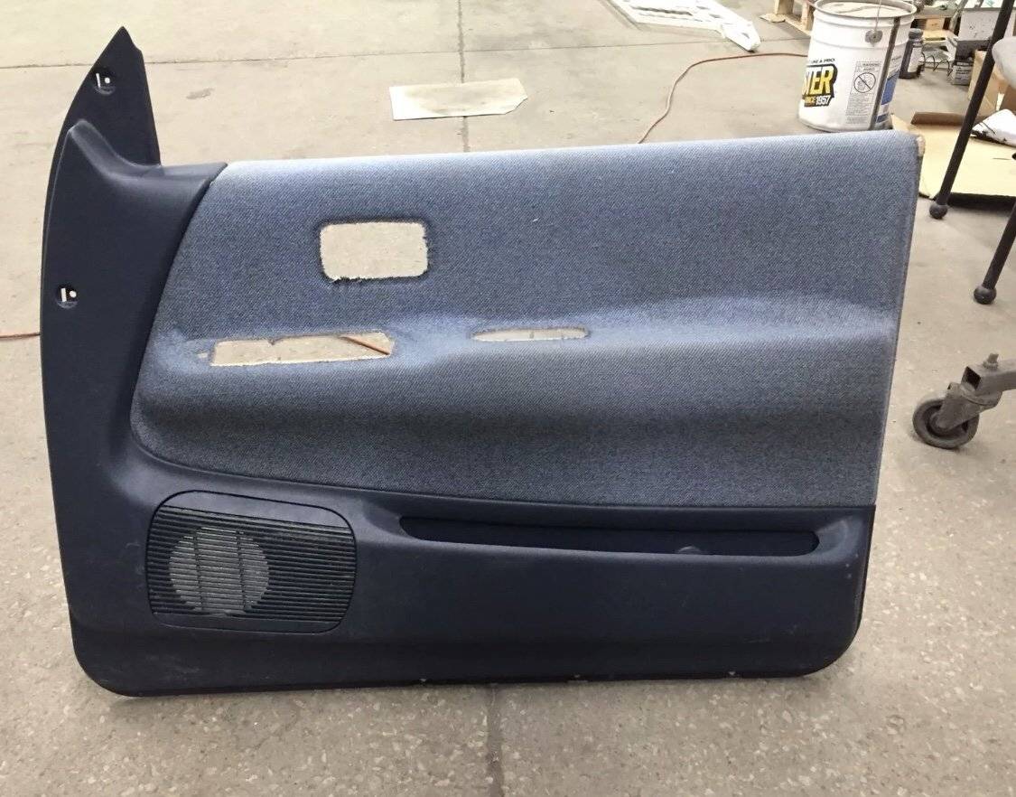

Last test fit before I found and decided to order the new factory panels.
The new panel we will use as the base

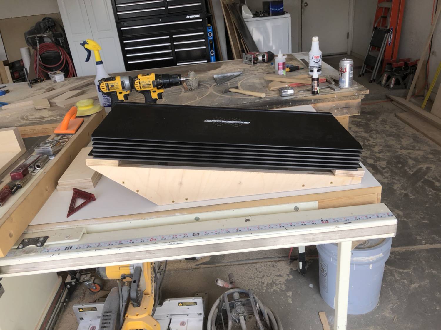

Assembled amp mounts. Glued and Kreg together.

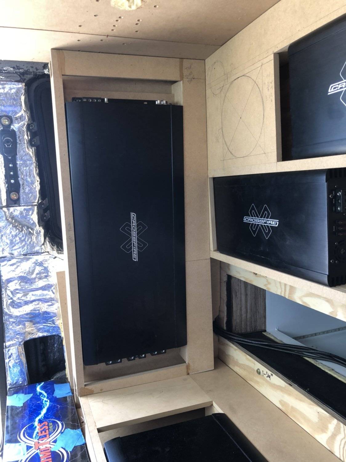

Test fitting the amp rack and amps

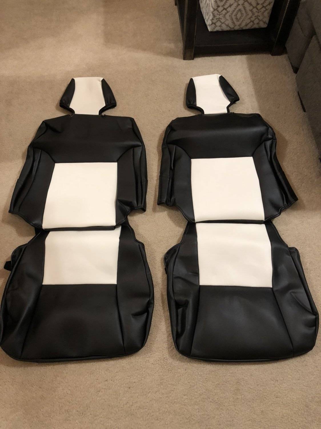

Got some custom fitted seat covers made through GT Covers. Really good quality and much cheaper than getting my seats reupholstered. Good enough for a demo rig.

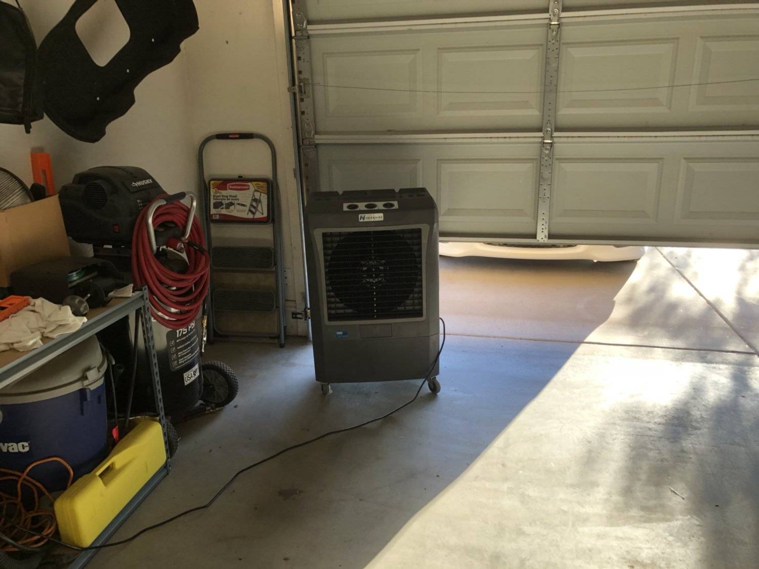

Finally picked up a swamp cooler as well. I can’t believe I’ve waited this long to buy one. It’s a smaller one because I still needed to fit 2 cars in the garage, but it works great! 3100 CFM and cooled my 20x20 garage down from 115 to 100 in just an hour. Big difference even just with the good air flow and circulation.

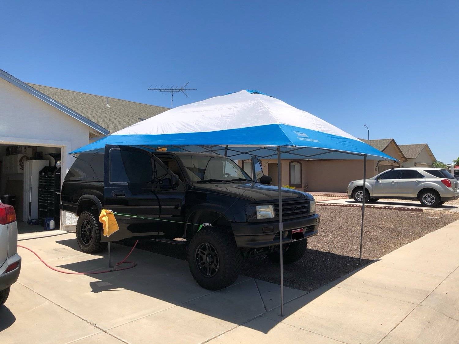

Also got a large 13x13 canopy for when I’m over at my buddies. I couldn’t believe how much of a difference this made when we were in the truck

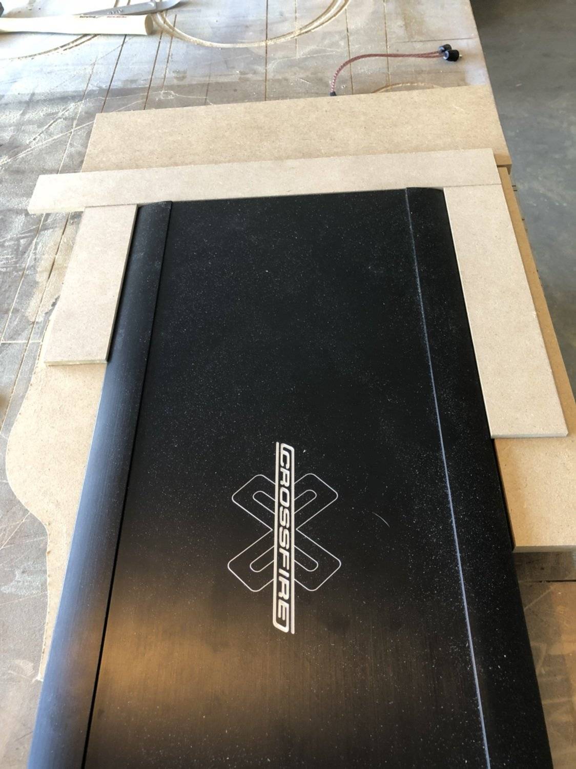

Got started on the floor 4K beauty panel template. These templates will be cut out of a single piece of 1/2”. We just glued a bunch of scrap pieces together to make the templates.
The large gaps on each side of every amp will hold a press fit cover to hide all wire connections. The main beauty panel will be wrapped in black vinyl and these press fit covers will be white. Should look really clean when it is all finished.

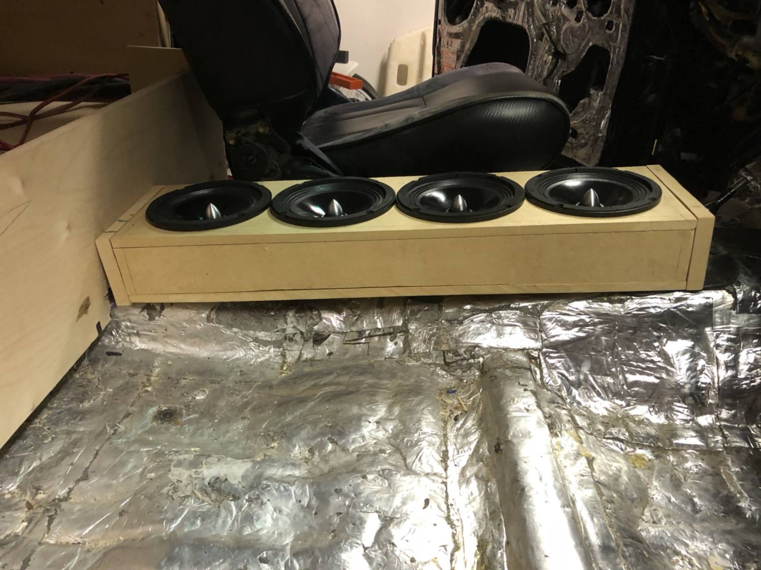

This rear wall beauty panel will also hold a 6.5 and super tweet in each corner.

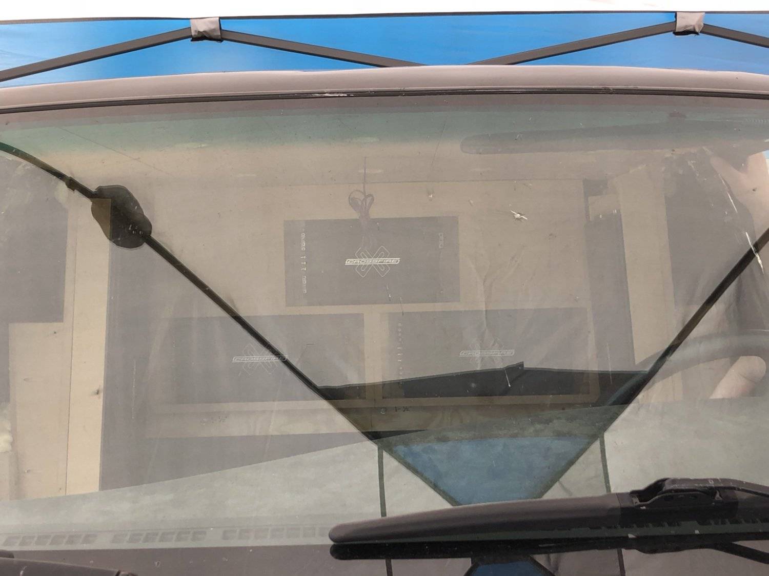

Kind of hard to tell with the glare, but the amp racks looks sweet through the windshield imo
