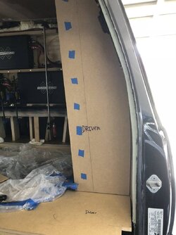

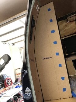

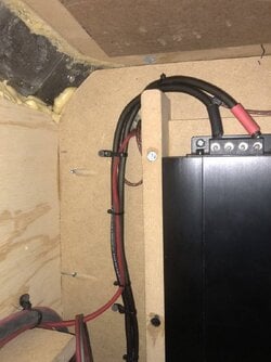

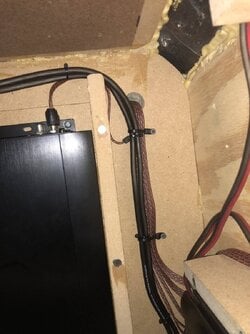

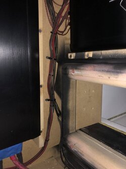

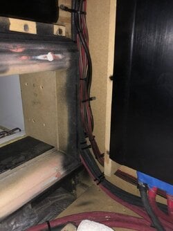

Zip tie and secured the 6 runs of 2 awg, 2 runs of 8 awg, and 6 runs of 14 awg to the side walls.
Driver side
Passenger side. 4 runs of 14 awg and 2 runs of 8 awg

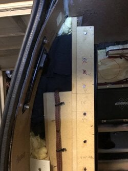

Cleaned up and secured the sub wiring and RCAs to the side wall 4k sub amps

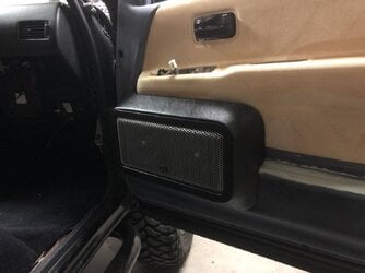

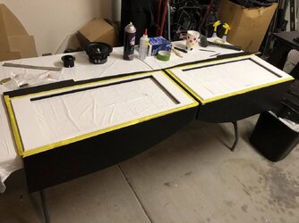

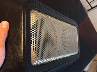

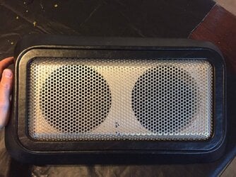

Door pods are also pretty much done. The bare wood you see behind the grill will be flocked white later on. I’m happy with how they turned out for the little time that was spent on them.

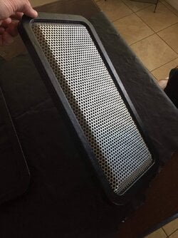

Added a small crossfire logo to the grill that comes on the stock 6.5 grill covers. Nice little touch imo6FE4AD7B-DD59-4C4C-A40F-937BFD4B709A.jpeg

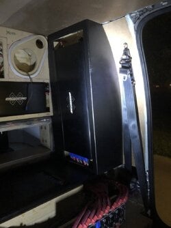

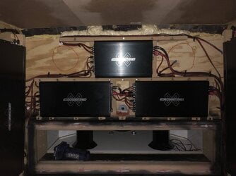

Got the multichannel amp wiring 100% done and test fitted the beauty panel one more time

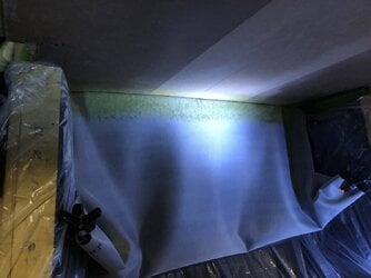

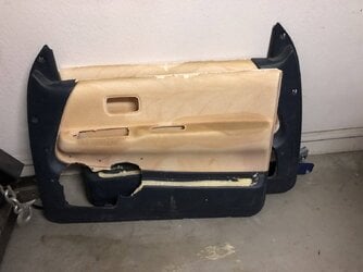

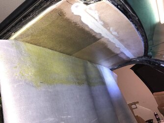

Stripped the old fabric off the doors. Was harder than I thought lol. Need to seal and body work over the spray foam trash area then they will be ready to flock and wrap.

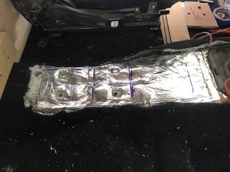

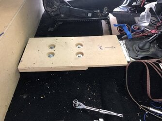

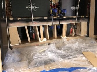

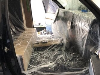

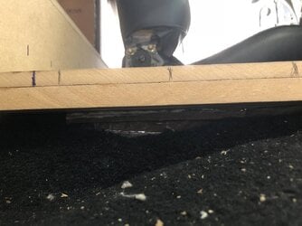

Started the base for the center console. Drilled 4 holes through the floor. Added 4 more layers of 60 mil for 6 layers total under the base.

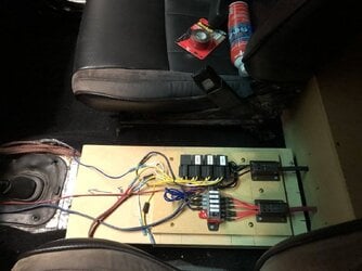

wiring is not finalized. Just temp so I could get it playing again. But this is where the relay and fuse panel will go.

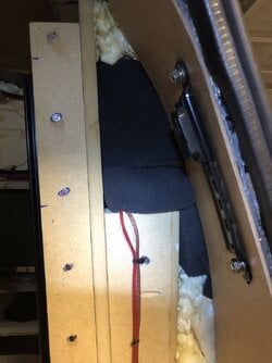

Stuffed some packing foam between the side walls and quarter panel window. These quarter panel windows do not move at all now even at 20hz :)

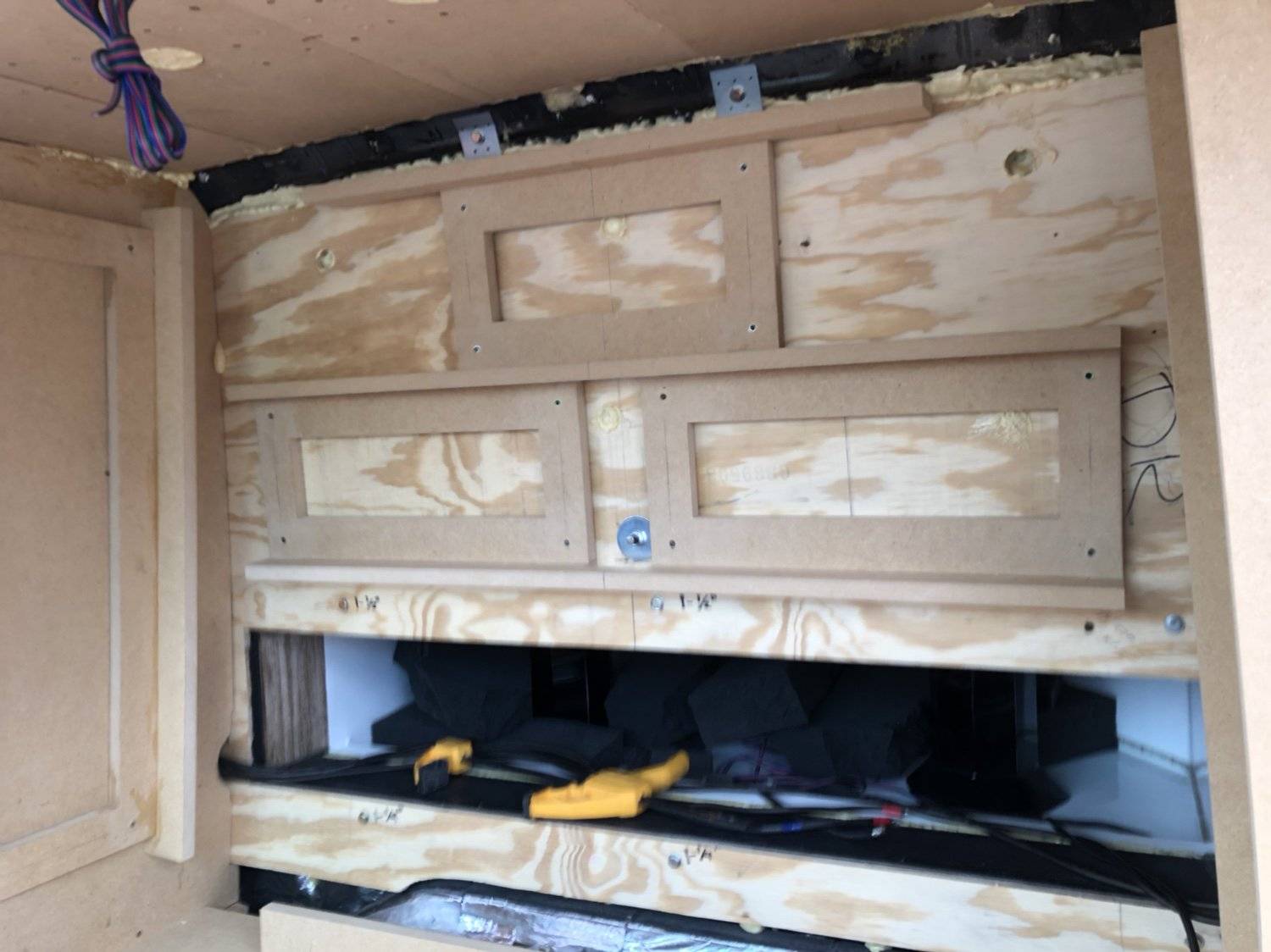

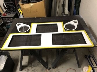

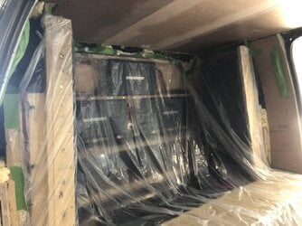

Test fitted side wall beauty panels again and glued and body filled the 1/8” hardboard to the truck wall as well.

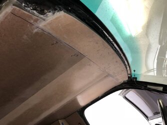

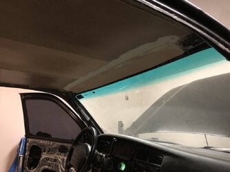

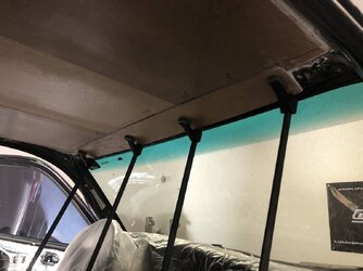

Glued some 1/8” hardbord that connects the roof and front windshield piece. Body filled the seamed. It is flush enough for me. Should look fine once I wrap the roof in vinyl. Also glued some 1/8” hardboard around the port to flush it out a bit before vinyl wrapping

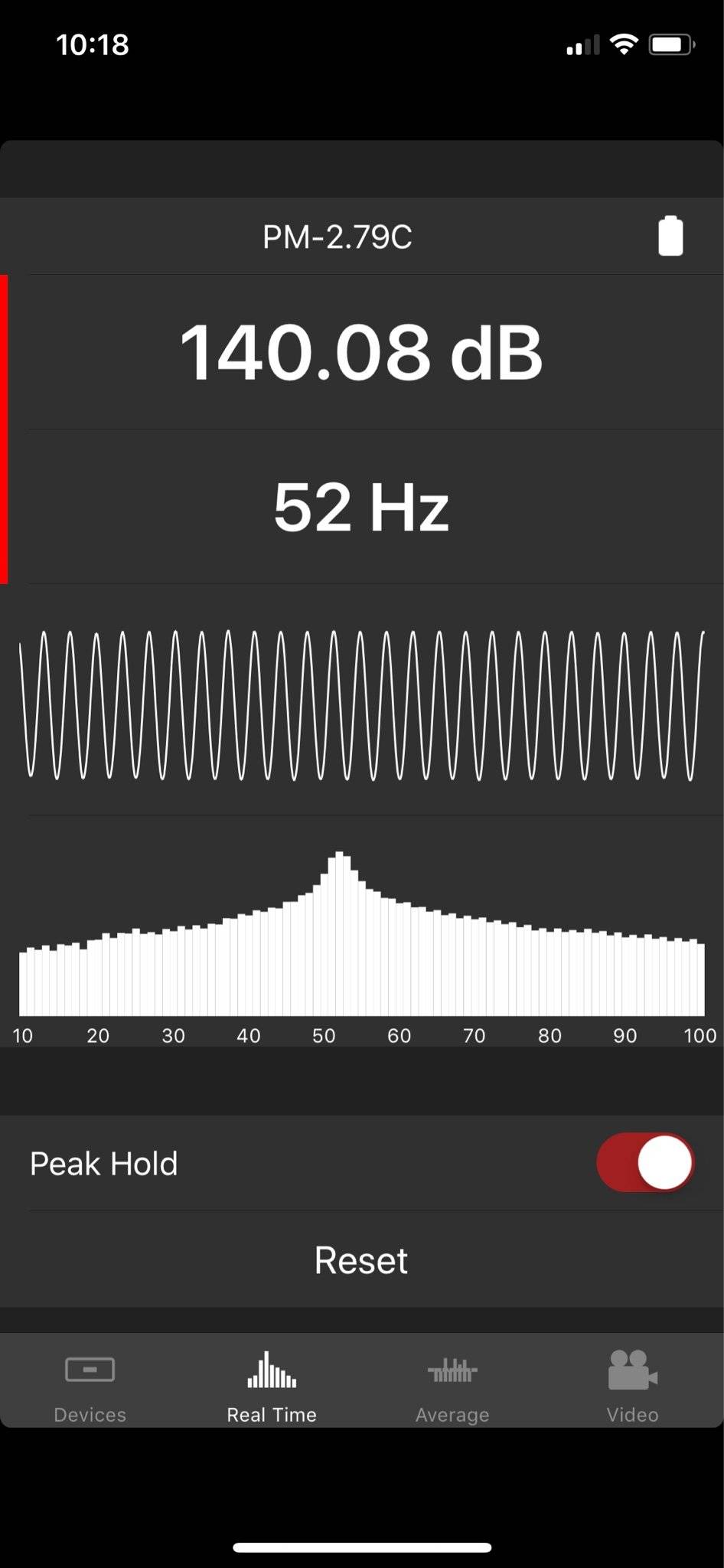

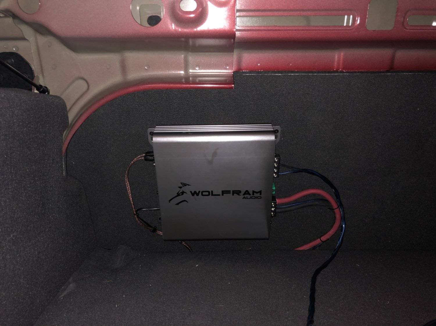

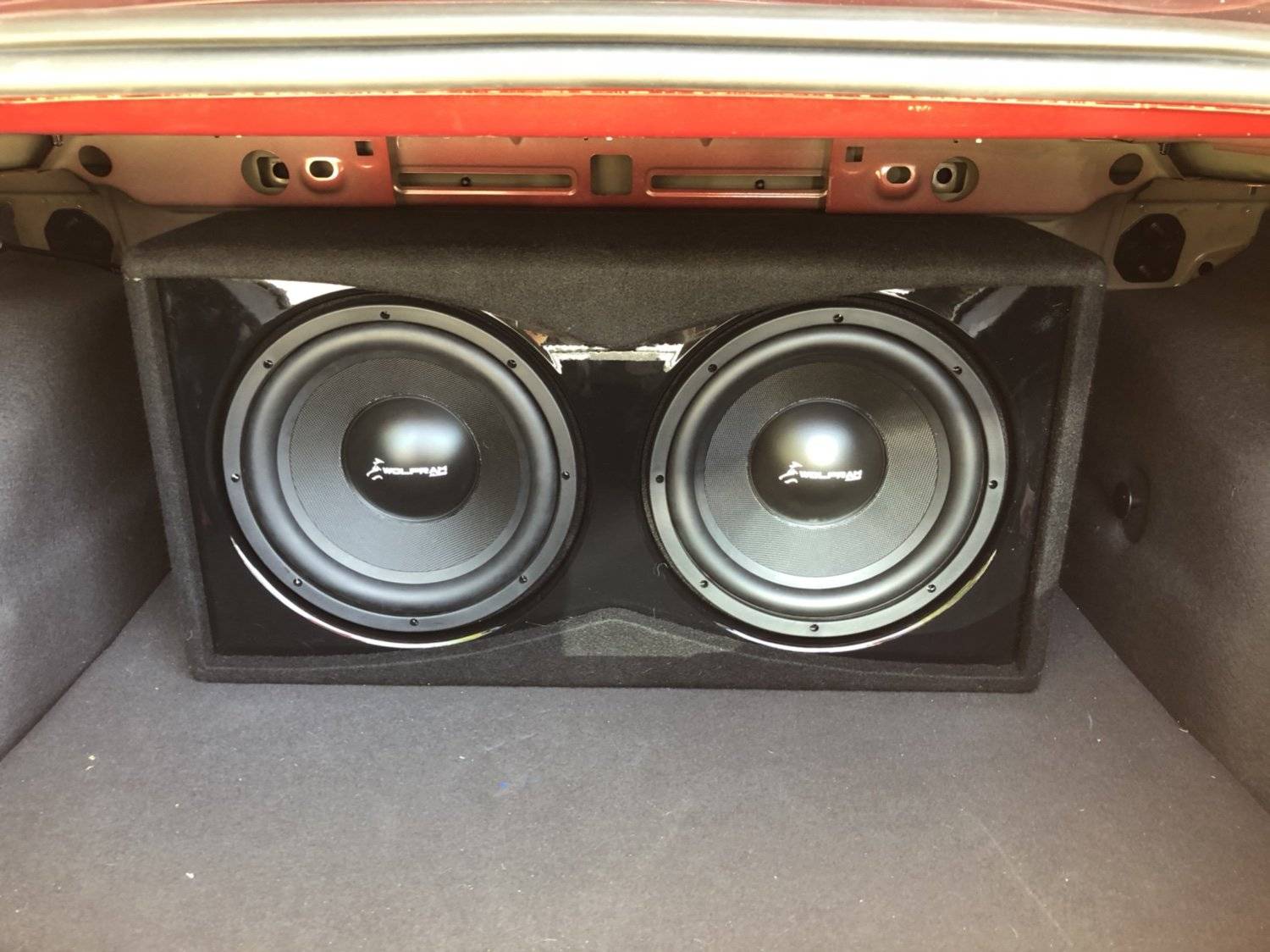

Used a weekend to install a little system in my wife’s car. 2 Wolfram Al-12s (300 rms) and a Wolfram W-600.1 amp. Does a 140 in a prefab sealed box lol. I’m pretty impressed with it. My buddy Colin started Wolfram and is producing some very good quality amps and subs. I’ll definitely be running his gear when I rebuild my Camry. Maybe just a little trunk 4th order with a single AU-12 (3000 rms) sub and a W-4500.1 amp.

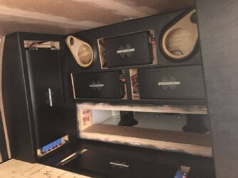

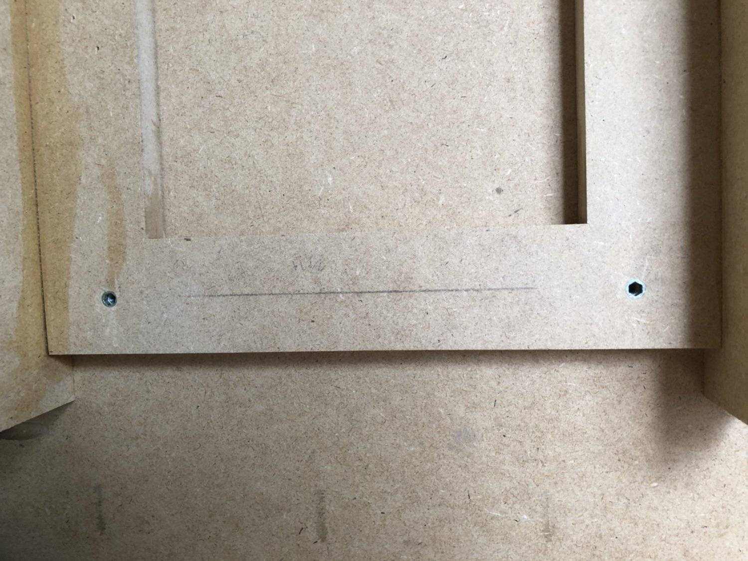

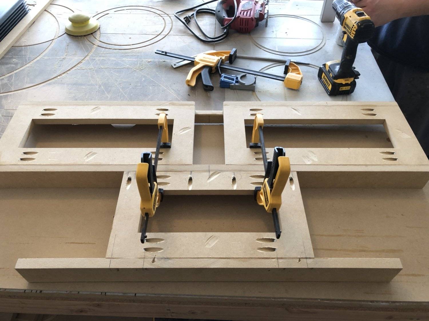

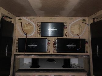

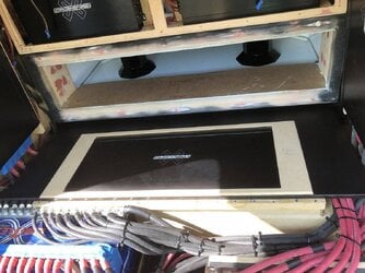

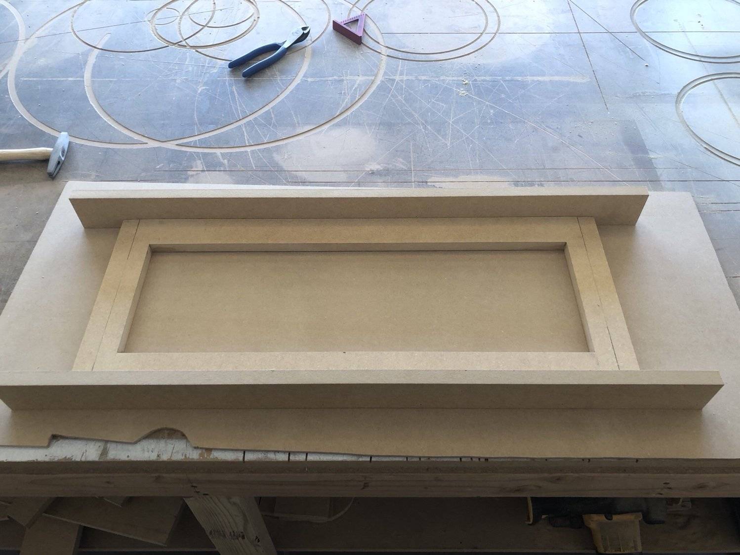

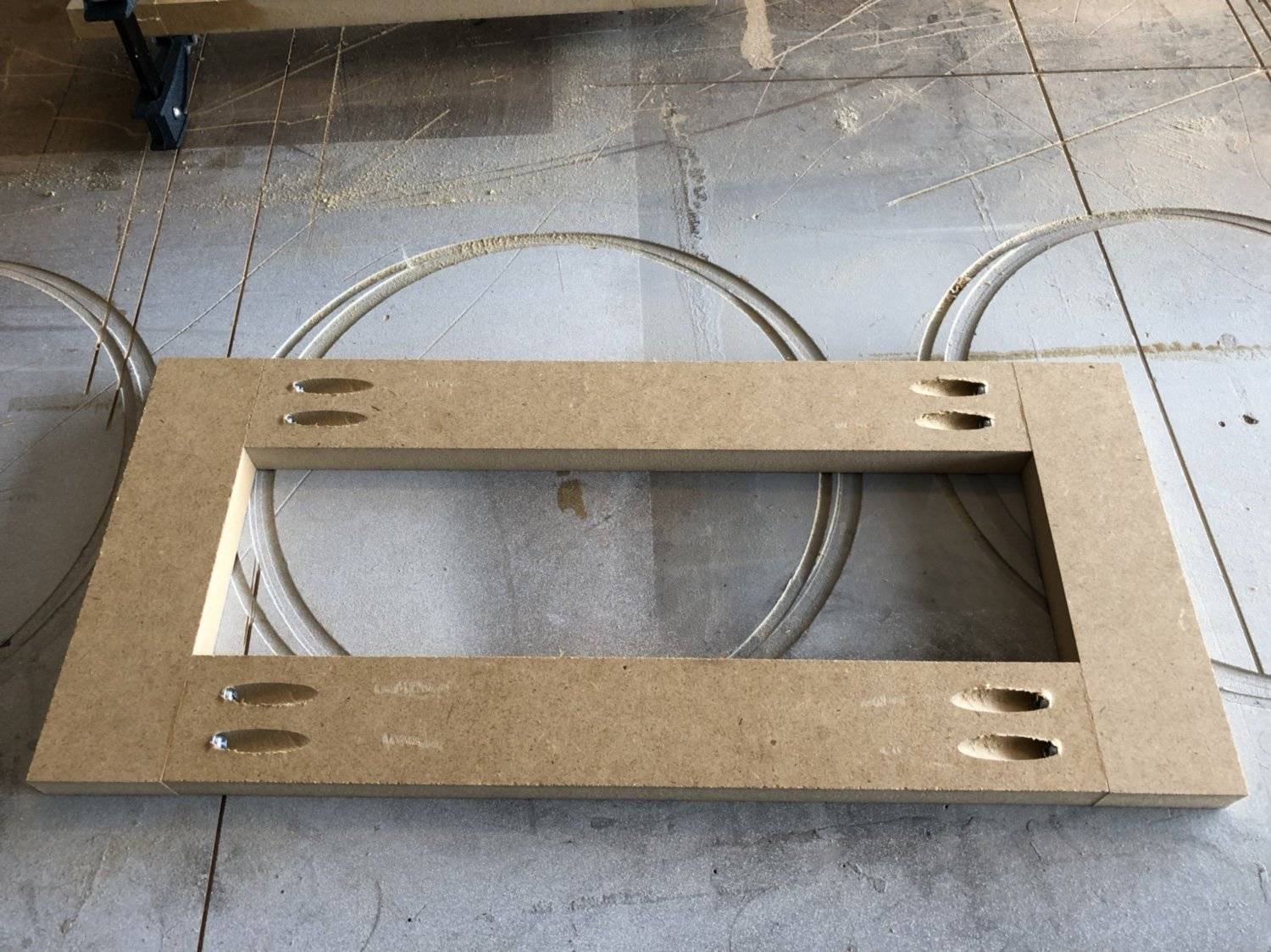

Assembled amp mounts. Glued and Kreg together.

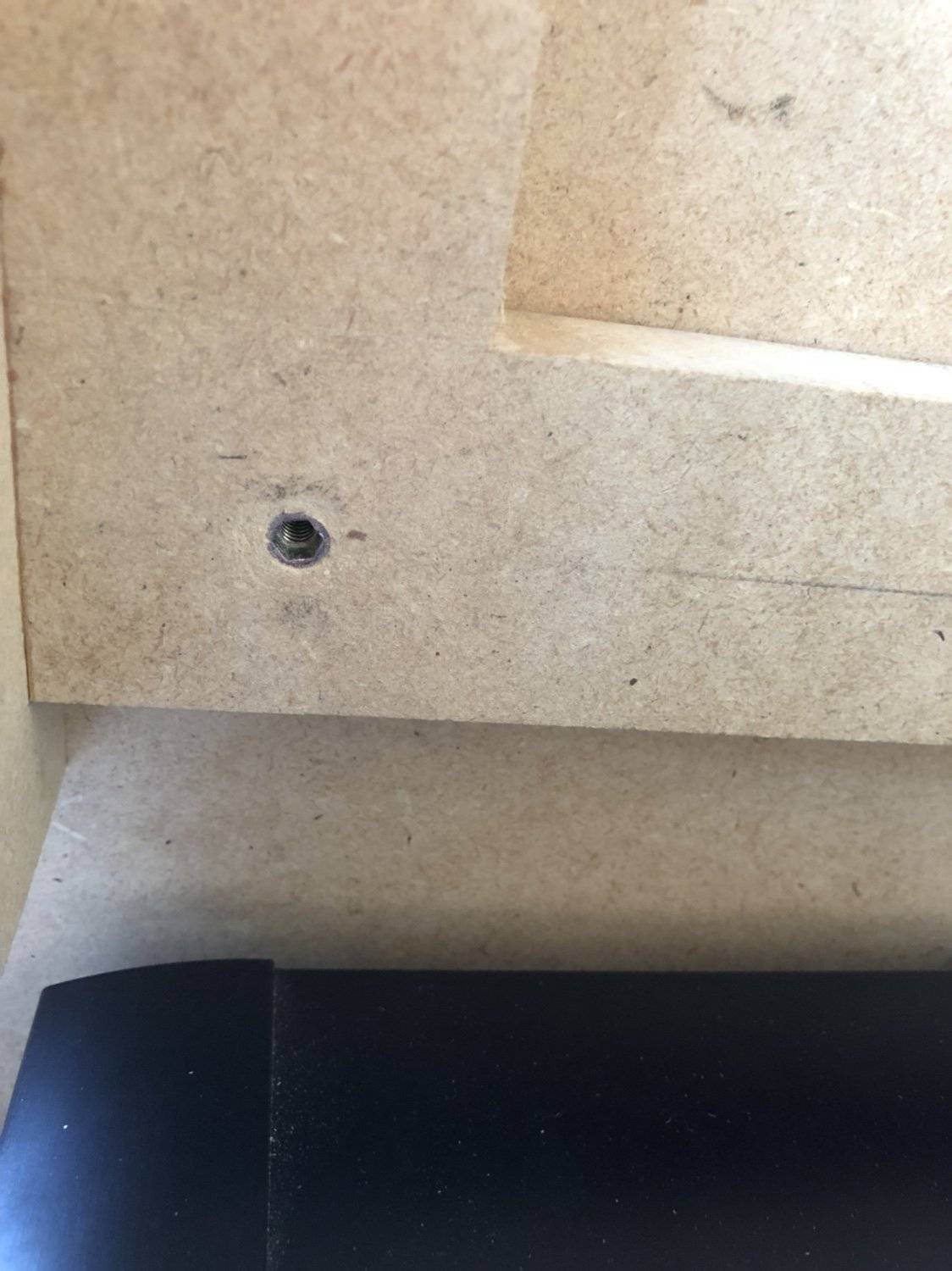

Used threaded inserts for the amp mounting points

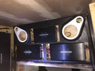

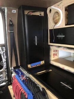

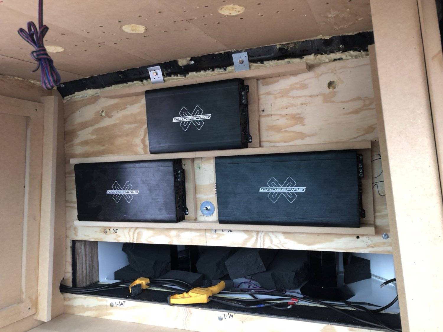

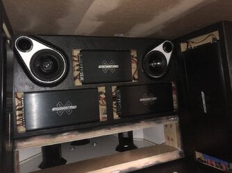

Test fitting the amp rack and amps

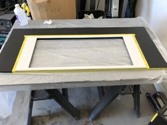

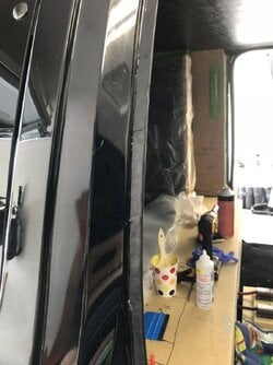

IFO is this Sunday so I did some vinyl wrapping to pretty it up. I’m liking how much the white pops.
Floor piece in black vinyl and the mdf trim piece that is around the amp will be flocked white next month.

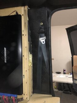

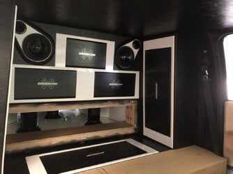

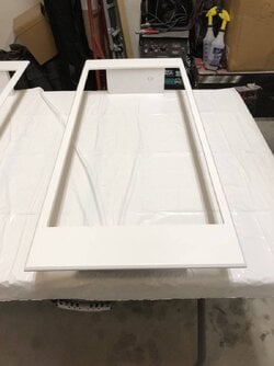

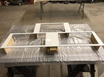

Installed the rear wall speaker and tweeters. Got the door pods bolted back on for now. Got the trim panels all finished up. Painted the trim with gloss white then polished and glued it to the vinyl beauty panels. It isn’t perfect, but I’m liking the way it is coming together.

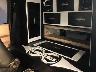

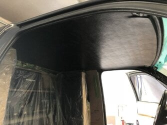

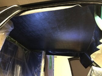

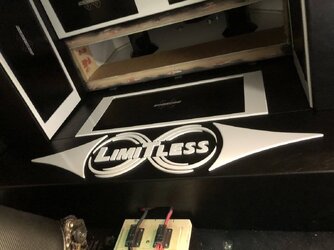

Got the roof and side walls by the seat belts vinyl wrapped and all of the beauty panels put back in. This was my first time using vinyl and I really like it. Pretty forgiving and easy to work with. Going to finish the battery cover this weekend. My father in law cut out the limitless logo on his cnc for me. I think it turned out pretty sweet. I’m going to paint it white and glue it over the black vinyl like the rest of the trim panels. There is also about 20” of empty area to the left and right of this logo so I may try to make something for those spots as well  BE3D783C-87CC-442B-8505-2C1A9FF1AD1D.jpeg4157846B-86EE-43A3-9A9F-E337164AE5CD.jpeg61324C4C-455B-4C6B-83C8-5876DDF3FE9D.jpeg7B82E65D-665D-49CC-92D7-AB33F52C0591.jpeg4FC931DB-5835-431C-AE3F-C537DA16A56D.jpeg0CC7DE69-CF76-4F28-AAFE-2AE207879D95.jpeg71A049AC-00E7-4C17-AAA6-42840AC6BF6F.jpeg496B5BA4-14F6-4929-9B9C-CE22290F4F4D.jpegBCF4BE07-FB1A-4768-B9A7-E195CB125CF1.jpeg

Got the battery cover finished up this weekend. Just need vinyl wrap the port and then the rear of the cab will be 100% done.
I think im going to repaint my dash next while it is still warm. Then finish up the door upholstering and build center console then it will be just about done :)  finally!

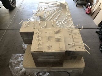

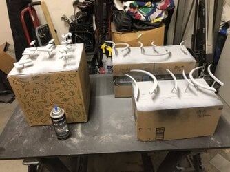

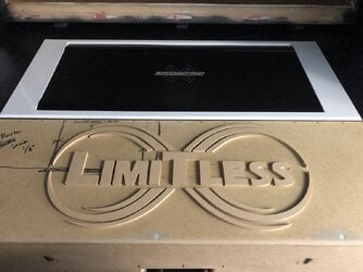

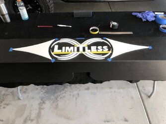

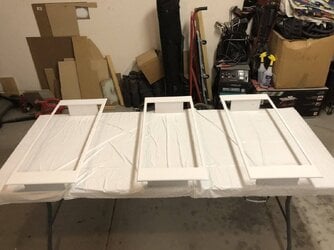

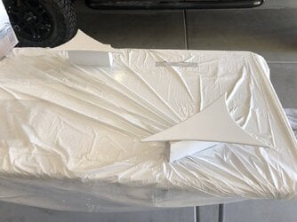

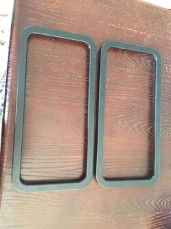

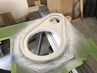

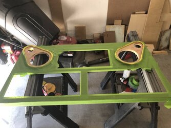

Primed the Limitless logo pieces first to seal the mdf

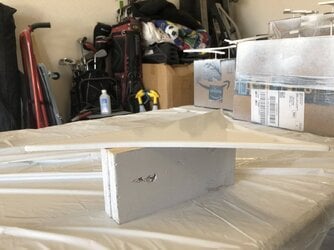

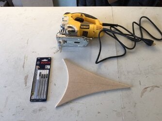

Got a new jigsaw as well. Wow does this thing work incredible compared to my old ryobi! Also go some extra fine blades and this setup is a night and day difference now! Cut these accent pieces by hand and am very happy with how they came out.
4 coats gloss white base and 3 coats clear
nice little reflection even before polishing.
Vinyl wrapped the battery cover and test fit the logo and accent pieces. The tape helped me guide the pieces when gluing them down. I love how this turned out!

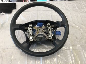

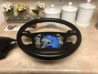

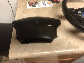

Painted the “new” steering wheel and airbag I got off eBay a flat black color with Duplicolor vinyl and fabric paint.
Before - gray/blue color
After - flat black1DEBB7A3-2189-4DC6-947B-385A6E2D18DB.jpeg5D18DF51-AEE6-4D1C-947D-432AC947112A.jpeg

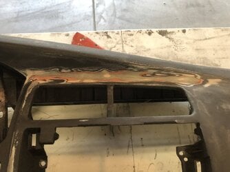

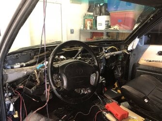

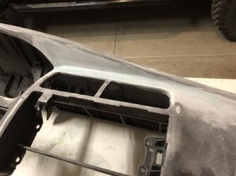

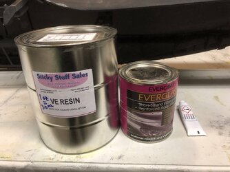

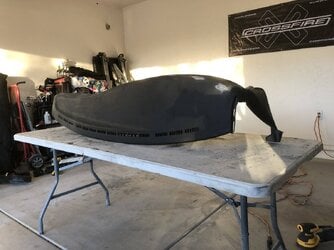

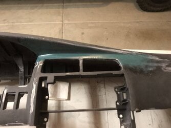

Got the dash pulled. Strengthened up and leveled out an area I body filled back in high school that didn’t look so great. Used Ve resin and short strand filler to make a milkshake.
Milkshake to level it out2CCDFA87-80D9-4F80-9563-0B2E4319B11E.jpeg25C3CEDC-12BD-4C2F-9E1B-AC2CE555D9CE.jpeg
sanded the whole dash to prep for paint
