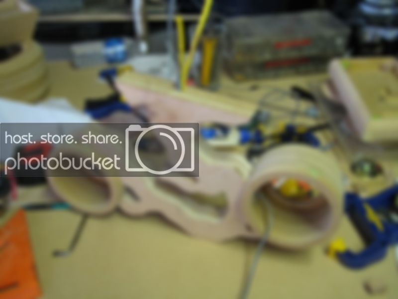

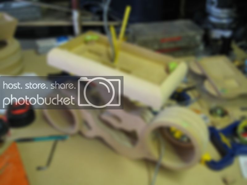

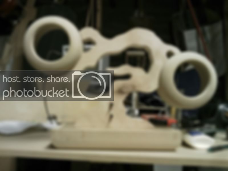

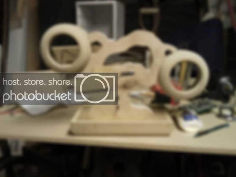

I dry-fit the trunk, base, and pods to make sure everything lined up right, and it turns out that the whole thing feels pretty solid with screws alone.

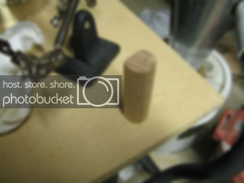

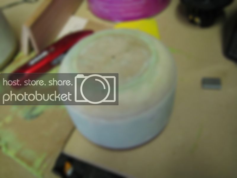

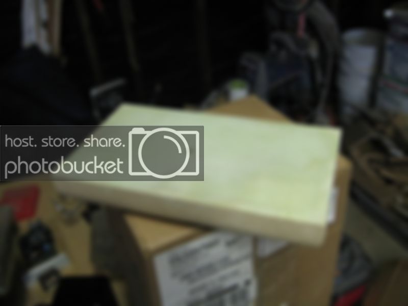

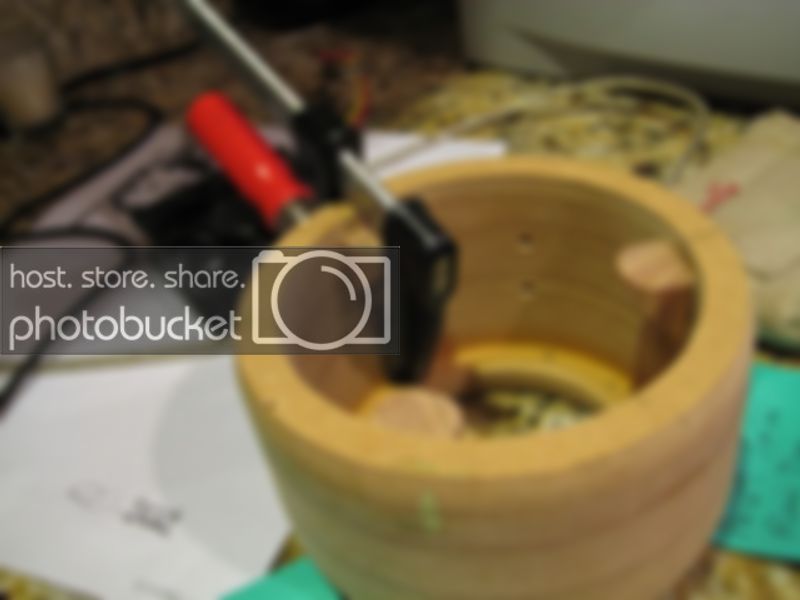

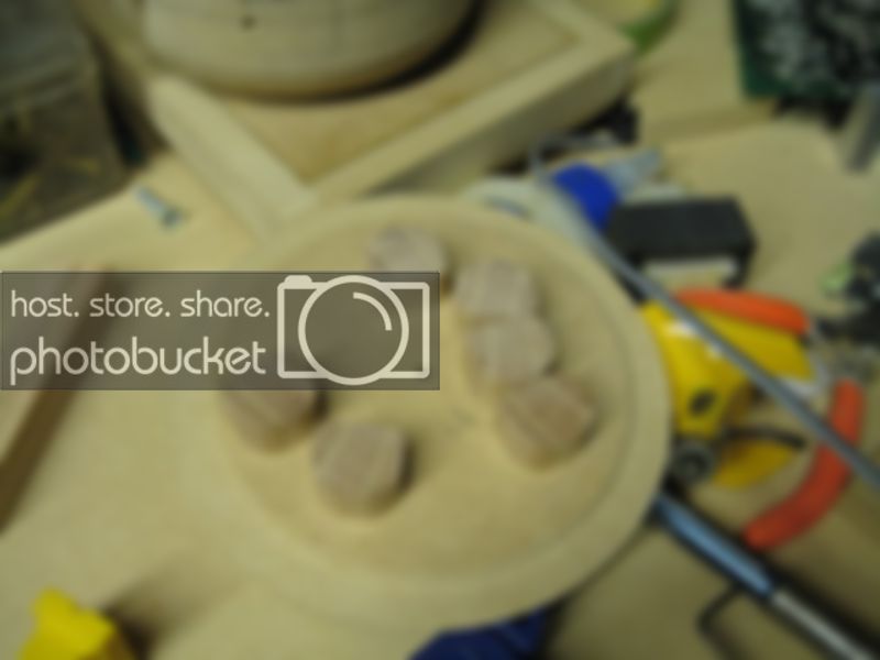

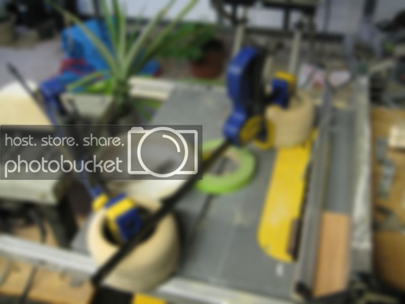

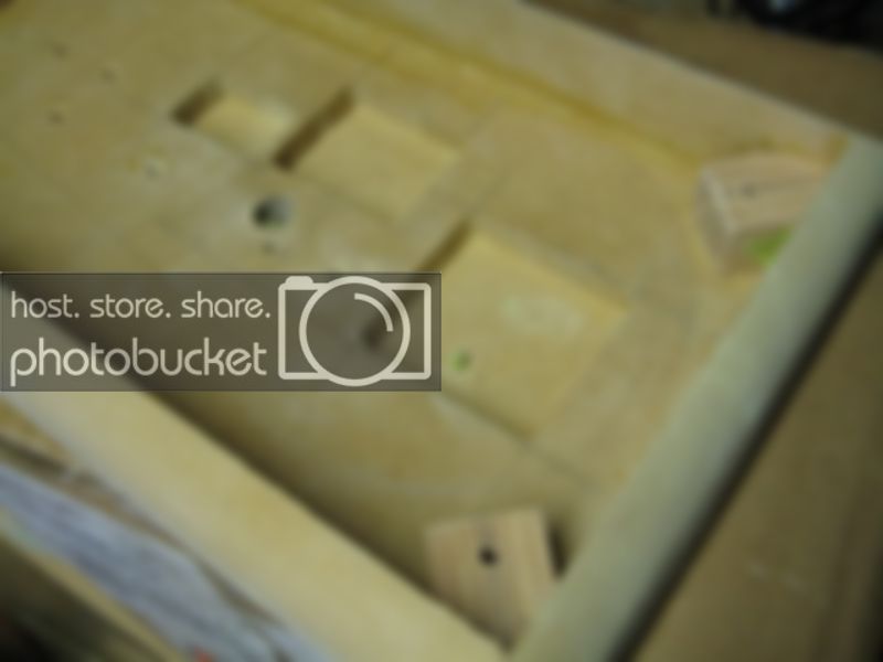

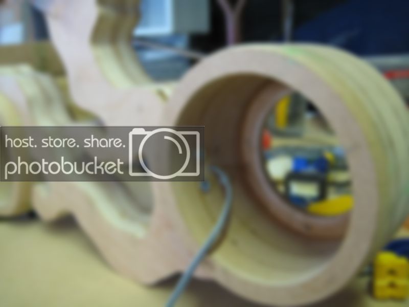

I also started on the blocks to hold the backs on the pods. I used some more of the oak that I used in the base, and rounded over the inside edges and cut off just enough of the outer edges to match the contour of the pods.

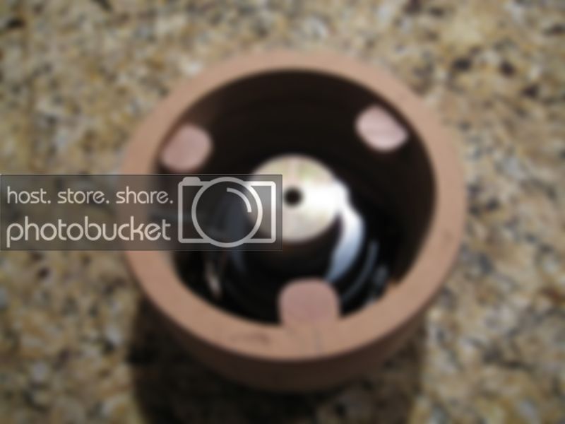

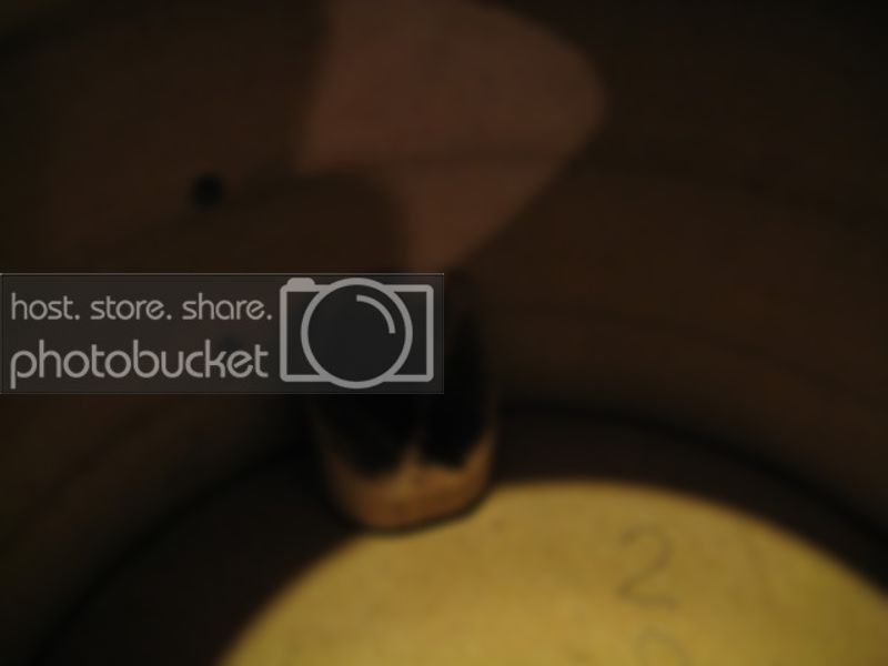

The first ones I cut were just slices of this shape, and after getting them all glued in, I found out that the drivers weren't able to clear them. Luckily it wasn't very hard to snap them out, and I sanded down the glue that was still left.
After this I decided to cut the new ones at an angle, and although they were a bit more difficult to clamp, they worked out and the drivers slipped right in.

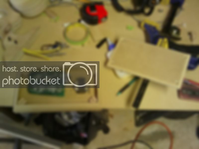

I traced the blocks on the inside of the back panels and drilled out the screw holes. I'll use those hole to drill out the blocks once I'm sure they are dry and solid, and I'll countersink the holes on the back of the panel. Once those are done, it'll be time for bondo! But that's all I've got for tonight.

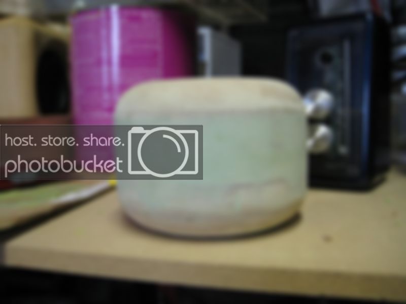

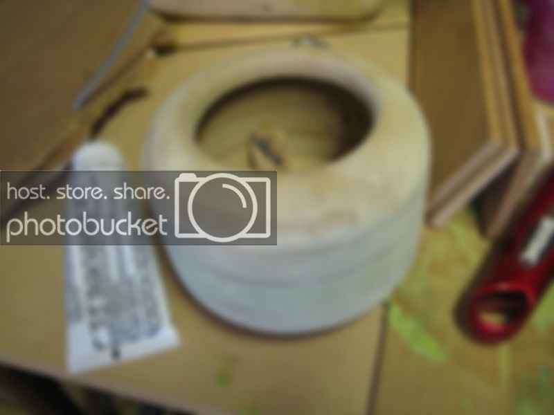

I finally got outside, and spent a bit of nice weather I laid down and sanded the first bondo application on the MDF pieces. It's a bit wavy in spots on the pods, but it should even out when I put a second batch on for more coverage. I've dealt with too many ugly glue joints in the past to let any of them show through the bondo. Hopefully it'll stop them, but who knows. If I can visibly see them through the primer I may go with something flat instead of glossy.

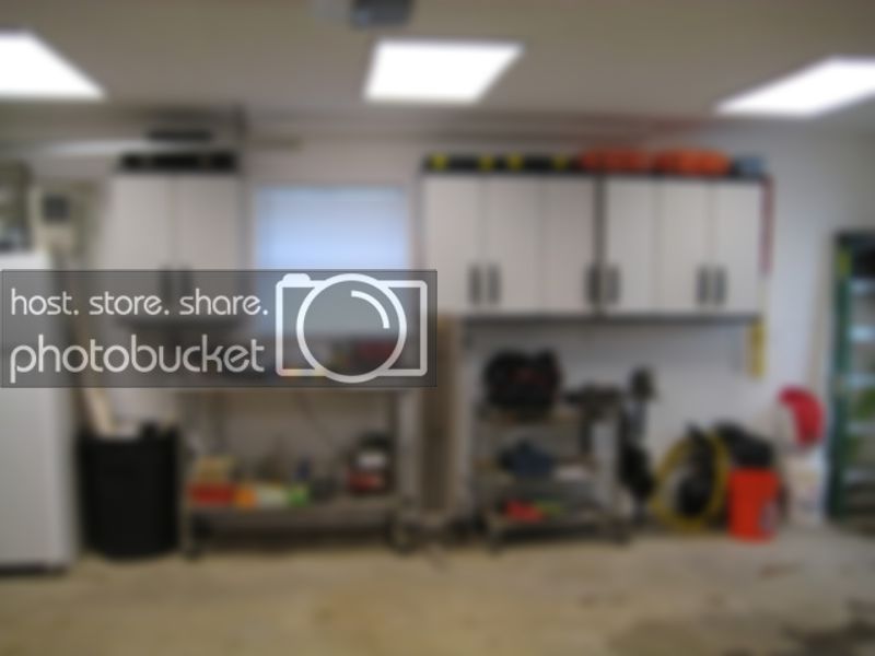

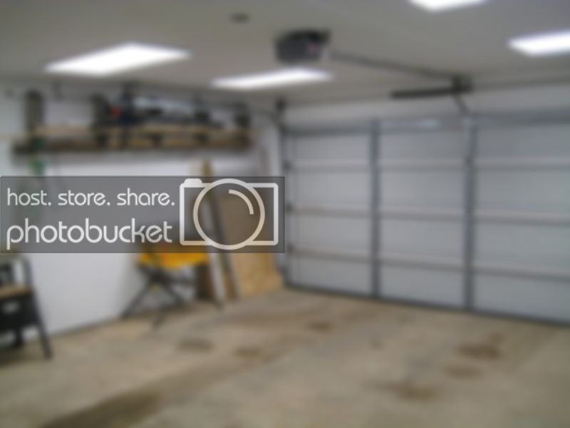

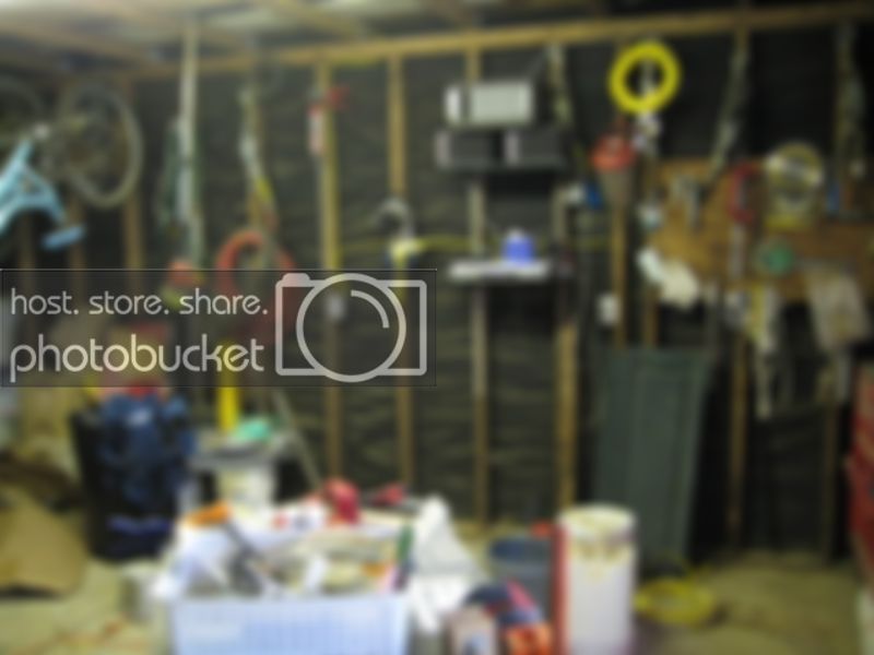

The other garage is also insulated/painted/finished now, so I have someplace warm to work in.
From this
To this
Nice work they lookin great, Also like the new garage //content.invisioncic.com/y282845/emoticons/smile.gif.1ebc41e1811405b213edfc4622c41e27.gif Send me a pm if you need anymore parts from parts-express ill hook ya up..

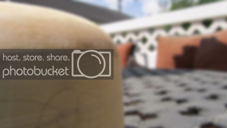

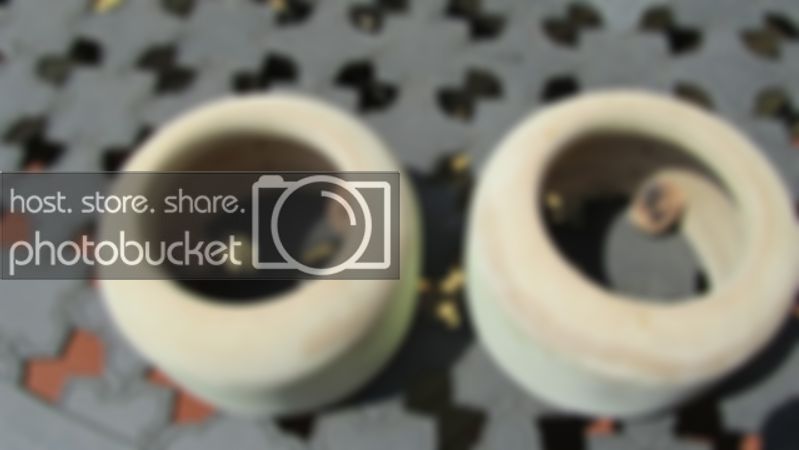

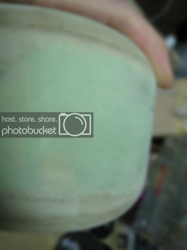

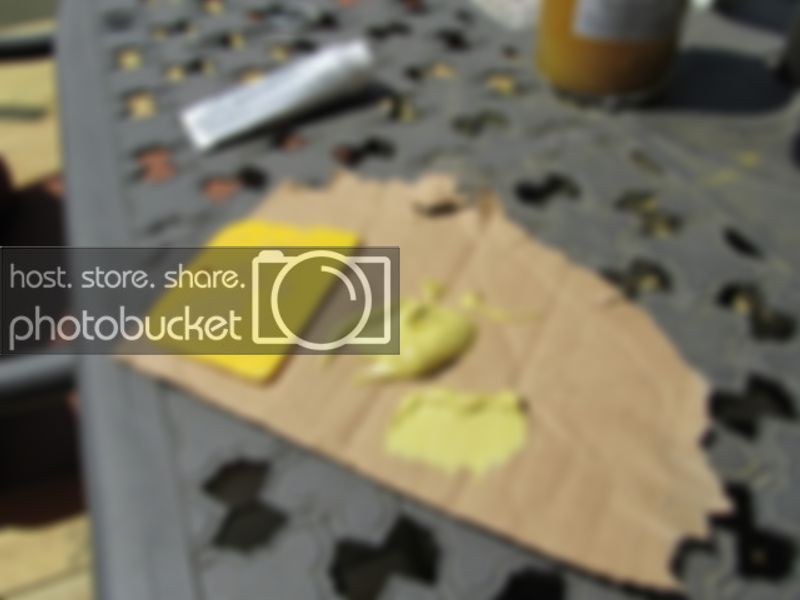

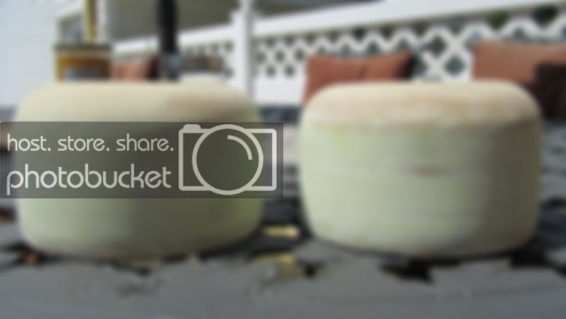

I've laid down 3 2 pretty heavy bondo layers and knocked everything down until it was just about level all the way around both pods. I mixed up a few small batches today to get small spots and holes, and I wound up losing 3/4 of a small batch because of the heat and the fact that the direct sunlight made my mix look lighter than it was.

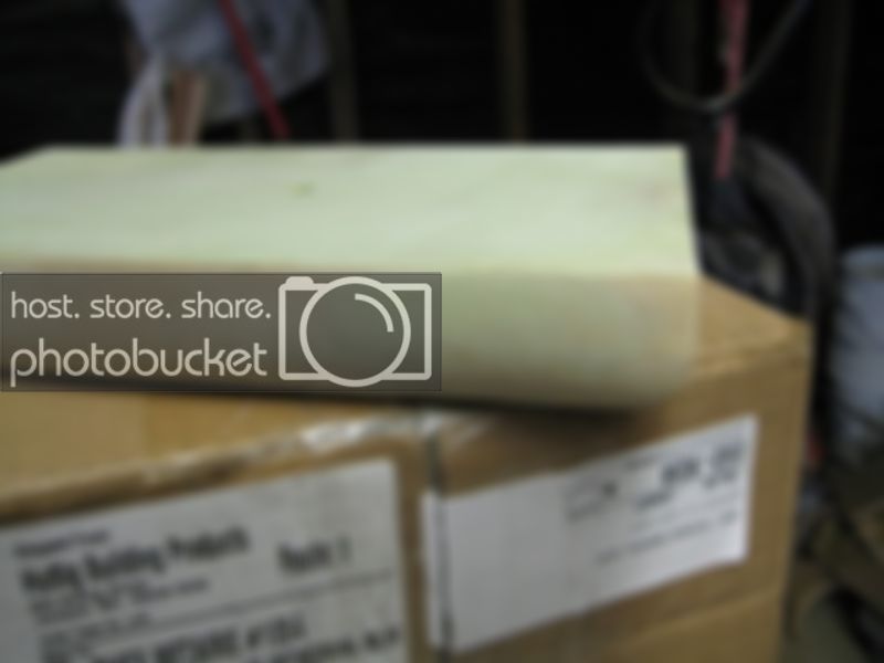

These pics are from after sanding the second wipe. I clamped my orbital sander at 90* and ran the pods along that to cut down most of it, but it left a few grooves that I had to come back and clean up afterwards. It's much more effective for cutting down bulging layers on a translam. I may just mess around with different grits and surfaces under the paper (right now the sand has a pretty soft base).
