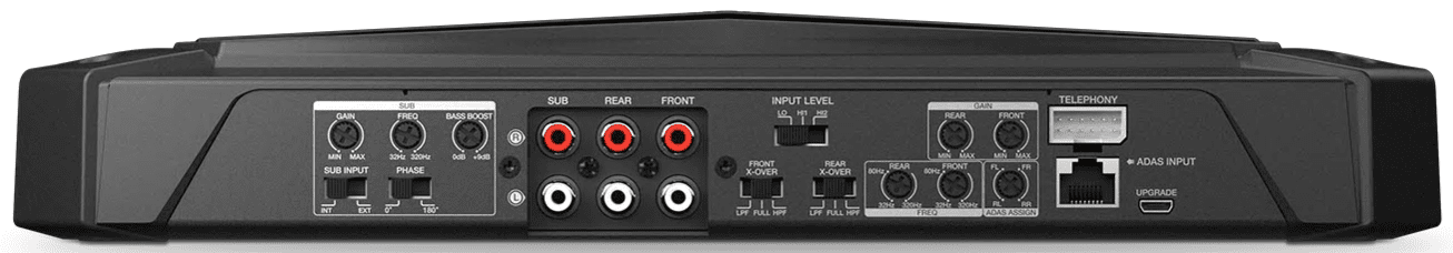

I found this JBL GTR-7535 5 Channel AMP and it does support HLI, but through the RCA inputs on the AMP.
21625
So I've done some research on how to make this connection work. I will splice the stock speaker wires on the back of the head-unit and run 2x 8 cables to the back of the car.
Then I would have to connect the speaker outputs of the amp to the stock harness, but before coming to that I would have to connect the wires from the head-unit to the RCA inputs on the AMP. I already know which wire would be for which speaker, see diagram (Don't mind the blue outlines, couldn't find one without):
21627
So it should be quite simple to do this, at least I think. So I want to know if it is possible to just wire on some RCA plugs on the cables that I will run from the head-unit to the amp.
I would have to put the AMP on the High level input, but will this work? Or do I really need a RCA line convertor?
