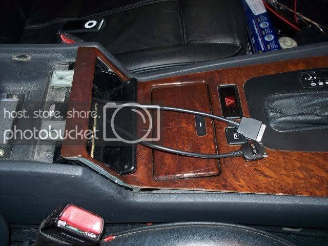

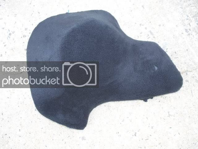

Today was cleaning up things, running the dice and ipod cables in the center counsel and a few other things. Tomorrow more cleaning up and working on the left kick panel more. I think I am going to wrap them both in black fabric, for two reasons they will blend in better and they will not get nicked like paint will. Been running the system for the past two days to allow the system to get broken in before tuning. I am waiting for carpet and an adapter to come on friday to finish up the trunk and the dice install.

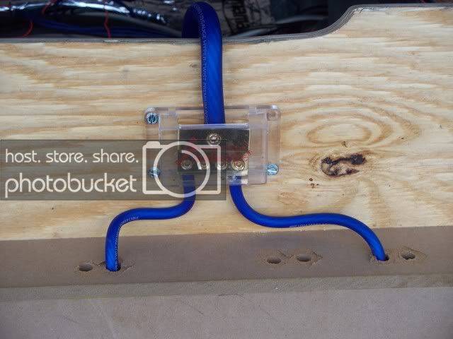

Power wire ran
iPod cables ran, one is for video and audio the other is for just audio and can be controlled threw the head unit.

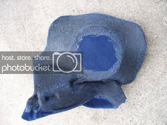

Left kick panel going to require some work but will get it done. The hood release and all is a pain to work around.

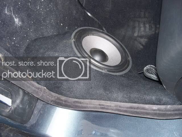

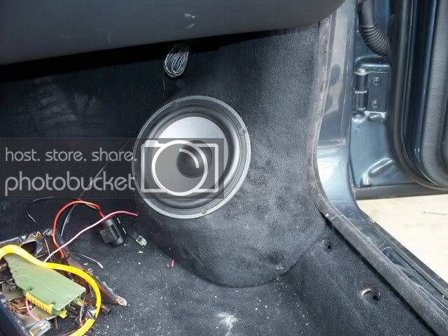

Wrapped the right panel.
Just a note the metal grill will be put overtop of the speakers.
that left panel is gonna be a bish....try to go a bit lighter on the Bondo this time around, that stuff is a pain to sand.
If you sanded that first one by hand you must be the most determined man on earth haha.
Good luck
Well luckily I did not have to sand very much by hand. But did have to do some. Your right the left is going to be a pain. Will make sure to go lighter on the bondo and smooth it out.
You can use some acetone to thin the bondo, or mix it with some resin to make a "milkshake". It will be thinner and easier to work with/spread
