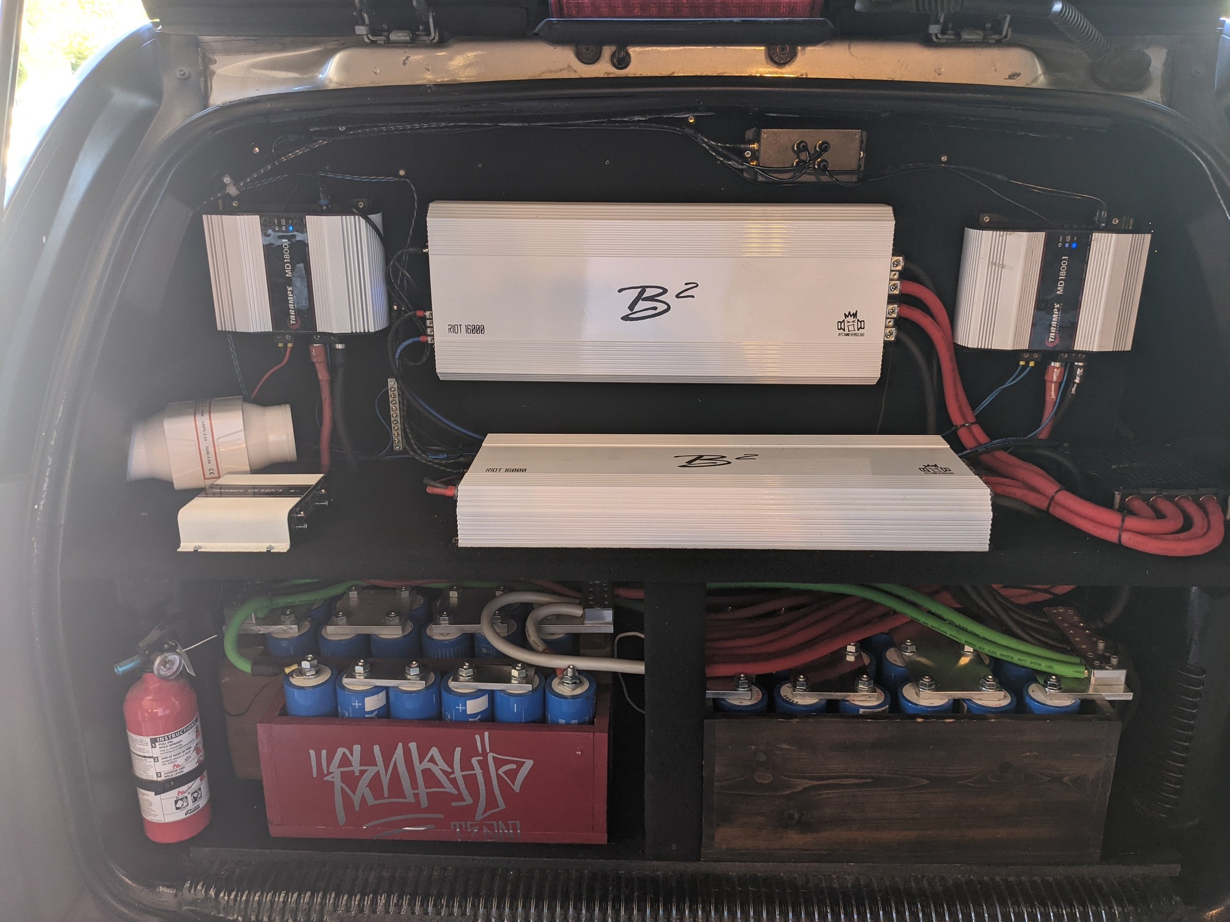

The set up was 4 15inch dc xl elite and 2 B2 audio 16k 2 subs for each amp. One sub and one amp went at the same time
This is the set up
Wow! nice set up mate! most amplifiers have some sort of protection that will prevent it from damaging speakers / or getting fried. Even if there is a short circuit, and the amp goes into protection mode. Find out what built in protection it may have, as that would give you an impression on possible issues with your system mate.
Not really a surprise he is breaking subs with that much power and from my experience any amp larger than 5K is pretty much a time bomb. Those Korean half-bridge class D amps aren't really bullet proof above about 2K size.
You're never going to fuse those amps adequately to protect either the amp or the subs and it may be impractical to fuse that sort of amp whatsoever.
If you are planning a build like that you had better have an annual budget/plan to break a lot of stuff. Keep recone kits/parts around, have an amp repair shop on speed-dial (or keep a spare amp), and probably plan for parts of your car to break.
Will do because I plan on going bigger than that
