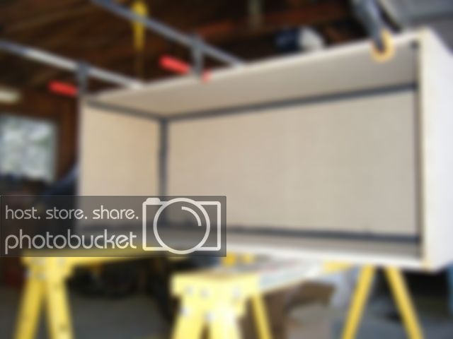

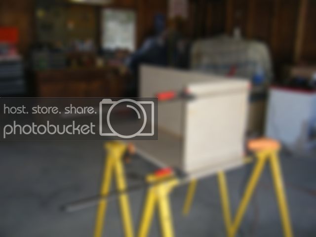

well started on my box build today. box will be 5ft^3 net with (2) 6" aeros at 26.4" long a piece tuned @ 31hz.

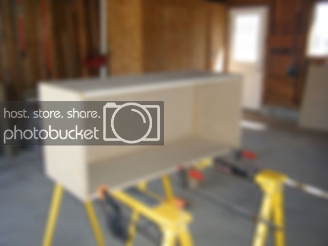

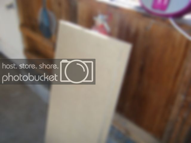

all the boards cut and started putting it together. there are many times i wish i had the tools some others have for theres, but i work with what i got.
heres the start

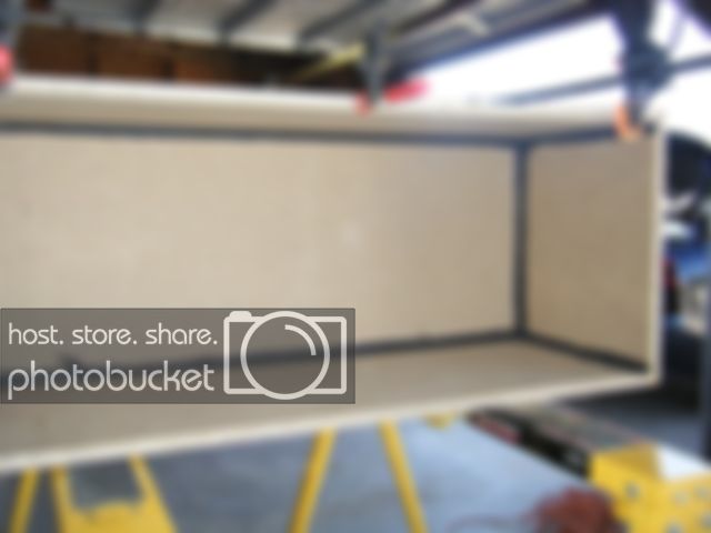

and i decided to switch it up and go with black caulk, not a big deal just something different.

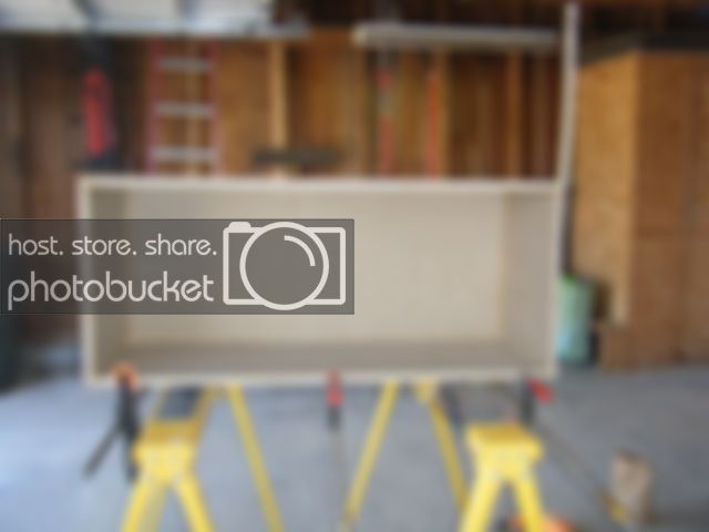

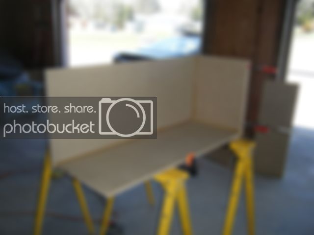

and last but not least......

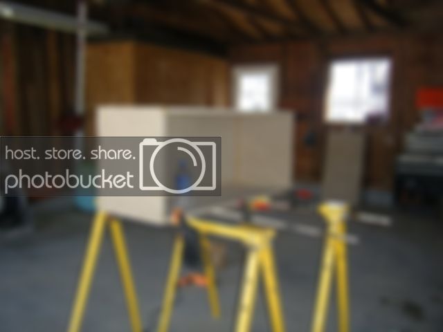

double baffle
lookin good, the black caulk is interesting.... on sale? lol jk...
it actually was on sale, i just wanted to see what it look like and to try a new brand. it doesnt matter to me to much as not many people will ever see the inside of my box.

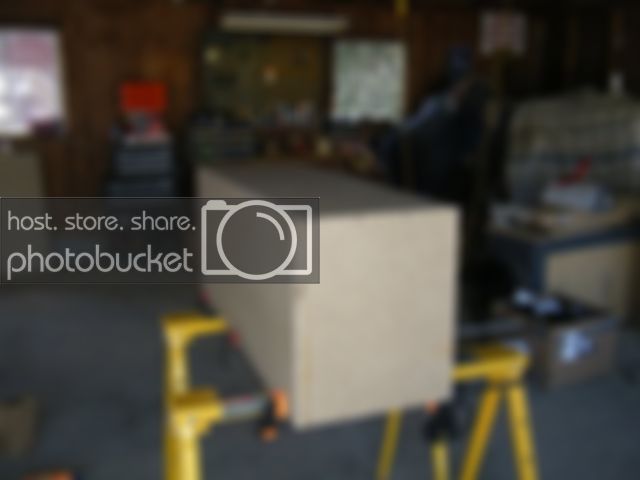

thanks, should be finishing up the rest of the box this weekend
What type of wood did you use?
novaply, it is alot like MDF but slightly less dense with less weight. and its cheaper. i had some left over from a previous build i did for a buddy, so i figured i would use it.
depending on how well it turns out and what i hit with this box i will most likely be building another box to try and yield better numbers. this box is going to be running aero's which i have never dealt with before so i didnt want to use MDF on it on my first trial.
depending on if im satisfied or not (which i most likely never am) i will be making another box, all MDF, resined and all for hopefully the final box.
