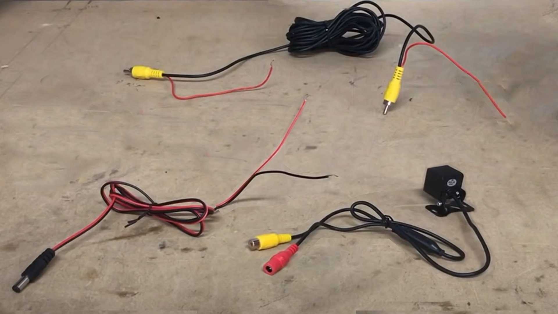

Picture is worth a thousand words. Here's the whole shebang, all laid out prior to installation. The answer to your question appears within.
The splice I repaired was in the video cable (top image).
I connected the red wire from the power cable (middle image) to the red wire from the video cable (top image) to a tap connector attached to the 12v conductor for the car's reverse lamp. I connected the black wire from the power cable (middle image) to a tap connector attached to the ground conductor for the car's reverse lamp. I connected the red wire from the other end of the video cable (top image) to the wire at the headunit labeled "Reverse". This is the extent of the power wiring for this camera, and everything worked as expected prior to the issue with failed splice.
Also, I don't think there's a "reverse signal" in this setup. I'm no electronics engineer, but to the eyeballs of this layperson, straight 12vDC juice flows directly into the "Reverse" wire at the headunit from the car's reverse lamp conductor via the red conductor within the video cable (top image). I presume when the headunit senses 12v on this wire (when the car is shifted into reverse) it switches the display to show the camera input signal. Again... it works (the display shows what the camera sees) when we press the "CAM" button on the headunit while the car is in reverse, but won't automatically switch to show the camera like it did before I made the repair.

The reverse switch wire is on the head unit itself. You would need to tap a reverse signal (possibly from the same place you tapped the red power wire) at the back of the radio. Assuming it's an aftermarket radio.
First I would measure the voltage at the reverse wire on the head unit, while the car is in reverse. According to a Kenwood manual, it likely does see the 12v+ from the reverse lights to trigger the head unit, so should be constant 12v+ while in reverse. I think most head units use a 12v+ signal from the reverse lights.
Perhaps a quick test if not good at measuring voltages, would be to manually send 12v+ directly to the head units reverse wire to make sure it triggers properly and switching the display. If it does work when force feeding 12v to that wire, then the reverse wiring where it taps into the reverse lighting is wrong somewhere. At this point I would run a new wire from the reverse lights to the head unit and not bother with the built in wire on the RCA cable.
