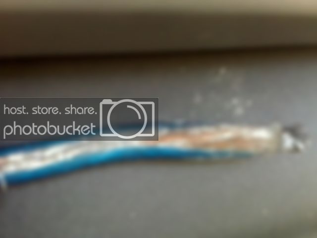

Here's a picture of the wire I cut. This was the wire closest to the Fuse.

whoa..... burned posi at the fuse.... definitely some bad connections.... go thru and clean ALL of them really really good, batt terminals, factory wires, B3 wires.... everything that has a direct connection to that batt, alt and engine/chassis.....
wire brush, electrical cleaner, etc.... the works...
