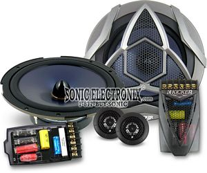

Hows it going well ive been messing with my amps and even PM people with better knowlegde then me with amps Hz bass boost, and gains. BUt no response im guessing these people dont know as much as they say they do or their just ignoring it. But anyhoo i have kicker components in my doros i and mid range kickers in my rear this is what im running in my front doors.
http://sonicelectronix.com/item_3573.html#
I love them no distortion even with the hardest hitting bass.

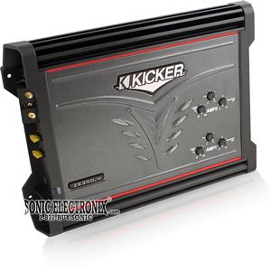

This is the amp thats pushing all my speakers
http://sonicelectronix.com/item_6748.html
I would love to have more midrange. I cant hear my drum rolls as clean as other peoples STOCK stereos i have heard. My girlfriends explore mid range sounds better than my truck now thats sad. I love that sweat TOM sound coming from drums. Espically drum rolls. But i dont get that. I was wondering what are some good setting to run like at what frequencys.

Where do you have them crossed over at? You cant just expect a ton of bass from them, you need a dedicated subwoofer for everything in the low HZ range like 80 and below or 60....then the mids you would run above that level....
the mids are between 63-80hz my sub is at 80 i can go to 50 on the sub fromt headunit. No bass boost on the amp either. And still sounds flat to me. Stock sounded better.
Sounds like an installation problem to me then...they are getting enough power....
