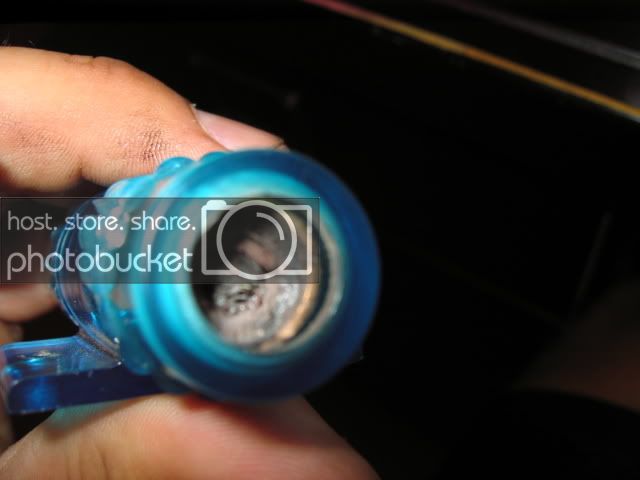

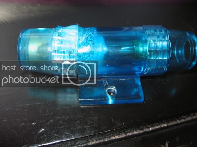

actually hittin this party up out on 64 and was bumpin and when i was leavin my subs hit for about a min and then they kinda bumped in and out, and my cap voltage said like 6.75 and i was like woahh. popped the hood today and saw this
i kinda need to get a run of 0 for the brutus :/ thats another thing i want to change but i paid like 15 bux for the whole 4ga kit and 8ga 4 channel kit.
